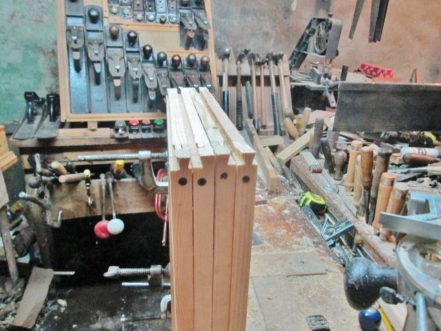

Had four 1 x 2 x 6' boards....needed eight @ 25" long.   Front and backs of the webframes. Which didn't leave a whole lot left over..
To get eight pieces @ 12-1/2" long....without the knots....gang cut a few..
Then went through the "stash" to find enough scraps that were long enough AND wide enough.....
Had to use a couple chunks od Ash, too....one or two needed cut for width, all needed planed down..
We have ways....then laid out for a few tenons..
Had to set up Mitersaw #2..
Once I cleaned it off....set up the depth stops..again...then make a bunch of shoulder cuts..
Bandsaw to make the cheek cuts...had one done for this picture....
Yep, even with having to hand-crank the Bandsaw to start it..

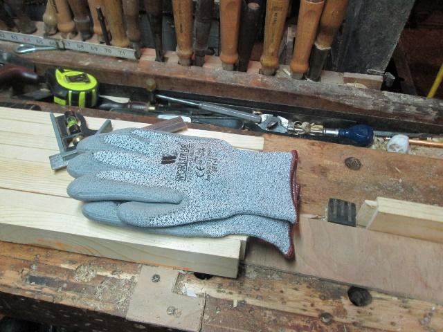

Back into mine..now.....was about ready to start throwing things in the shop....closed it down at 6pm.gloves.jpg.a8fe62754e2eb6095e1e67b5794c0b63.jpg
Gloves..so I don't get cut on sharp, pointy objects

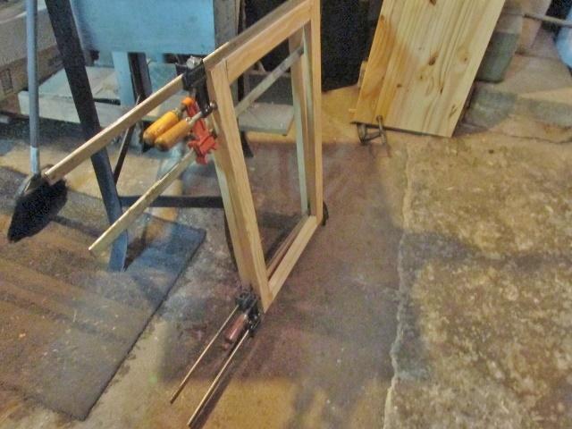

Something like this.....I get all four mortises done for one frame...time for glue and clamps, and..
two nails.   Scrap iron is to curl any points that come through, back up into the wood...set one aside..
Actually, there are 2 frames in this picture...while I worked on #3....noticed these two were warped a bit...thought I could clamp them back to flat...

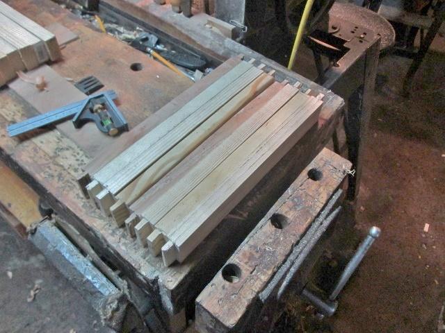

Need to get this Project done....soon.   Got the fourth frame built today....and ganged it up with the other three.    Then planed and beltsanded the sides until thel match
Well..almost, anyway:rolleyes:..got it clamped to the side of the bench for a reason...
Time for that corded thingy, again.

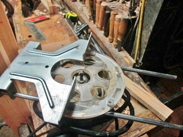

Called a router..right?:rolleyes:  Needed to change it to a dovetail bit, and add that fence...
At least for the first cuts.   The idea is to cut along the outside edges of the stack..
Make a pass down each side..
About like this.   Then slide the fence a bit, for the second cuts...
Then slide the fence until the bit is as centered as I can get it..and make the last cut..
Had to add an extra clamp, too.  Tomorrow, I can flip this over, and repeat for the other end.   Then maybe set up to mill the side panels?

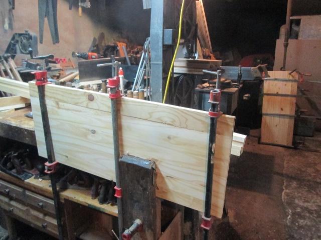

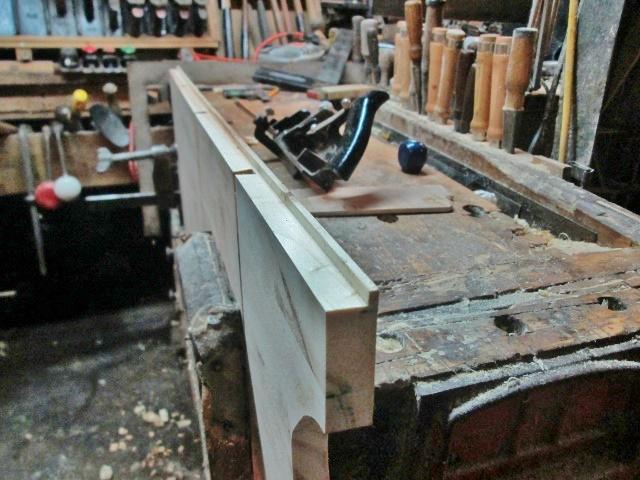

Got a bit done today..
Not pretty, but where these are going, doesn't matter....side these four aside for a while...got the panels out of the clamps..
Add-ons were thicker than the panels..
Hmmm, we have ways....set one panel aside, for now....and got out Old Number 8..
Got the worst off of this side...flipped the panel over....arms were getting tired, switched panels a bit..
No. 7c and the No.4....had a bit of tear-out on one end...decided to make that the bottom.

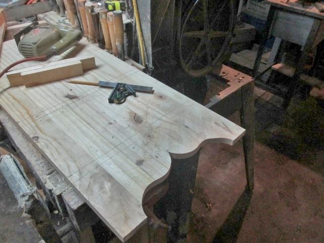

Going with 1 x 8 drawer fronts...spacings will be right at 7"...Got to the bottom....had a bit extra.   Used 5" from the bottom of the drawer to the bottom of the foot
Apparently, can used as a model, had a dent in it....used two Vintage saws..
Both B&Ds   One might be a tad newer than the other....All metal one was for the straight cuts
And the green plastic one for the curves..
Will fine tune that curve, before I trace this onto the other panel....Time for a straight edge..

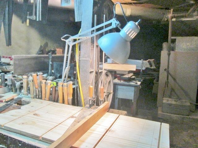

Managed to get the last two sockets on side 1 done....

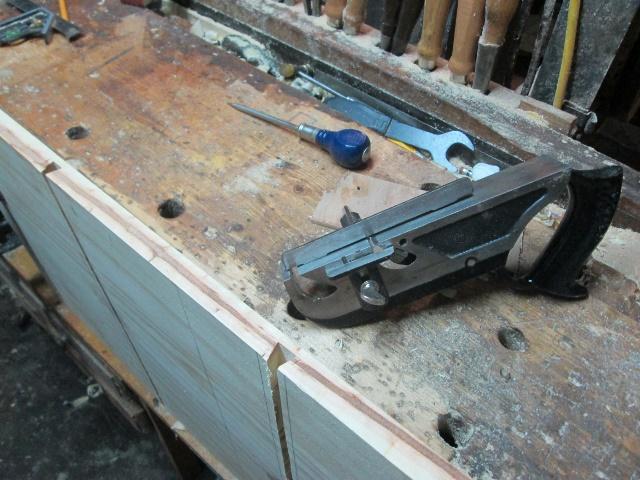

I needed this light...camera hates it....got the #78 out..
Once I got the side clamped up..
Wards #78...something to pick stuck shavings out with, and a scrap of plywood to check depth.  Even use that to set the depth stop with
Made a mess on the floor...thumb was getting sore, too..:(
Between the #78 and the router....finally got this done..

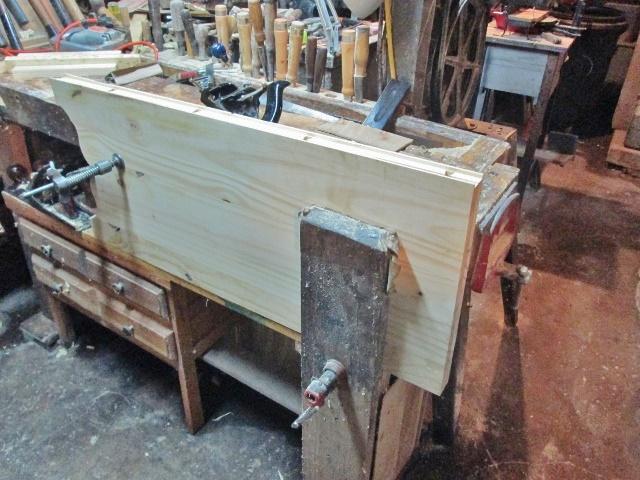

Because the second side needed flattened out....4 planes...a #4 a #5 (cambered jack) a #7c...and i tried the #8..again..
Then laid the first side on top of this side..

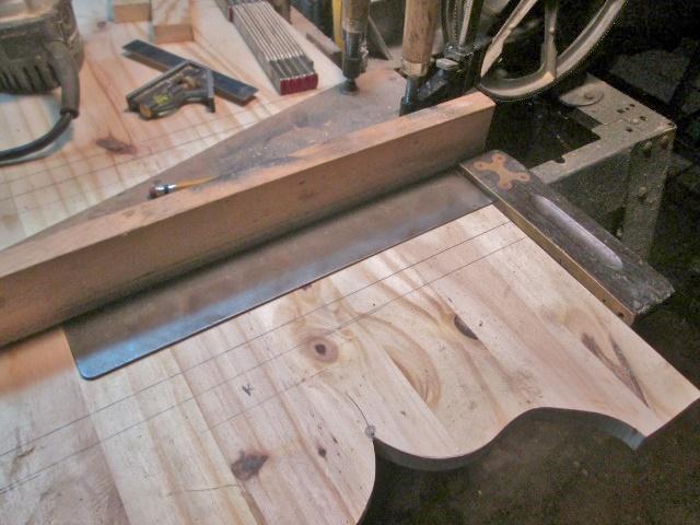

Decided to trim the "top" of the second side...tear out was on that end...marked this for the saw...and marked the other end..
Marked where the dovetail sockets were..
Set up the speed square to trim the end..
SKIL 6" saw.   Saw follows to guide..
usually gets a decent straight cut...green sabresaw was next..

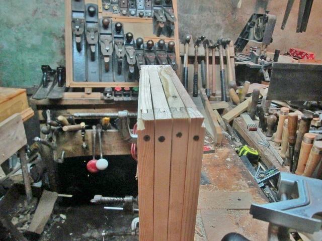

Power outage for a few hours today....put a crimp in shop work....other than a dry fit...
If'n you be taller than 5'10", that bar clamp will nail ya..
