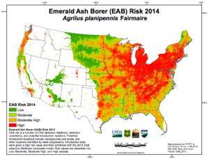

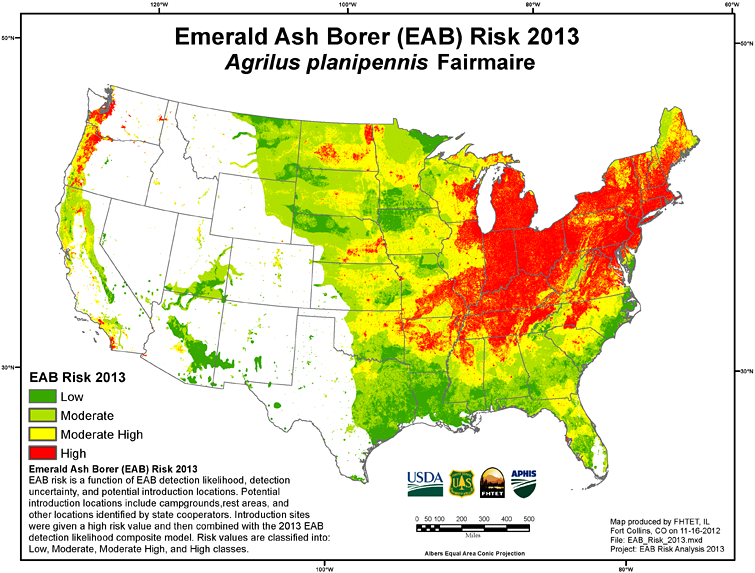

As far as I know, yes.   For a few years there was a quarantine against moving logs across county lines.   So the lumber mills stopped taking it.  Thanks to idiots, it did not do any good and within a couple of years it was in all counties of Ohio so I think the dropped that.
On their own, EAB will only move a mile or two in a year.   But it's spread from the initial port of entry, Detroit, much faster than that.    I lost both ash in my new yard and had two in the old yard that I had treated, but will probably succumb if the new owner doesn't keep it up.  In one year:

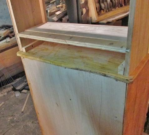

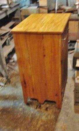

Tipped the case backwards, so I could work on it better..
This way I could reach these three plugs, without having to kneel on the floor.....got out two tools to trim with...
Bevel down chisel, and something to "tap" it with.....then sand everything smooth as I could, and add a coat  of shellac...
Then repeat for one side....

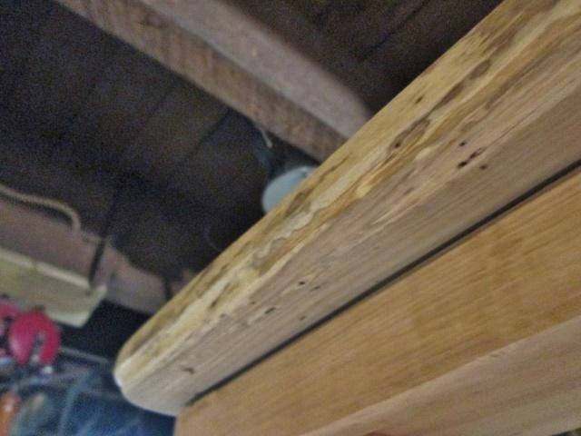

Those two little objects sitting on the top?
Trying to decide whether to round things over, or...just cove it....still need to do the last side.      Maybe I can get the router set up, and do a few edges...
Stay tuned. might have this case upstairs, before all that white s..stuff melts.    would hate for this to be floating around, down there...:angry::rolleyes:

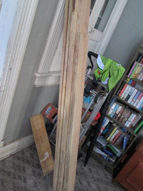

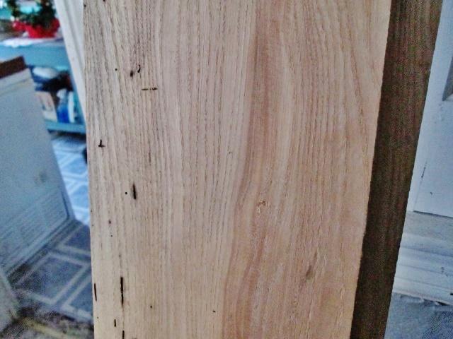

Just got back home.   Spent just over $12 for 15bf of Ash.    All 4/4 x 6" w.....average 5' long.    10' was a bit too long for the van, anyway.
Going to let them sit and get warmed up a while ( me tooo) before I start using them....
Stay tuned....

All 6 planks....used to be about..10' long, before we cut them down.   Which would be three @ 4/4 x 6" x 10'
All quarter sawn.   Just about matches the last load...may have all been from the same tree...

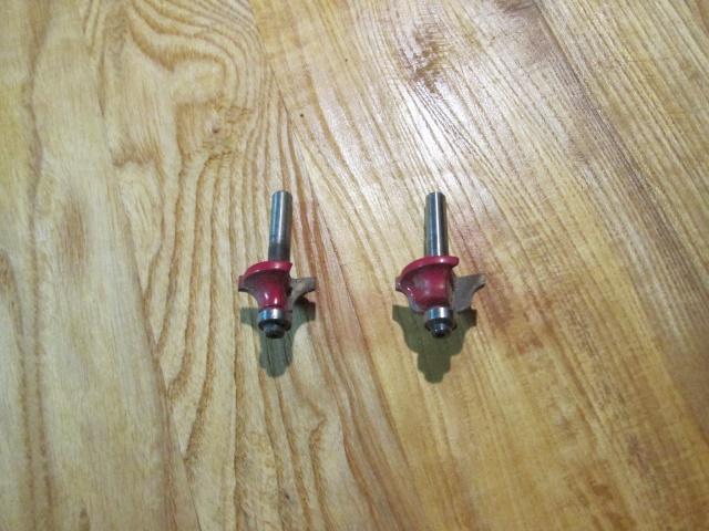

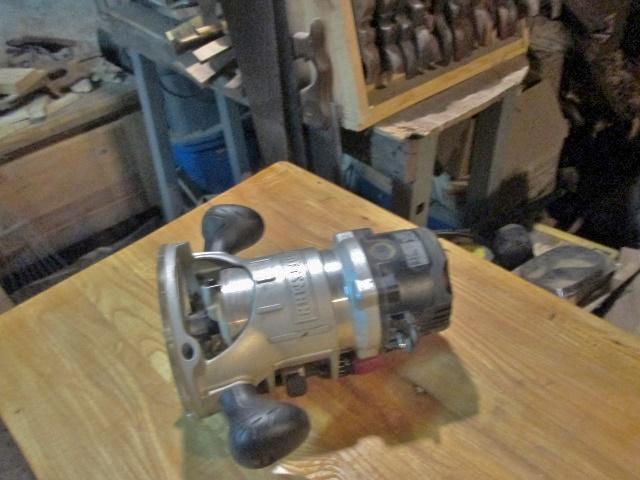

Set up this machine, today..

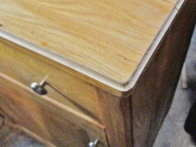

Decided on a cove bit, and only a portion of it..
Wanted a small detail around the top's edges..
Then a sander, and the smooth plane, to get the top about done.   Then it and the last side..

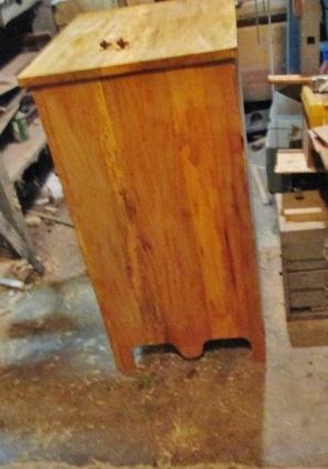

Got a coat of shellac.    When this dries, it can go upstairs, until the bookcase is done.    May just use Shellac for the finish....

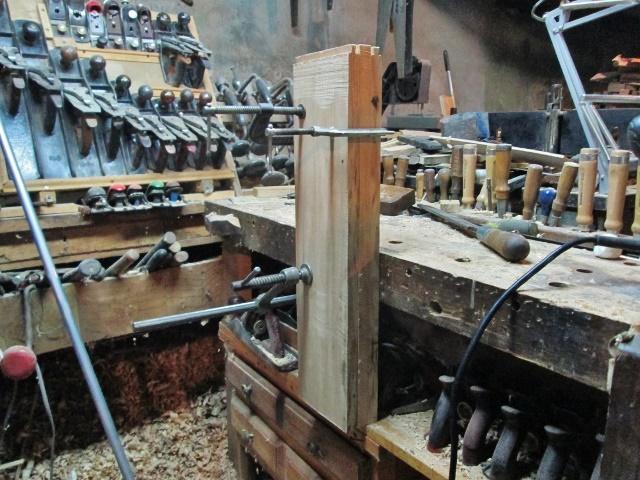

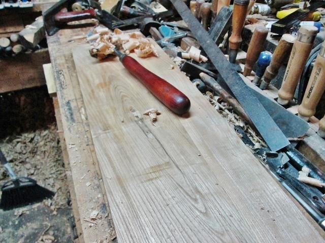

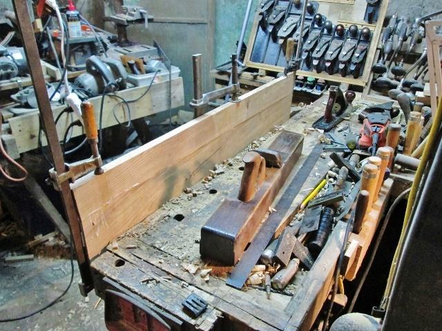

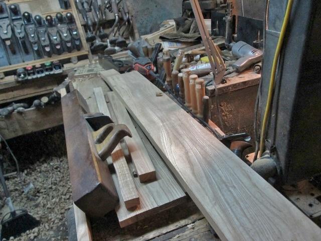

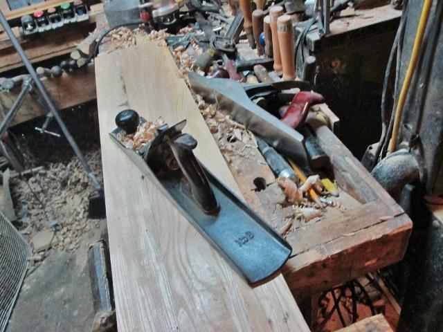

Today's little shoptime:     Hauled one plank to the shop this morning.   Crosscut it to length.    Set up the bandsaw to rip right down(almost:rolleyes:) the center...Was a bit too wavy....blade was tracking the grain, NOT the line...:angry: reset, and this time I followed the lines...almost.    Clamped one into the legvise
That big wooden plane is my jointer, for today.   Got both edges of this board jointed, then moved to a wider board..
Checked to make sure the gap-osis is gone..

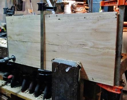

Then spread some glue, and add a few clamps..
One board is a hair thicker than the other....can be planed smooth, once the glue has cured...set this one aside, and repeat

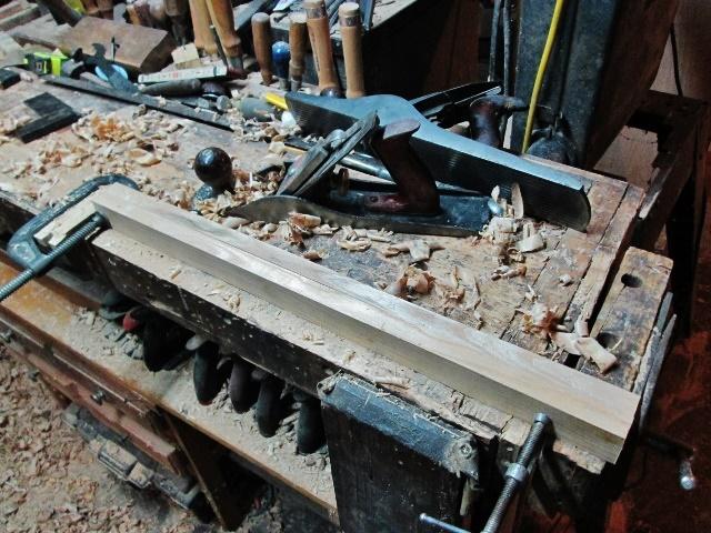

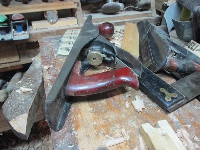

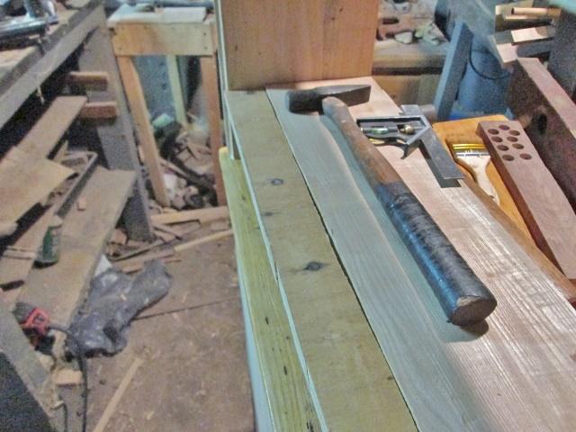

Had a few edges that weren't quite lined up....we have ways..
Cuts on the pull stroke, this time.
Can also be push along.    Took that ridge right down.    I had some work for two other planes..

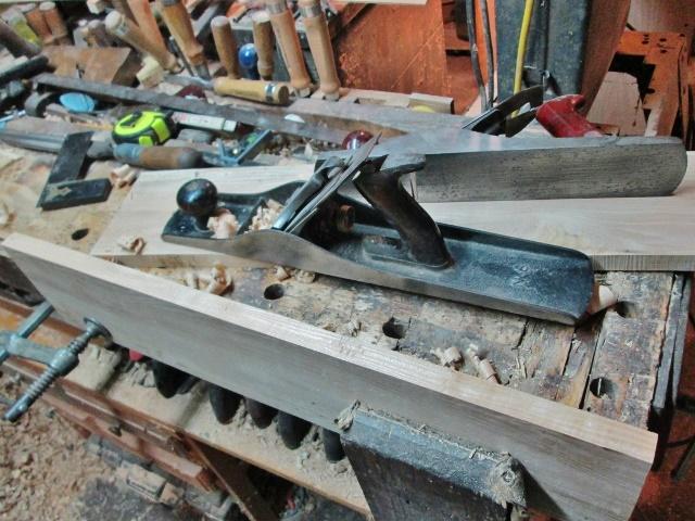

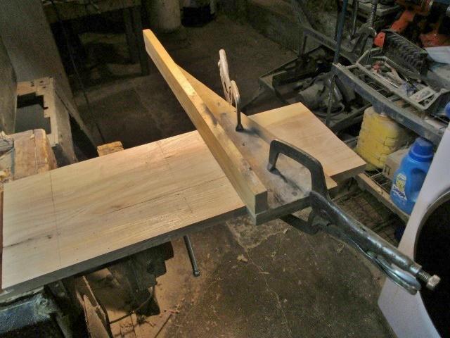

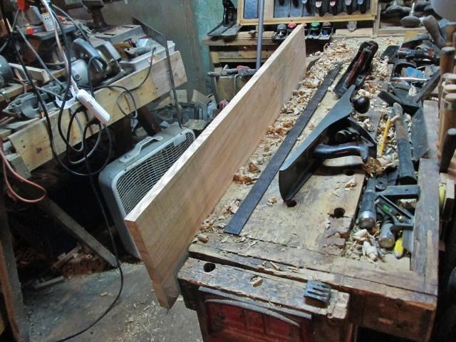

Trying to get one of thses case sides flat and square...this one was curved a bit..
Finally got  this jointed straight, according to the steel straightedge.   Decided to set this on the other plank, and see how much needed trimmed down..

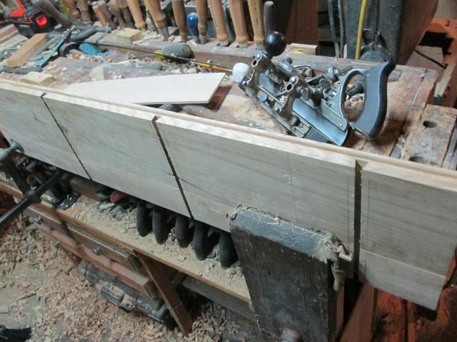

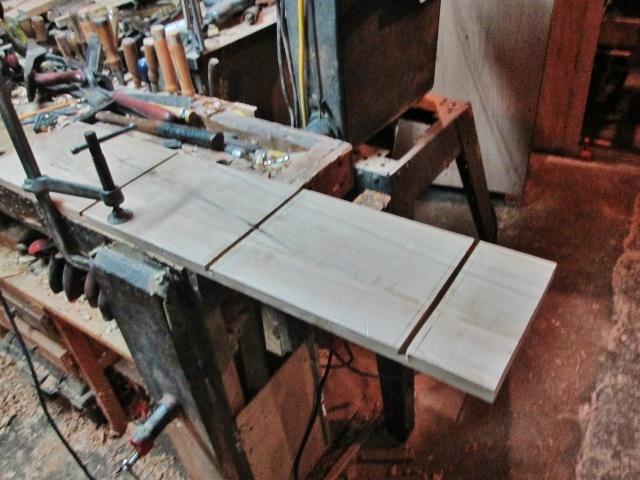

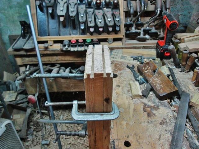

Well..anyway, marked this out, and trimmed it down.    As you can see, there are a few dovetail sockets showing

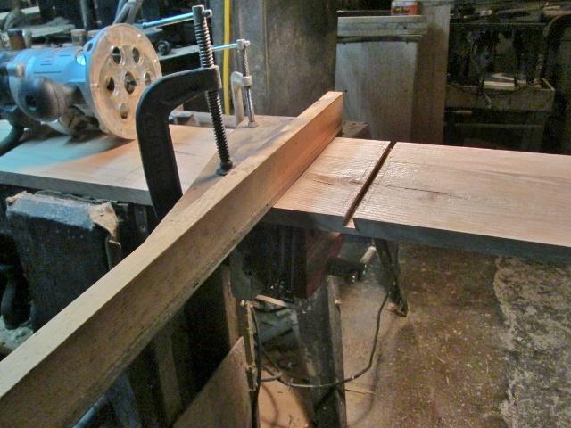

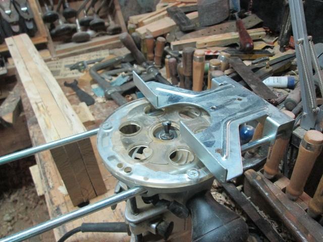

Something like this?   Laid out three such sockets, and milled those..
Trimmed the second plank down, and worked it over a bit..
Until it was also S4S.   Then milled three sockets...AFTER I made SURE I was setting up on the correct side of the plank....had to set the fence a little differently, on one cut...
Backwards?   Maybe, but I did have to PULL the router through, instead of PUSH.    Once all the sockets were done, I could change fence types

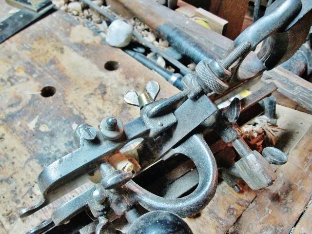

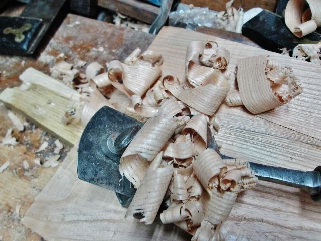

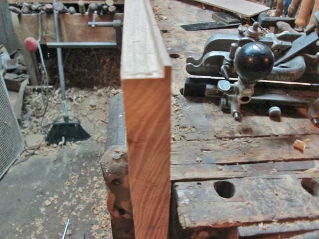

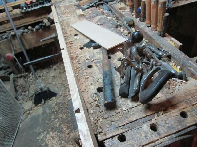

Leave these for later.   Set up a handplane..
That be a #17 cutter.   Everything is set up to mill a rebate to house a 1/4" plywood back....and have it deep enough  the edges will be hidden..
Something like this?   I had a scrap of the plywood handy, to check the depth..
Got one side done, and double checked a couple times, BEFORE I started to mill a rebate on the other panel....

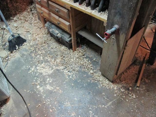

Had to keep sweeping the floor..
About this time, decided I had enough fun for one day.    Almost needed to turn a fan on....I swept the floor, turned off the worklight, and called it a day....

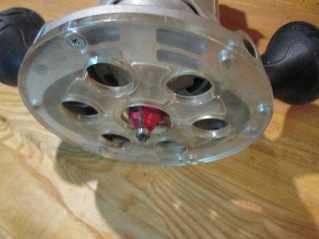

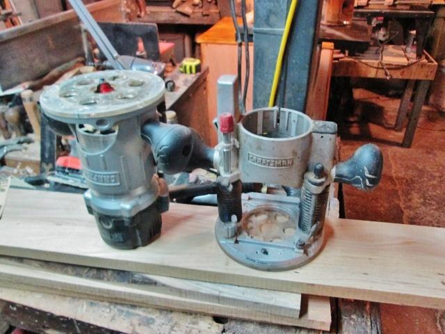

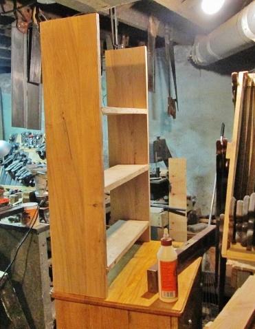

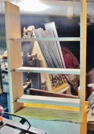

Got three shelves set up, router was set, might see how it goes..
Not too hateful?     This evening, got bored, again..sooo..
Ran the router a bit more, got all the ends done....Then the hammer came out..
No glue involved, just a press fit.   Still need to cut and install 2" wide fillers in the back of the shelves...

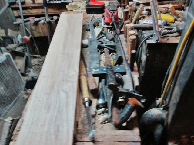

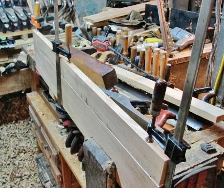

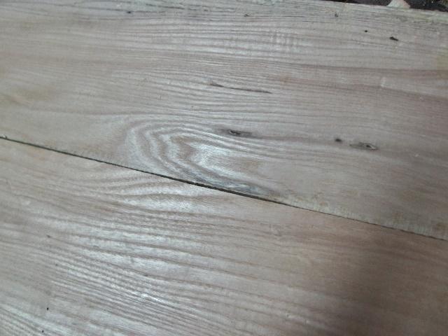

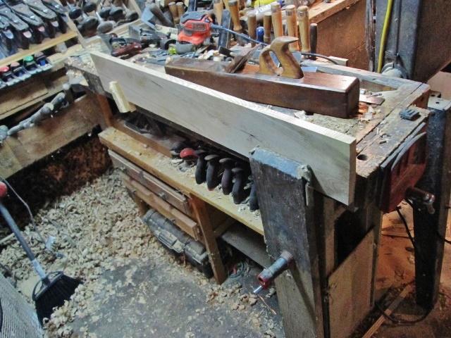

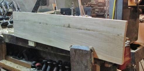

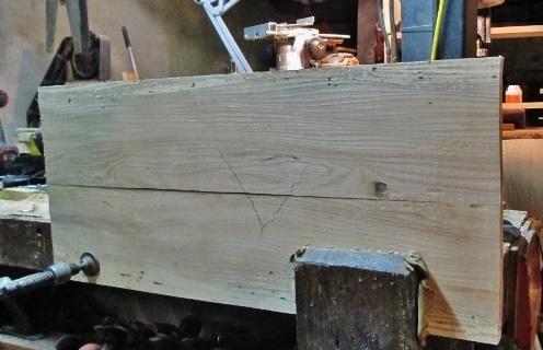

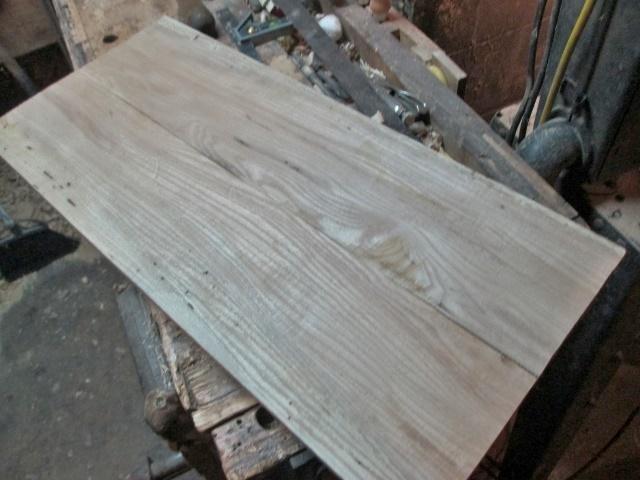

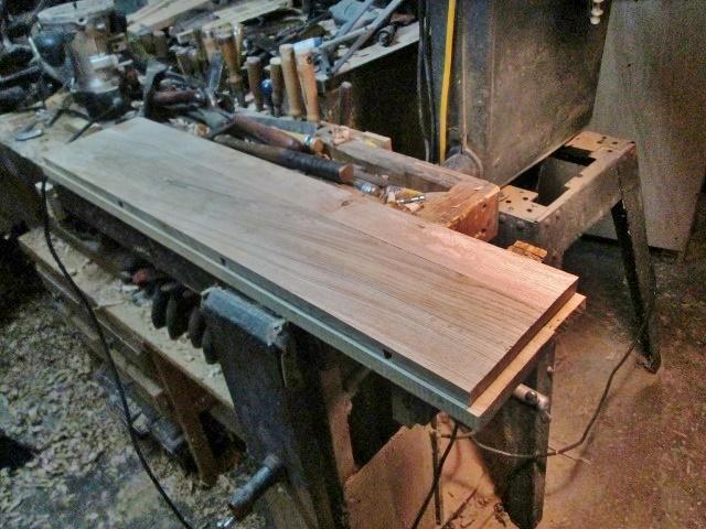

Decided to get a little bit done, this morning, BEFORE Lunch..hauled a board to the shop.    Squared one end.    made a mark 26" from that end, and made a crosscut.     Turned the board end for end, marked 26" from the cut end.....came out just before a huge knot.....lopped the knot off.   Laid the two blanks side by side, to see how they will look
Not too bad.....had a few gaps along the edges
Marked a "show" side with a "V" to keep things lined up
Then got of the toys to dress the edges a bit
"We have ways...."  worked both edges, until I was able to spread a bead of glue, and add a few clamps..
Will let this sit a while....break for Lunch.     Need to haul more boards to the shop..AFTER Lunch..:rolleyes:
This will be the top of the bookcase....need to build the face frame and the door, next.....

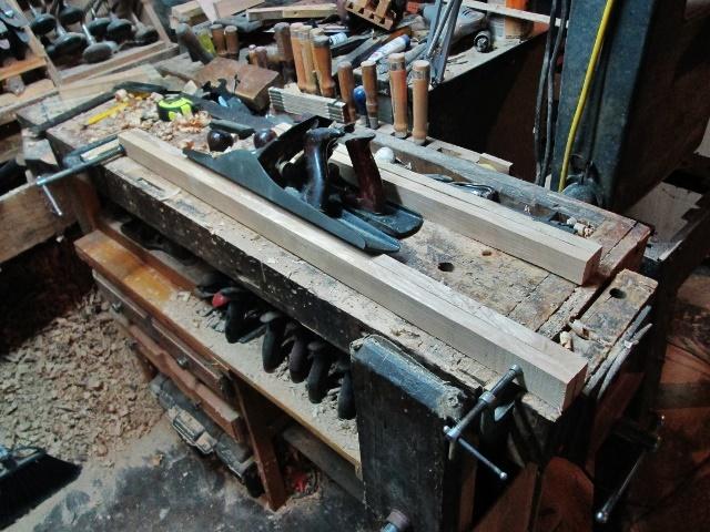

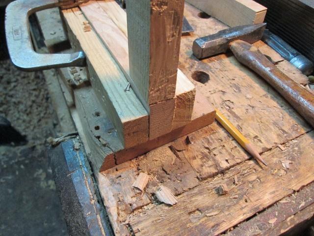

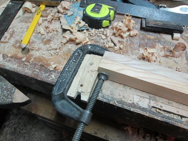

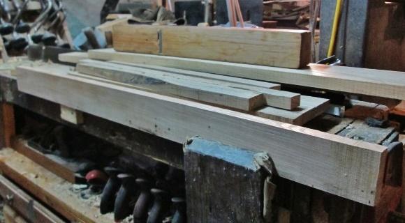

Removed the top and set it up on the bookcase, to get it out of the way......set up a way to joint the edges..

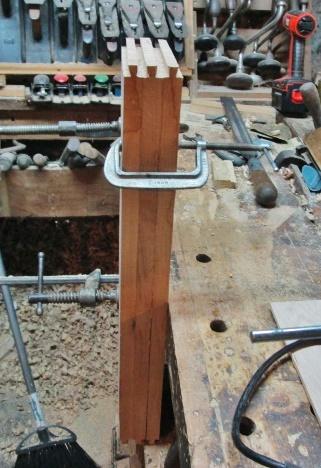

The one c clamp is held by the end vise...the other c clamp?
Well, there is a block screwed to the bench, as a stop.    C Clamp to keep things from sliding around.   I jointed the two long Stiles ..

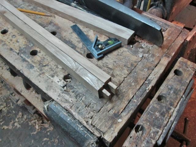

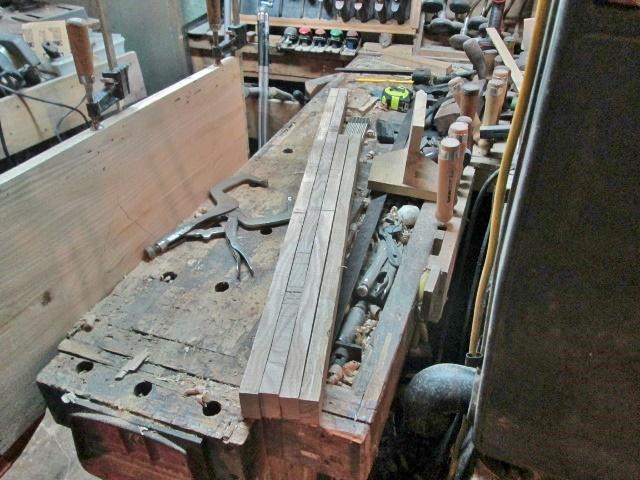

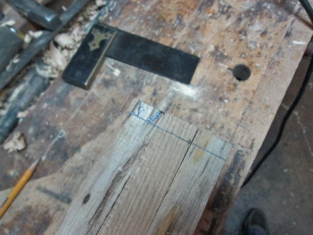

And then the shorter rails....Then did a bit of  lay out work, to find out about cutting these...

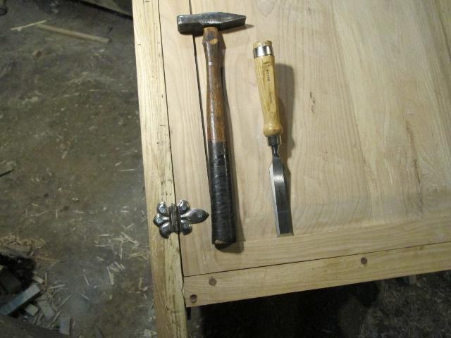

Rails were 3/4" too long.  Then marked for the tenons,   trimmed down a bit.   Got out the mortise jig, and chopped four mortises
About this time, that hammer thought my thumb was the top of a chisel...
Ring finger picked a splinter up, under the finger nail...legs were cramping....lovely day..

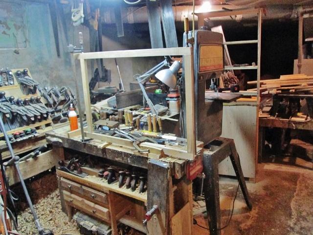

Got all the mortises done, somehow....and spread some glue around ( including all over my fingers..) and added a couple clamps..

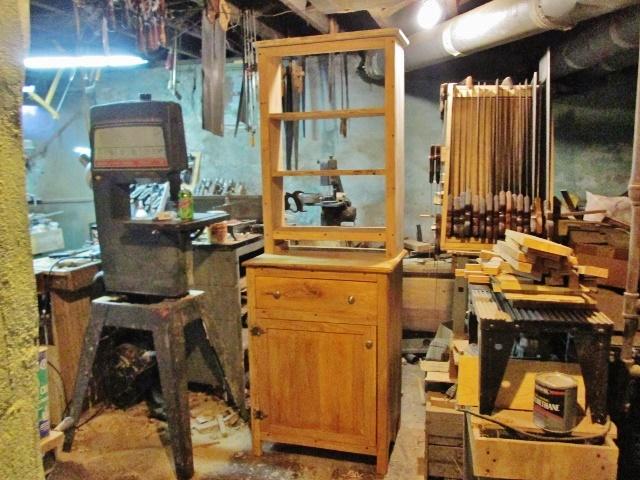

Decided to stop for the day.  IF you look in the background of the last picture..you will get an idea just how tall this thing is...
Maybe, if things  turn out better...I can get the face frame installed, and maybe the top?    Top may need trimmed for width...might try tomorrow afternoon?

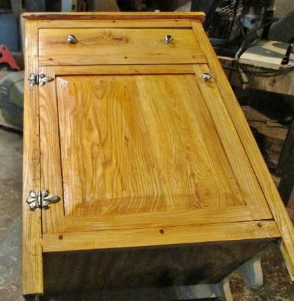

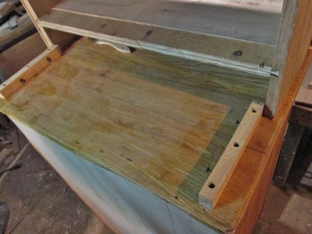

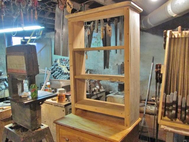

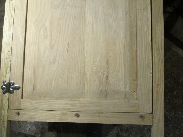

Hmmm.....Had to add a thin strip to the outside edges of the face frame.....Top is out of the clamps, edge details added, counter-bored holes drilled.
Face frame was also drilled, and counter-bored.....then installed along with the top...
Added a couple cleats....
Then attached the bookcase to the cleats..
Still need a plywood back made.   Turn this tall drink of water around for a PIP..
Need to start working on a door for the Bookcase part.   Going to be a tall one...Stay tuned
