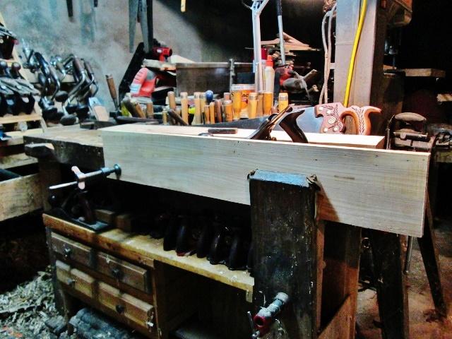

First up, a 3/16" tongue cutter.   Wanted a tongue to align the glue joint for the face frame.
The chest of drawers that holds all the "extra" chisels?   It sticks out just enough..
Makes a nice place to rest a panel on, while I plane it.   Got the front edge of both panels done.....had to rest the Stanley 45...
