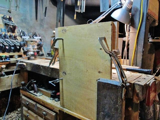

Place it to where the bow comes out at the ends, clamp in the leg vise, and to the side of the bench.  The other two clamps..
To pull the top edge straight, besides, I needed something extra for this "fat-arsed" thing to slide on..
Set up to make a cut like this..
Reset this a few times, two cuts on each end, on two shelves= 8 cuts.   Cussing was in full gear...Used a shoulder plane to "fine tune"  the cuts.

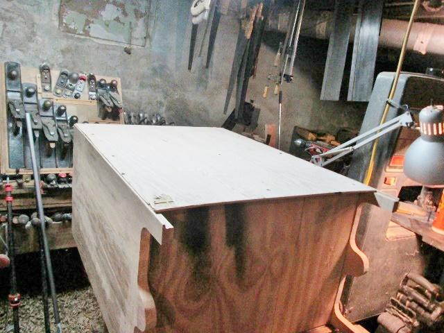

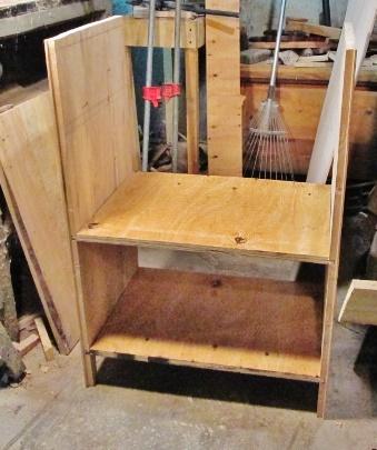

No glue was needed.   This is the back of the case.   Need to cut a 1/4" plywood panel to close this back off.
Details?
Figure between the back panel, and the face frame, these two won't be going anywhere.

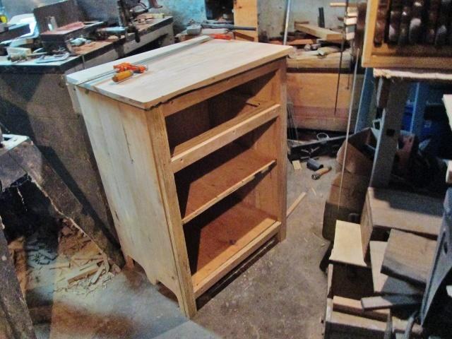

Laid the blank for the top of the case  onto this mess...

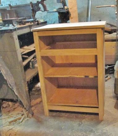

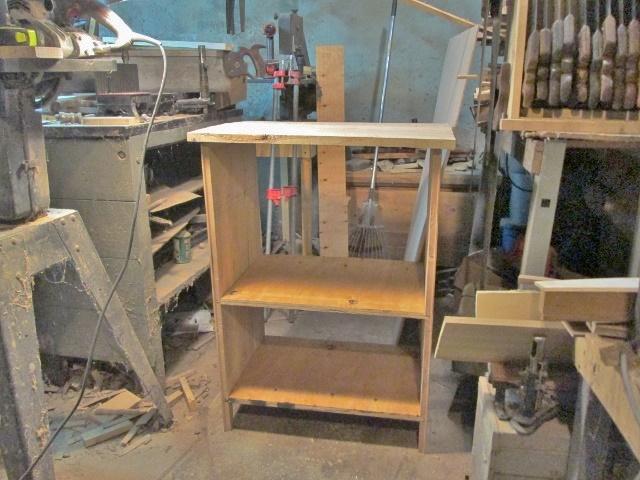

this stands just under 36" tall, case is 24" wide.    With the face frame on the front, it will be almost 18" deep.  Top will add some  more to the width and depth.   need to make two webframes..tomorrow.   Then, see about ripping stock to make the face frame.   Maybe by next week, I can do a drawer and a door.
Once this "base unit" is done and out of the shop.....I can start on the upper unit...Stay tuned...

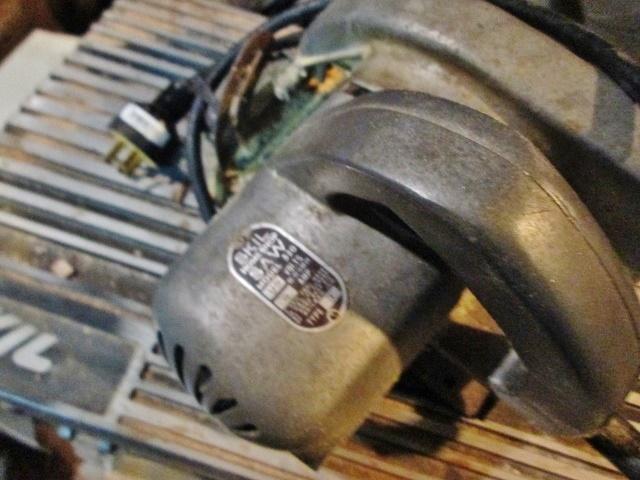

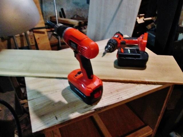

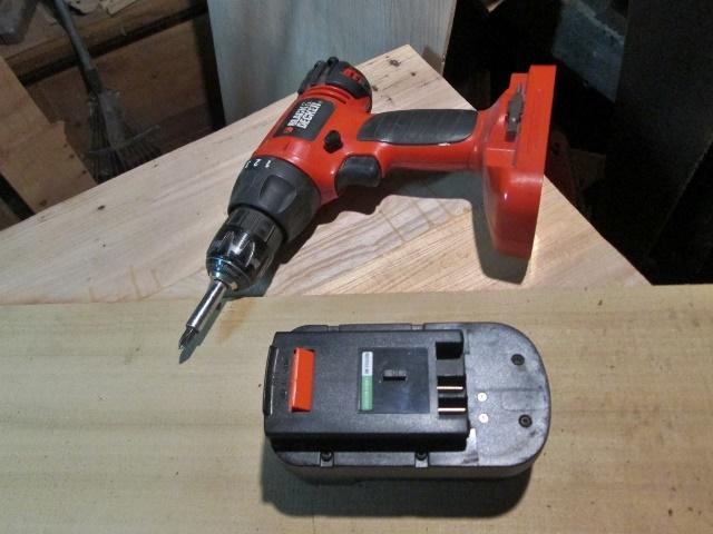

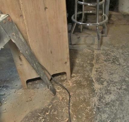

Started to haul stuff to the shop this morning....had a problem....the drill I have been using, the battery died.   Brought both chargers to the shop...and tossed one into the trash can.   Soo.
Luckily, the other charger does it's job.    Leaves me without this drill, though.   There IS a spare in the shop..
But, I can't get there, from here.....soo..

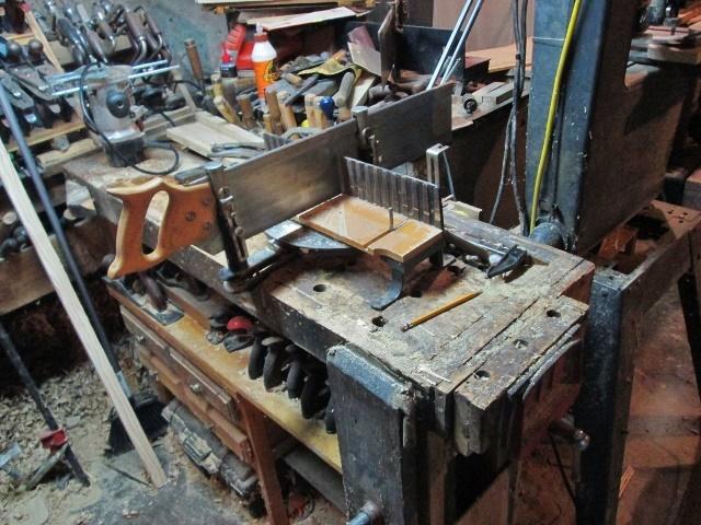

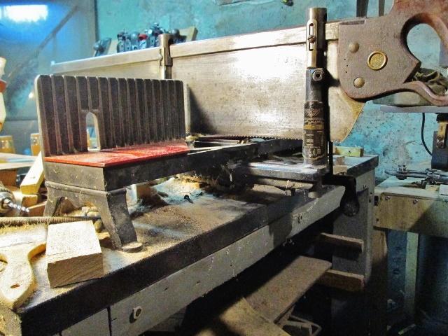

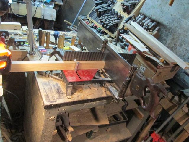

I had to haul #3 down to the shop.....I also set up my "Sliding Mitresaw"
You were expecting something with a cord.   That 1 x 2 leaning over there?   Needed to cut it down to make a few parts.   Two webframes.

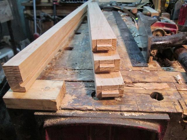

Got the long parts all cut to length.   Then cut the shorter ones.    Then figured out what size tenons to make..

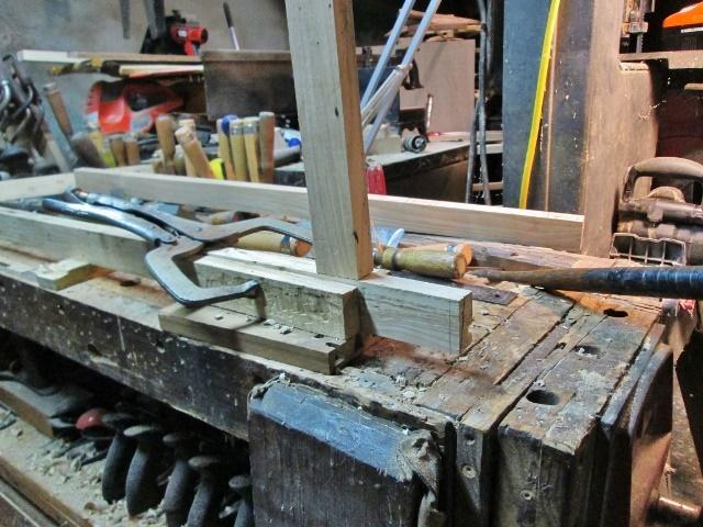

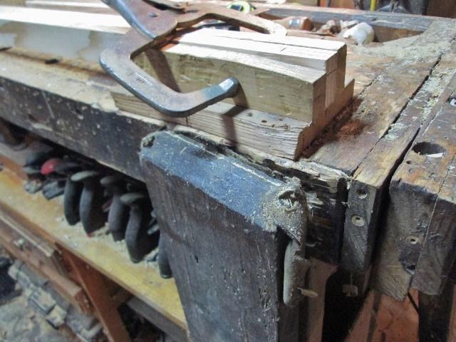

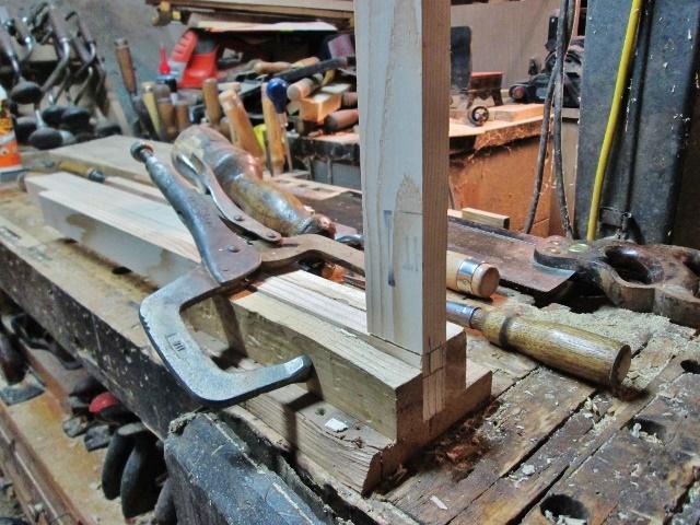

These go on the ends.  Have the tenons made, need to chop a few mortises.   Dug up an old jig..
I fasten this to the bench, so I can clamp a part into the jig..
I use the tenon to mark out a mortise.   Backsaw at an angle, then a mortise chisel to pop the waste out...test fit each one...
Three more to do.   Then a bit of assembly work.   glue on the tenons, use a clamp to pull things together, add a couple small nails to hold until the glue dries.....the add a kicker..
Just needs to be close to center, and close to square.   All it is there for, is to keep the drawer from tipping down, when you pull it out.

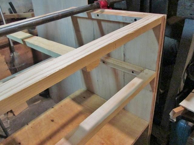

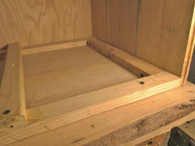

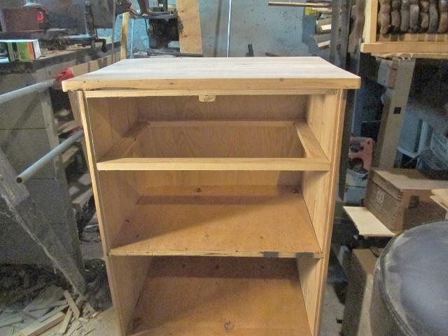

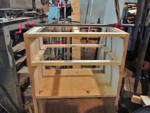

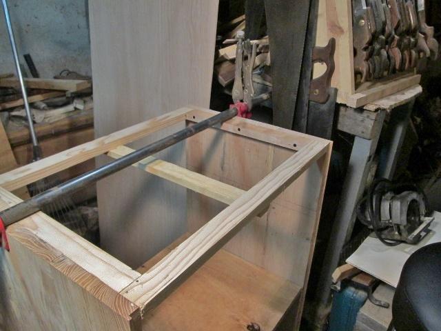

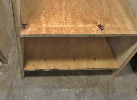

Decided to install this in the case....
Which  meant I needed to drill some pilot holes ( oversized ones) to use the #6 x 2" screws.   A blob of glue is in the middle.   None on the ends.   Clamp to help hold things while I used the driver to drive 6 screws.   Frame is flush with the top edge.    I will also be attaching the case's top to this frame.
So, this is where I am at...besides at Lunch.   Need to build the other webframe.   Need it or the drawer to slide on.

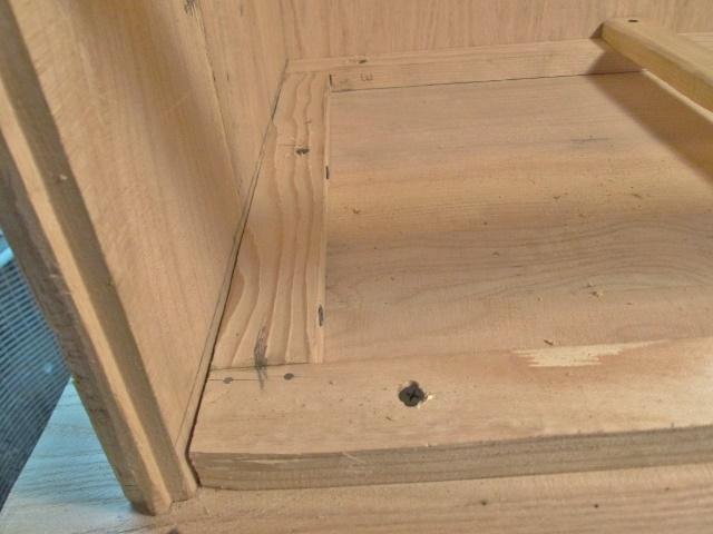

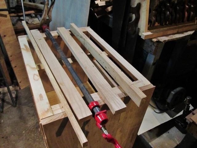

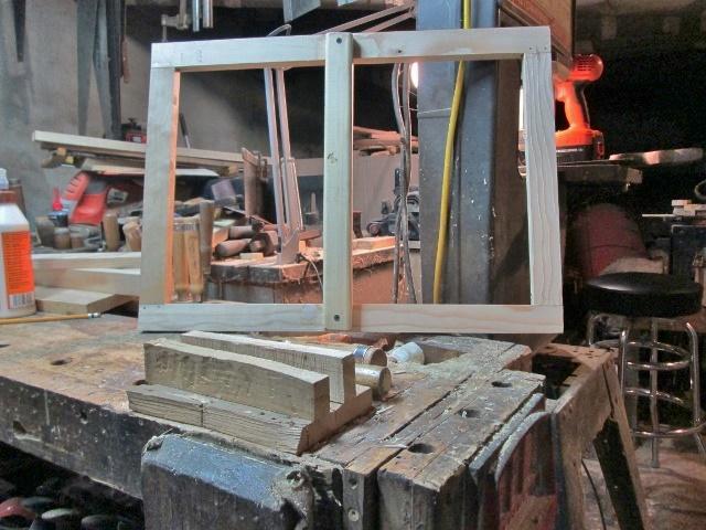

Was quite a busy day, yesterday.    Second frame is also completed, and installed..
This will let the drawer slide in and out.   Details?
I didn't add any glue to the center of the frame.  Each screw is about in the center of each board in the glued-up side panels.

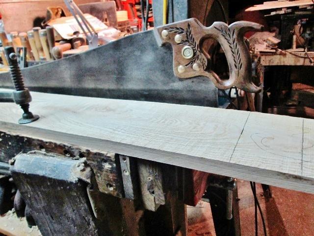

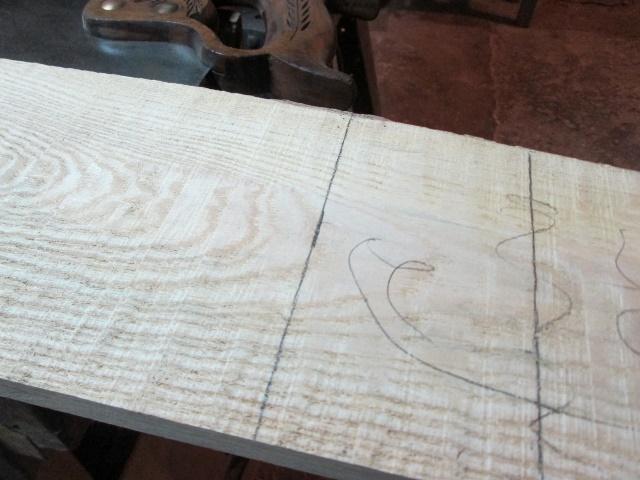

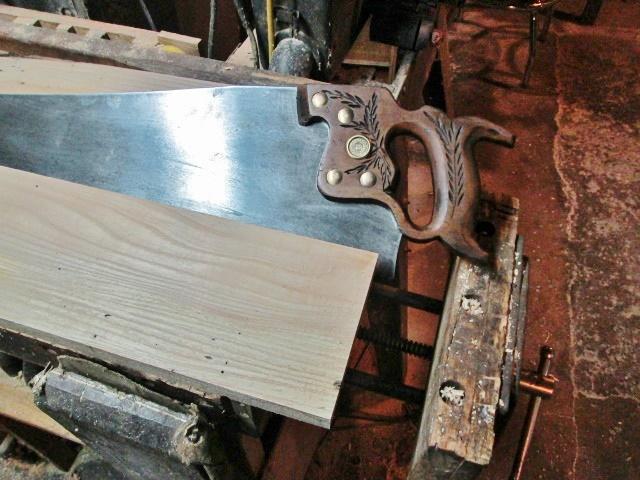

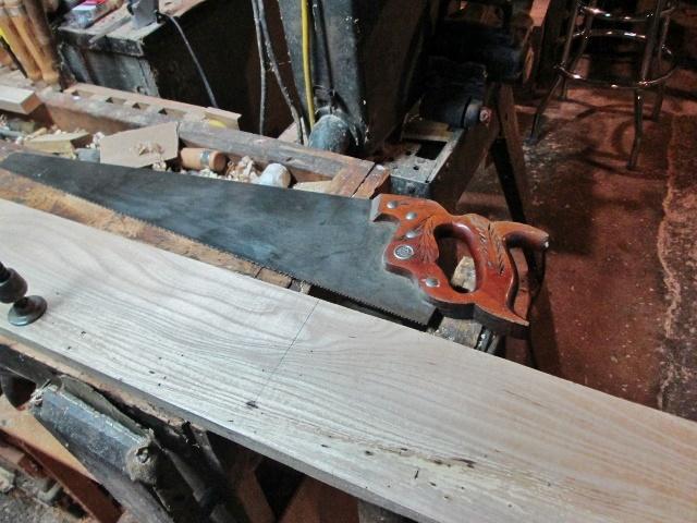

Now the "fun" part of the day.....I also hauled a plank of Ash to the shop.....marked out what I needed to cut for the stiles of the face frame..

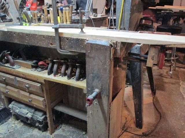

And clamped it to the top of the bench...
I run the vise all the way out, to act as a support for the cut-offs.   I WAS going to use the Disston D-23

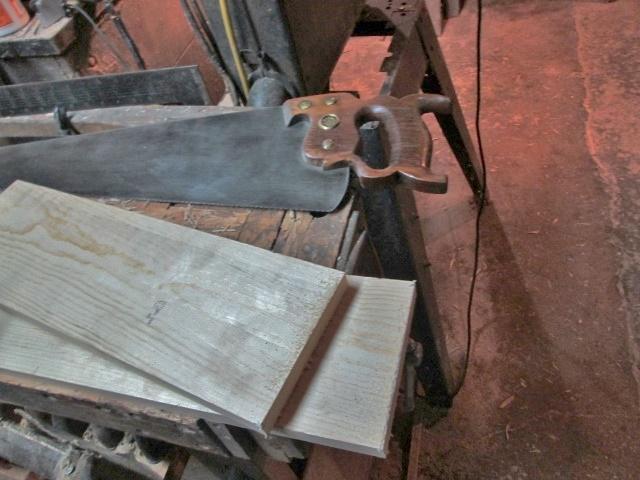

Only to find out, that the "set" of the teeth was also..gone....we have ways...
Cuts like butter.  Disston D-112.  Cuts nice and straight.   Never got close to the metal rods underneath, BTW.

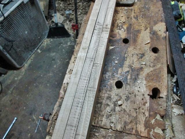

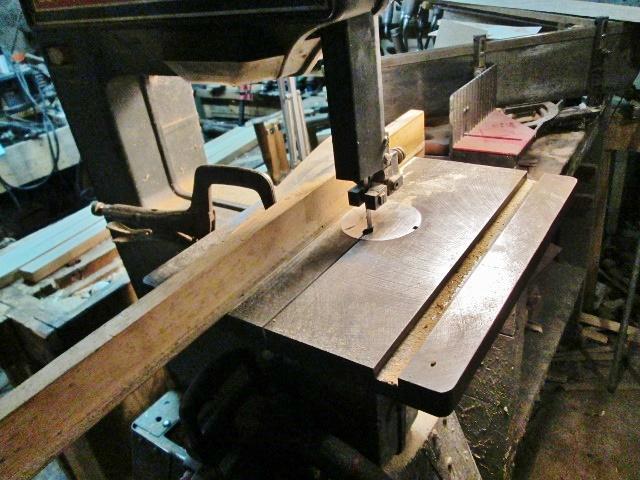

Had one blank @ 35" long, and a shorter blank.   Set up the bandsaw to make rip cuts @ 1-1/2" wide

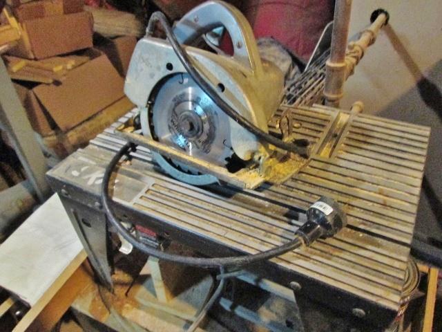

Yep, same rip fence/router guide/circular saw guide Home-made contraption I used earlier.   Cleat against the end of the table, and a single clamp on this end.   Took a while, but...

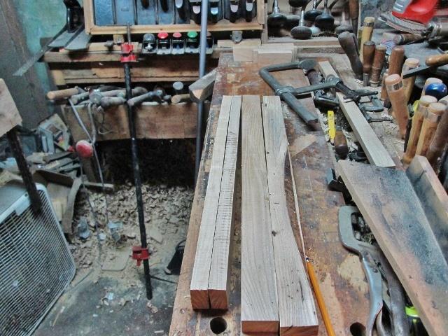

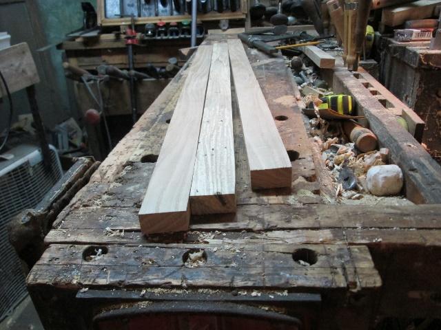

I got two decent blanks for the stiles, and a not so decent one.   Good news, the "bad" section is on the far end, where the blank makes a big curve.
While the saw was set up, I ran the shorter blank through..

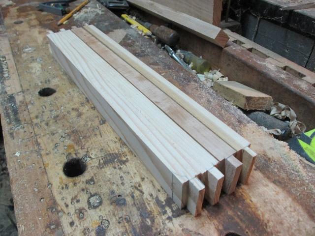

Long skinny was from the stile cuts.  I trimmed the shorter blanks into stock for the rails.....and the bad stile became a rail, too

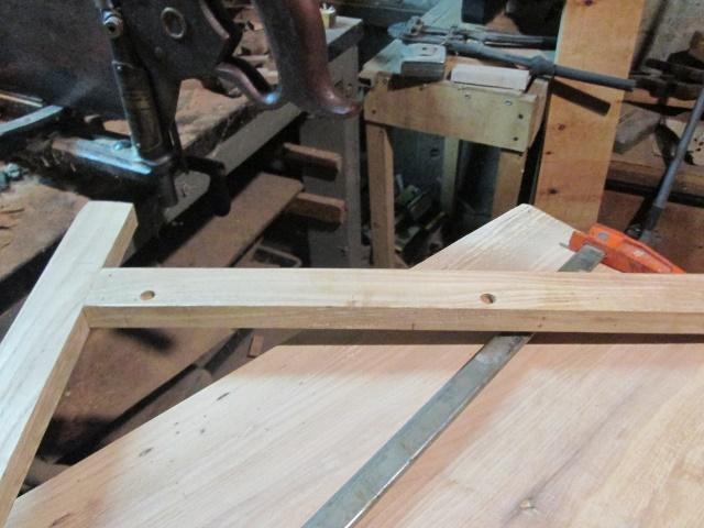

laid two on edge.   The other two are laying on the stiles.   Undecided about that "live edge", whether to add it to the bottom rail as a glue up...or, use it elsewhere.   All four are the same length, now.    I allowed for a 1/2" tenon on each end.   May get busy on that, later today.

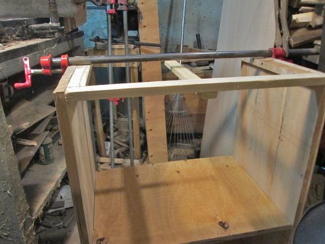

Decided to add corner blocks to the top webframe, to make things easier to attach the top.  Once the top's blank is on, and pulled flat, I can work it over a little bit better.    Trim the edges,  dress it up a bit....and flatten it up.
I think that will do for this year's work.....maybe next year, I can finish this project...stay tuned..

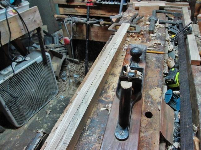

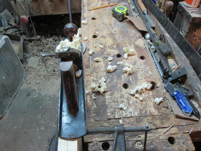

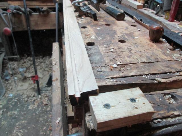

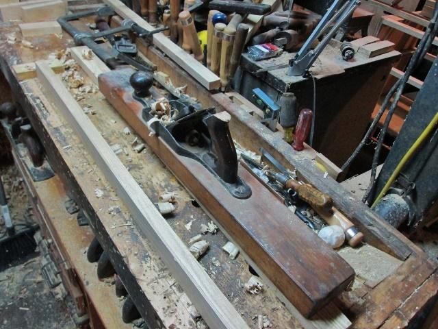

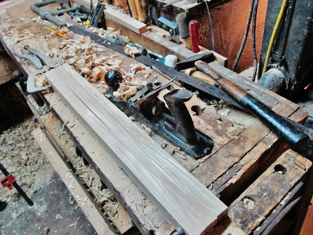

Got out a wooden handplane today..

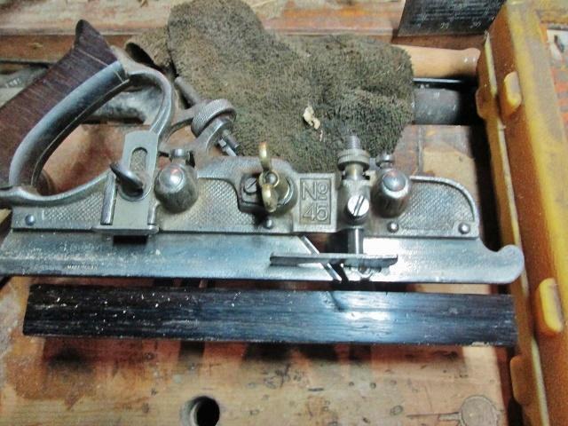

Stanley #31.....24" long, with a 2-3/8" wide iron.   Got two stiles  jointed on both edges, then ganged them up..

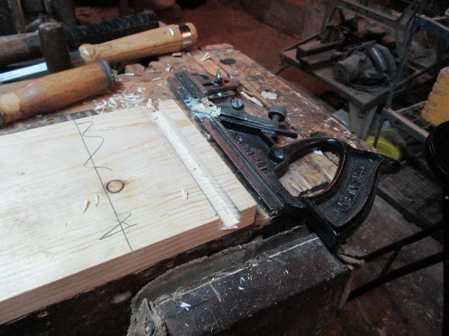

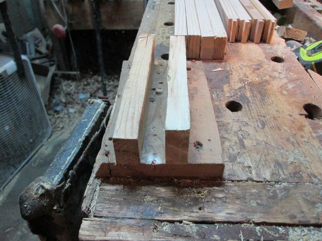

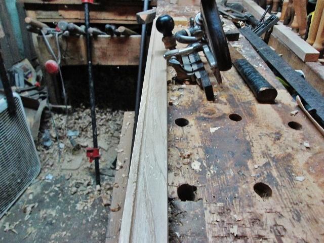

As I wanted them to match each other.   I set up the Stanley 45 to plough a couple grooves...
Feeling groovy?  ( that  reminds me, have a CD to play, Jefferson Airplane, Live at the Fillmore East, 1969)
Grooves weren'y all that deep..
But they will match the tongue I milled on the case's front edges.   Set these two aside, for now, have other items to joint..

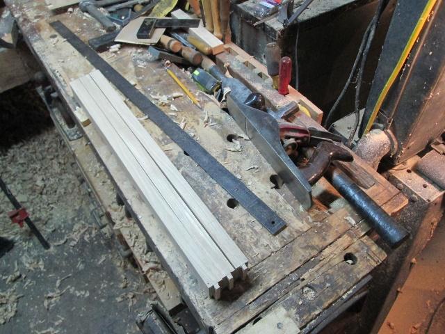

Would like to have these rails jointed, and matched up....the #31 was a bit too long, got out one about half it's size..
Millers Falls No. 11....seemed to work nice enough.   Needed to square those ends, though...
Which is something this saw does well.   I clamped the two stiles where they will be going..
So I could measure things out for tenons.....they are a bit"stubby", but...
A bit too wide.  Cut them down a bit...( less to mortise out..:rolleyes:)

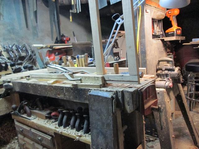

Will do a bit of trimming later.   I had to readjust the old mortise jig....stiles were 1/8" thicker than the webframe part were.
Set it out, laid out for three mortises, and chopped a few holes..
One done, 5 to go...
Two done.  This is for the drawer opening.   Turn the stile end for end..
Bottom one is done.   One stile is done.    Taking a LONG break,  before I try to do the other stile....have a knuckle leaving fresh DNA on a few spots..

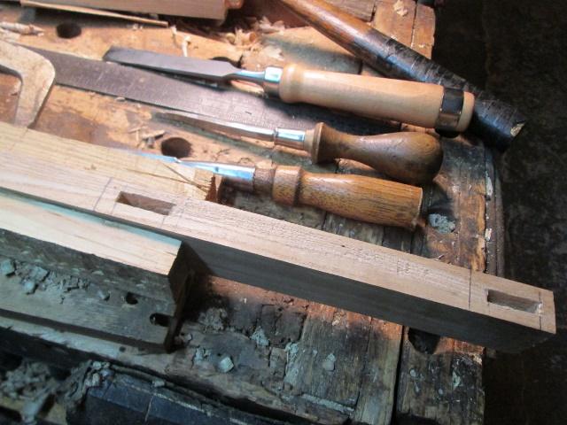

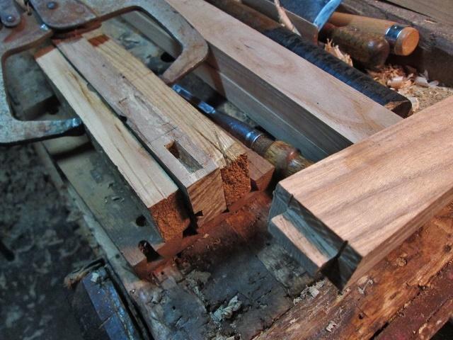

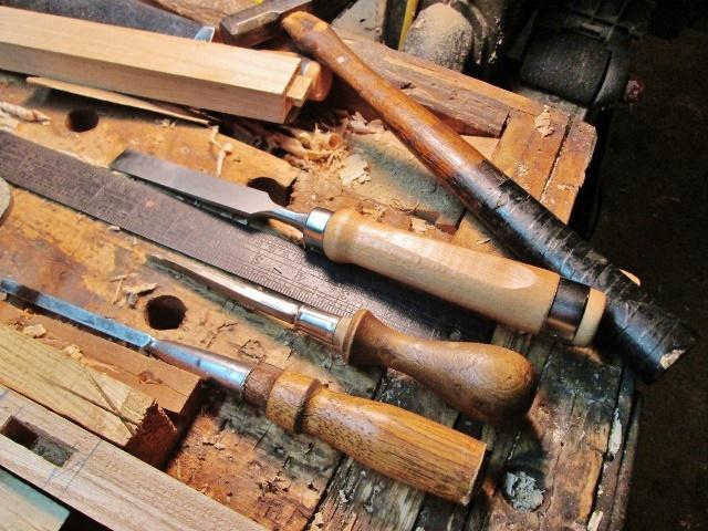

Got out some toys..
Fancy handled one, is to clean out the bottoms of the mortises.  Had three to do..

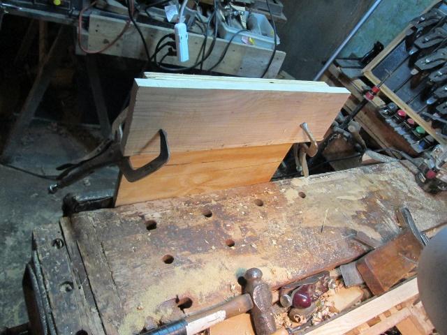

Two down.  got the last one done..then the fight started...:angry:and the cussing...trying to glue and clamp this thing...
Started with that bottom clamp....it was vertical out over the end of the bench...then tried to rotate things around, to add the other clamps, must have picked them rails up off the floor a couple times.  Finally was able to set this "thing" aside....clear the bench.  Next, I marked and cut that 1/4" plywood panel.   needed to make sure there was enough for the drawer's bottom.   Then trimmed the remainder to fit the back of the case...needed to haul that to the bench, first...:unsure:
One of the plywood shelves was a bit too big, stuck out the back....fixed that.  Got the glue, got some screws, and some nails..

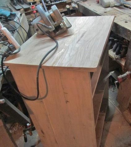

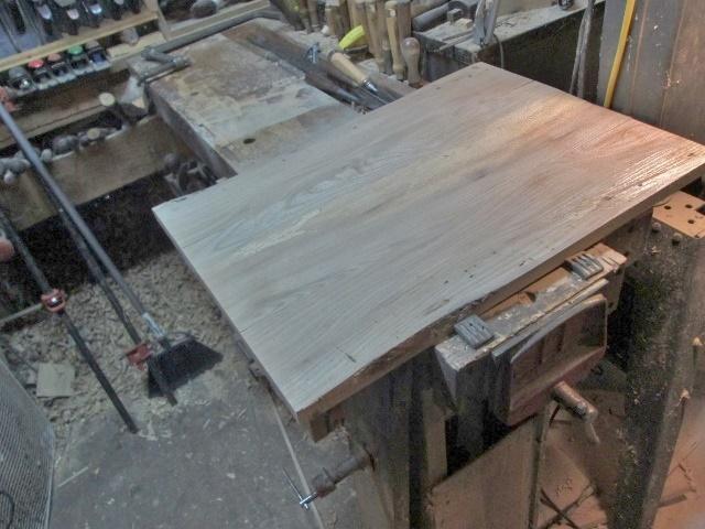

Then had to take this thing back to the floor, and out of my way....had a top panel to work on, as soon as I could dig it out....:rolleyes:

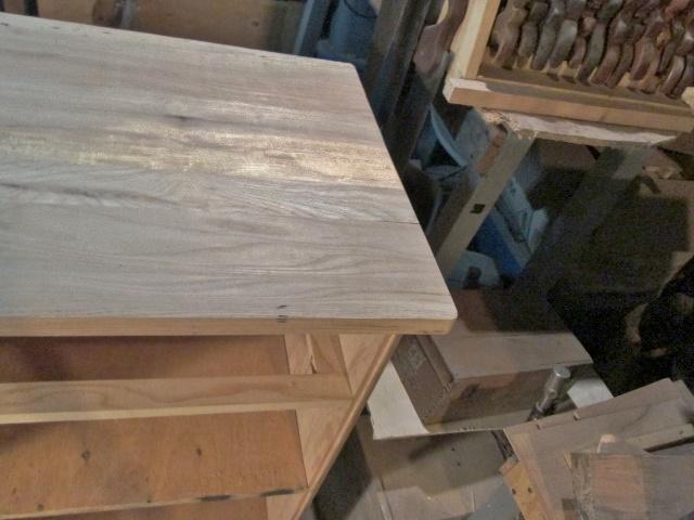

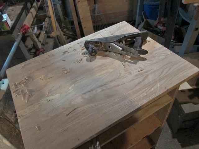

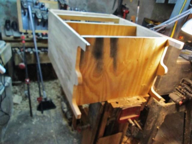

This is the underside.   Flattened it down close to flat.   Live edges will be going away.... Made sure the left edge WAS straight, and square to the "back" edge.  Top webframe was drilled for screws to mount the top to the case.   Along each side of the case, there is a center screw hole, with slotted ones front and rear.   Fun part was getting the case back onto the bench, and "centered " on the top.   I used the left side, and the rear edge to align things up.  Used a scrap of Ash to set the distance between the edge and the side .  Screws were 1/8" too long..grinder to shorten each one...
Something like this.   Center screw won't need to move, the front and back ones will.   That is why the slots.   Another look?
Thing to the left is the kicker for the drawer.   Set a combo square to cut the right edge and the front edge down to size..
Made sure they were square to the other edges.  Traced a line, and the saw did it's job.    Beltsander to round the front corners.   I also worked on the top of the top...trying to get it close to flat....then, set this out of the way..

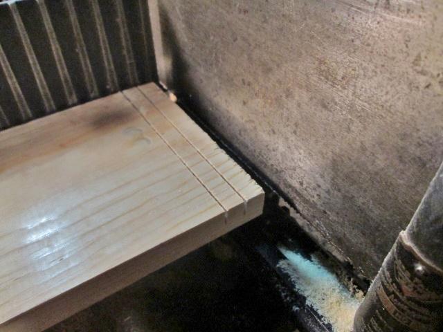

There is an area right behind the front roller on the sander, and the platten.   Makes a nice, round profile.

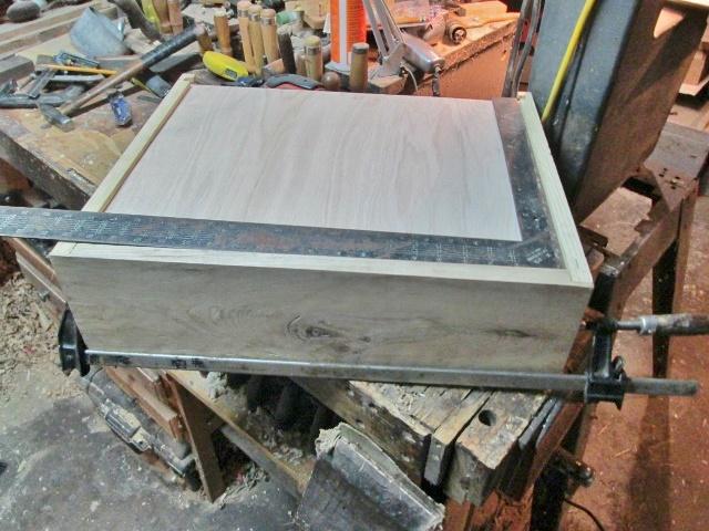

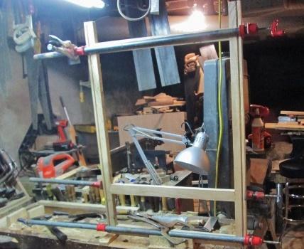

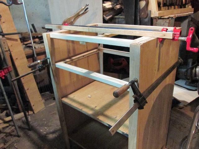

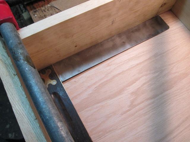

The Good News for today?  Well I got this frame out of the clamps....and...

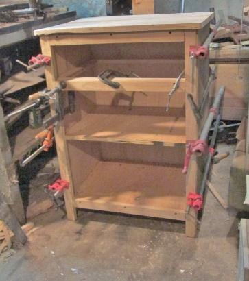

It didn't blow up, or fly apart.   It is off by a 1/16"   in width, clamps should fix that.   Tested the blank for the drawer, that I WAS going to use....not.
Up & Down it was a bit too tight...side to side it was way too short.    It will NOW be a raised panel in one of the doors.
had to break up a cat fight....got a couple holes in my hand...old Tom got a size 11 shoe up his rearend, on the way out the door.  There are a couple garages nearby, that he also stays in.....until he learns his "manners"....
Might need a few extra hands, this week, when I glue the face frame in place....going to take about every clamp I have in the shop....and enough cussing to make R. Lee Ermy ...blush....stay tuned

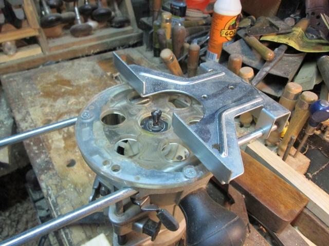

OK...decided that I could install the next wider cutter in the Stanley #45 ( from a #12 to a #13) and cutter the grooves a tad wider towards the outside edges of the frame.   Changing the cutter was the easy part....widening the groove was a PITA.   Let alone clamping the frame to the bench's top...
Dug around, found one of only two Veritas tools in the entire shop....a 3/8", tapered, plug cutter.    Then had to dig around and find the set of Forstner bits...and hope the 3/8" one was in there...( it was :))  then figure out HOW to hold the frame AND operate the drill press to counter-bore 9 holes....

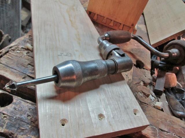

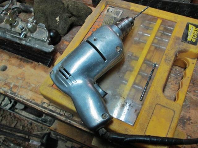

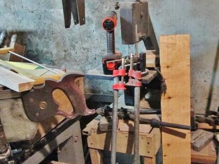

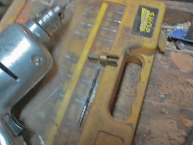

Batteries on the cordless drills were needing charged up.   Got out a vintage drill....a Ward's Powr Kraft 3/8", keyed chuck, corded drill...all metal,too.
It even had a drill bit in the chuck, and was ready to drill 9 pilot holes.   Was a lot easier than using the drill press, BTW.    Got some clamps laid out, glue bottle is ready, box of screws handy....all set for the morning's follies:rolleyes:   Should be an entertaining time....:angry:
Film when it all happens......names will be changed, to protect the guilty:ph34r:  Stay tuned..:)
Pictures....anyone?
All reset.  Now, about that drill..

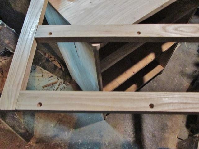

Bit is for pilot holes, but the drill already had one in the chuck...
And the Veritas plug cutter...yellow box is my Forstner bit set....
Drilled 3 holes per rail,  Including ..
The three down at the bottom rail.  Had to lift the frame up over the drill press, to reach these.   And operate the drill press, too...

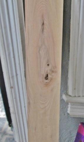

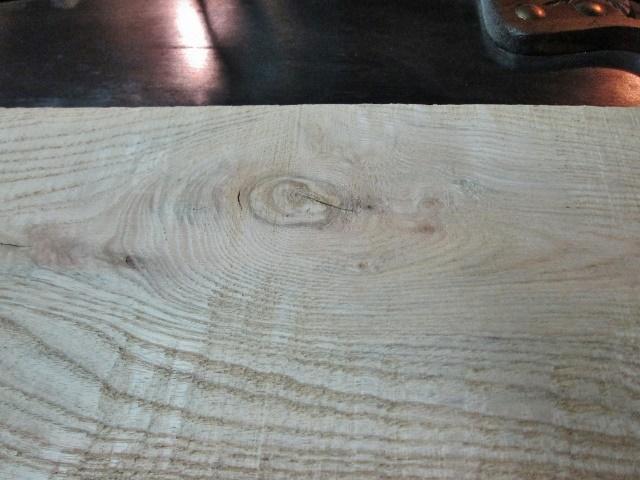

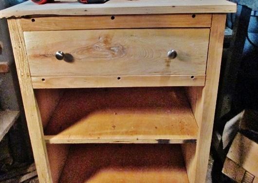

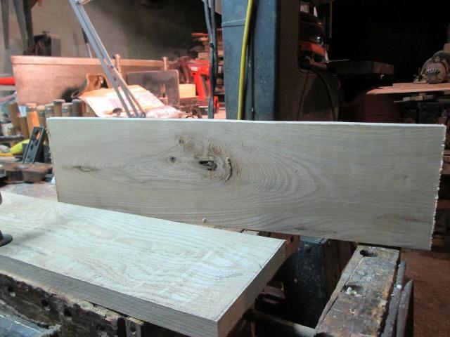

Hmmm...while getting ready to meander  to the shop....got to looking at a plank....decided it MIGHT make an interesting drawer front..
Boss says it adds "Character", maybe if I can center that knot....other side was a bit plain..
Ummm, it was merely skip planed.  I can see why.    Only need 21" for the drawer front, maybe I can avoid the bad parts..
Ummm, yeah,  we'll see.   Got the rest of the supplies to haul to the shop, might as well get it over with..installed.jpg.aa43e1ad80922a5befcf402a7a06c5df.jpg

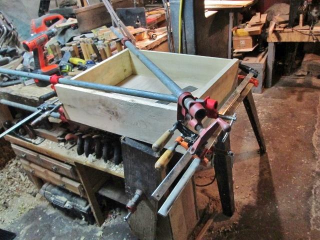

Lots of glue, 9 screws and even more clamps....and a bit of cussing......big box end wrench and a large phillips screwdriver to help turn a few cranks
Well...this bay in the shop is done, for the day.   Will let this sit a day, or two.    Need to add a couple drawer guide strips, to keep the drawer where it is suppose to go.   Glue and a couple nails to install.   LATER.

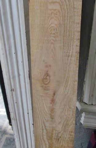

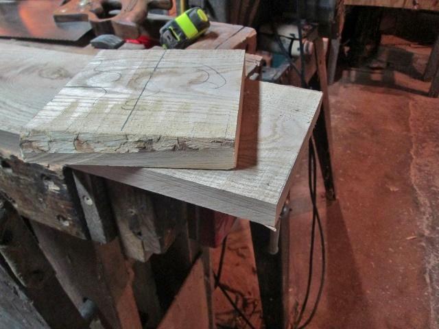

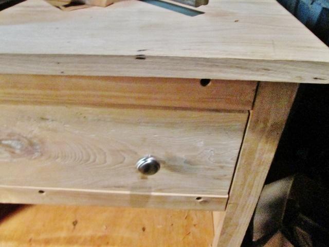

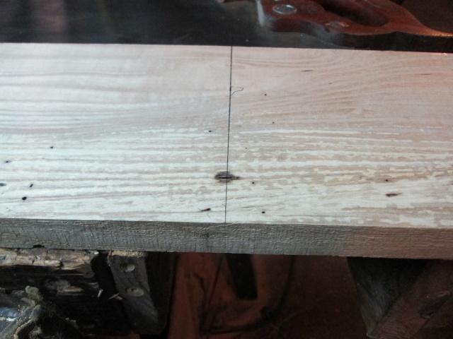

Hauled that drawer front plank to the shop.....one end had a split.   marked a line to get rid of it....checked where the knot was...needed to move the line a bit further in...
As for down at the far end...
This was causing more curves than a Pin-up Girl ....Might get rid of it as well.   Board was a bit long for where the Langdon could be used...couldn't get to it, anyway.    Decided to use the old school way..
Disston D-112.    Seemed to do the job..need a better operator, though..:rolleyes:
Still, wasn't too hateful a cut.   Moved things down about 21" or so, made another cut..
Drawer front?   Maybe a two knob drawer? :unsure:....Cleaned up the ends, and checked for square..

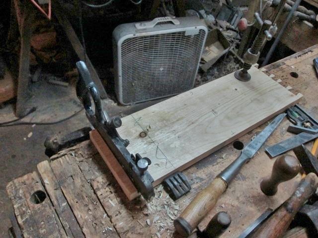

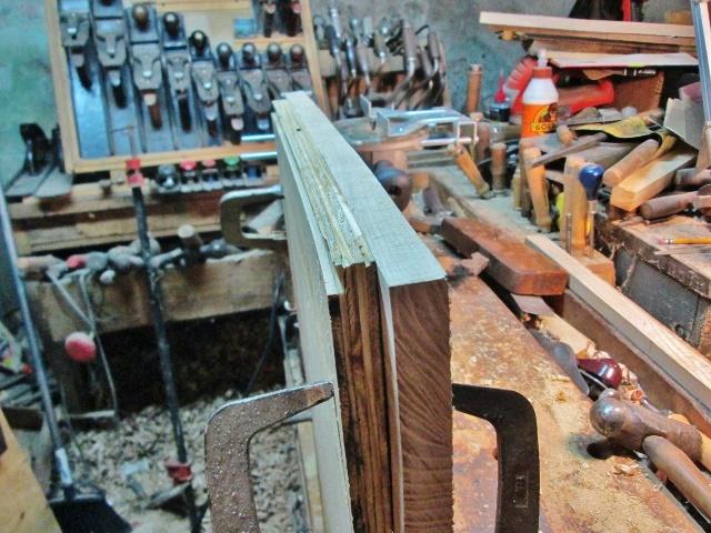

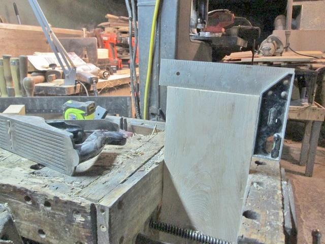

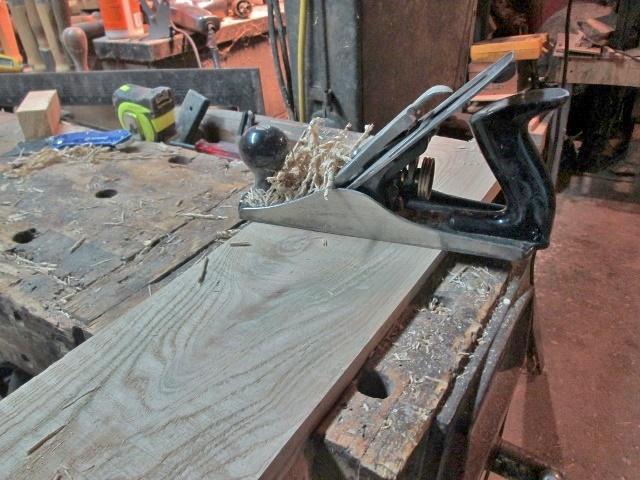

Old No. 4....."Good side" was bowed up in the middle, "inside" was on the top & bottom edges.    I also filled the nasty knot with a bit of glue, and some sanding dust.   Back was starting to act up, again....time to call it a day.
Maybe tomorrow, I can start on building a drawer?   Have a 1 x 6 x 6'  for the drawer sides, and some 1/2 " Poplar for the back of the drawer.
Stay tuned...

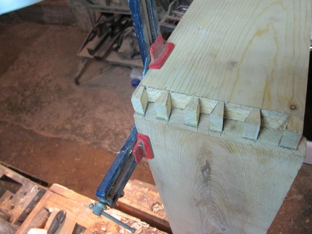

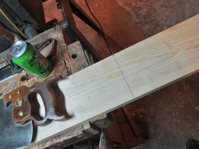

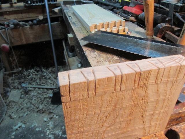

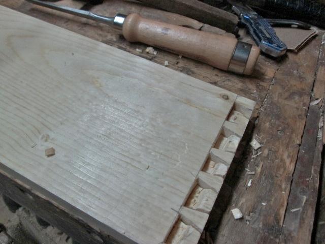

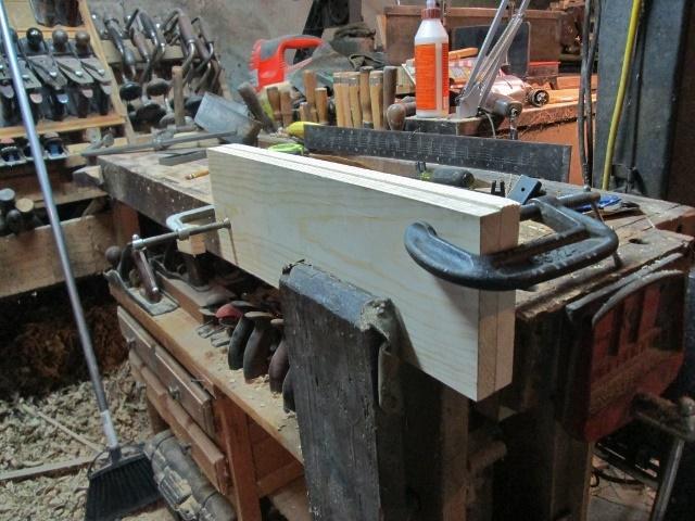

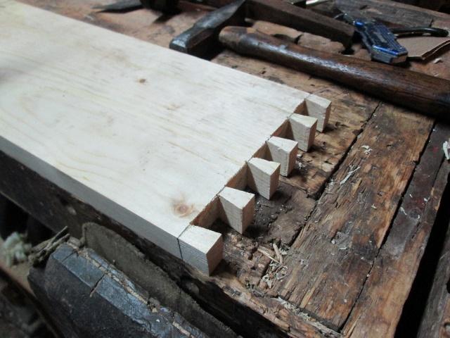

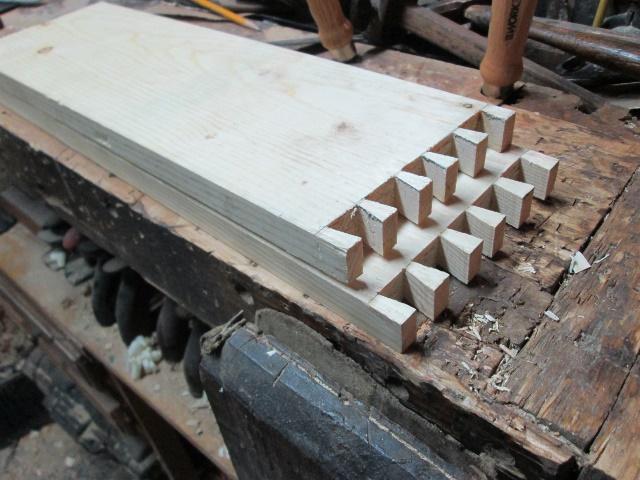

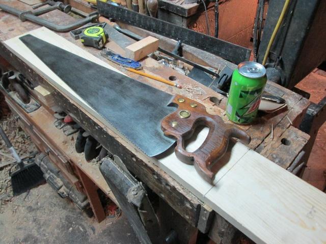

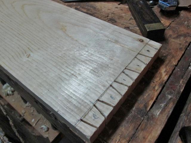

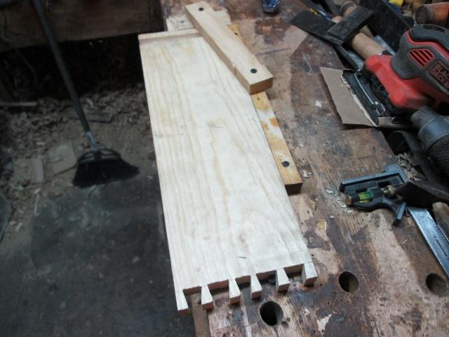

Ok, here we go.. Hauled the Pine plank to the shop....set up to cut a pair of drawer sides....had all the useful tools handy..:unsure:
Clamp, squares, knife for a knifewall pencil. a handsaw...and a green can....marked a line to saw..
There is a "dog" behind the edge of the board.  Big clamp to hold things still, rubbed the toothline with a candle...
Cuts like butter.  Disston No. 7, 10ppi.  Cut two sides...had to use the mitre box to trim one end square, and matched for length to the other..now, being from the same board, you'd have thought these would be the same width?    Nope.   Ganged them up, and into the vise...
See the difference?    Got out the Millers Falls No.14 Jack plane.    Ran that until shaving were equal..
Then laid one aside, and laid out a few cut lines on the other..

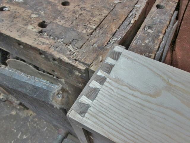

Bandsaw for this sort of thing.   Tails first?   Time for some chisel work..
Half way through, then flip over..
Then rinse and repeat..
I used a helping hand, to lay out the pins....
Sharp pencil to trace around...then some more saw work..

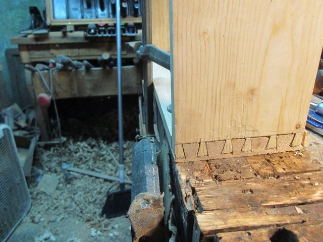

Then the chisels took over.   Soon, I was able to do a dry fit...
Yeah, yeah...a little out of practice.    Got both ends done.   Time to mill a couple dados, to house the back of the drawer...

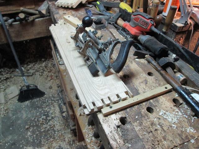

The Stanley 45 was still set up for grooves, didn't feel like changing it over, sooo..raised the depth stops on the mitre box
Marked a pair of lines on each drawer side,1/2" in and 1" in from the back edge.  Made a couple cuts..
Just needed a way to remove the waste....a big chisel to pop most of it out....
And that Stanley #39  3/8"  dado plane.    Had to adjust it's depth stop, but.
Doesn't  do too bad?   Then repeat for the second dado.....As  for the Stanley 45....it had work to do,,, once I got a jig set up...
Then run the 45 until the depth stops hit the pine.  Then readjust the jig. and plough the front...

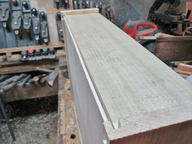

Then a dry fit, to size the plywood panel for the drawer bottom, and test for fit..
Clamp to make sure the sides don't get wider than they should... with this done, I could size the back.    1/2" thick poplar plank, crosscut to length, ripped to width.   Test fitted and planed to fit
We're gaining on it.....Needed three pilot holes drilled in each dado,  as I use screws to hold the back in place,  and countersunk
Then a lot of glue got spread around and a bit of cussing, too.    Got the screws and clamps in place, but the plywood wasn't fitting just right.  Checked the diagonals,....yep box out a touch....added a diagonal clamp..
And pulled things around, until this big old square was happy, happy..
That be a 10" square.    So, now I am waiting on the glue to cure overnight....tomorrow I might get thing fine tuned to fit...

Well, guess I should meander down to the shop, today.    Remove the clamps and clean up the drawer, so it will at least fit IN the cabinet....
Thinking about a single door.    Too many problems with two skinny doors....one larger door might be better.   Will still get a raised panel, in a frame.    Need to start ripping some parts, and glue up a panel.....first need to get that drawer done...and OFF my bench:angry:
Stay tuned.....
OK, "Hide yer eyes, Mabel !"   Drawer is out of the clamps, dovetails and other things cleaned up5a5269e789a4f_cleanedup.jpg.66a84b3331f35e987723039379281e56.jpg
I guess it will  just have to do.....Handles have been installed, wood drawer guides installed, test for fit..
 Kind of plain handles..
Need to plug those holes.....might just use the Ash scraps.....Not sure IF there is enough Walnut...
Next up?    Build a door....
