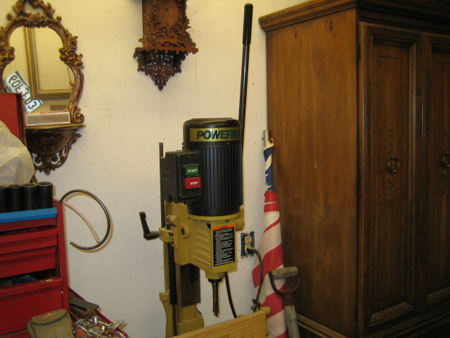

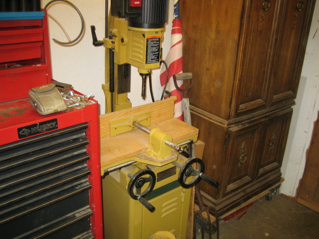

If you guys are talking about a mortising attachment for a drill press like one that is on a real floor model mortising machine, a square chisel around a drill bit,,,,,Then you will need a long cheater pipe on the drill press handle.. I have a Powermatic floor model. The handle is 25"long and you need ever inch of it when using hardwood even with new bit sets.  So I'm not sure if the guys recommending the drill press setup have ever used one?? I would not recommend one.  The right router set up would be my suggestion next to the real thing.
 I don't usually enter into discussions on the best of things but not happy with the suggestions.
PicturesIMG_9346.JPG.4167b659c155037df0e848fcab658f0c.JPGIMG_9345.JPG.8ef187ea2d5456b66cd8b3a1cf3c5915.JPG
  I don't have any ideal how this Powermatic is rated but it does a good job.

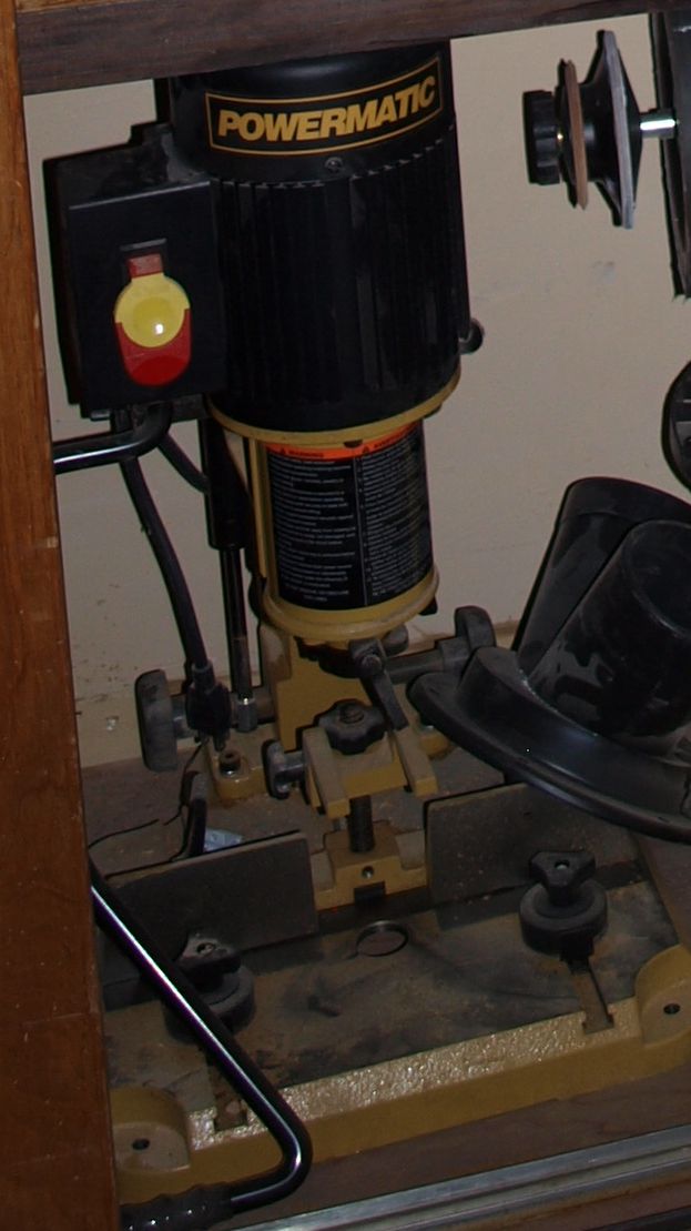

For the occasional stopped mortise or loose tenon mortise, any of the suggestions offered will get the job done. For through mortises in hard wood though, Patch's Powermatic or similar, is the way to go.
In building some Morris chairs, several through mortises in white oak were required. A Delta bench top mortiser was used. And, Patch is so right about the need for a cheater. Many times in that process, I wished I'd opted to do stopped mortises with fake tenons glued on where they were to be exposed. And, just as often I regretted not buying the Powermatic.

at least the PM mortiser chisels cover more sizes, longer depths and can be easily resharpened by the owner......
