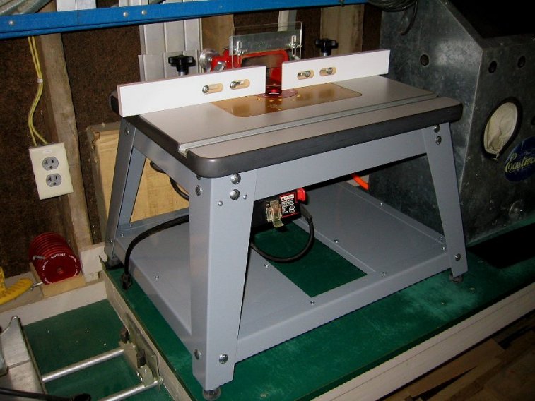

Looks good Mike. I know what your saying, but that is what came with the ShopSmith router table. I was hoping that I could just add to it to make it taller. Here is a picture of a portable router table that I put together a few years ago, and is in my main shop. The stand and top I built, then added a Freud fence, Woodpeckers plate and ring set.

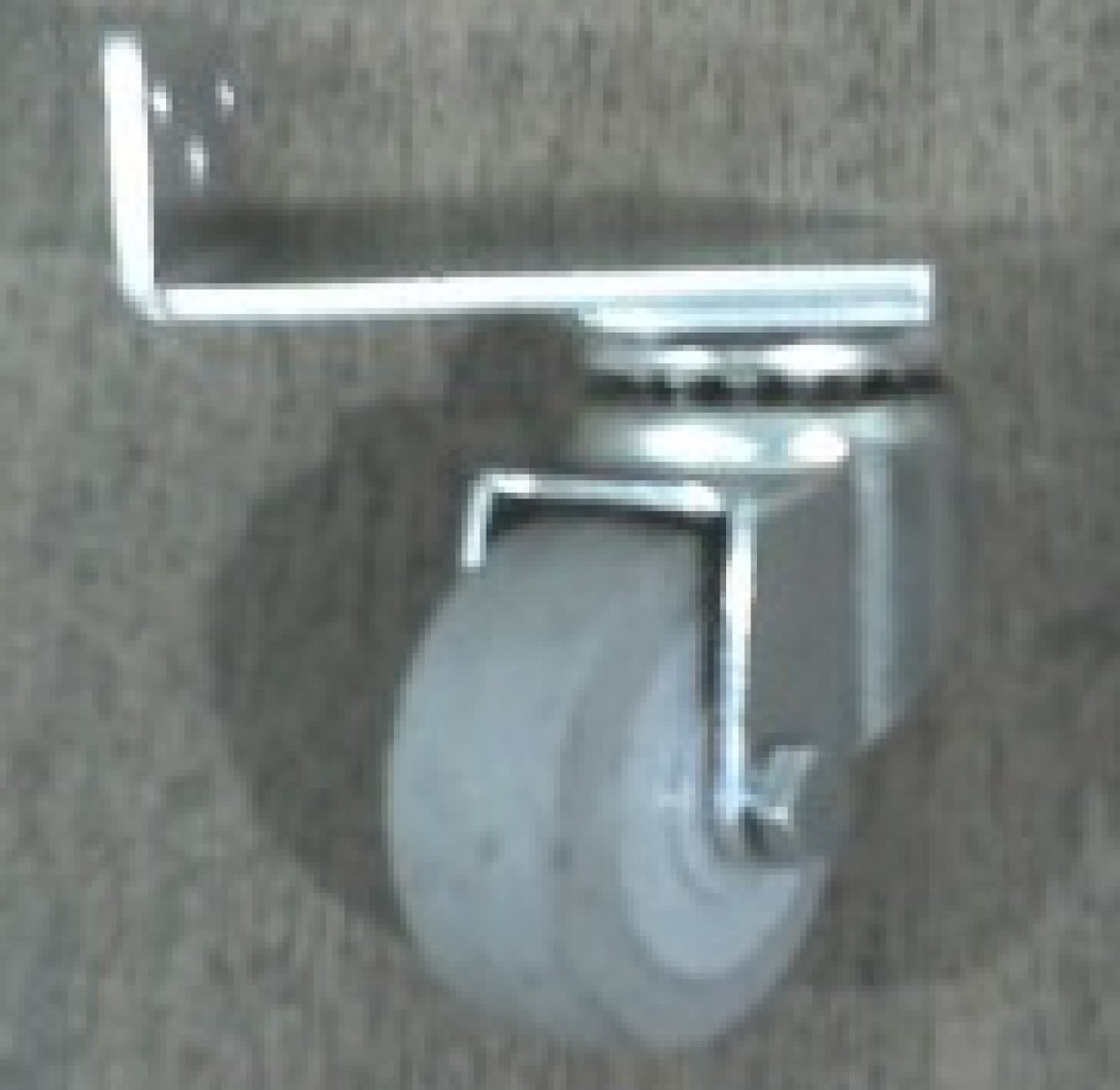

who says you have to have the casters under the table...
put them on brackets (add a gusset if need be) as outriggers part way up the stand's legs and make them long enough that the swivel casters operate freely...
or mount them to to an internal self inside of the legs...
 Stick, thats not a bad idea. Here is a quick sketch of how I would try your suggestion. fixed casters on the back two, and two swivel locking casters in the front. I will definitely consider it. Thanks.
Edited by CharlieL
2 hours ago, CharlieL said:
 Stick, thats not a bad idea. Here is a quick sketch of how I would try your suggestion. I will definitely consider it. Thanks.
use angle iron...

This morning I finished mounting two shelves to the stand. I did not put a finish on them because I figure that they would just get scratched up in time. Someday I may add a rubber mat to the tops of them. Next is to try to refurbish the router table top surface.
Edited by CharlieL

Done for now, relaminated top, and added some height to the fence. A mobile base will have to wait.
Edited by CharlieL
That look great Charlie!
Great job Charlie and great find. Next is finding a dedicated router for it (or two)?:P
