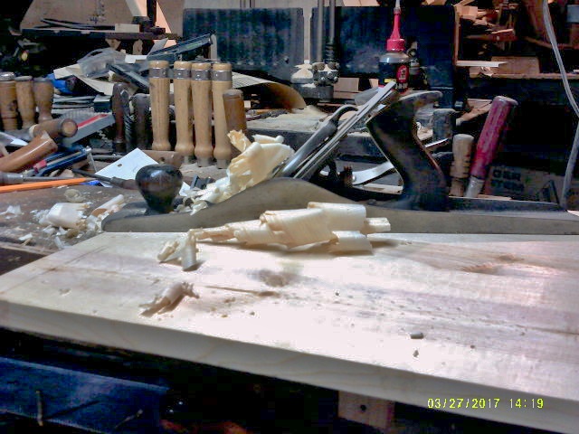

Laid the three out, only needed 17" in width.....so I resawed the third board into a narrower strip, or three....Needed to joint the edges..
Made a lot of fancy curlies..
Did both edges on the narrow board, and then..

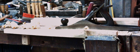

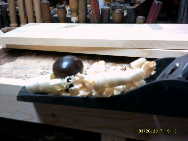

Might as well do the wider boards, too.     Jointer is an Ohio Tool Co.  No. 0-7...same as a Stanley #7

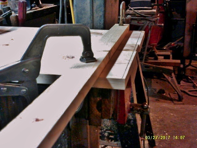

Top is out of the clamps, needed to trim the end square.   Drew a line where the saw needed to go, set up a guide bar
Distance from the guide to the cut line, was the same as from the saw blade to the edge of the saw's foot plate.  Ran the saw along the guide bar
Looks straight to me...repeat for the other end....less wood to plane, this way

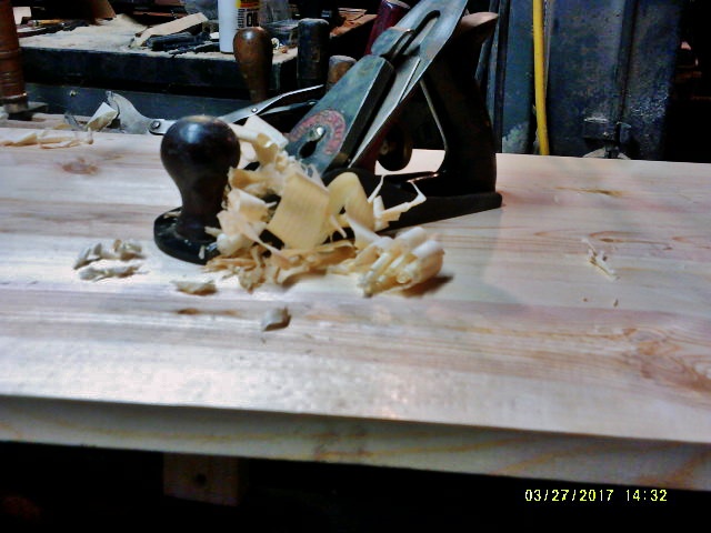

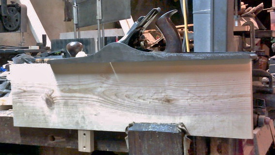

Slowly got down the #6c plane, to level the top, on both faces,  needed a bit of fine tuning...
Detail work with the smoother plane.   Set the top aside until needed again...we have legs to make..

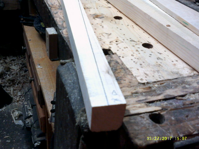

Well, it made a nice straightedge to draw a line with.  I marked a line, below all the knots at the top of the blanks.    Down at the other end, I marked a 3/4" mark.   Connected the dots..
Ok, the "top" is in the leg vise, and a block holds the "foot"  up in the air.    A cambered jack plane to hog most of the waste off,  starting at the foot, and working back towards the top.  Layout line is on the other side, sorry    Got as close to that line as I could, then went with a long plane to finish it up..

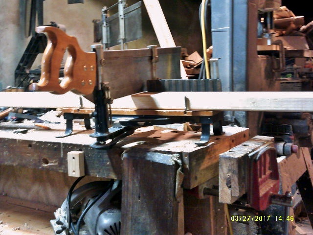

Made use of that #358 Mitre Box, to cut the three aprons to rough length...
Short one is a bit over 14" long, the two behind it are about 24" or so long.  I bought TWO 1 x 6 x 6'  pine boards today at Menards.   The Boss wanted to price a few things there, so I spent just over $6 for the two.

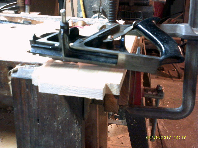

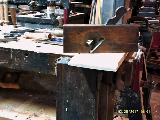

Thought I'd set up the old Wards #78  to mill the cheeks....

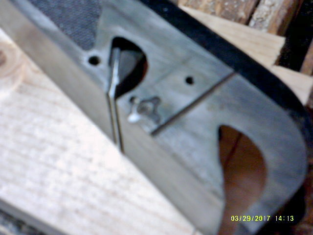

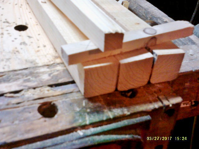

A 1 x 6 is a bit wide for a tenon, notched these in about 3/4" from each edge.   Took the trouble to 1). set the spur
Did it without losing the bolt!    2). Set the depth stop..
Tried to get it at 1/4" deep.....and set the fence..
Noticed things were "moving as I used the plane.....Grrrrr  depth stop AND the fence were moving.   Had to find a better way to do this.
Handsaw, and a chisel...worked, but needed cleaned up...

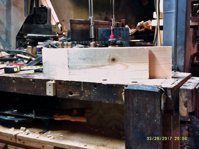

It did work, a little too well...decided to use the Stanley 358 mitre box instead.    I can set the depth stops on it,and they don't move.   A sharp paring chisel to peel the waste off...
Discovered all that,AFTER having to trash the one apron.   The shoudler plane almost peeled it all the way off... Not a biggie, trashed long apron will now be the drawer front.

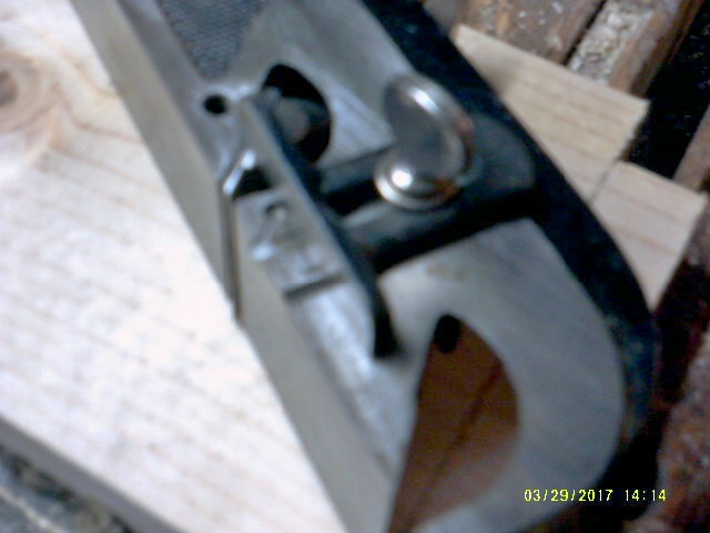

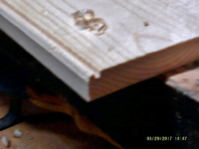

I somehow managed to get ONE plane to work the way it should...
The Stanley 45 was still set up for bead work.   I had to redo the fence, so it sat below the cutter, so I could get as close to the cutter as I could.   The idea was to add a detail to the bottom edge of the aprons..
If I can manage a way to clamp the legs, later, they will get a couple of these, too.   Plane liked to clog up, though..
after each bead was done.  Got the two long and one short aprons all milled, and tenoned.....time to chop a couple holes

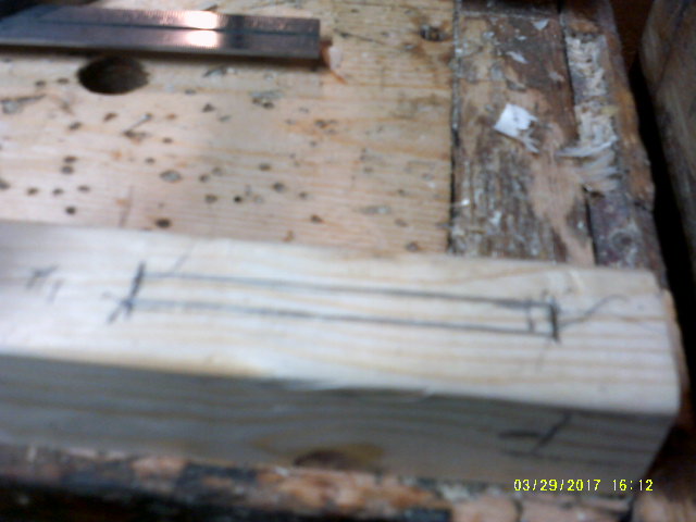

Clamped a leg to the bench, got out a few toys for digging.....used a tenon tolay out for it's new home
Since this is the "first" one,I marked the leg and the end of the apron with a #1.    Got out the shop stool, and ...
This is what I have to chop.   This one was the easy one, the next one had a BIG, hard as steel knot right about in the middle.
This was 1/4" by 3/4" deep.  Did a dry fit to see IF I was deep enough..
Not too bad.   That fancy looking tool? That be the "Gooseneck" chisel  I made a while back, to clean out the bottom of mortises...
Got the second mortise chopped, for the tenon on the other end of this apron....took a LOT of checking, to make sure I was digging in the right spot...finally, said the heck with it..
