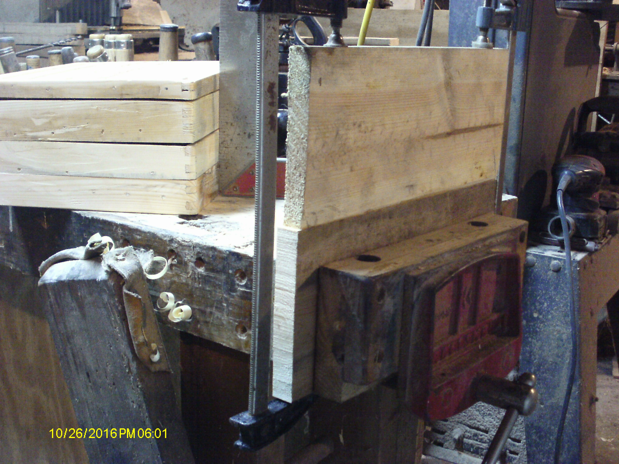

Trying to do a glue up, with  just two hands.....used the end vise to help out..
Put the bottom board in the vise, add glue, then add #2 board and clamps.     #1 board can't run away, or flip me off.     Nice to have a helper in the shop.

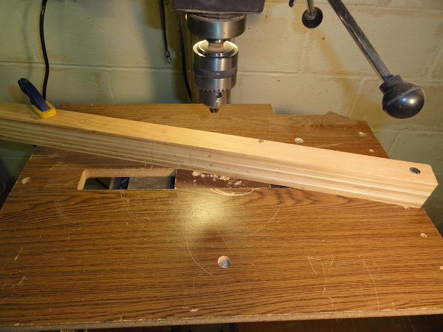

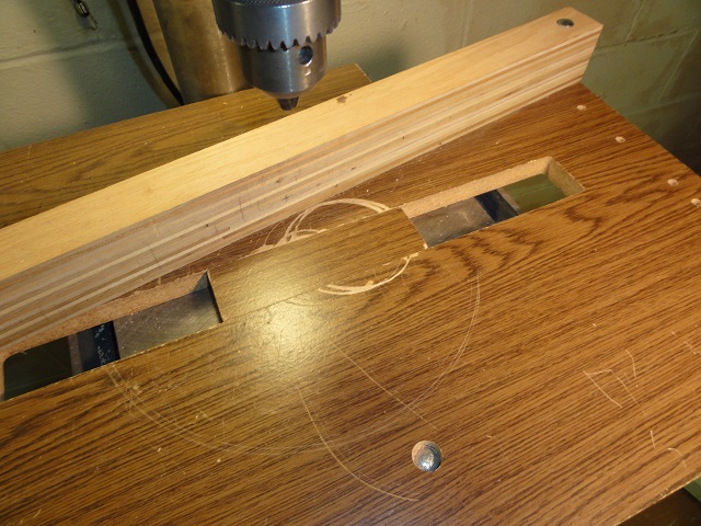

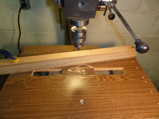

Everyone seems to make complicated drill tables.  I went simple.  Used a flat piece of particle board with a slot cut in the middle bolted to the metal table.  I make inserts for the slot to use as backers and they can be moved side to side for fresh wood and turned over when worn and replaced when both sides are used up.  The fence has a bolt in the right side that goes in holes in the table with a hand knob on the underside to tighten it to the table.  The left side is just clamped in place and can be fine adjusted with a bump of the hammer.
