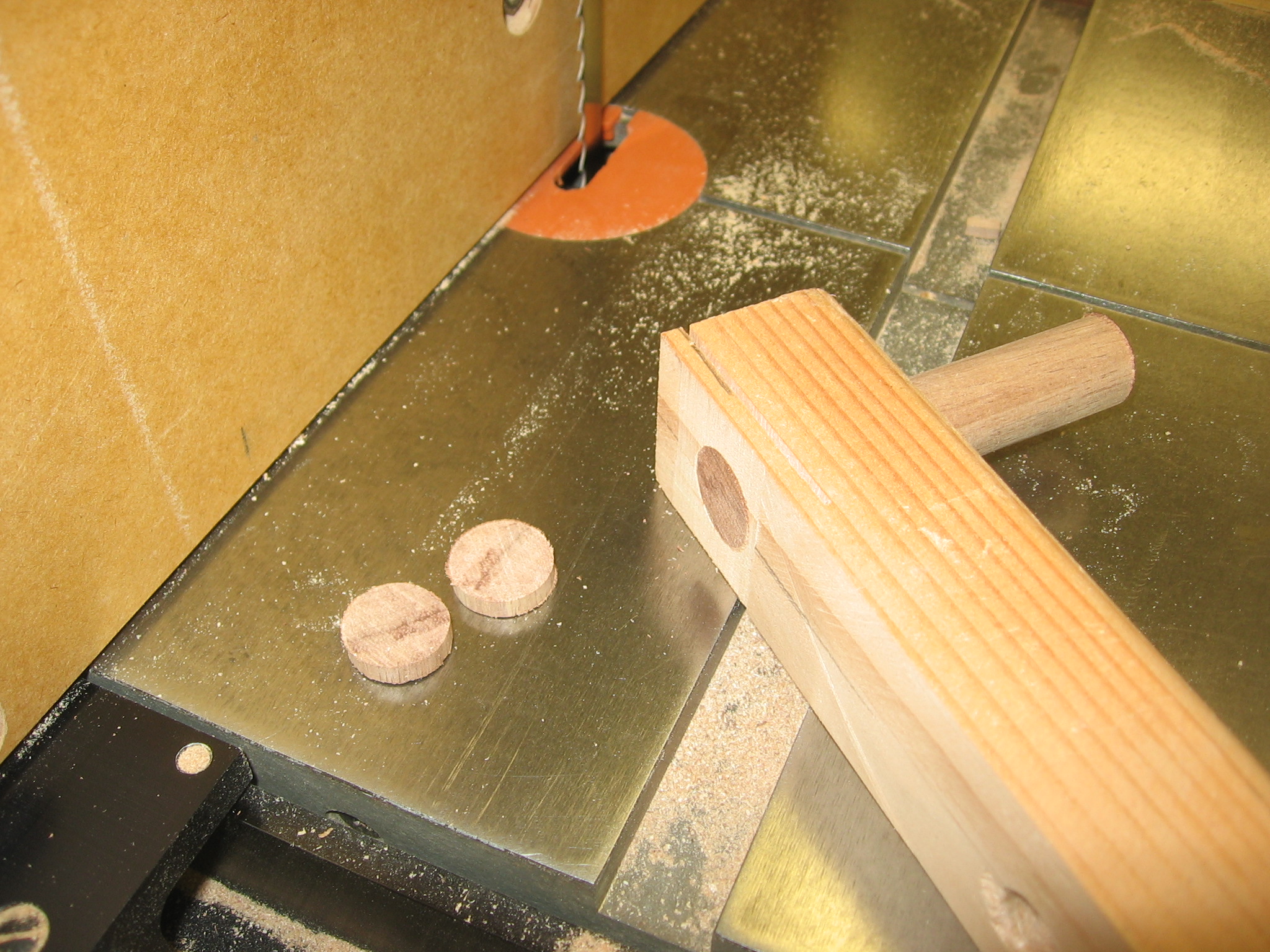

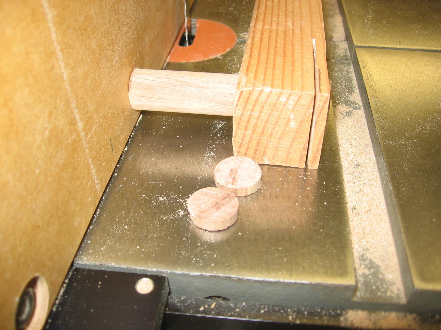

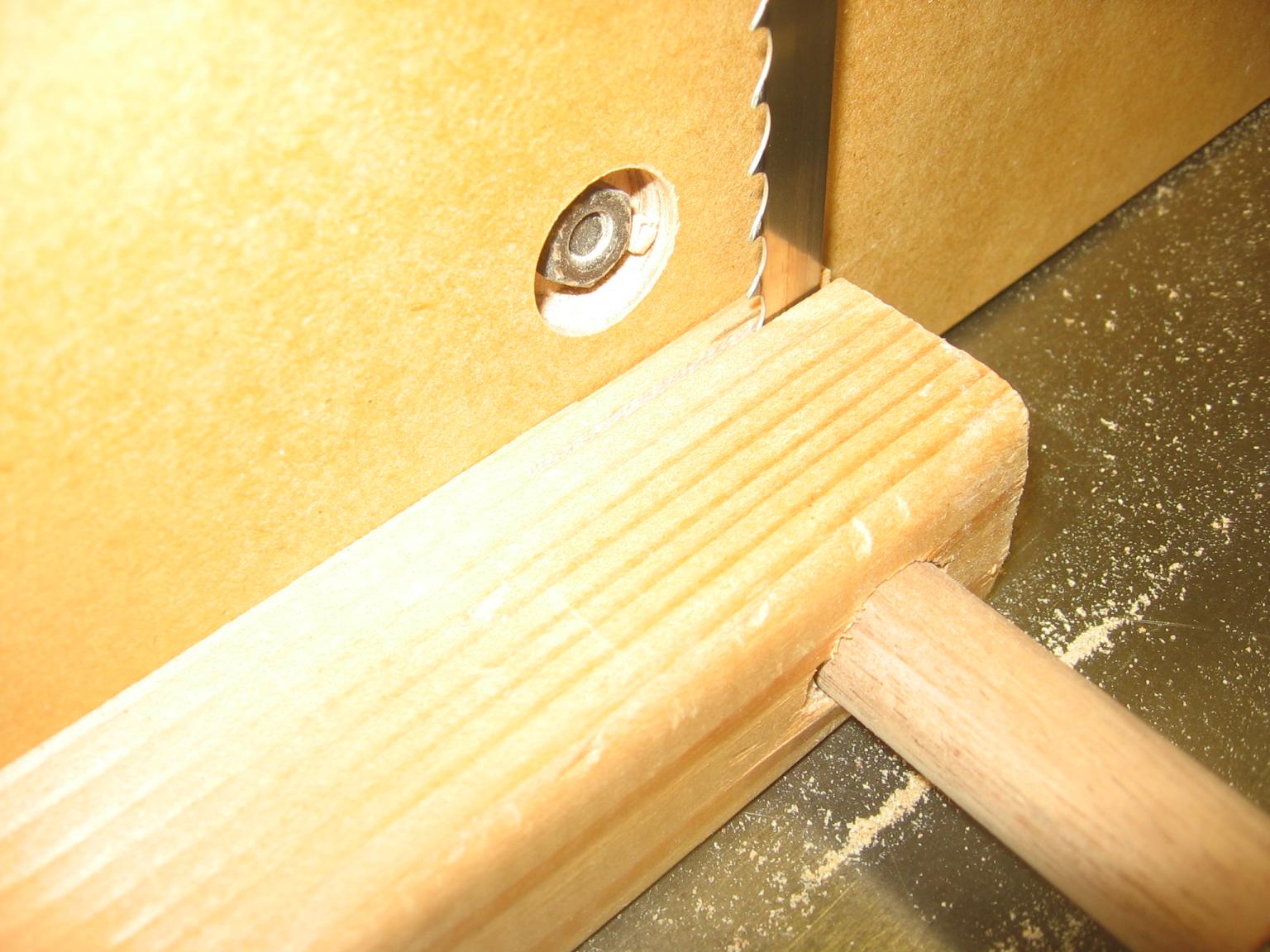

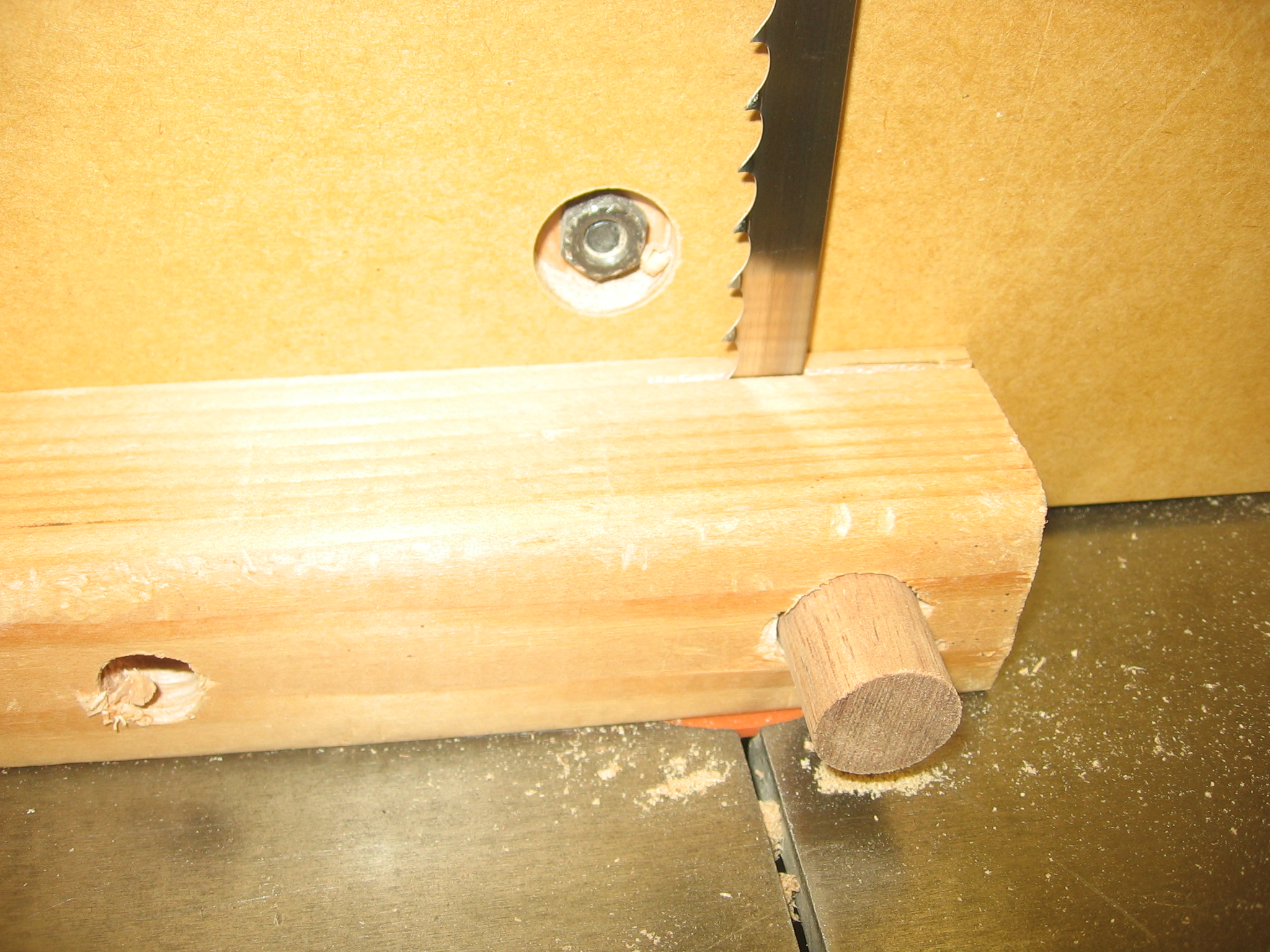

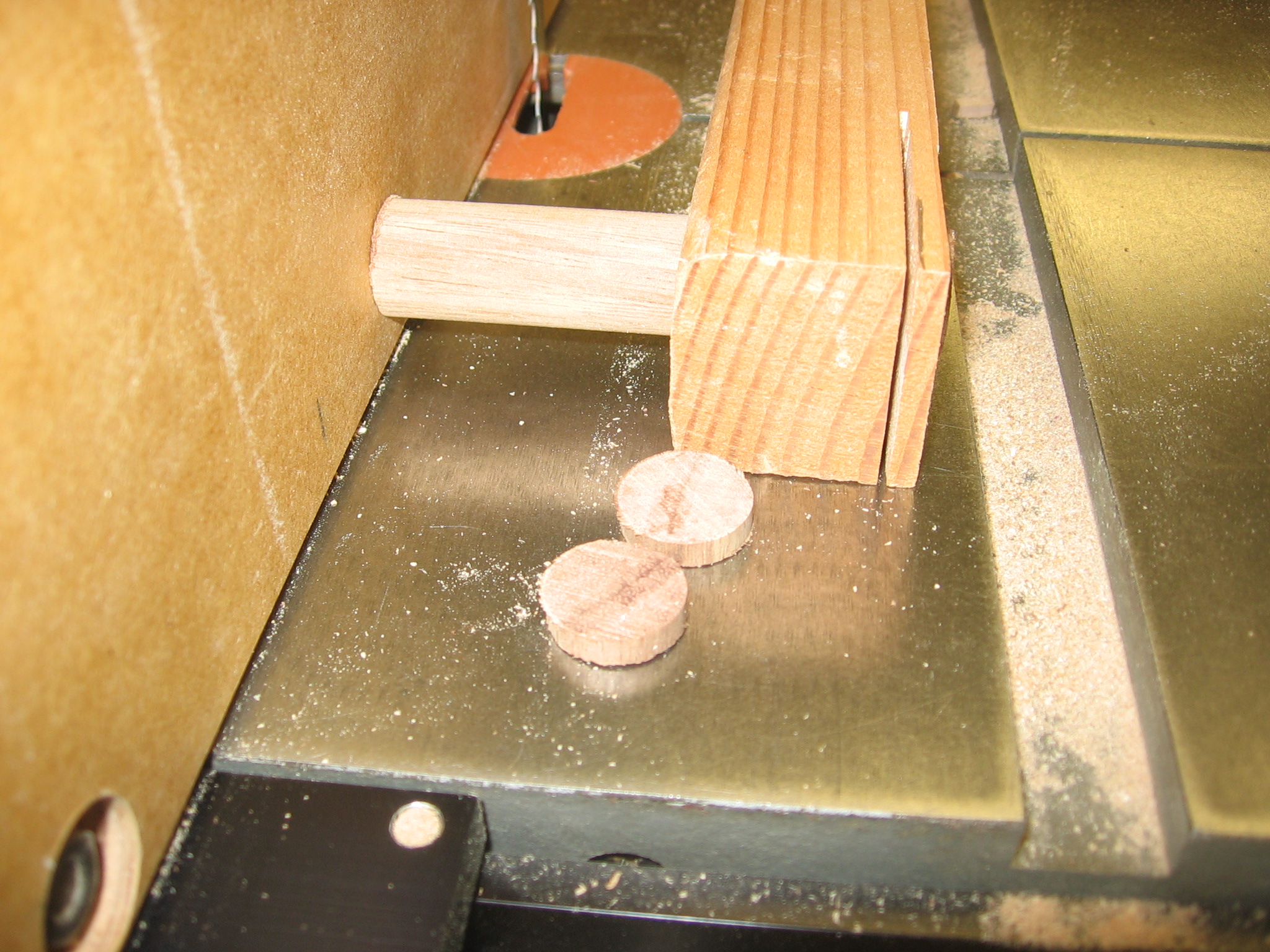

Awhile back I needed some 1/8" buttons for plugs. This is the jig I made to cut them from 3/4" dowel stock.
Herb

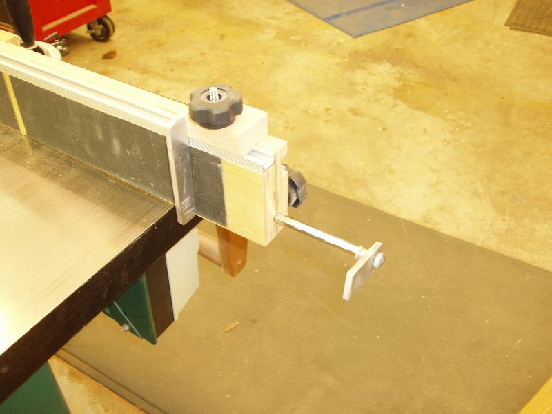

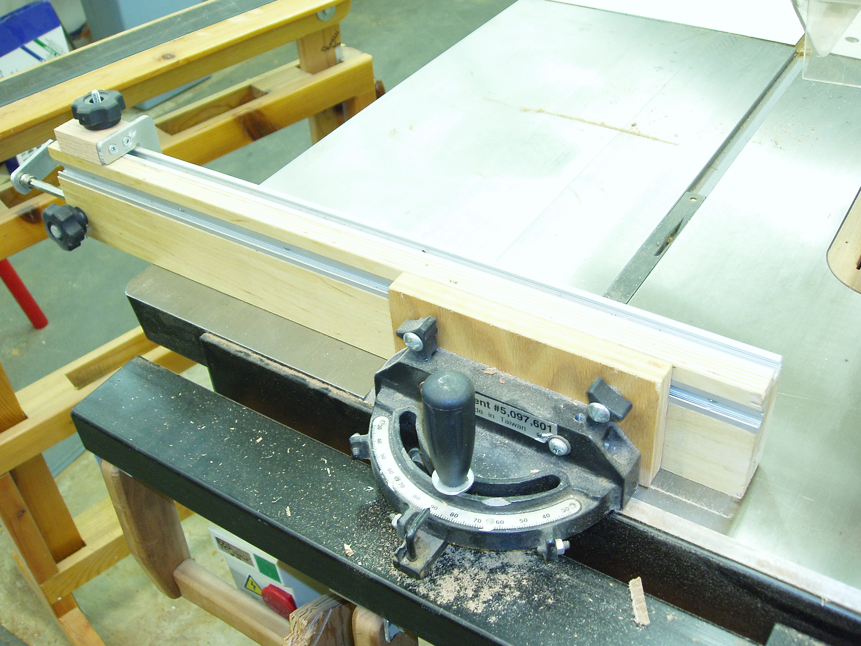

Made this adjustable and extendable TS Mitre Gauge Fence. TS Mitre fence back.JPG
The fence is positioned via the tracks on the back . There is an adjustable stop on top of the fence also mounted on track.P6301907.JPG
The extension mounts in a slot cut in the 2 pieces of the fence before joining. Also placed sandpaper on the front to keep wood from sliding.

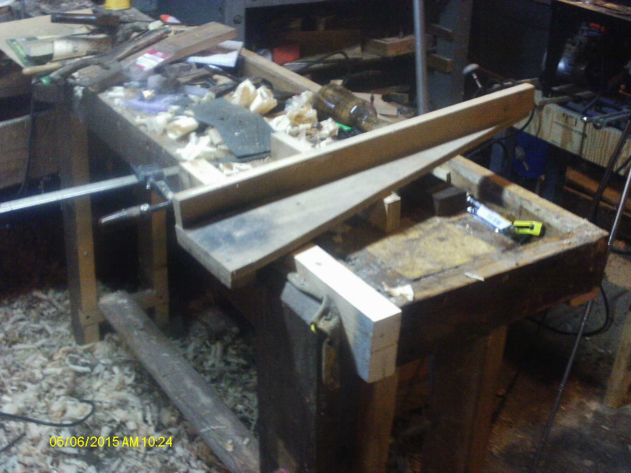

Cheap "Speed Square"..
Was designed to fit a DeWalt Jobsite saw......can be used just about anywhere, as a rip fence for those saws ( I use a circular saw)
Can be used as a crosscut guide.    It can be clamped to a board to guide a saw, or a router..
That is a hardwood cleat, set at 90 degrees to the long edge   3 pieces of scrap  and a handful of screws.   Accurate?    As accurate as YOU can make it.  Too tall of a fence?  switch out to a shorter one,.....not tall enough, switch out to a taller one.    Maybe someday, I'll add a layer of slick plastic......speed square 3.JPG
I mostly use this to get square crosscuts or rips on wide boards.   tip:   use the "Factory Edge" at a corner of the plywood sheet.    I made mine as a right triangle, for weight.   You can always add a hole to use as a hanger point on the wall.
Herb
It also helps if you put some masking tape over the cut end to keep from wobbling, especially if you are doing plug cutting and have a whole row of them.
Could you please elaborate? I am not quite clear on that.
Thanks, Herb

@Gerald; Sweet miter gauge enhancements. Got any more pictures of it I can steal ideas from, 'er admire? :P

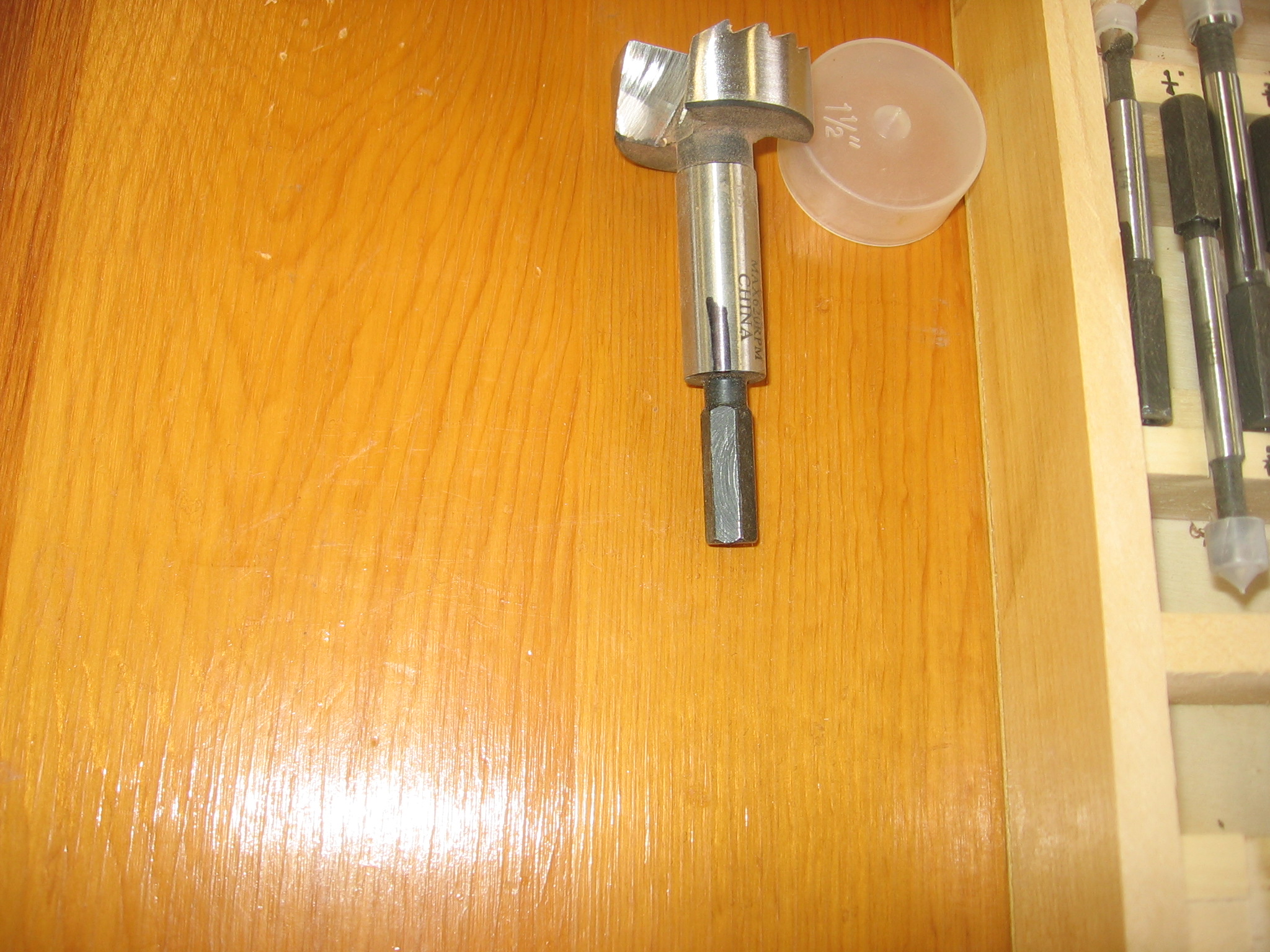

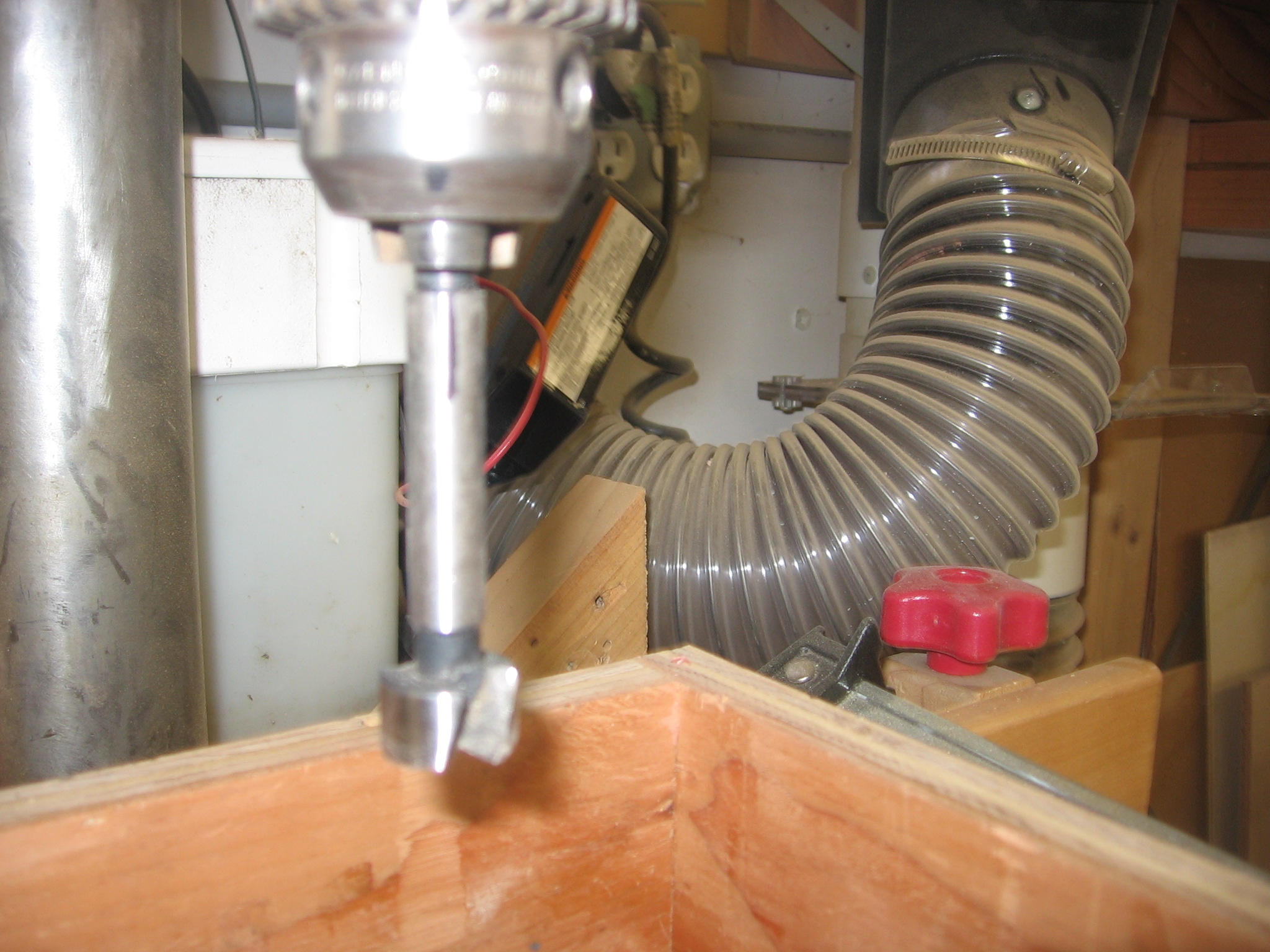

Here is another one. A year or so ago, some company had a sale on Forstner bit sets at a very reasonable price. Once in awhile I need a larger size for one hole,then not need it for awhile and usually that bit cost as much as this set. So after I got them, I found that when I chucked it up it was not running true. Upon examination I found the hex tangs were rough forged and the rest was ground. I tried to chuck them up by turning the bit one flat spot at a time on the tang until I found the "sweet" spot that ran true. Then I marked the shank with a felt pen and marked the chuck to correspond. I did this to each bit  referencing them to the same mark on the chuck and got all of them to run true, so When I pick a bit I can just chuck it up and start drilling.
The bits might be cheap ones, but they cut clean and are sharp. Maybe not production, but work for what I do.
Herb
