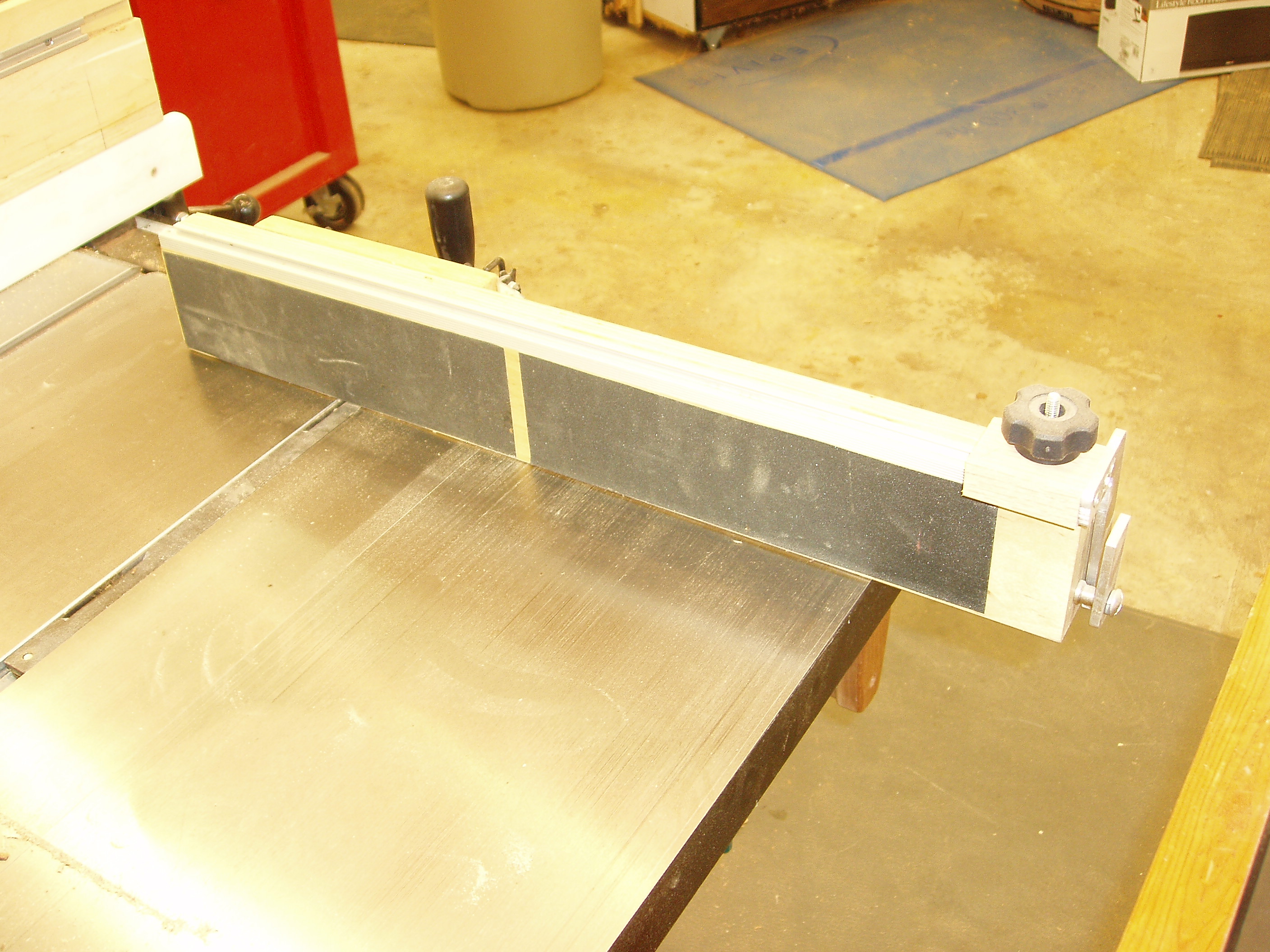

2 hours ago, Gerald said:
This is the only other pic I have that shows anything different. The fence itself is 2 layers of ply. The extension stop is mounted in a slot which is a V cut in each piece of ply . This came from some shop magazine , maybe Shopnotes (hated to lose that one). Let me know if you have any questions.ts miter fence.jpg
Gerald, is that a table saw or router table?

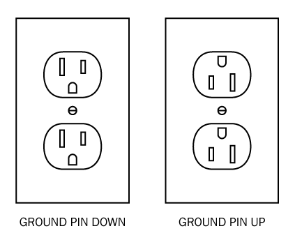

11 hours ago, Roly said:
Go to any hospital and with the outlet vertical and the ground is at the top.  Code does not specify which way it is positioned when vertical.    If the weight of the cord is hanging down,  with the ground at top the hot blade would not be exposed as it would if the ground is at the bottom.  The ground is also a little longer for the same reason.   When installed sideways the neutral should be at the top for the same reason,  to prevent the hot to be exposed.     Around here most are installed with the ground down but up makes more sense.    Roly
I agree with Roly on this one, I have always put the ground up for all the same reasons.
Ground Pin Up or Ground Pin Down?
There is an age-old debate about whether an electrical outlet should be mounted with the ground pin up or down.  Unfortunately, there is not a fully accepted answer.  However, it is commonly accepted that the National Electrical Code (NEC) of the United States, or NFPA 70, does not provide any specific direction for the orientation of the outlet.
Ground Up or Ground Down?
Some theories about the orientation of an outlet:
  • The outlet should be oriented with the ground pin up because if the plug comes slightly loose and a metal object were to fall from above, the ground plug, which usually does not carry current, would deflect the object so that it would not hit is live prongs.  It is accepted that this idea began in health care facilities where many tools used for patient care are metal.  The story goes that hospitals were wired by union electricians and as the unions grew the practice spread to other types of buildings.
  • The outlet should be oriented with the ground pin up because this pin is longer and the plastic around the plug is meatier, so it will help to keep the plug inserted in the outlet.
  • The outlet should be oriented with the ground pin down because a person grabbing the outlet will have their index finger at the bottom side of the plug and the index finger sticks out further than the thumb.  Having the ground down will keep a person's index finger from touching the live pins.
  • The outlet should be oriented with the ground pin down because many common household items such as nightlights, timers, and battery chargers are oriented with the ground pin down.  In addition, GFCI outlets, which have text on the reset and test buttons, are oriented with the ground pin down (and the text readable).
A quick internet search provides comments that easily debunk any of these theories.  The most basic answer is that it truly doesn't matter which way your outlets are oriented.  Select the strategy that best works for you.
To my knowledge the only NEC requirement for outlet mounting position is they cannot be mounted in the work surface of a counter top or other work surface.   Roly
 Most GFCI's  have text in both directions so either is readable.    Not that we read them anyway.
Edited by Roly
Table saw fence

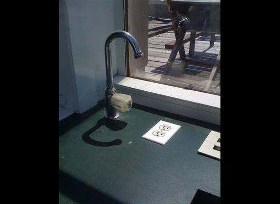

That picture is so unbelievable. Is it staged?
some how I think not...
Without a sink basin under it I call BS on the pic...
I do have a vinyl decal that supports the ground down orientation on the outlet.  This is not the forum to post it in though... it would need a mature audience section or some such...
Cal
Edited by clhyer
We can only hope!
The receptacle makes for a pretty small sink unless he is washing a couple of pennies at a time.
 Image result for electrical short
 Found the pic years ago on an electrical website and don't believe it was staged. Most of the codes are based, IMO, on things that people have done and failed miserably. A lot of the pictures I have taken over the years were used to try and explain what I wrote in a service report, sometimes words were not enough.
  The red lettering on the pipe states " for water us only".
Edited by DuckSoup
My guess is it's a faucet modified to be a beer tap...

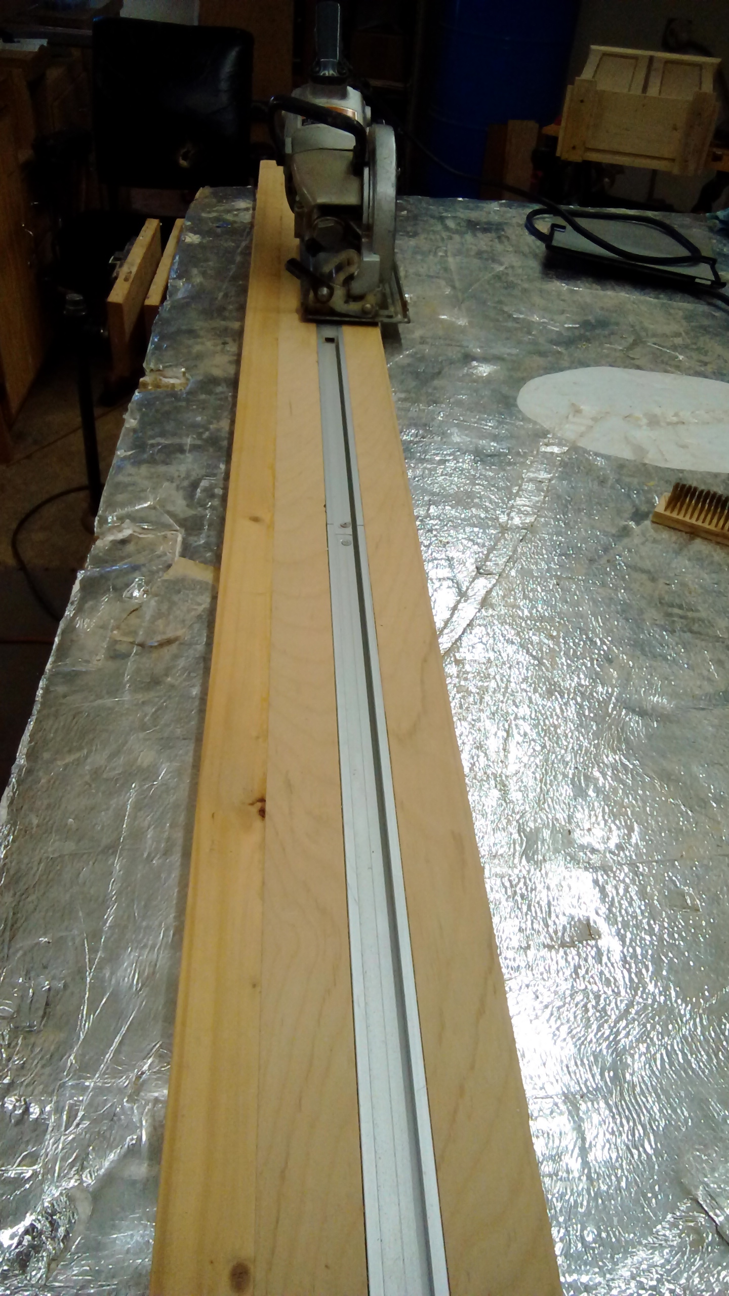

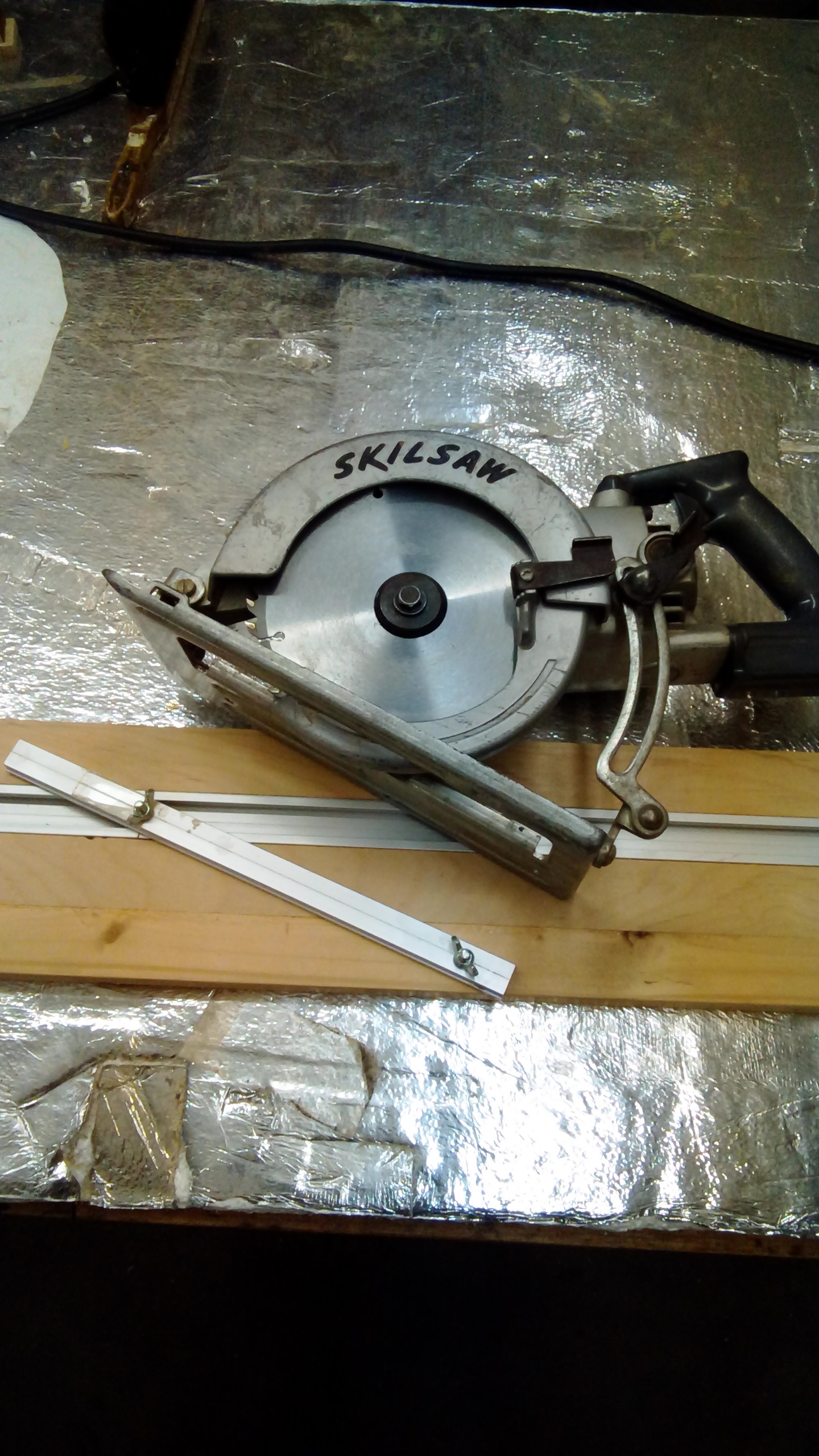

Here is a saw guide for breaking down sheet goods. It's a commercial edge guide attached to an 8' piece of ply. Figuring the offset for the cut was error prone, to say the least, before the ply was added.
The first cut through the ply establishes the cut line. Then, line the edge to the tic marks on the sheet to be cut. Clamp both ends and go.
Works good but, rough. I always cut a smidge wide and trimmed it at the TS.

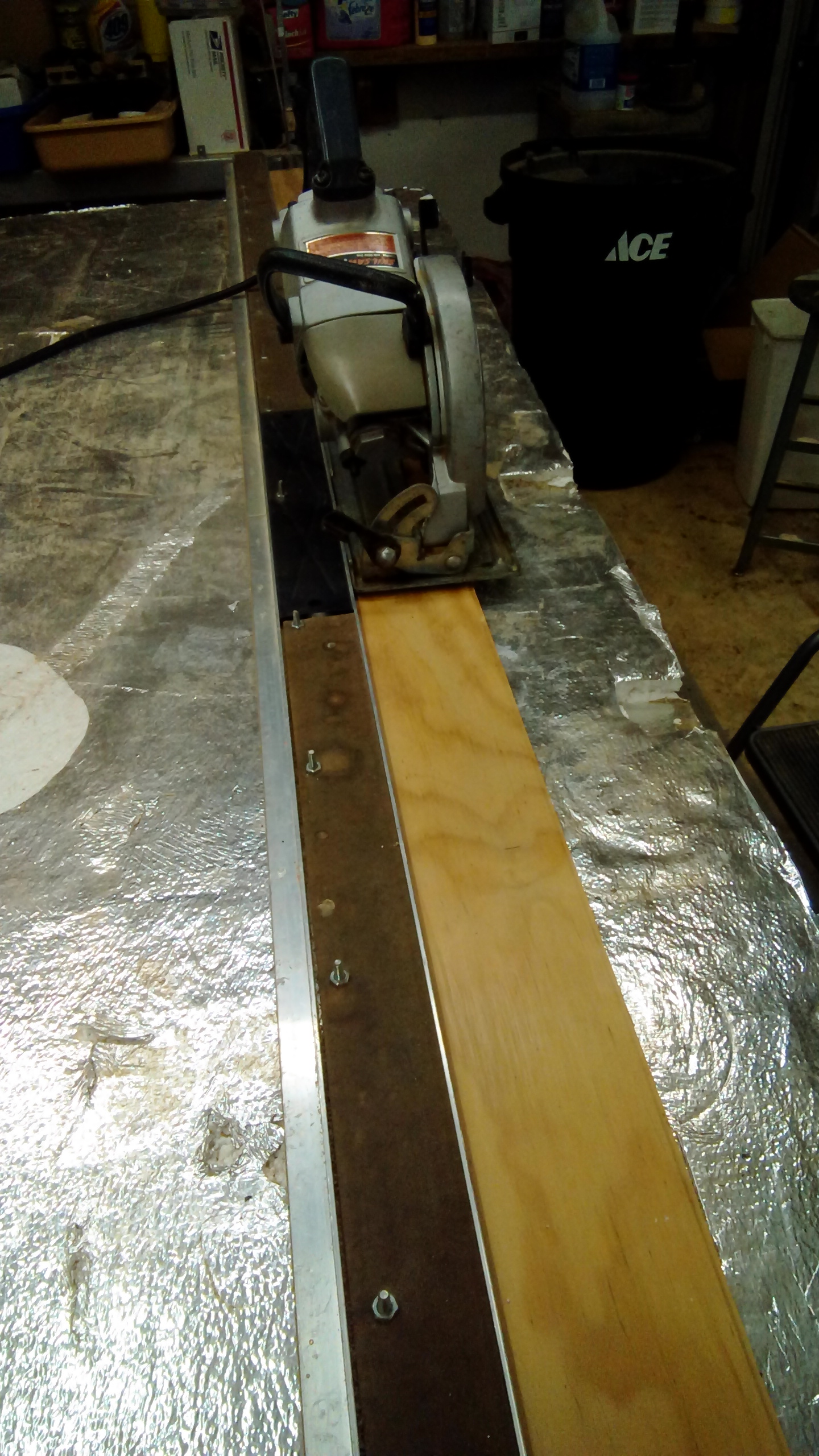

Here's a gooder one. An 8' "T" track screwed in a channel cut in a 3/4" piece of ply.
A matching insert is attached to the saw plate.
With this set up, there's no need to trim at the TS.
@Gene HoweReally cool ideas Gene...I especially like the second set-up....do you have some type of set-up jig to ensure the insert is parallel to the saw blade?
Edited by Grandpadave52
