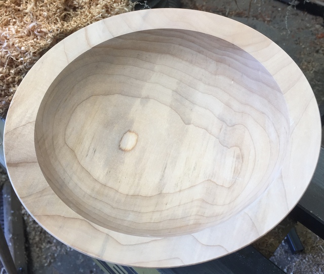

  3. Steve Krumanaker
    Got some new bowl gouges
    Most anyone who visits this forum will know I spent a week at Marc Adams in September. The guest teacher was Glenn Lucas. During that week I had the opportunity to use some of his signature bowl gouges. I was very impressed with the cut I got from them, enough so that I ordered his 1/2", 5/8", and the 5/8" bottom feeder bowl gouges. This is the first bowl I've used them on. It is hard maple, twice turned, harder than nails, and about 9" in diameter. In the picture I have sanded it with 150 grit only. I used a 3" disk in my drill and this is after about 5 minutes. In this picture the rim has not been sanded at all. It is the first time ever I started sanded with anything other than 60 or 80 grit on the inside of a bowl. I could start with 150 grit because there was virtually no tear out, even in the "problem" areas. FWIW, I have since finished sanded the bowl inside and I started with 320 grit on the rim. This is not meant to be a recommendation to buy his tools. I'm sure the techniques I learned from him contributed as well. It's not unusual for me to spend an hour or more sanding a bowl this size. I might have had 15 minutes on this one. Steve
