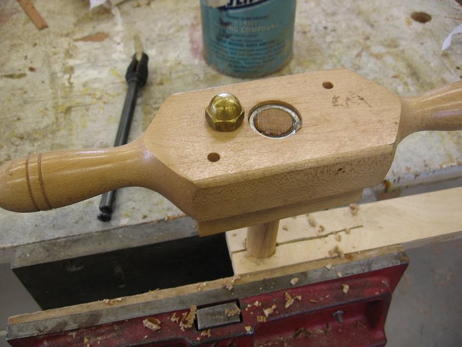

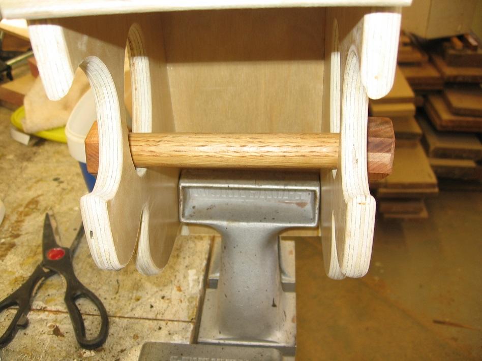

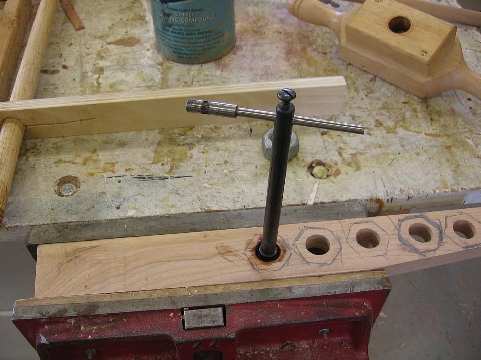

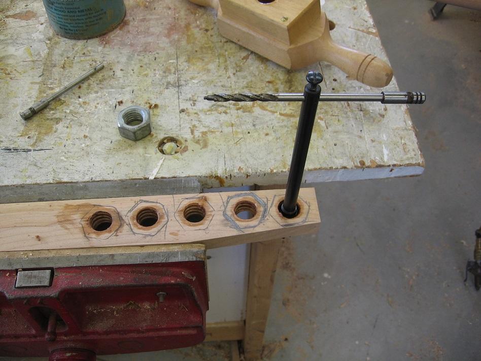

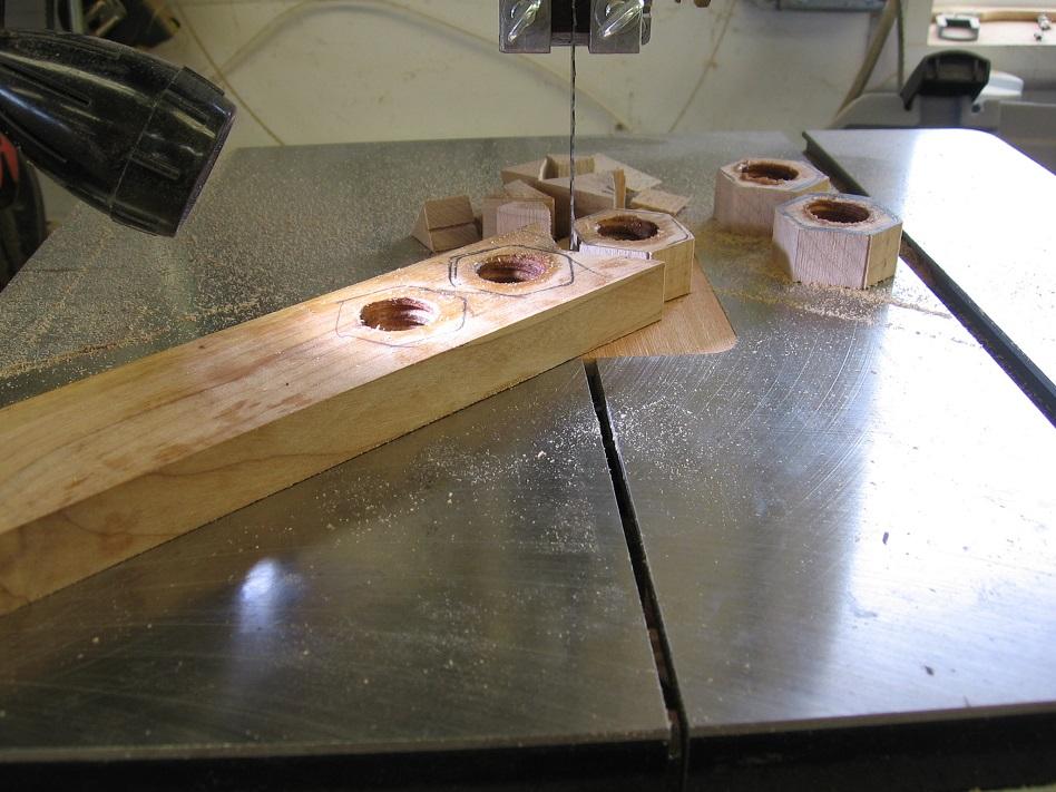

  3. I have requests for showing how I thread the bolt and nuts in the TP Dispenser Post. It is the same way that you thread metal rods,and tap metal plate for bolts. I use Slipit for a lubrication so as to not tear out the threads. Here I show an oak dowel and maple nuts. I use Slipit on drawers rails, drawer slides, and any wood that needs to slide. https://www.slipit.com/all-products/...ding-compound/
