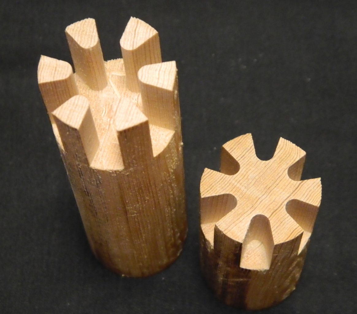

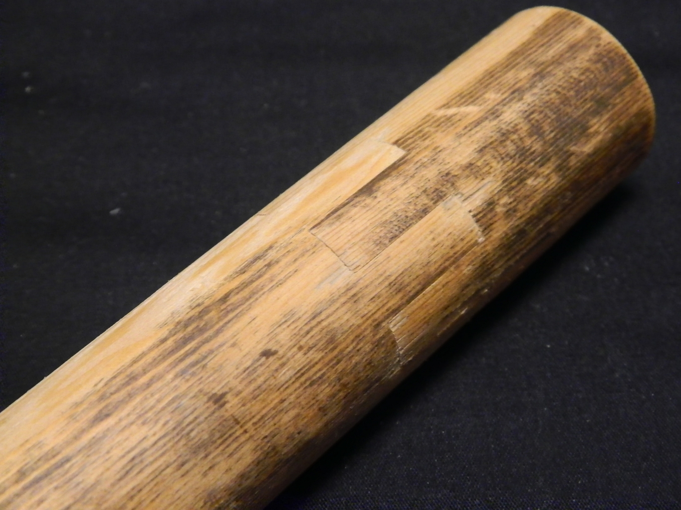

    Dowel Splice Joint
    I've got a closet in my spare bedroom (storage room) that I wanted to add another clothes hanger rod to. Among my scrap pieces I had two 1.25" diameter closet rod sections that together would be long enough, but neither was long enough on their own. The distance to span is roughly 22". This is a CNC-cut splice joint I came up with to solve the problem. Test cut on smaller scraps shown in the photos. I'm calling it my radial finger joint. Finished spliced rod now loaded with clothes and seems to be able to handle the weight with no complaint. If it does fail eventually I'll report back. 4D
