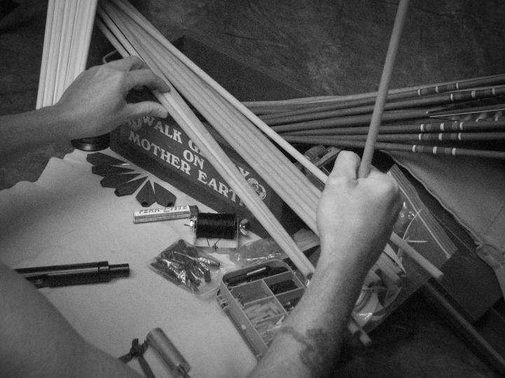

As a traditional woodworker I also use hide glues, but I'm comfortable with those because I've been shooting traditional Archery for over 30 years and have won many competitions shooting 31" 23/64th arrows I've made and glued all 100% natural.

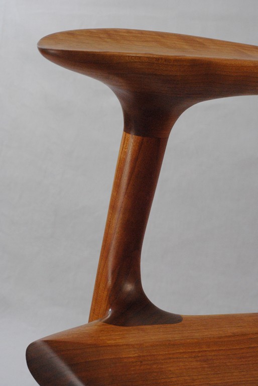

I like to match color or at least I like to use dark glue with dark woods, and light glue for light woods. If there is a micro gap or a very small gap in your joinery, it can help disguise it, more so with dark woods such as walnut. The Tightbond for dark woods is great for this especially if you are going au-natural with the finish. Once a coat of oil is applied, you cannot tell the difference between the dark glue and the walnut, it does help me since I am far from a perfect joiner!

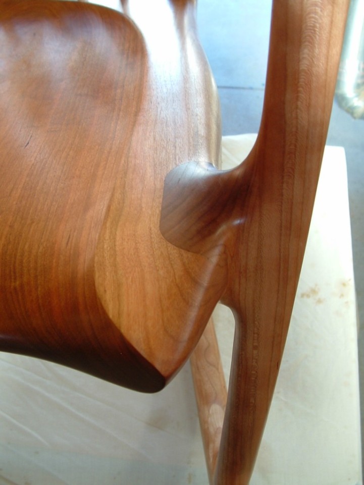

The joints in this rocker I made all fit really nice and tight, but there was one joint where a micro gap was visible if you knew where to look for it, I corrected it by taking advantage of glue squeeze out, and if you use the basic tint of glue to match the species of wood you are using, you can really use the squeeze out to your advantage. I have tried wood dust and glue for a situation like this with little luck. But a little glue squeeze out works great. After sanding the entire chair to 800 then a micro pad at 1200 the glue line becomes part of the wood, you cannot see the difference.
ning-taylorrocker6-2759-79.jpg?width=721
The leg to seat joint is the money shots in this project, these have to look perfect, if not, the customer walks on by. There was one tiny area where a micro gap was visible if you knew where to look, but it disappeared by using the glue squeeze out. I have tried dust with glue in a situation like this, with horrible results.
