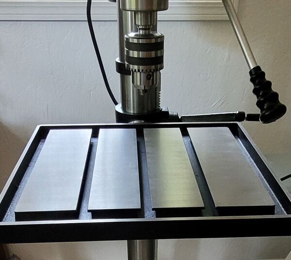

The current factory table doesn't have any holes to attach from below as done in the YouTube videos I have viewed so I'm trying to figure out the best way to attach the plywood table. Here's the factory table.

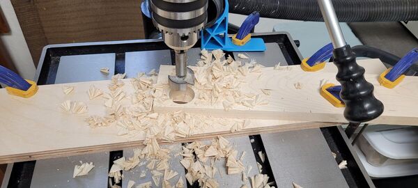

  • Here's some of the other pictures that I wasn't able to post earlier (thank you for fixing that @John Morris ) 3D shims for under the t-track 3D printed drawer slides that worked great as the hold

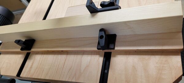

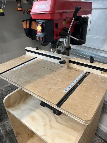

  • Decided build the fence rather than buy. Used some leftover maple 1/2 plywood. Cut and glued up three strips to allow a base piece to fit into the created rabbet. Then added a groove on the front fa

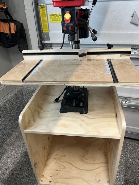

  • Here’s mine, pretty typical.
I got a plan from Shop Notes and it allows for drilling ends of much longer stock. It has two fences and a replaceable center panel.

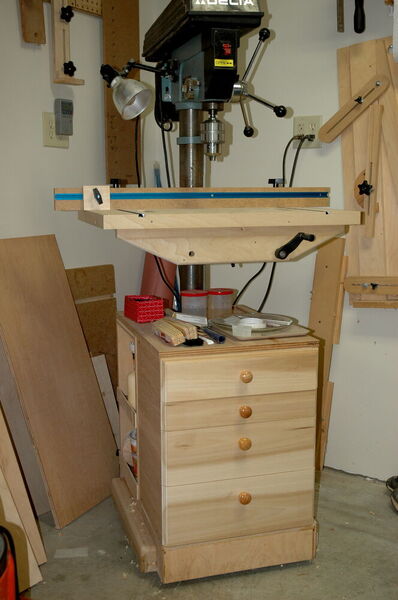

Here's an old one I did, this arrangement didn't allow for me to tilt the table so eventually I replaced it with just a flat table (no crank to raise ti up down). But the one thing I want to suggest is the round insert under the chuck. You can rotate it to get a clean spot, after it's used up flip it over. After that's used up toss it and replace it with one of the spares you made. BTW, this is a floor stand DP, the cabinet is on wheels and can be pulled out for when I need the extra space. I think all this stuff was in Woodsmith magazine.
Edited by Fred W. Hargis Jr

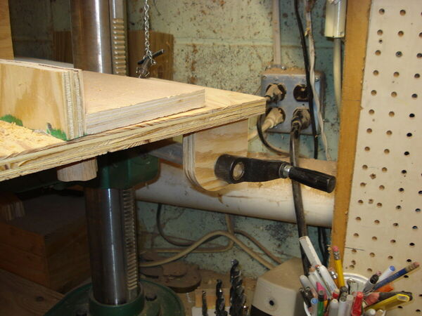

Something I forgot about when I first designed mine was the crank to raise/lower the table. I kept banging my knuckles on the table so I added this

Lew I did my handle almost just like that but I found a large handle at a antique store.

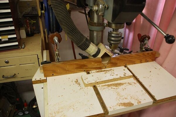

my drill press table. my own design. 1/2" ply with 1/2" of MDF on top, then some scrap laminate countertop material. i recall i got the hardware from INCRA, held to the factory table with bolts underneath that tie into the 2nd channel. replaceable MDF insert. i do have a stop that fits into the fence channel, just not in place at the moment.
Edited by DAB

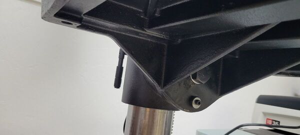

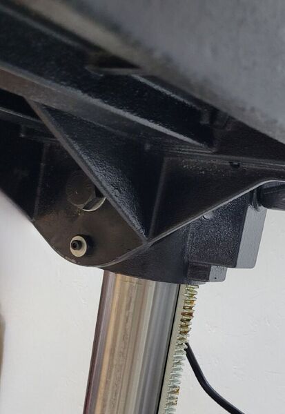

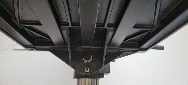

How is the factory table attached underneath? Is it a round part, clamped, so the table can be rotated, or ??
I would love to see a picture of the bottom, please. 😃
I like Lew's solution - I never even thought of that but it's pretty brilliant since every hardware store in the country has flange bolts in stock!
However, what I would do is get the right size machining hold down nuts for those table slots (https://www.mcmaster.com/products/t-nut-slots/t-slot-nuts-2~/t-slot-nuts-2~~/) and then use short flat head bolts to fix the wood table down to the nuts. Not the cheapest way, but flush mounted and pretty darn easy!

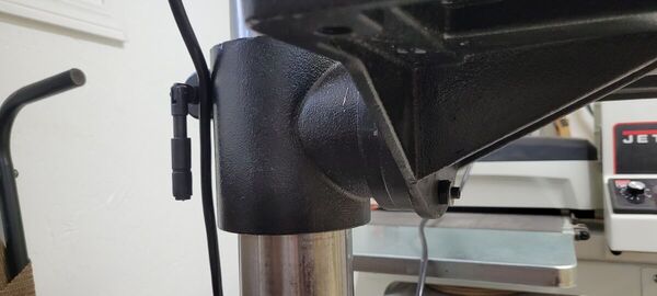

Have been installing flooring so missed responding. Here are some pictures.20260901_082353.jpg

Thanks for the photos. My solution won't work with that style of table. ☹️
That would be the only way unless you want to drill holes in the table. Well, I guess you could make the new table oversized and have it clamp to the cast iron around the edges.

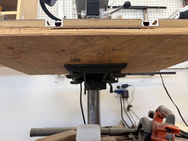

I have a start with two pieces of 1/2 plywood glued up, and have leftover t-track that I want to install for clamping a fence and hold downs (t-track just laying there in the picture).
