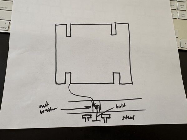

Drill press table
top sketch is looking down on your wooden table, 4 slots cut to match the spacing of the steel table slots.
bottom is a side view, you slide a bolt into the steel table slot, and the wood table slot, securing with a washer and nut (recessed below table top).
got it?

27 minutes ago, DAB said:
got it?
This helps a lot! Sort of a combination of recessing a bolt with a "side" attachment. Thank you!

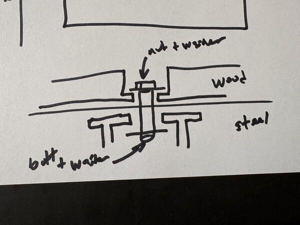

little better sketch of the steel table and wood table interface i'm trying to describe.
i'd make the wood table about 1-1/2" thick (maybe two layers of plywood and a layer of 1/2" MDF), and then using a Forstner bit, create a recess for the bolt/washer/nut you can access from top, and have it still below the top, so it won't interfere with whatever you are drilling.
you can create the slot in the wood table with a drill (little bigger than the bolt diameter), and either a bandsaw, or just a handsaw, then slide the bottom (in this view) bolt and washer into the steel table slot and the wood table slot at the same time, and once in place, tighten the nut. doesn't have to be overly tightened, it's just holding the wood in place.
better?

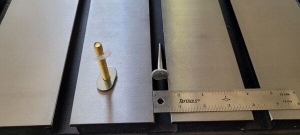

I'll need to get some different bolts and washers if I go this route. I checked a T-bolt from a t-track hardware set I got years ago in a holiday sale and the toilet set I picked up this morning, and neither are the appropriate size, and no washers on hand that would work.
Was hoping one of these would work, but too small. Will need to do some better measuring and planning.

How about cutting a small block of wood to fit the table slots and then embed the bolt upright though the bottom? And then go with DAB's plan for the rest of it.
The blocks don't even need to be the full thickness of the slot. Full thickness might be difficult to get into the slots.
This is what I have done when the slot is too wide for the closet bolt

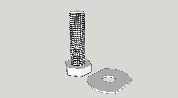

Take a large washer and grind off 2 sides to fit in the slot, drop it over a bolt and slide the pair into the opening.
Well, that's a great idea. I looked through my random hardware storage with no luck. Wouldn't have come up with this - good tip.
Another good tip. And I might have an oversized washer that might work if trimmed.

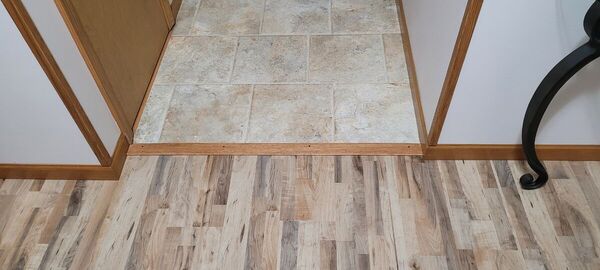

For today, got my last floor transition in place.
Now to an update to the "landing" in front of our fireplace. I keep telling myself that it is "nice" to be able to work through these home projects rather than paying to have them addressed. Right?!? 🤔

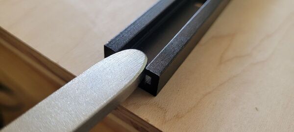

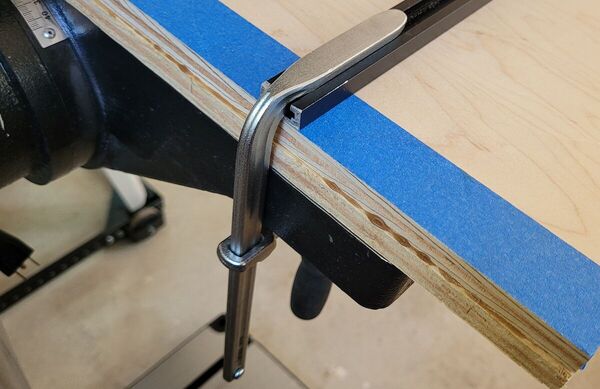

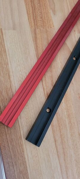

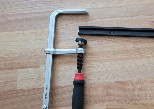

Continuing to brainstorm a simple way to attach and remove a table for my drill press. Trying to use the existing slots on the DP table will require embedding the bolt. To avoid drilling into the table, am thinking I could use the t-tracks I plan to install in the add-on table. If I could find a clamp to slide into the track that I could then tighten under the table. This is the idea.
Unfortunately, the clamps that I thought would work do not fit in my t-track as shown in the picture (not sliding into the track).
Is there another type of clamp that would work. I've tried some searches but seem to land on clamps similar to what I have. Maybe my t-track isn't a standard size? 🤔
Just checked some other track and doesn't fit there either. What I have seems specific to my tracksaw track.
just route a groove big enough to fit that clamp head. done.
Yes, for sure. The t-tracks will already be there so seemed like a solid solution. Well, until the clamp didn't fit. 🤦‍♀️Also thinking to leave an opening when (if) I add one more plywood layer.
