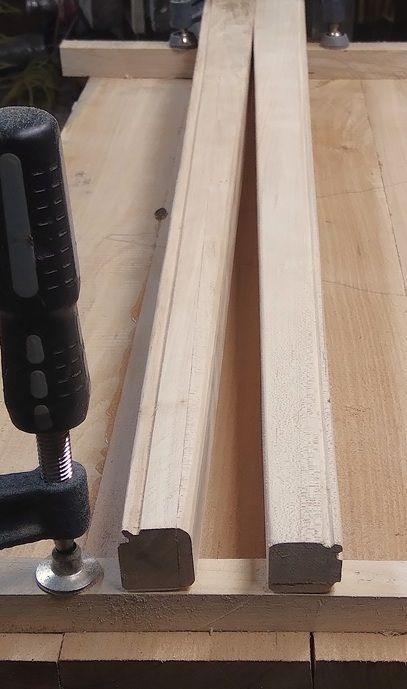

5/8" thick Soft Maple for the sides and back of a drawer...Ash for the 3 aprons and a drawer front...which leaves..:WonderScratch:

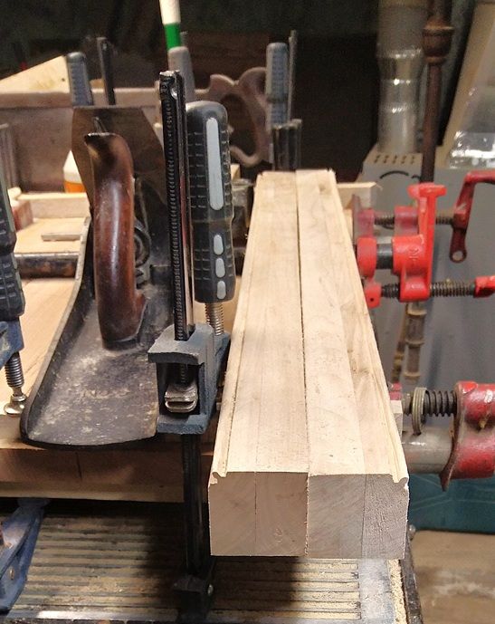

Needed for of these...to make tapered legs with...let them sit overnight, then...:ChinScratch:
De-clamped them...set up the rip fence to just skim two faces...one to remove the glue lines, the second one was to skim of a face, to get rid of the "Fuzzies", 90 degrees to the first pass
Passes #3 and #4..fence was reset to 1-1/2" width...and the other 2 faces were run through...:ChinScratch:
Will have to trim the ends square..then decide which two faces to cut the tapers on...:OldManSmiley:

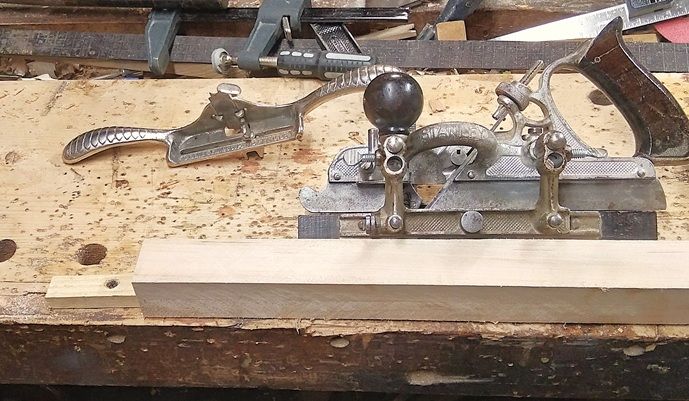

Tapered legs...2 faces get tapers cut and planed..one corner gets a bead...so...easy way is to mill the bead first..on the best looking corner.
Need a jig to hold things..:OldManSmiley:
Block of scrap in the vise, at the other end is a small block..:TwoThumbsUp:
The No. 66 is there to clean up the bead after the #45 mills it...I first run that #80 down the blank..works better for the planes..:OldManSmiley:
Run the bead along one face, then rotate the blank. and complete the bead..:SaluteandRun:
2 done, two to go...:Cheer:
Beads done..time to cut tapers..while leaving the beaded corner alone..:ChinScratch:

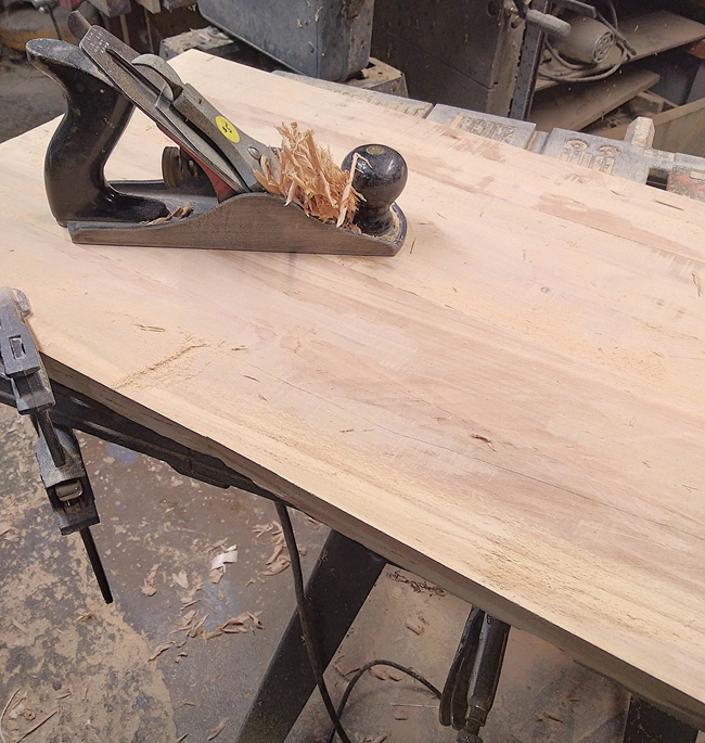

Ohio No. 0-5 Jack plane ( because the Stanley #6c was too long) and a Stanley no. 4-1/2 Type 11 smoother...
Goal was to remove any and all saw marks, and any "Bumps" in the road along the tapers:TwoThumbsUp:
Next, a block plane to add a slight round-over..:WonderScratch:
Repeat for the next 7 tapers...refine with a bit of 220 grit sandpaper...and that Stanley No. 80 Cabinet Scraper..:OldManSmiley:
4 done, 4 to go...all faces were sanded and scrapered....:TwoThumbsUp:

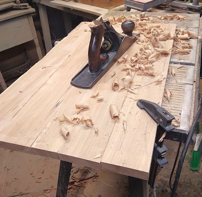

Ok...all the cauls and clamps came off that panel, this morning..clamped it down to the top of the tablesaw...theory was to use this..:OldManSmiley:
And level the glue joints down....was NOT impressed..:ArguingSmileys:..so, Olde School we go..:SaluteandRun:
Ran this at a diagonal, where I could, then ran with the grain....got things looking close...decided to try the ROS, with 60 grit...all it did was stir up a dust cloud...:BangingHead:
Hmmm, how about this sander, since I don't have a beltsander at the moment..:JawDrop:
Was my Dad's Craftsman "Finishing Sander".    Fitted it up with some heavy-duty 80 grit paper...Sander was still set at "In-line" ...seemed to work pretty good..finished up by setting it to Orbital...I still had some high spots to level out...so..:OldManSmiley:
Stanley No. 1204.  Was Picked during the Garage Sales..sharpened it up, a wee bit of tune up...and a test drive on Soft Maple....
So..decided to see how it does on Ash...:ChinScratch:
Didn't even bother to remove the Price Tag...just put it to work...:SaluteandRun:
My Cardio  Workout for Sunday.  :Cheer:

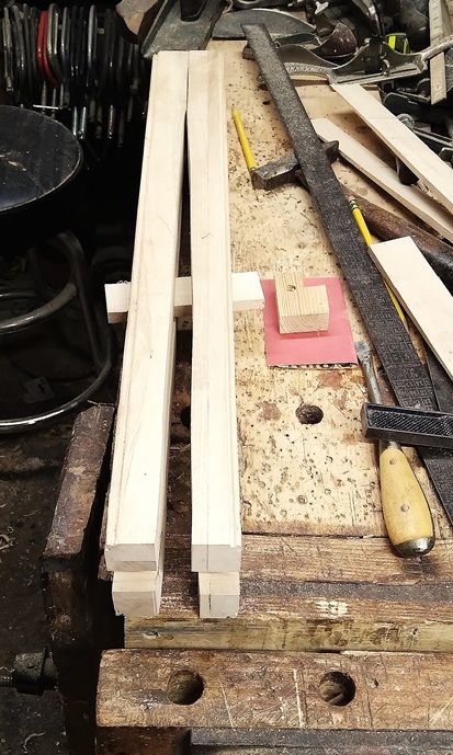

Laundry Detail, this afternoon...so...Tenons got done...:Cheer:
Wasn't so much the spacing of the fence...it was the height of the saw blade...took a few tries..was looking for a 1/4" thick tenon that was 1/2" long/deep...then:TwoThumbsUp:

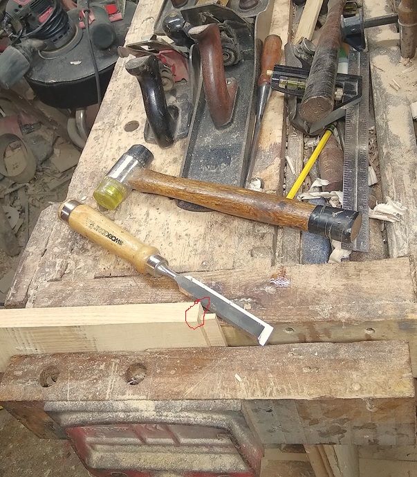

Stand it up and clip the ends a little bit...:OldManSmiley:
One tenon almost done ( yes, I do Tenons first, then size the Mortises to the tenons:JawDrop:)
6 tenons done, almost...( Drawer doesn't get any..):TwoThumbsUp:
Have that little area right there, that needs pared away...so..:MachineGun:

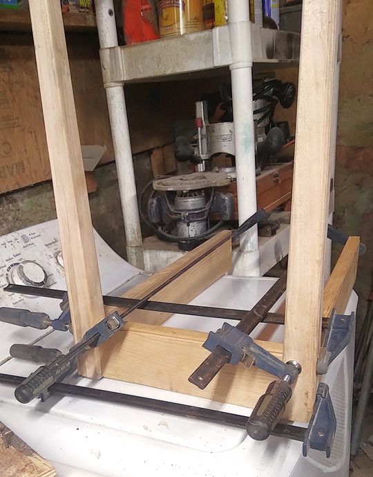

Test fitted last night, while awaiting the Laundry to finish up...:Tapping:
Stay tuned...:cowboy:

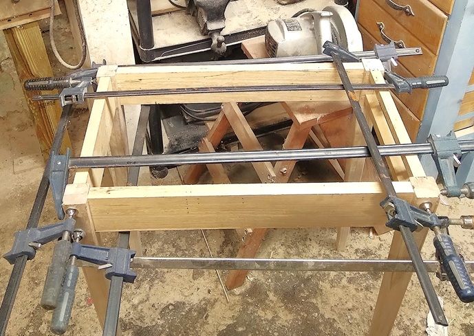

Ah one, And a 2..:SaluteandRun:
And a 3...:TwoThumbsUp:
And a 4...:Cheer:
Dry fit the back end...:ChinScratch:
Seeing IF I have enough clamps...checked to see how the blank for the drawer will fit..:TwoThumbsUp:
Need to rip a strip off the bottom and top of the drawer front, to make runners, and dovetail the 2 strips into the legs...:ChinScratch:
Set the mess down on the floor, for now....:OldManSmiley:

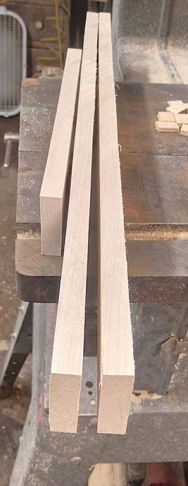

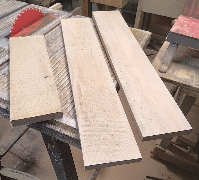

Drawer parts...2 sides and the back...:ChinScratch:
Needed cut to lengths needed....then..:TwoThumbsUp:
They needed ripped for width, to match the drawer front...and the back needed a trim to match the drawer front...:ChinScratch:
It a start...the 2 sitting over on the Shop Stool?   They will get mitered into corner Braces, that I use to both square up the base during glue ups, but also a way to attach the top to the base..:OldManSmiley:

Drawer sides and back..:PullingHair:
None were the same thickness, they also needed ripped to match the width of the drawer's front...:OldManSmiley:
And, the thickness was all the same..:TwoThumbsUp:
Roughly 1/2" thick...Drawer front will stay at 3/4" thick.  :OldManSmiley:

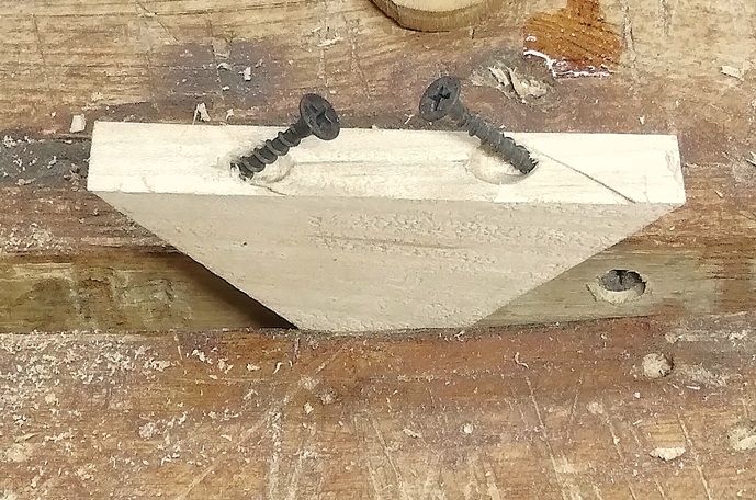

Start with a stick of Soft Maple...make a bunch of 45 degree cuts..:Cheer:
Done on the Bandsaw, so I had to take my time...these go into each corner..:OldManSmiley:
They get glued in place when I glue up the base...clamp?:WonderScratch:
We have ways.   #6 x 1-1/4 screws...countersunk, too....:OldManSmiley:

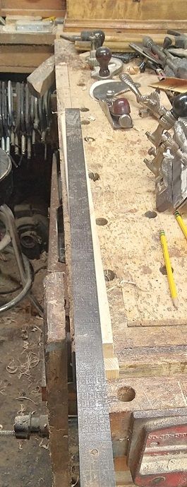

Task #1...mill a bead:
Jig...:TwoThumbsUp:
Double check that is the correct corner...:OldManSmiley:
Appears to be...then, run the Stanley #45 a few times..:TwoThumbsUp:
Until a bead appears..Task #1 is completed...:Praise:

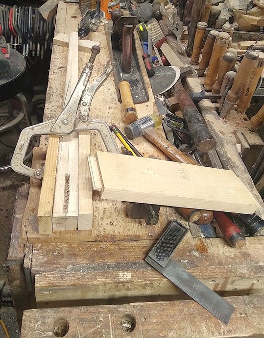

Task #2....chop 4 mortises....remove one front leg for the dry fitted base...lay out 2 mortises, and proceed to chop and fit..:SaluteandRun:
One done....:Cheer:
Second one done...replace this leg with the other front leg,, and chop a few more holes...:SaluteandRun:
Then, a dry fit of the whole mess..:ChinScratch:
Task #3?   Before I can glue this mess together...I need the corner braces made ready...:TwoThumbsUp:
June1ProjectDrawerPartsmortisescornerbracesdone.jpg.89b61eaa7a7ed535e51104741514ef76.jpg
Drilled, countersunk, added the screws, these are ready to go...:Cheer:
