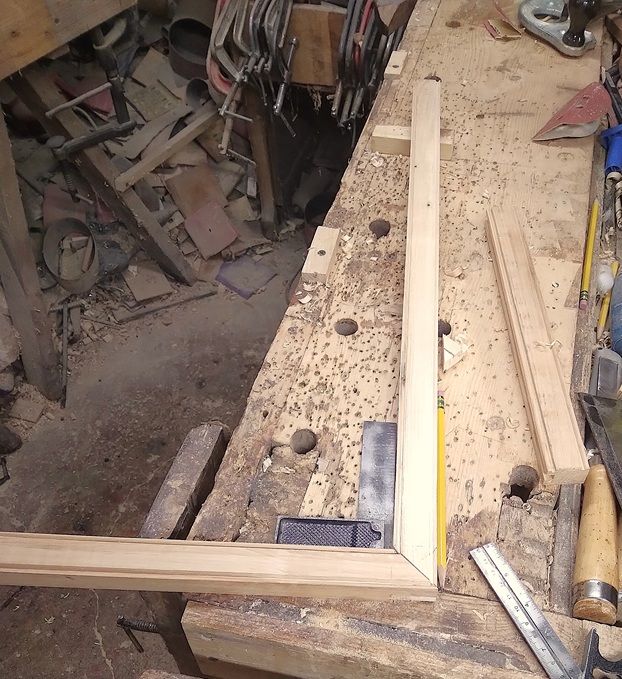

Task #3...involves one of these..:TwoThumbsUp:
Some 90 degree cut and some..:ChinScratch:

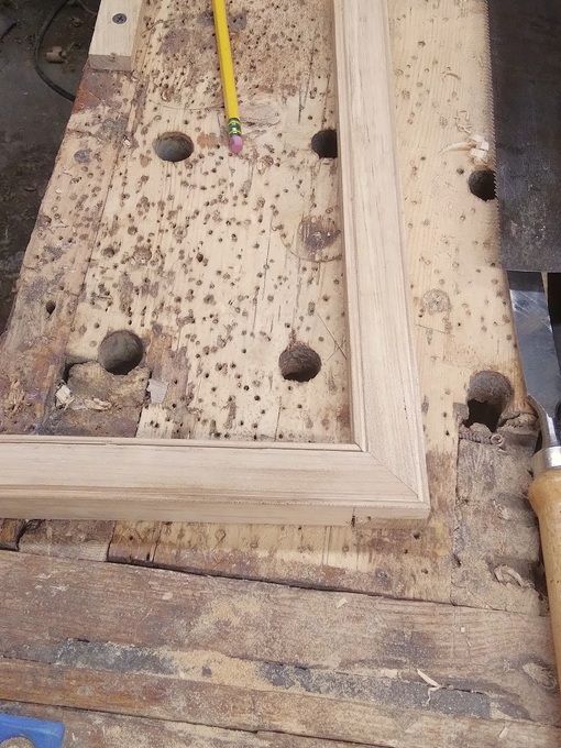

And some 45 degrees cuts..none are to go all the way through...we have other tools to help..:TwoThumbsUp:
Like maybe a clamp to hold the part in place, and..:WonderScratch:
Another saw and chisel...then do a lay out...:TwoThumbsUp:
Make a few more cuts, try a dry fit..:OldManSmiley:
Then tried the next corner...:ChinScratch:
Needs a bit of fine tuning will try again next time I am in the shop..:ChinScratch:
Stay tuned..:cowboy:

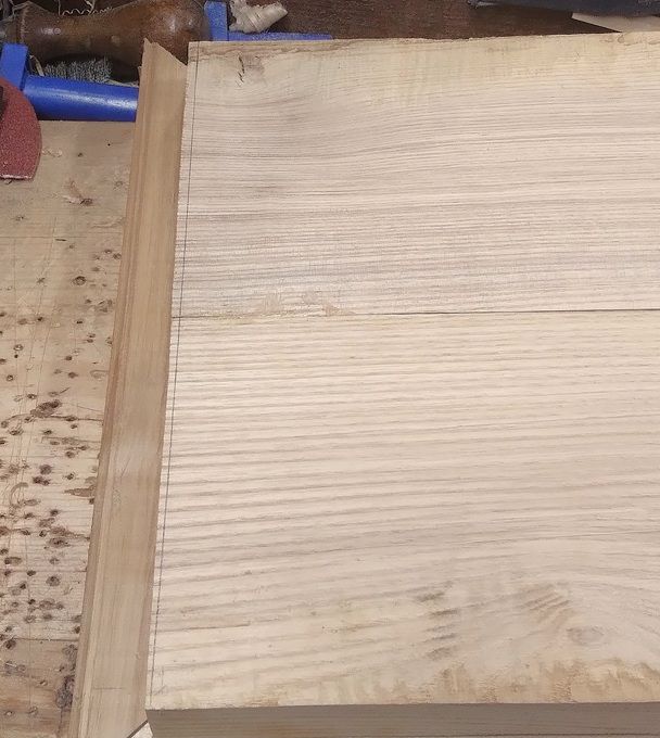

    1 hour in the shop..cutting and a-ripping...8 bft soon became about 3 bft...   The Good.. these are all 3/4" x 3-1/2" width..might have enough to glue up a panel.. Mayb
  • steven newman
    steven newman

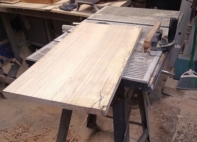

    Sides of the new cabinet will be around 8" deep... 1 hour in the shop, today.. Milled a top and a bottom panel..trying for best grain match... Same with the side panels...on

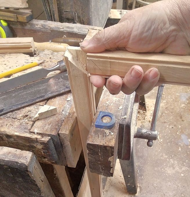

So..working when I am really tired, in the shop..does not turn out very well...This cut..:ArguingSmileys:
Should NOT have been 1/2" deep....only needed to be 3/8" deep.   so, when I go to glue up the first 2 corners, I am going to have to add a 1/8" thick shim, to fill the gap...:BangingHead:
IF I get really bored ( and rested up) and wander down to the shop...those depth stops will be the first things on the to do list..:MachineGun:
First 2 corners are now going to be the bottom corners of the door...:ArguingSmileys:
Stay tuned...:cowboy:

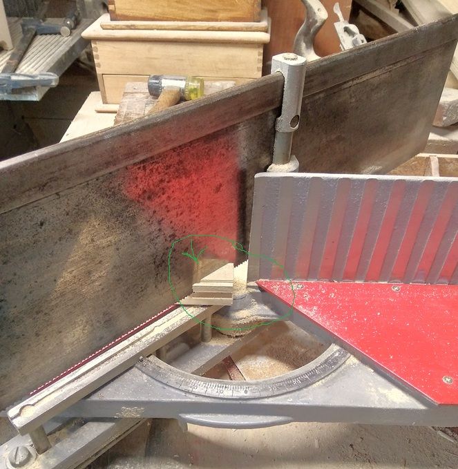

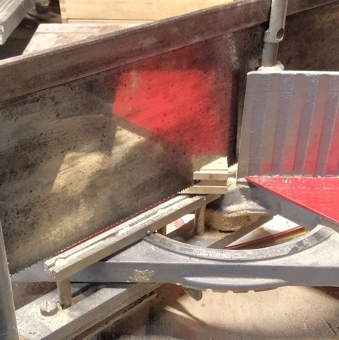

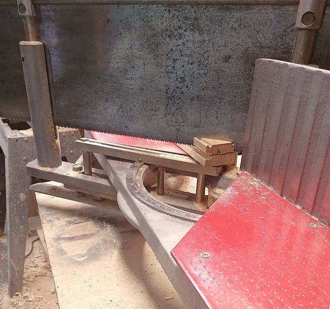

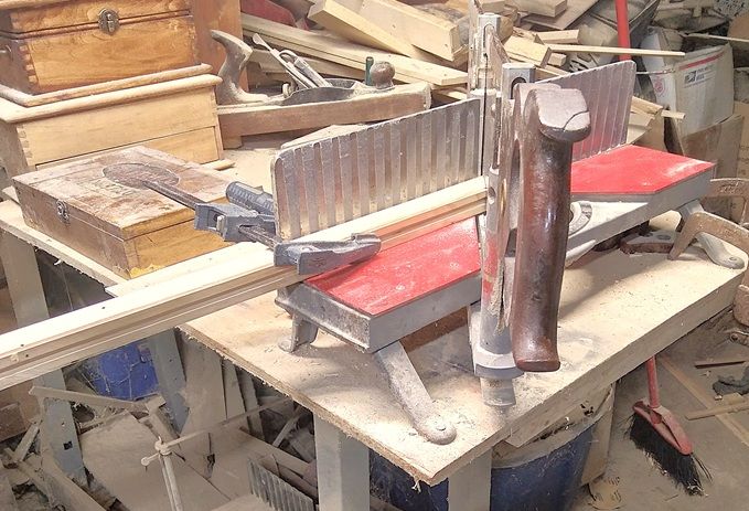

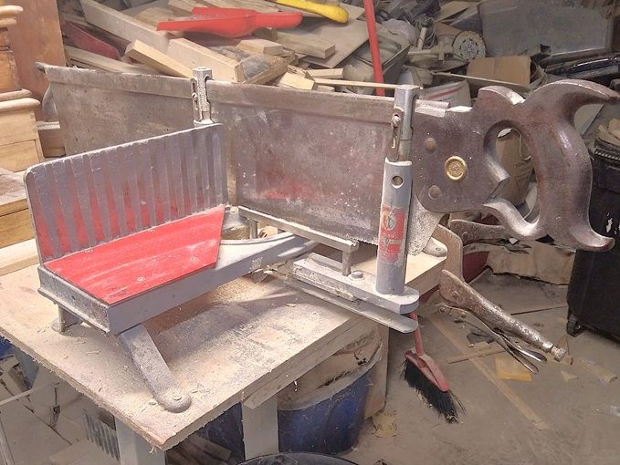

After the news about the Landlord..decided to do a little in the shop....reset those depth stops...and made sure the saw stops at the line..:OldManSmiley:
I think that will do...how does one know IF you are cutting a perfect 45 degree miter cut?:WonderScratch:
Look in the reflection on the saw.  :JawDrop:

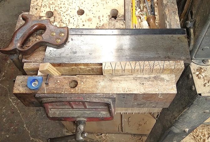

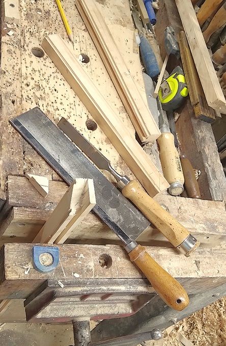

Was also having issues with that No.68 dovetail saw...fired it,:MachineGun: and switched over to the Disston No.4 Backsaw...:TwoThumbsUp:
Yep, this one...seems the No.68 wanted to wander all over the place in the cut...No. 4 had no such problem...Test fit..:SaluteandRun:
I think that will do nicely...repeat for the last corner..:TwoThumbsUp:

Ok, which brings up...:WonderScratch:

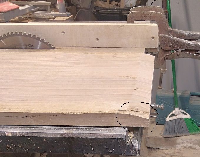

This handsome devil...this end NEEDS trimmed for square...badly..:ChinScratch:.the other end?
Just a tad...just enough to get it squared away...:TwoThumbsUp:

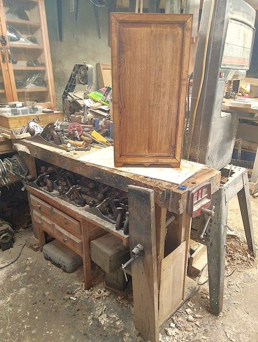

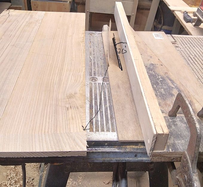

Ok, after all that running around this morning...waited until AFTER Lunch before I went to the shop...:Tapping:

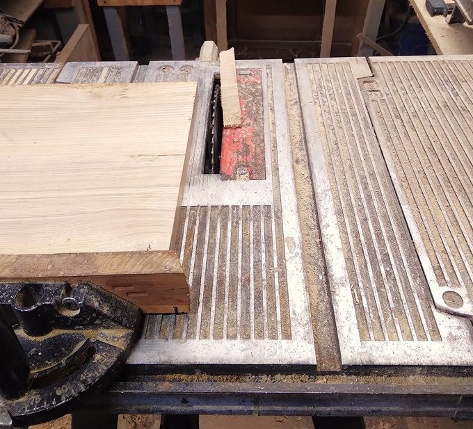

Need to do this..twice..:SaluteandRun:
To get both ends of the panel squared up...then reset the saw...:OldManSmiley:

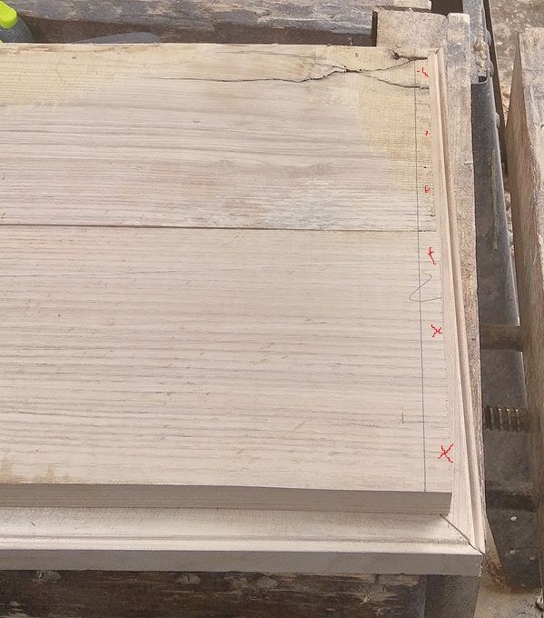

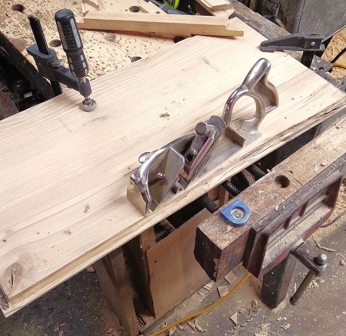

Blade is tilted 20 degrees, more or less..( lost the pointer thingy:BangingHead:) and then run all four GOOD edges through..

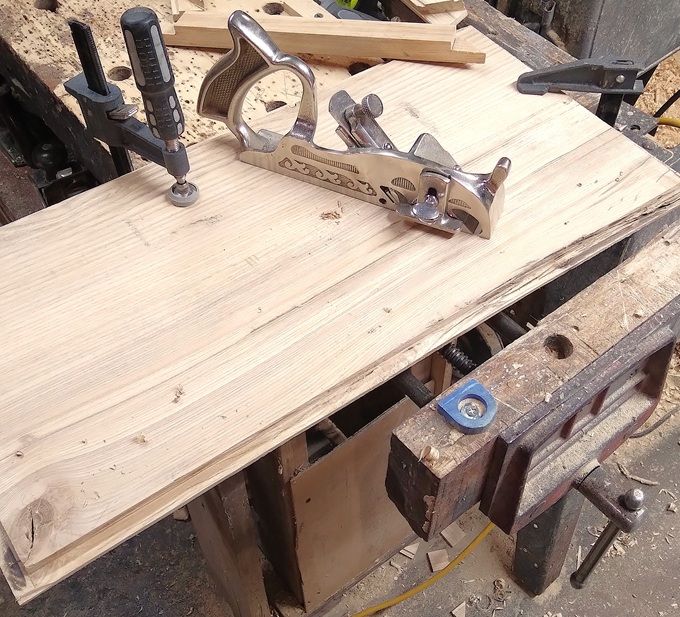

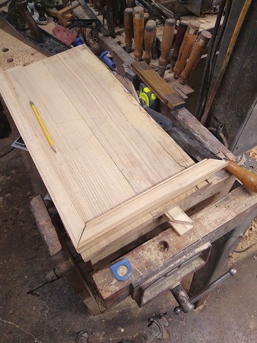

Once all 4 bevels were done, and before I can mill rebates around the inside face..:Tapping:

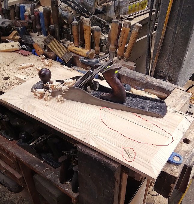

Needed to plane a few place flat...or at least flatter than this...:WonderScratch:
Then the rebates were milled, checked for fit, and then fine tuned for fit..:ChinScratch:
Made by Sargent as a No. 79, type 2, sold at SEARS as a No. 3720..:OldManSmiley:
Yes, it has been Nickel Plated...a couple of Dry fits..:Cheer:

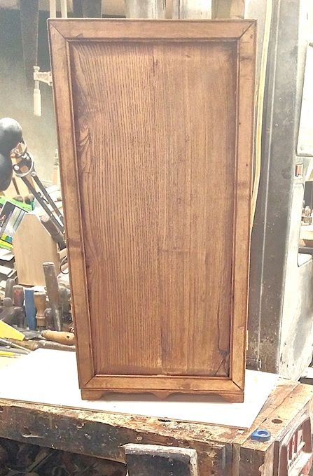

This is just one side, looking at the inside of the door...the outside?:TwoThumbsUp:

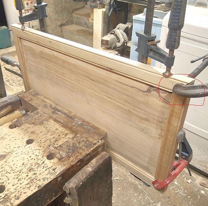

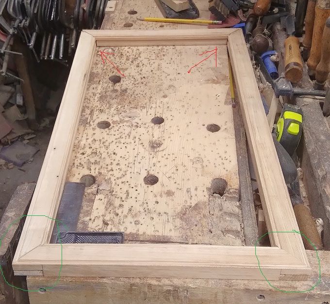

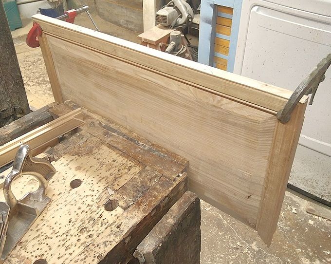

Then...CAREFULLY rotate this mess..:SaluteandRun:
Slide the other Stile into place...Hmmm, would appear I will need to adjust that corner, before a glue-up can be done...:ChinScratch:
That bead detail looks quite nice on the door.

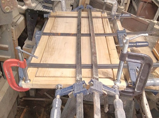

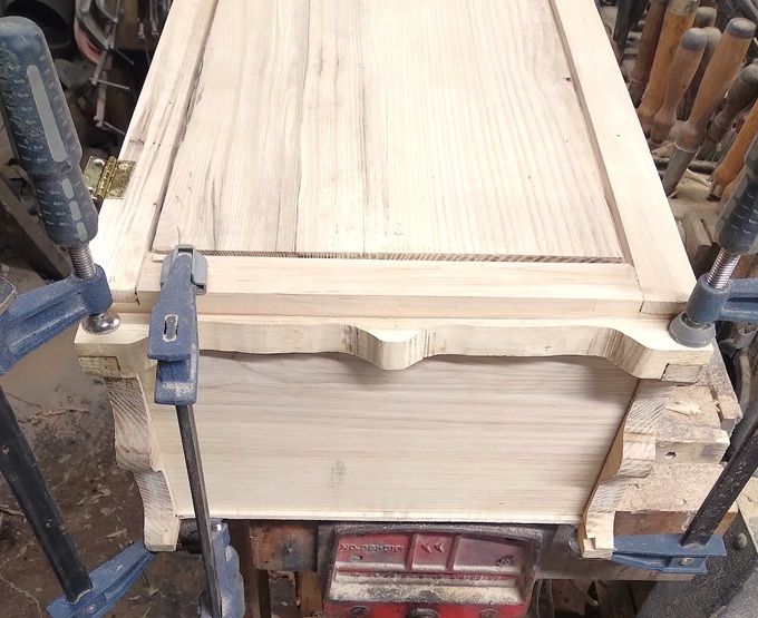

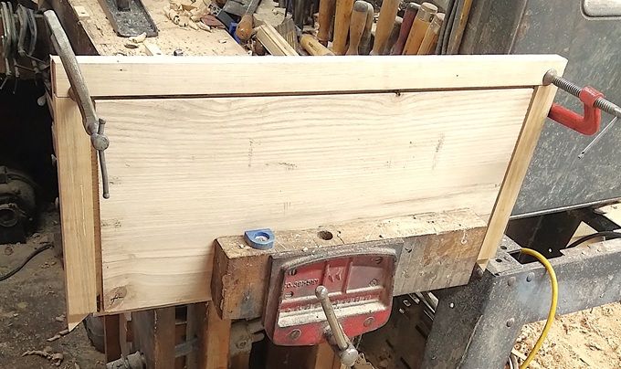

Got things as fixed as I could...spread some glue..added a few clamps..:Cheer:
And let this sit a day or 2...while the shop dries out..:WonderScratch:
Seems the Dungeon Creek has risen...thanks to all that rain, yesterday....one "Frog Drowner" too many, it would seem...:JawDrop:

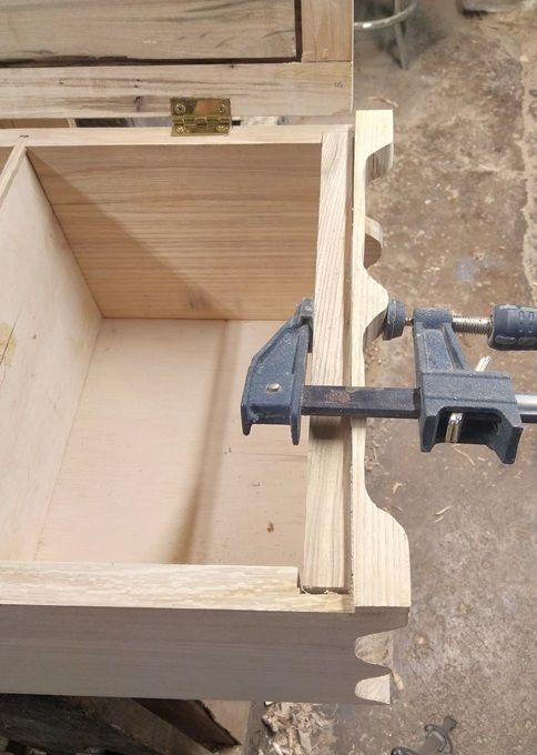

Up-date time?  Hinges have been installed..:OldManSmiley:DVDCaseHingesinstalled.jpg.00b2b524d42af3d07ab900cb1e31df26.jpg
And a fancy "Toe-kick" has been glued in place..:ChinScratch:
Then a coat of of Witch's Brew brushed on, and wiped down..:Cheer:DVDCaseHingesglueup.jpg.d884c336a9d8467fc6d35ea5f9f3c92e.jpg

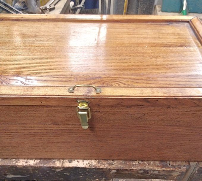

Once the stain was dry....I could install a Latch..:TwoThumbsUp:

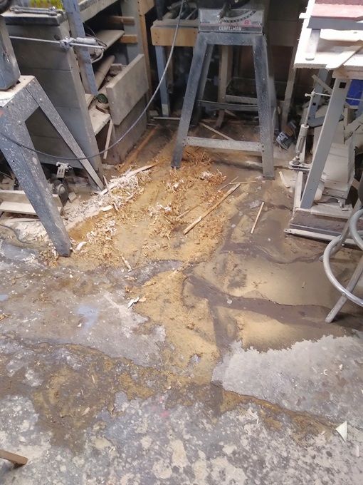

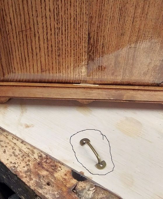

(Like the view of my shop?:ph34r:)
This morning...brushed on a coat of Minwax Warm Gloss Poly..:ChinScratch:
To shine things up a bit....I even found a Brass handle for the door..:TwoThumbsUp:
Yep personally I do. Beats what I've got.

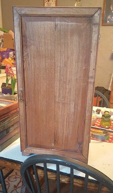

Moving day..after rubbing down the varnish with 0000 steel wool, and adding a handle to the door...:TwoThumbsUp:

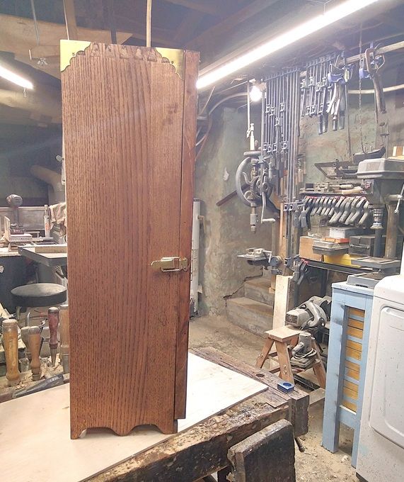

Hauled it upstairs ..:SaluteandRun:

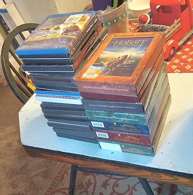

As I had a collection to load up..:Cheer:
To see how they fit the case..:OldManSmiley:
Still have plenty of room...close the door, and move this to it's new Home Station..:SaluteandRun:
And see how the door works in that area....:ChinScratch:
Added a small "Accent Piece" up on top of the case...:TwoThumbsUp:
Figured they would fit right in...:ChinScratch:
Project is now done..thanks for looking in:TwoThumbsUp:
Looks right smart and at home Bandit. Thanks for sharing the build-a-long with us.
