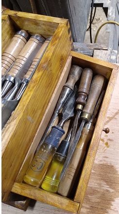

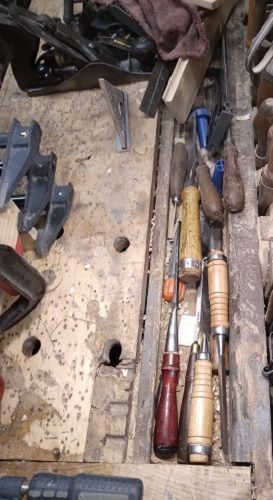

Chisel Case Project
Decided to build a case to stash a few chisels in...maybe keep them organized a little bit better?   Box that will be a Pattern of sorts..:ChinScratch:
Is just a smidge too small...so..:ChinScratch:

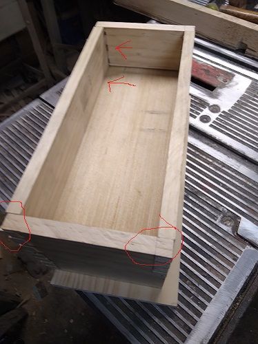

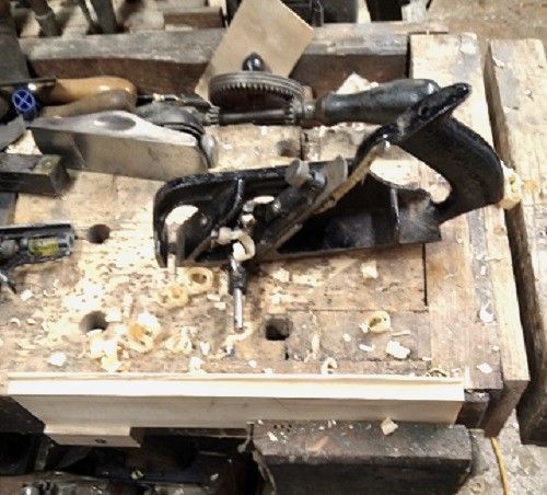

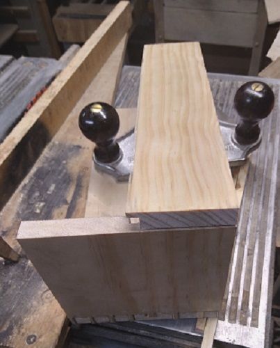

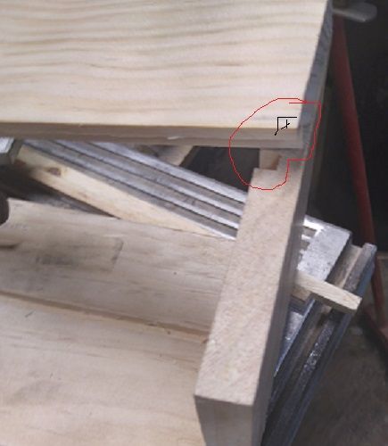

    Needed a rebate milled...so.. I now have a sore left thumb.  did a test fit of some 1/4" plywood... So..IF you happen to be inside the drawer, and looking up..this is what you wi
Following along 2.0
Needed a rebate milled...so..:SaluteandRun:
I now have a sore left thumb.  did a test fit of some 1/4" plywood...:ChinScratch:
So..IF you happen to be inside the drawer, and looking up..this is what you will see..Will glue the panel in place, later
Panel also need grooves to sit in..that line up with that rebate..:WonderScratch:

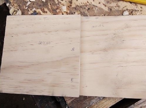

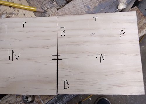

ChiselCaseProjectmatchedthegrainaroundthecorner.jpg.b5cc0aa602939ee7f843cfa6b25fc53f.jpg

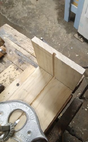

B as in Back...F as in front, and T as in the top of the case..those 2 lines?  Are where a groove will be going.  Was trying to match up the grain so that it "wraps" around the case.:OldManSmiley:
I had just got the grooves milled when The Boss called.:ArguingSmileys:..wanting her Ruku fixed..new batteries. Had to stop the shop for the day, drive down and fix the remote.  Visit for a bit, then head back home...:SaluteandRun:

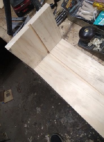

This is the other end...:ChinScratch:
Need the grooves and rebate done first, to help lay out the dovetails...going to take a few very fancy cuts.  :WonderScratch:

Some needful tools, for next time in the shop...:Cheer:
Will be doing Pins first, of course...:JawDrop:
Stay tuned....:cowboy:

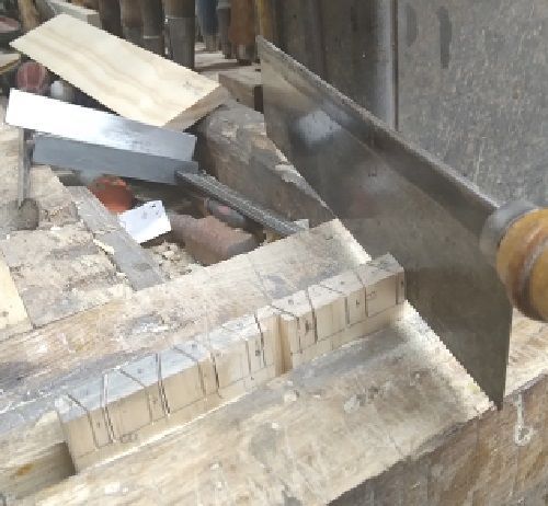

Hope nobody minds, this just MIGHT be a long post...:ChinScratch:
Lay out work..:ChinScratch:
Need to account for that groove, so that it does not show...:ph34r:
Saw work?:Cheer:
Note the other essential tool?  The well worn shop stool.:DevilLaughing:.had to adjust a bit while cutting..
Adjusting on the fly?   The tails will go off of whatever these pins call for.  :OldManSmiley:

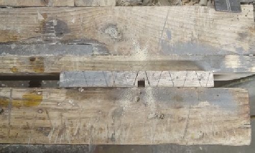

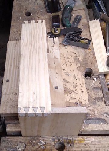

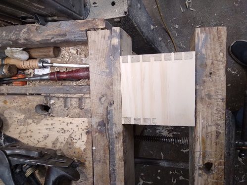

Chisel work..:WonderScratch:
Chopped half way down, on the show face...to prevent blowouts from the other face being chopped..:OldManSmiley:
The pin with the groove, will be cut down to fit into another groove..chisel selection, today?:ChinScratch:

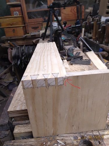

There is a 24mm one down in the tool well, too.  Use these pins to lay out the tails, cut the tails while leaving the lines..chop out the waste..Dry fit?:TwoThumbsUp:

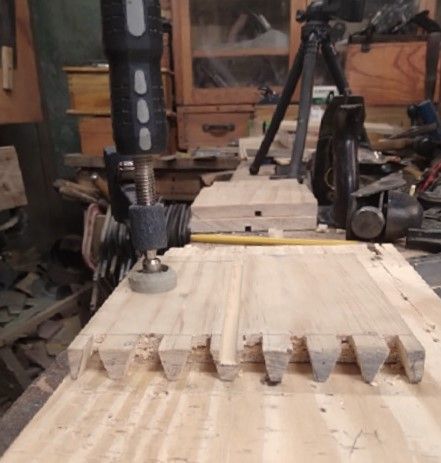

There is no tail at the groove showing...Had to cut the pin down to match the groove.  And, chop out a bit of waste with a chisel..:OldManSmiley:
Cleaned up with a router.  :JawDrop:
And the grooves still line up:TwoThumbsUp:
Set up for tomorrow?:TwoThumbsUp:

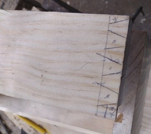

There will be a couple dovetails here, but..:ChinScratch:
I still need to cover a groove...Might just cut th black lines first, then lay out the pins...?:WonderScratch:

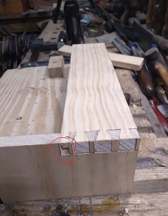

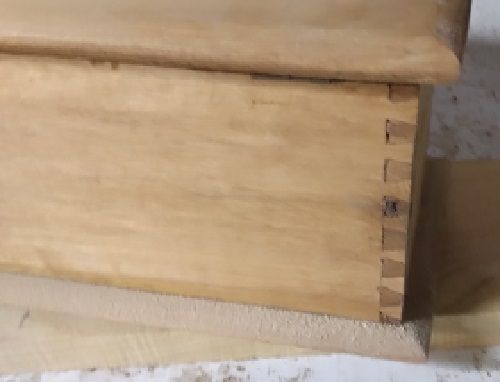

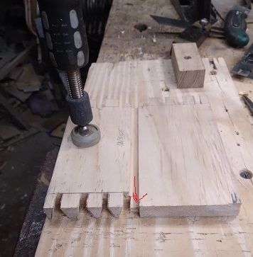

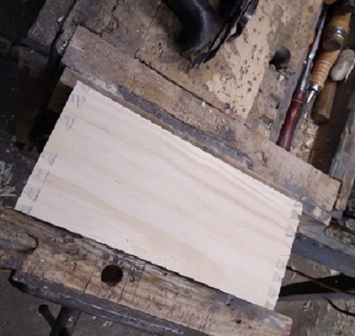

Mystery of the front dovetails...first try..:DevilLaughing:
And tails first?    Wasn't happy with the layout.:ArguingSmileys:..went back to Pins first...:SaluteandRun:
Wasn't quite right...:WonderScratch:
Will glue a plug in there.   Try again...on the other end..:ArguingSmileys:
Then a dry fit...:Cheer:
Moved a cut line to the left a bit..no gap showing..:OldManSmiley:
Actually needed a mallet for the dry fit...:JawDrop:
All 4 corners are done...:ChinScratch:

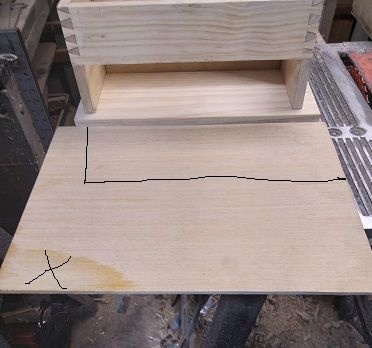

Need about this much to make a floor panel...:TwoThumbsUp:
Needed to move a few things...them try a dry fit with the plywood panel in place...:ChinScratch:

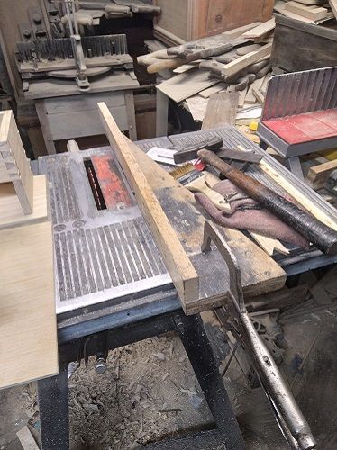

Length was 1/16" too long...width about 1/8"...crosscut half a blade width on the tablesaw...the width?   We have ways..:ph34r:
Plane a bit, test fit a bit,,plane until it DOES fit...:MachineGun:

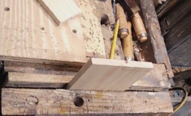

Before the glue, I needed a chisel, or 2...:ChinScratch:
As one corner needed pared for a better fit..and..we are off ( or so I have been told :ROFL:)

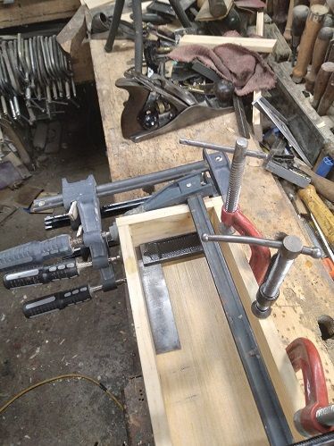

On this end, other end was fine..those C clamps?:WonderScratch:

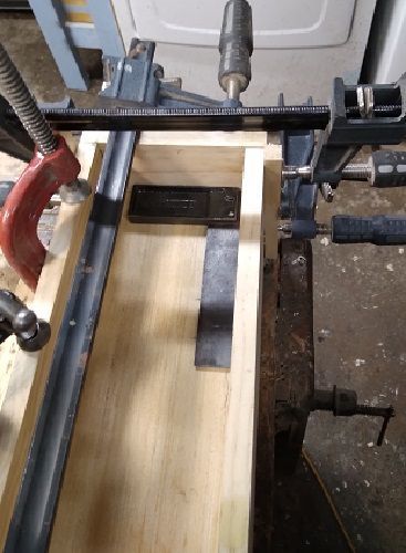

The front edge of the floor board is getting glued into a rebate...was easier than trying to nail it in place..:ChinScratch:

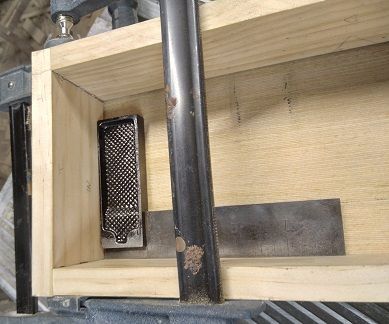

Checked one end for square-ness.:OldManSmiley:
And might as well check the other end..you never know..:WonderScratch:
Well, how about that..both ends are square? :TwoThumbsUp:

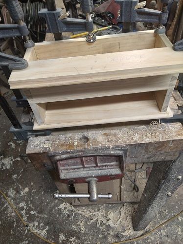

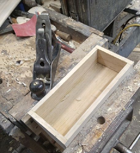

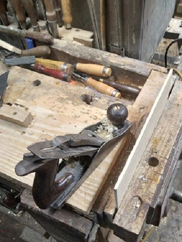

Roh Kay, Raggy....case is out of the clamps...back has been cleaned up..:TwoThumbsUp:
And the front, too....ends were cleaned up..:TwoThumbsUp:
and the top edges were leveled..:ChinScratch:
That old Stanley No. 3 was getting a workout today...:Cheer:

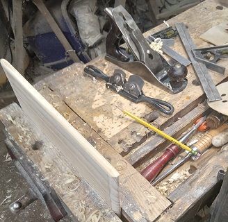

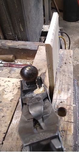

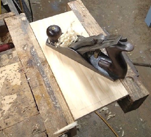

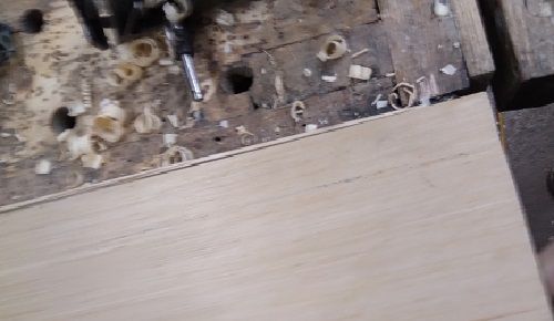

Next...needed to flatten the panel that will be the base..:SaluteandRun:
Had to do both faces, too...was beginning to wonder who was getting the workouts...that plane, or me?:WonderScratch:

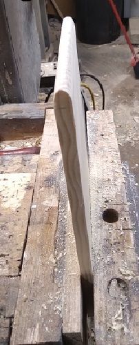

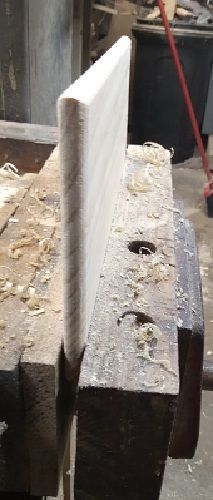

Paul Sellers did a "thumbnail" edge on his, so..start here..:ChinScratch:
Establish a 45 from the center, then roll the plane down to a stop line...do the end grain ends first..rotate..:OldManSmiley:
And do both the top and bottom edges..of both of the ends..rotate again...and do the long grain edges..:TwoThumbsUp:
Each edge then get hand sanded, with 80 grit, then 220 grit. :JawDrop:  Tools?
Spokeshave where the grain allowed.  Square to mark the stop lines.  A No. 80 was used on flattening the flat areas..:OldManSmiley:

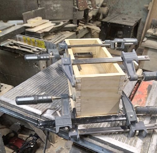

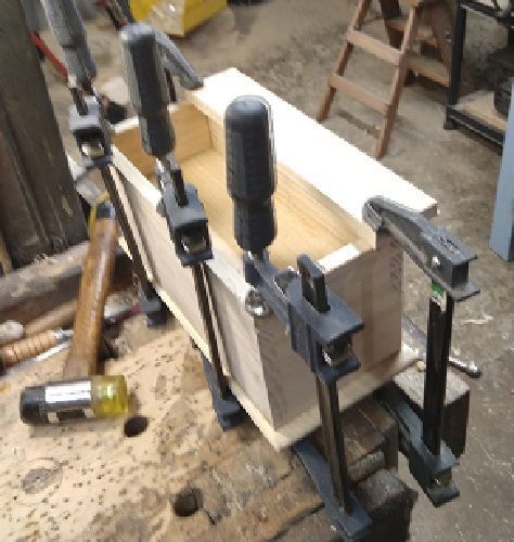

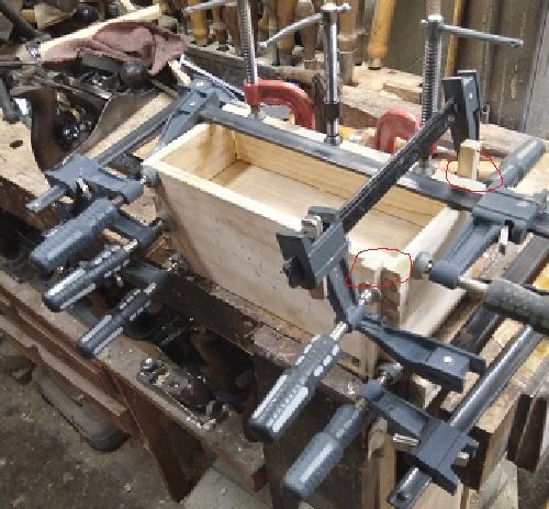

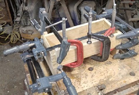

Next? spread a bit of glue..:SaluteandRun:
A caul to help out along the front..where the glue was just on the end pieces...vise was a 3rd hand...around in back..
Clamp on each end, and one in the middle..Mallet to adjust alignments..:OldManSmiley:
Will let this mess sit a spell, and me too...:rolleyes:
