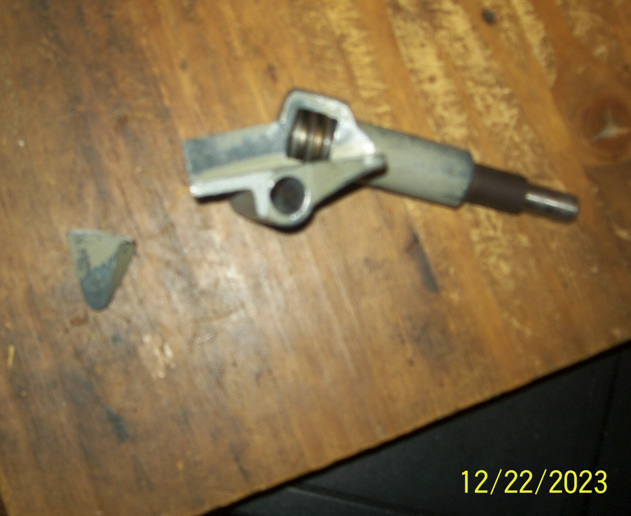

Here "Two Weeks From Anywhere" I've been trying to gather my stash of old Delta machine parts into one location so I can determine if I have everything required to put together one of these.
I'm down to trying to find two parts for the table saw. I have one of the parts, but it is damaged hopefully not beyond repair after I broke it yesterday trying to straighten it.
It snapped just as I got it back straight. :(
I don't think this will work to fix it. :Tapping:
Here's a look at the part. NCS-55-S Front Trunnion Clamp with Worm and Shaft. Hard to tell in the photo, but there is also a crack just left of the worm gear.
Must be a common problem as I saw several photos on The Vintage Machinery website with the same crack by the gear.
It would appear that a previous owner forgot to loosen the Trunnion Clamp before trying to change the table angle. The worm gear tore two or three teeth out of the Sliding Trunnion Bracket which I do have a replacement for. I do believe I can make this part work while I try finding another. We have ways! :DevilLaughing:

As to that NCS-55-S, Front Trunnion Clamp,
We have the technology to make it better, stronger, yadda, yadda, yadda. :DevilLaughing:
J-B Weld!

1 hour ago, lew said:
J-B Weld!
Two of their products along with a small piece of aluminum and a thick washer to be exact. ;)

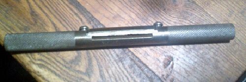

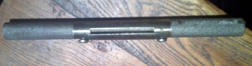

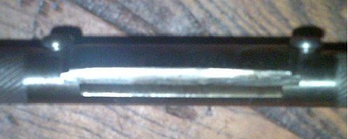

Road Trip results?
$16.09 for...( wait for it..)
Solid steel, no less...10" long, cutter is 2-1/2" wide..
Handles were milled as part of this thing, and can't be removed..
Cutter will need a good resharpening..
Kind of "chippy" and someone had given this a coat of.....Clear Coat?
I am always looking for hand tools I don't have...might have found one?
28 minutes ago, steven newman said:
Road Trip results?
Bruce has one of those, what is it?
A knock-off of a Millers Falls Cigar shave?   Spokeshave.

Stripped the paint off of the Front Trunnion Clamp in preparation for the repair surgery.
First I'll fill this crack with some J-B Weld.
:ChinScratch: Looks like the keyboard needs a wiping down. <_<
And after I get that shaped, I'll be using some J-B Weld 3000# Super-Glue to attach a flat washer on the end that I still have to modify a bit to hold the rest from cracking. I'll also be reattaching the broken off guide ear and backing up the flat side with a 1/16" aluminum plate that will cover the whole flat side using the same Super-Glue.
After that a little file work and a coat of paint and the repair (Other than the washer.) should be mostly unnoticeable. ;)
