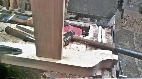

    Task for today:   Cut a tenon for the arm rest to attach to the front post... Will do the other front post, tomorrow.. Need to add a kerf for a wedge,later...   Task #2

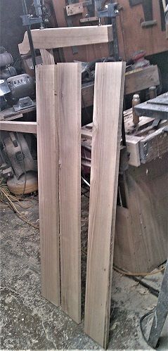

Back between the shoulder blades has decreed that is is QUITTING TIME! :KooKooClock::SaluteandRun: task was to get 3 Rails ready...:ChinScratch:
3 rails, split ends removed...cut down to 48" length...:OldManSmiley:
Then mill a 3/4" long tenon on each end..:Tapping:
I also ripped things to width,,then the tenons could be cut...:TwoThumbsUp:

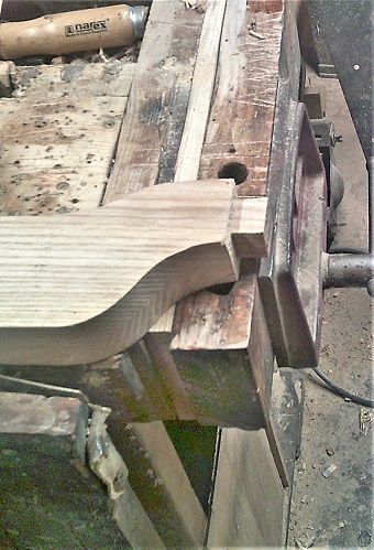

This is the Front rail, goes under the front edge of the seat,,:OldManSmiley:

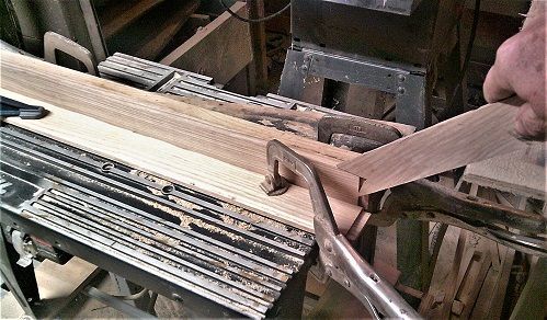

This one goes at the back of the seat....a row of slats will connect it to the crest rail...which needed a shape bandsawn to it..:ChinScratch:
A bit rough? We have ways...:ph34r:
Spokeshave!  :TwoThumbsUp: Was trying to remove a few high spots, as well as the saw marks..
Then turn this around, and do the other curved section...:OldManSmiley:

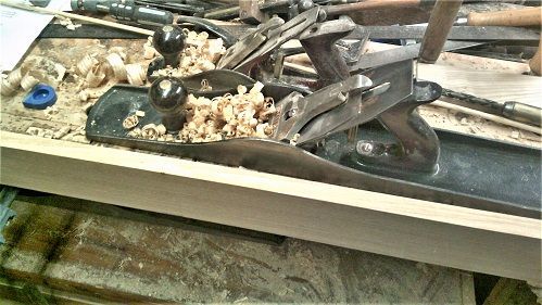

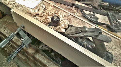

Edges that needed to be straight..needed jointed...issues with the No. 8c....tried Junior Jack first..:Cheer:
Resolved the issues with the Jointer plane( clogged mouth, chips lodged between the iron and chipbreaker):ChinScratch:
Then put it to work...:TwoThumbsUp:

Task for today:   Cut a tenon for the arm rest to attach to the front post...:OldManSmiley:
Will do the other front post, tomorrow..:TwoThumbsUp:
Need to add a kerf for a wedge,later...:ChinScratch:

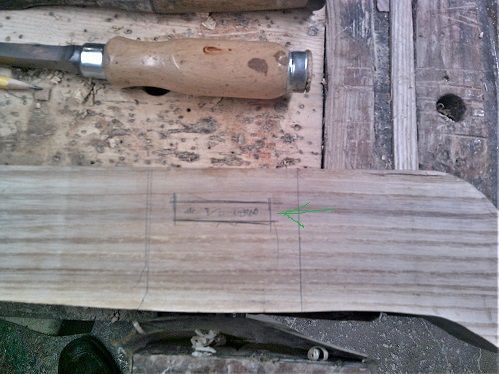

Task #2...lay out 6 mortises...to house the 3 rails in...:SaluteandRun:
Lay them out on one frame...then transfer the markings to the other frame's parts...:OldManSmiley:

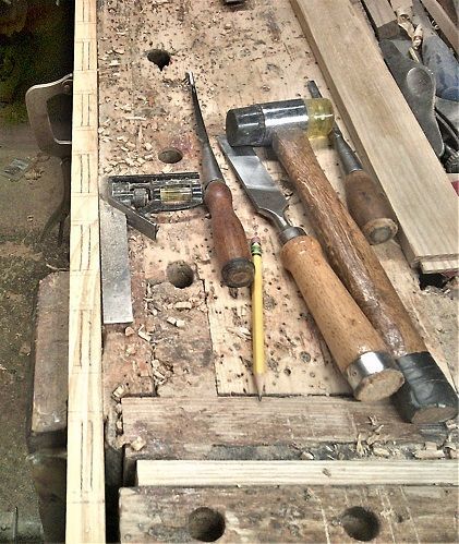

Task #3....chop 3 mortises...to 3/4" depth..:Cheer:
With just a couple chisels...:JawDrop:
Both are 12mm wide...pencil came in handy, too...dry fit?:TwoThumbsUp:
Front rail..goes under the front of the seat....:ChinScratch:
Tenons on the rails will be trimmed down to 3/4" length...will be getting a dowel through them, anyway..:ChinScratch:
Figured it would be easier to chop these mortises out, BEFORE a glue up could happen...don't have enough room to chop after a glue up:OldManSmiley:

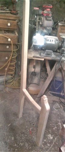

was the only way to set #1 on the bench
#1 can stand on the floor on it's own..
There is a spot where 2 rails meet,,,
That I will have to notch a bit....will notch the back rail...

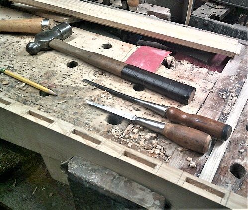

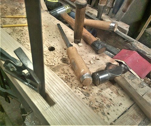

First pass with the Japanese chisel..
Hammer is a 24oz ....5 good whacks, move a bit, repeat.....takes about 4 passes to get to 3/4" depth...
Depth checker...Narex was used to clean out the chips....
Kind of hard to do dry fits...
When the other end is 4' away....once the last mortise was chopped, and a dry fit...
Need to trim and square a few tenons....

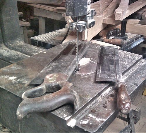

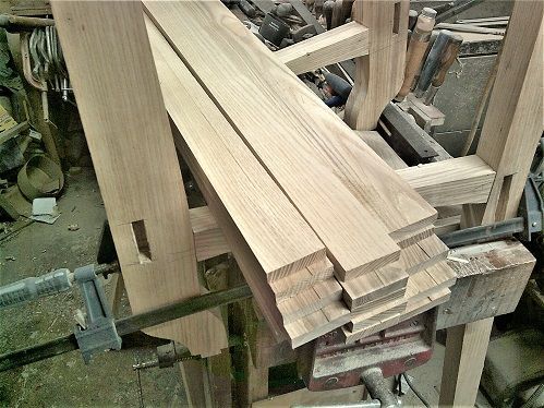

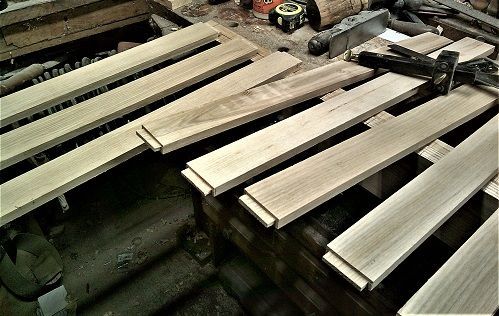

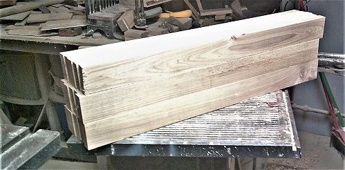

Task for today:    mill 15 slats, for the back of the bench....1/2" x 2" x 24-1/4" with 3/8" long tenons on each end...:SaluteandRun:
Rough sawn..:OldManSmiley:

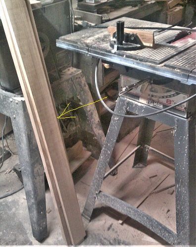

Set up to resaw to 1/2" thick..:Cheer:
So, now I have 15 slats ...:TwoThumbsUp:
just over 2" wide, and a bit un-even as to 1/2" thick...:OldManSmiley:
Flatten the cut side....a quick zip along the "bad edges with the saw set to exactly 2" wide.....:ChinScratch:
The "cut-offs"?:WonderScratch:
Stashed until the next Box Build Project...Need tenons on the ends..:SaluteandRun:
All set up...:ChinScratch:
Only 29 more to do....:JawDrop:

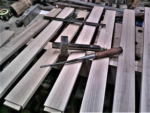

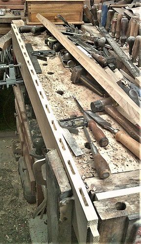

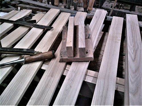

Mortise lay outs..
By the time I got to the other end...:PullingHair:
Space between#13 and #15 was a bit wide....sat #14 centered between them...tools have been laid out..:TwoThumbsUp:
1/4" Witherby.   Mortise gauge has been set to match the chisel...:OldManSmiley:
Hopefully, I can use the Mortise Jig...Maybe?:WonderScratch:
Both frames...was test for with of slats....2" will be a tad too skinny....may try a bit closer to 3"?   :ChinScratch:

Lots of chopping going on, today....been to the shop twice....had to stop for lunch, after all..:rolleyes:
Bottom rail is done..15 Mortises total....:TwoThumbsUp:

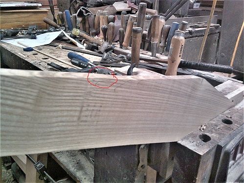

Aligned up the mortises to the Crest Rail...:ChinScratch:
Lay out the new mortises...:Cheer:
Was trying to find a way to clamp this TO the bench...:WonderScratch:
Then see how far I'd get...:ph34r:

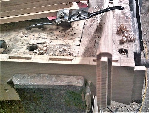

Seymour Smith & Son, Double Spokeshave?:OldManSmiley:
A little sanding, good to go.    :Cheer:
With the router table, I'd have to run each corner at a time..four trips like this...:BangingHead:
And..still have to sand things smooth,,and burn-free:PullingHair:
Spokeshave will do 2 corners at a time.   :TwoThumbsUp:
