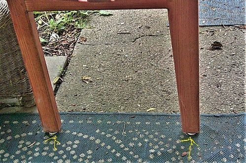

Popular Post DAB Posted April 26, 2023 Popular Post Report Posted April 26, 2023 go measure a chair that fits well for seat height. bet it'll be very close to 18" above grade. KevTN, Grandpadave52, HARO50 and 2 others 5 Quote

Popular Post Gerald Posted April 27, 2023 Popular Post Report Posted April 27, 2023 Here is Chair measurements Cal, HARO50, Grandpadave52 and 4 others 2 5 Quote

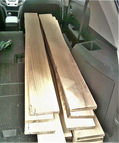

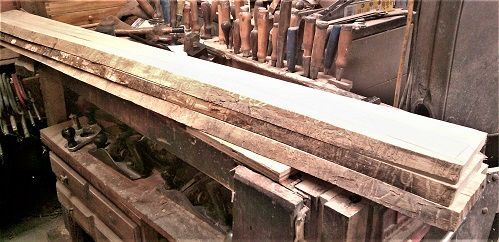

steven newman Posted April 27, 2023 Author Report Posted April 27, 2023 Nope...got it from a friend of mine....he has had these planks in the barn for over 10 years, now... 14 planks, @ 1 x 6 x 5'......after I had to cut the down to fit IN my car... As 10' was a bit too long.... Along with a bit of Cardio..to boot.. Grandpadave52, Cal, Gerald and 1 other 4 Quote

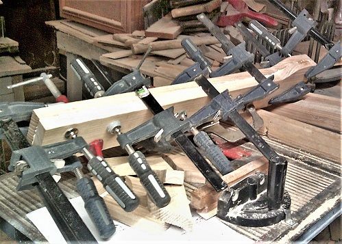

steven newman Posted April 27, 2023 Author Report Posted April 27, 2023 Second back leg is now sitting in the clamps....will see how they look, this evening... Grandpadave52, Cal and lew 3 Quote

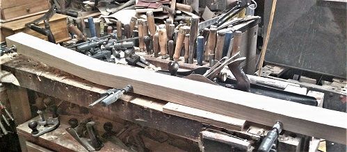

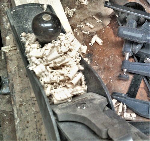

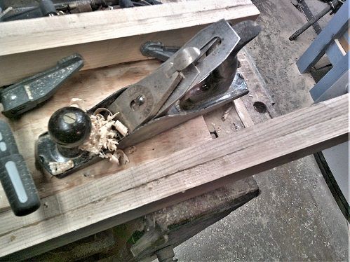

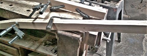

steven newman Posted April 28, 2023 Author Report Posted April 28, 2023 Pictures from last night.. Will be a couple front legs? Needs a wee bit of clean up...BEFORE a plane is allowed to travel here...we have ways.. Cleans it right up....tried 2 different planes... Junior jack was...ok...but.. Clamped both back legs together...it was a bit too wide for Junior...so... Heft & Hubris..aka Stanley No. 8c..... Seemed to work quite well...on this edge...it is when I flip this over to do the inside curve, that I may need the Drawknife, again....and some new belts for the beltsander Drawknife is an 8" Fulton....may give the 6" Pexto a go, later... Shave Horse? Stay tuned... Cal, KevTN, Grandpadave52 and 1 other 4 Quote

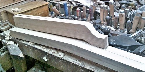

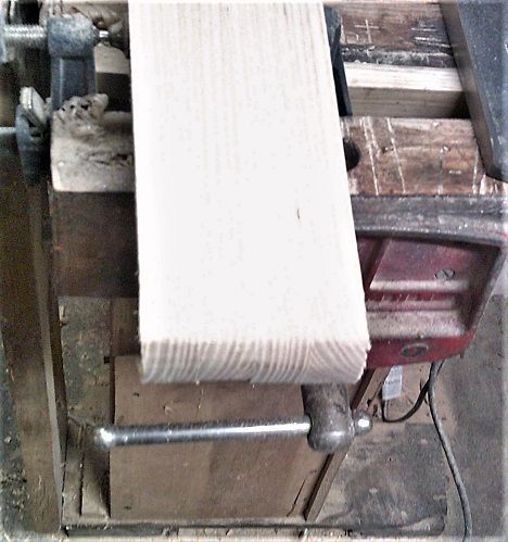

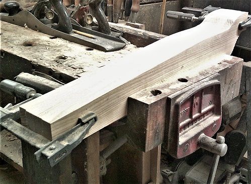

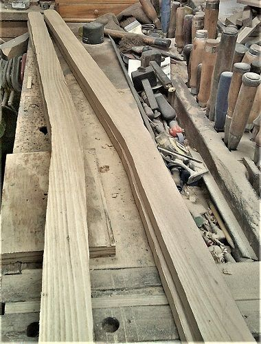

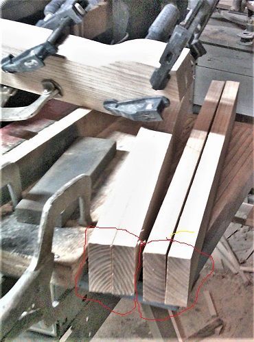

Popular Post steven newman Posted May 1, 2023 Author Popular Post Report Posted May 1, 2023 Back legs are now done... Hardest spots to work on ....was at that bend in the road....(beltsander) and rounding the top to match each other.. Sunday...was work on the blanks for the front 2 legs... Had 2 planks in the shop for that.... Here are 2 of the blanks..the other 2? Are now sitting in the clamps. I also kept the 4 cut-offs.. Will glue these up into the curved seat supports for each end of the bench Waiting on 4 items..while the glue cures... Stay tuned... Grandpadave52, lew, Gene Howe and 2 others 5 Quote

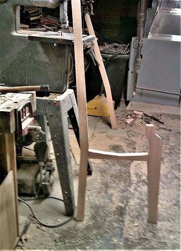

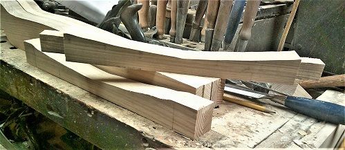

Popular Post steven newman Posted May 2, 2023 Author Popular Post Report Posted May 2, 2023 Front legs are out of the clamps....they have a taper detail on the inside face... That needed cleaned up so they match each other... Hardest part was getting the curves to match up.. Then the front of both legs... Work in progress. Top of the legs will get a tenon, later...to attach the arm rest to.... Laid out a curve... While I was cleaning up the seat supports....as They needed to be squared up, and cut to length...then the curve was bandsawn.. Along with those tenons.. Bottom of the front legs also needed squared up. Was a busy Laundry Detail, today.....toes started to get cramps...decided to quit for the day... And do Mortises tomorrow... Moose & Squirrel did drop off a "plan" of sorts... "Page 1" I think? Stay tuned... Cal, Grandpadave52, DuckSoup and 3 others 5 1 Quote

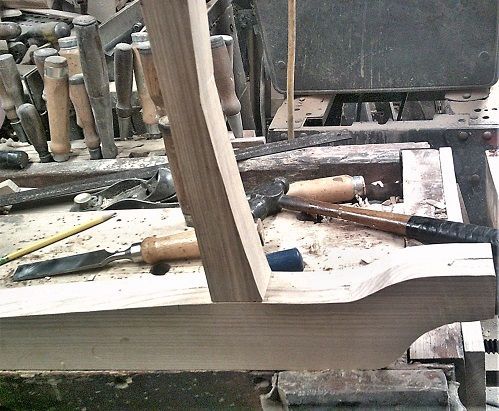

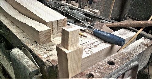

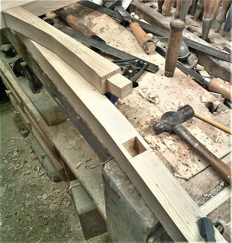

Popular Post steven newman Posted May 2, 2023 Author Popular Post Report Posted May 2, 2023 In a bit of a rush...so... 1st mortise...wasn't staying still. so.. Moved things to the top of the bench...managed to get a dry fit...then transfer the lay out lines to the back leg.. This is right on the curve....was a bit tricky to chop down 1" deep...but... We getting there....yes, I used THAT hammer..dry fit... Then set it down on the floor.. Then tried a dry run with the clamps.. 2 mortises are done....have a bunch more to do.... Stay tuned... Gerald, Headhunter, lew and 3 others 6 Quote

steven newman Posted May 3, 2023 Author Report Posted May 3, 2023 2 hours rehab, this morning....then 45 minutes of shoptime.....busy day, today..... 20 minutes to chop down 1" in Ash..dry fit.. Trying to close up any gaps....then another 20 minutes to chop the other mortise...and dry fit things together... Have 6 more mortises to chop..before I can glue the ends together...have to rip and cross cut and tenon 3 rails... Stay tuned... Grandpadave52, Larry Buskirk, Fred W. Hargis Jr and 1 other 4 Quote
