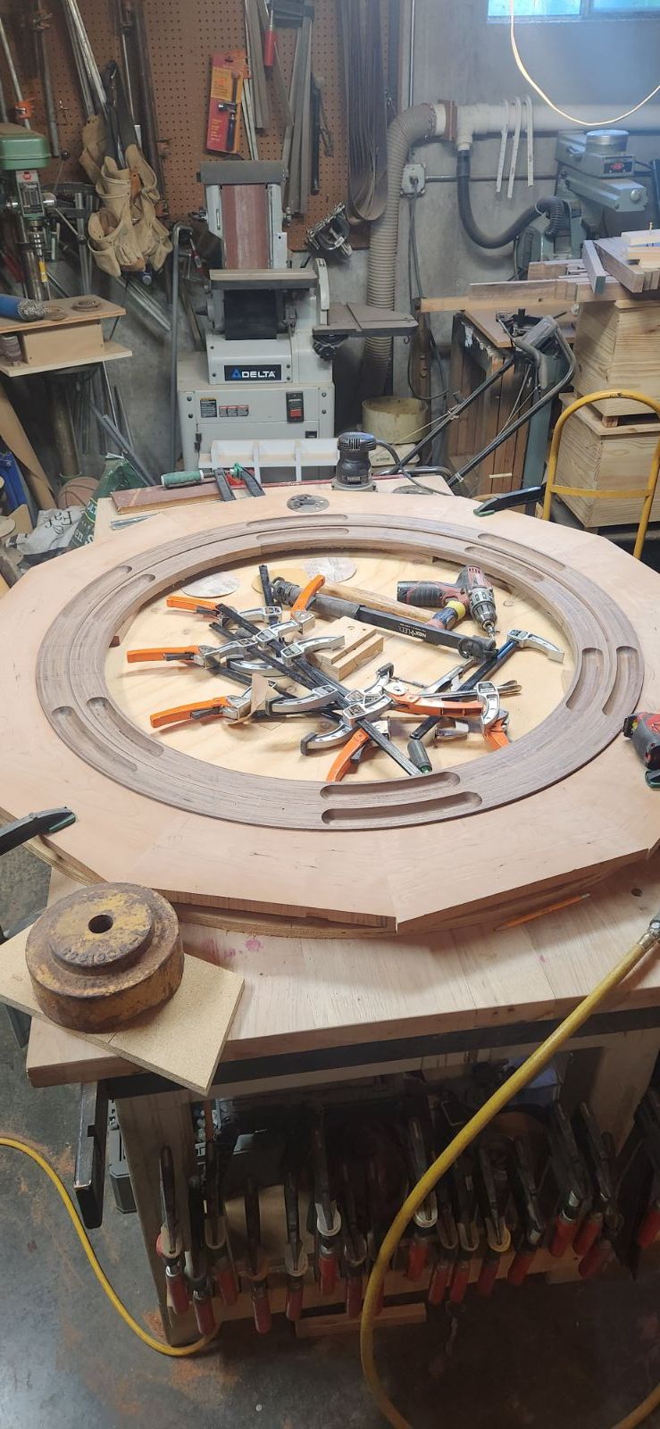

I spent a lot of tine sanding.  Its  close and if the ring shrinks I may not need to sand anymore. It's close. Tomorrow I'll cut the outside of the ring.
Edited by BillyJack
Radius is complete.

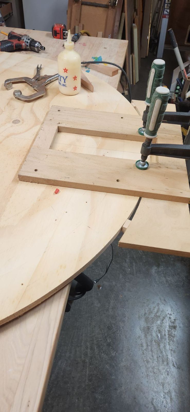

I'm hoping to key this settle while I work on the cup roll outs.
Trying to decide if I want  to route out for the cup slides..

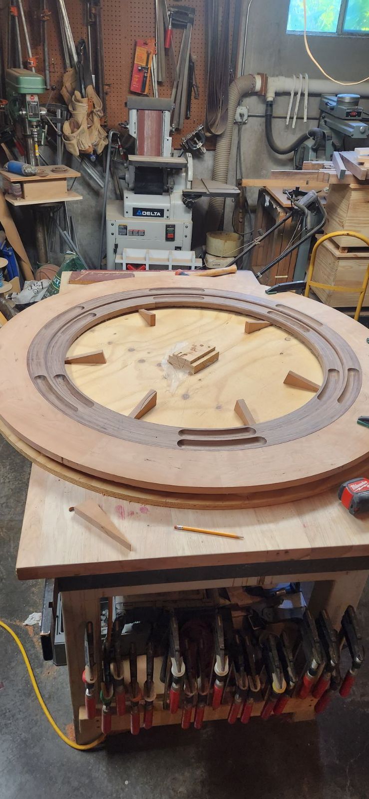

I've got it now we're I can remove it from the work table. Had it tied up for two weeks. Gotta work backwards now.

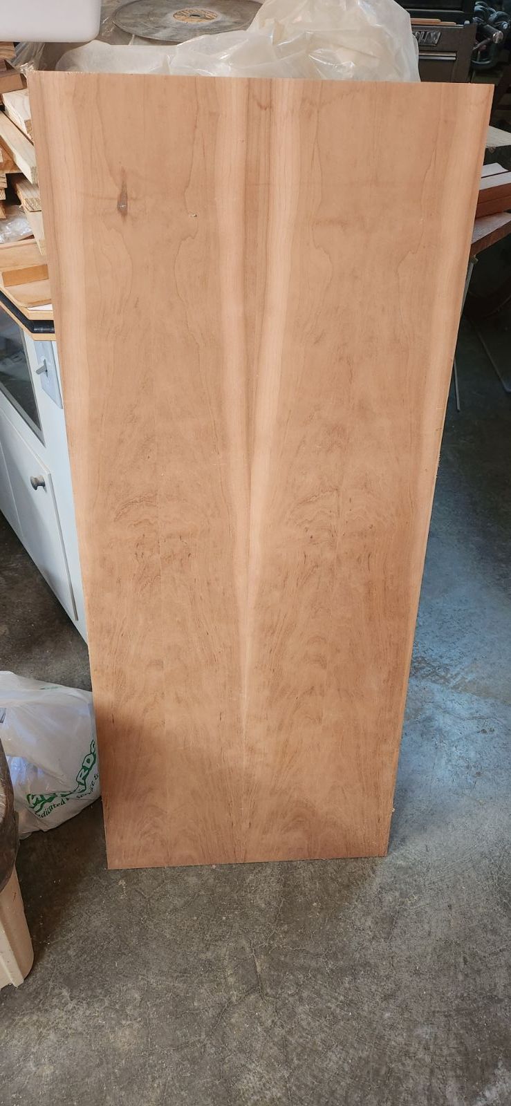

I'm at a stand still for the moment deciding on whether it should have a cherry apron with walnut cup covers  or a walnut apron with cherry cup covers. Maybe  just a maple or birch apron...
Found one piece of 1/4 cherry 19x46. Not sure if it will be enough for the apron..

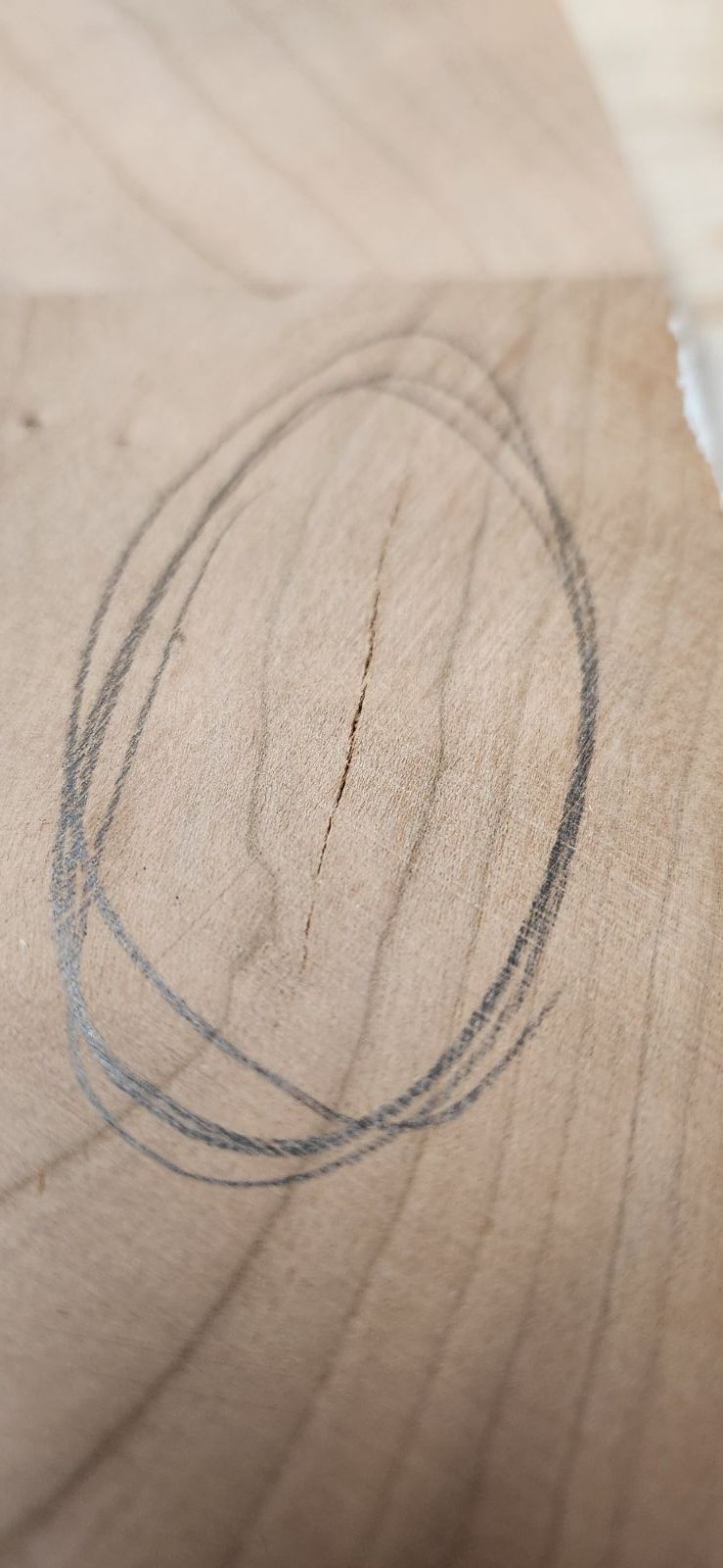

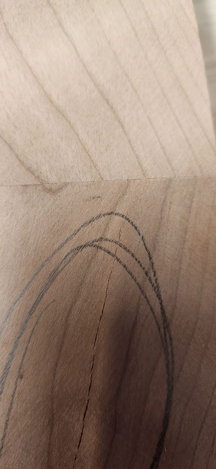

Looking around t he circle I noticed a crack. Not from a pocket screw.i must have missed it. It doesn't go all the way thru, nor is it tk the end. Some t hing I'll need  to address.
Just catching up and now seeing this picture. A gorgeous piece of cherry. I love the warmth of cherry.

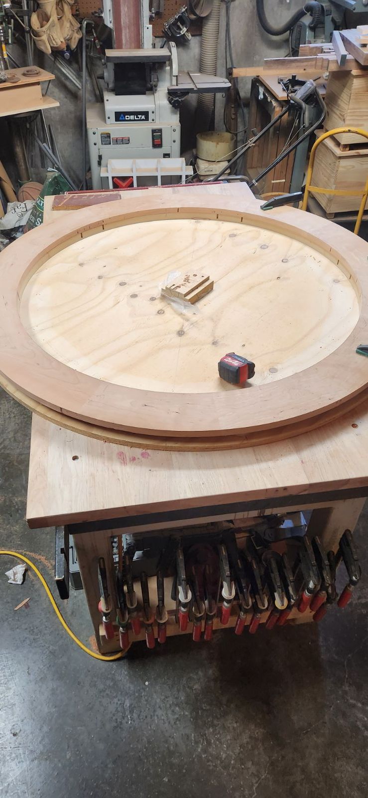

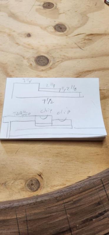

Back in the shop today trying to figure transition between levels. I guess I’ll cut out an “L” and add a 1/4 to the inside for the chip tray. I usually have my ducks lined up , but sometimes I get a rowdy one who doesn’t follow the line…
I'll be looking into marine epoxy eventually.

It doesn’t go all the  way through. It’s in the surface.
7 hours ago, Woodman said:
I'll be looking into marine epoIt’s very important to have the ratio as accurate as possible.  Ten years ago I bought a high quality microgram scale, and have since gone over to weighing the product.  Ambient temperature is also very important;  55˚F is the minimum I’ll work.
Note if the epoxy is volume to volume that is what you must use. If the resin and hardener are different wt/vol then weight will not get the proper mix.
That said I use volume but even then if you scrape the epoxy out be sure to get it all.
I’ll probably do what I always  do. Fine dust and glue. We had what I call hot sticks at Jakobe which were two part hot epoxy. I remember cutting into two pieces and mixing to putty into the crack. I try and find flaws before the finish, this one is minor. The more I sand the less you see, but I don’t want to sand that much.
