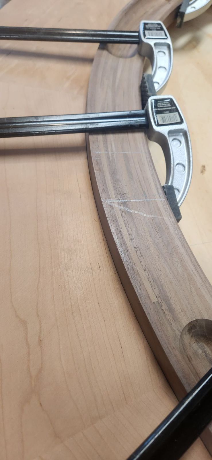

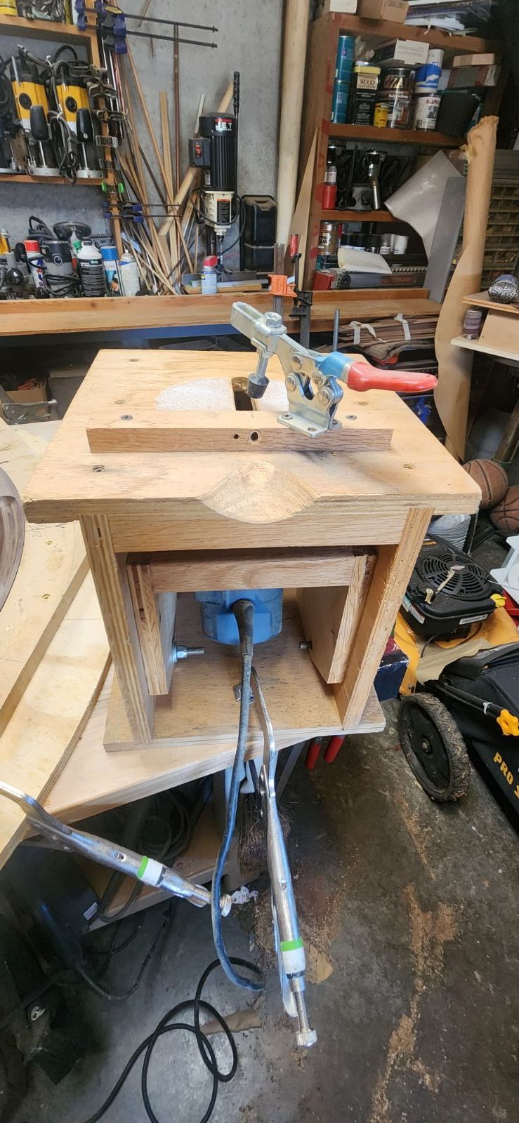

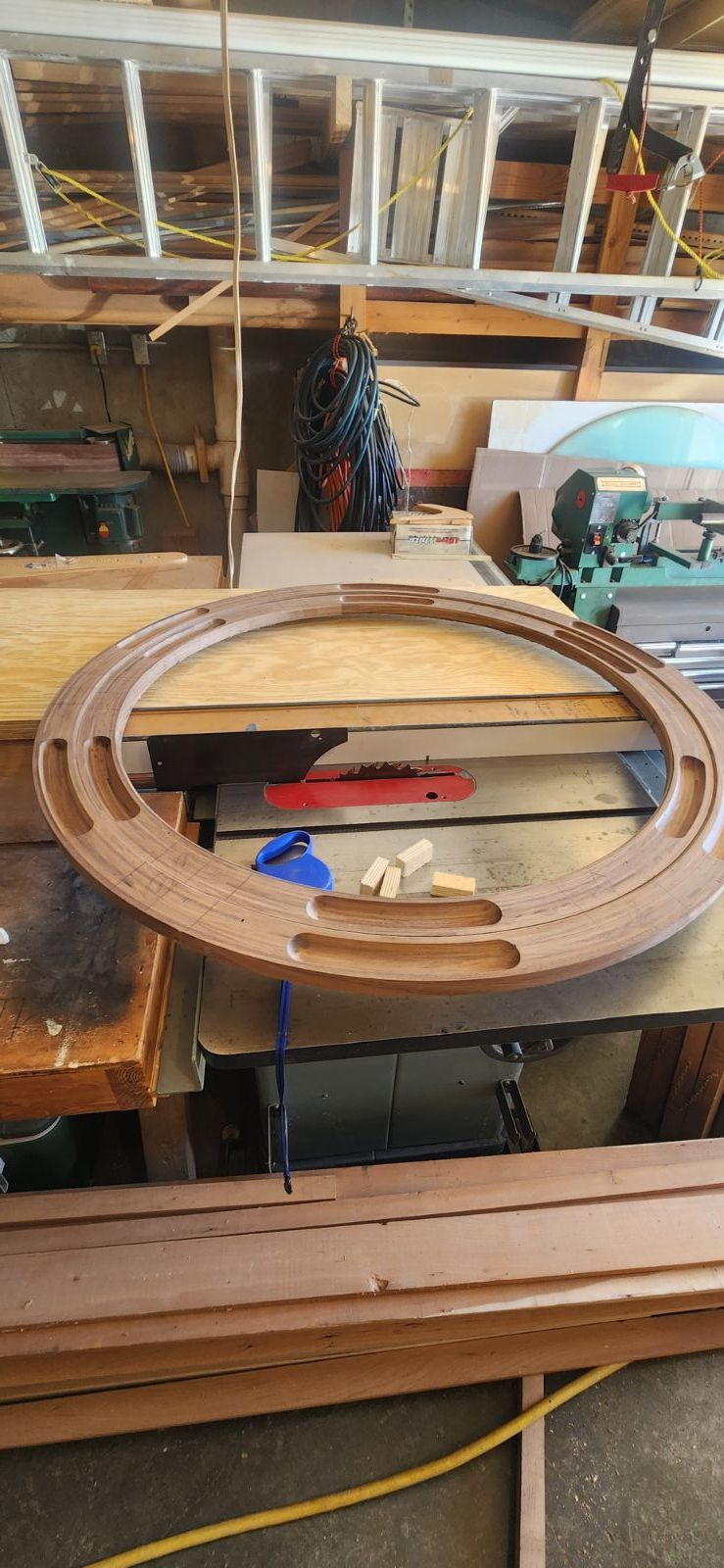

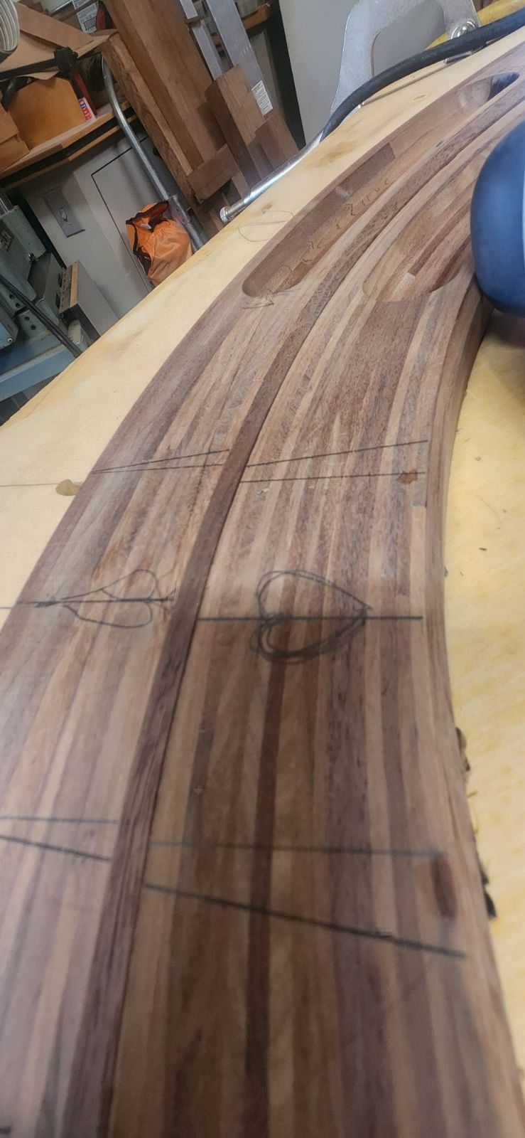

I bevel router the two inside sections of the ring to give me a defined line.

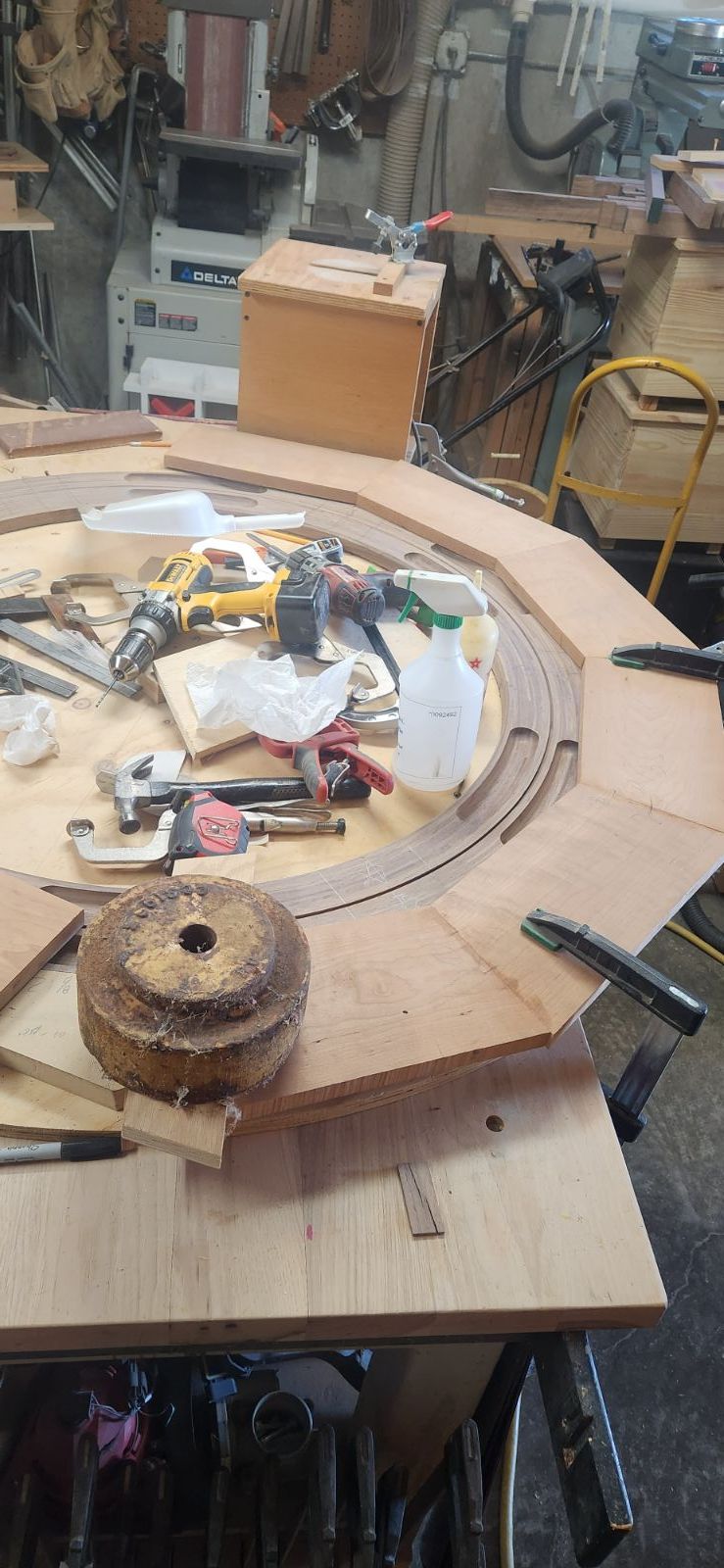

Other than installation abd final sandibg the chip rail is complete. Getting iit out of the way abd on to the cherry rail. The pattern is used again for the cherry rail.
When it cones to good wood, im slow, No hurries..

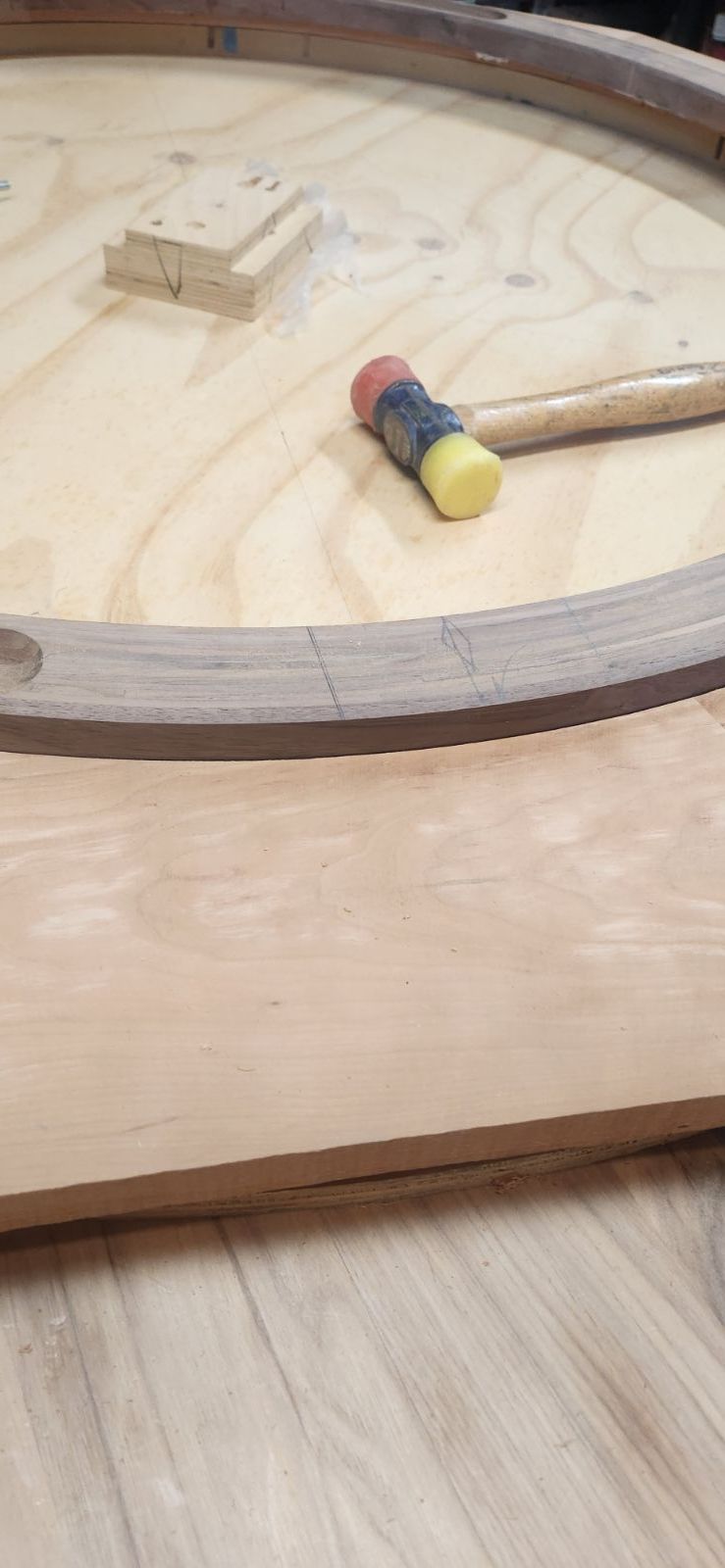

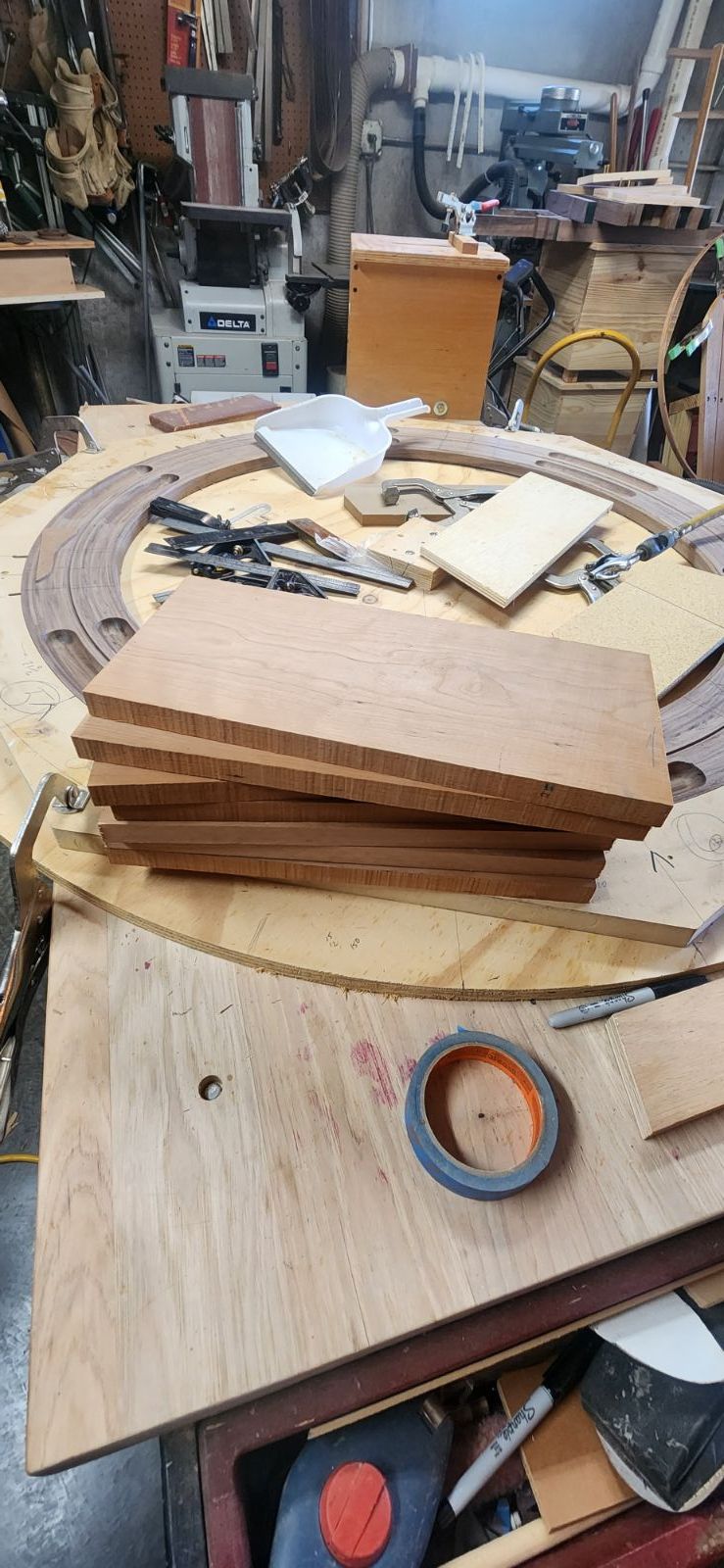

Started cutting the cherry. Hard to cut long boards  to shirt boards but it had to be done. It will take 12 pieces and require 1 1/2 boards. They were all bought years ago from the same dealer so there pretty consistant..

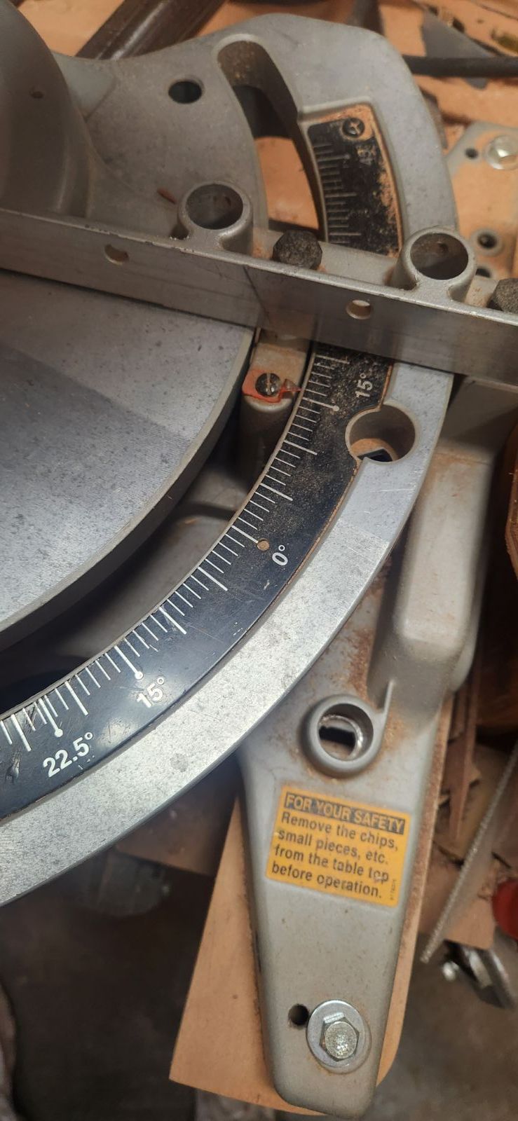

Thr angle is 15 degrees.
I cut the angles at 15 degrees. I overlay the line abd set it in just so the router can clean it later.

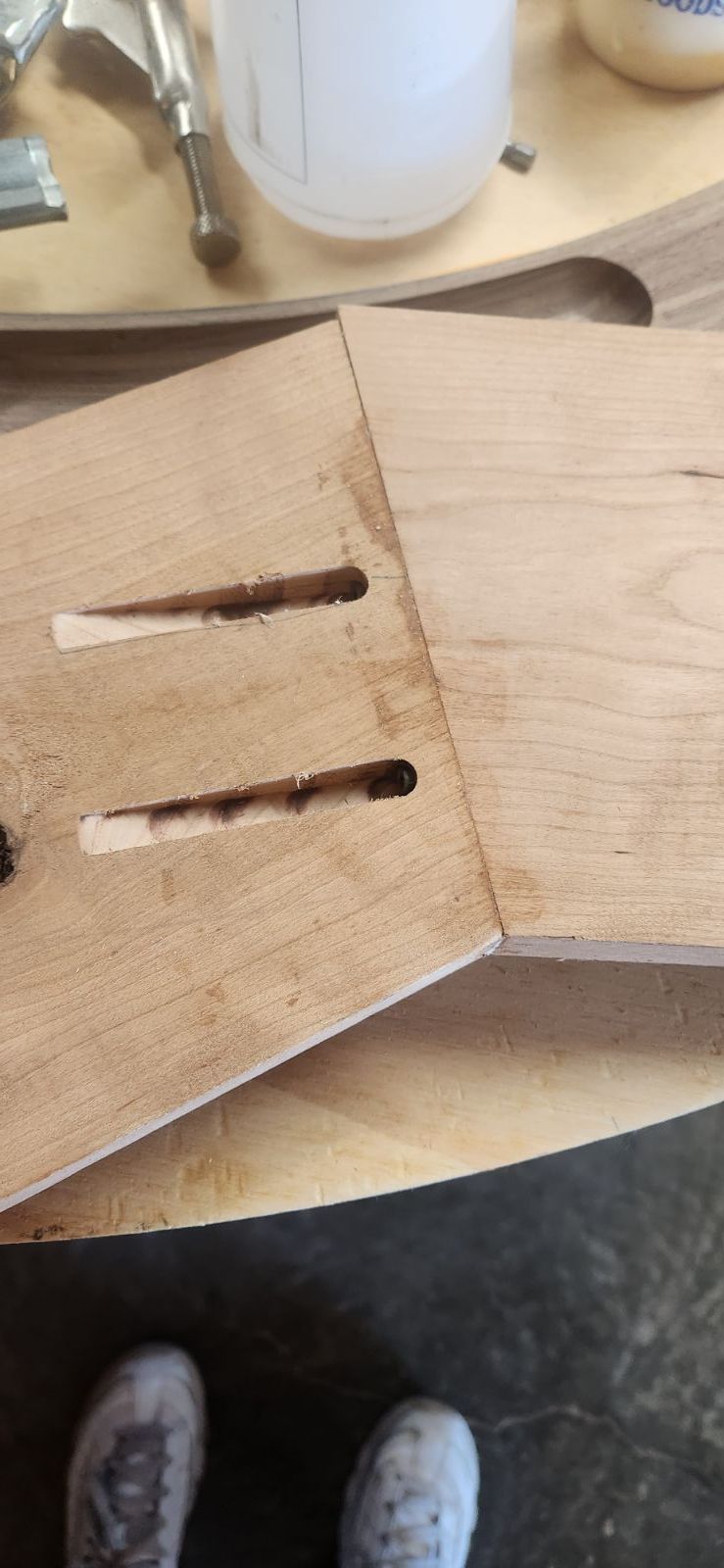

At this point checking, rechecked I make the second cut on the second piece and pocket screw it together.
Pocket screws in furniture?

I usually use my trusted Dewalt 708 for these  angles, but last year someone had a Makita LS1013 for $75 and I bought I t.. without  a second thought I thought it would be a good times to try it out. What I don't like.
I believe it rests on ball bearings which I hate. You have to lock it or it can move.

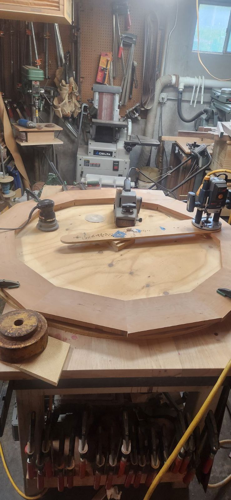

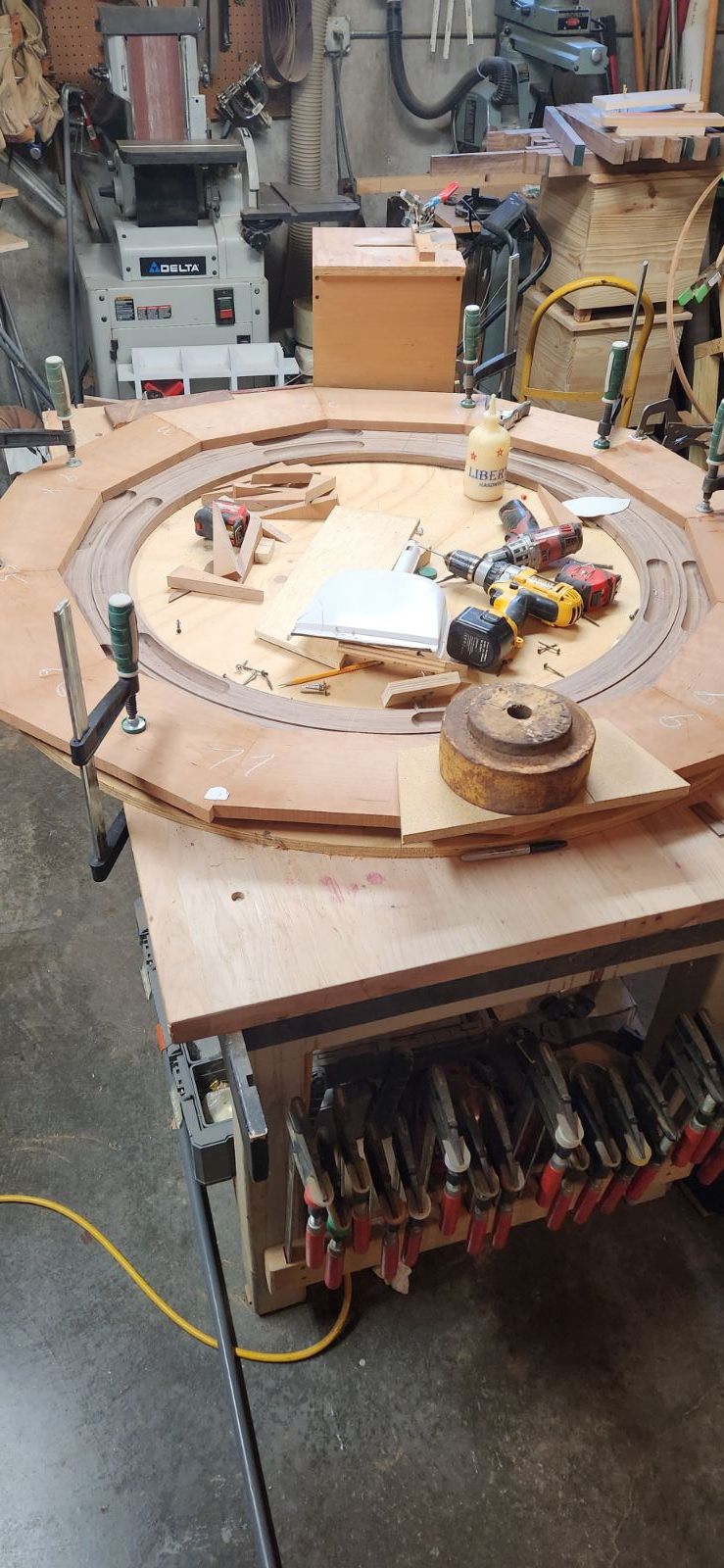

My circle is almost complete. I have just one more to cut. I layed out my lines in the beginning and  try and stay in these lines. I have never used the Makita slider  for something like this, but either it gets with the program or I do. Setting t h e saw and making small adjustments at the end if my circle left me pretty happy.

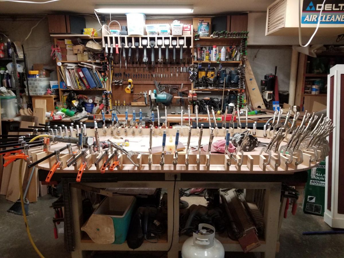

Radius is  complete. I'll let glue abd ring set all night tll tomorrow.

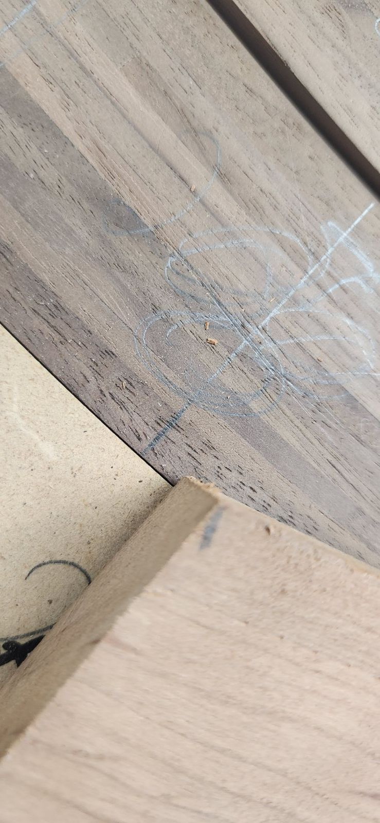

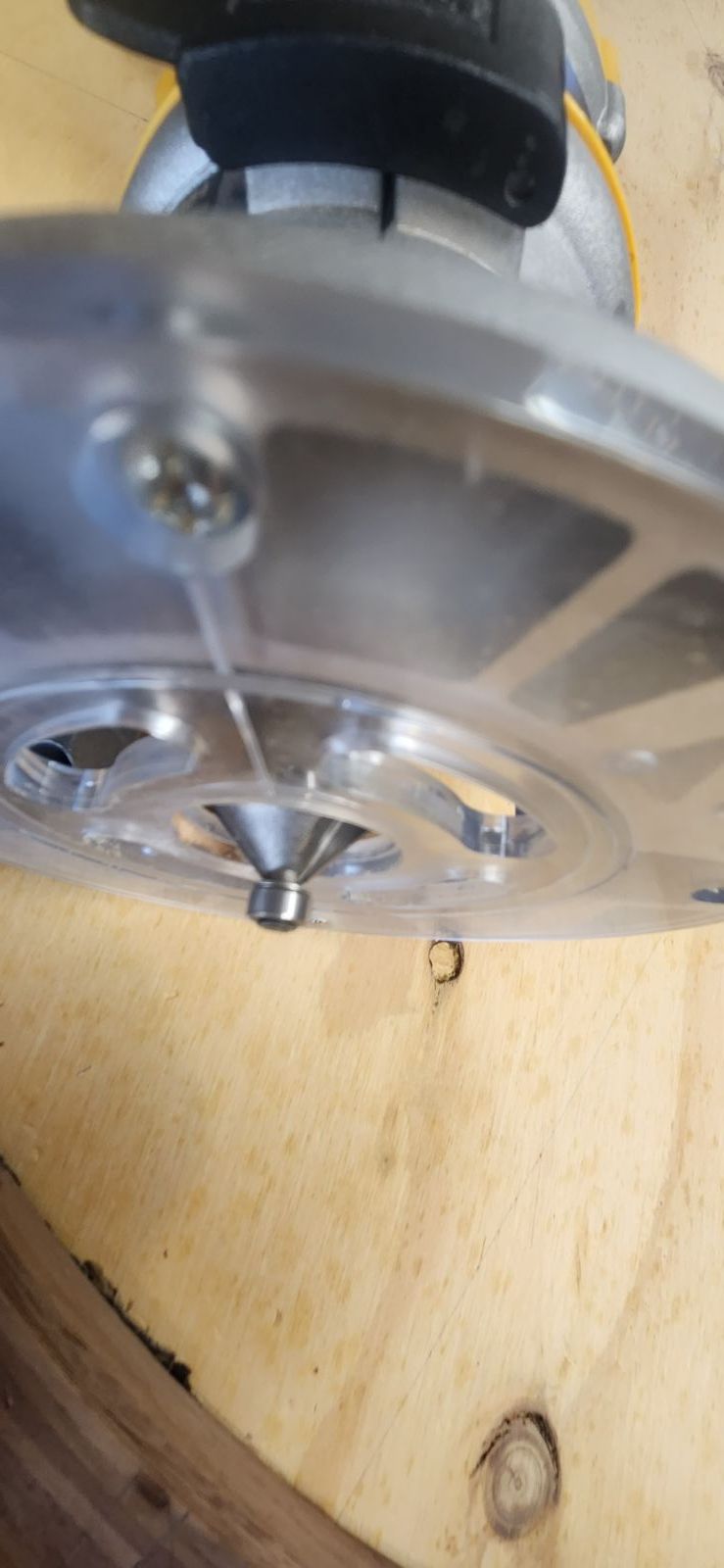

My center pin I found is just a 32nd off on one direction. Looks fine but isn't. I find that I have enough for about 6 tables and may want to keep the pattern healthy if possible.9ne center hole is slightly back from the others. I may try it first and see how much it's off.
Before i route,  I used a 4x24 PC sander with a 100 grit to smooth out the glue joints. I usually use the Bosch with a bag , but wanted tk try out my PC sander pawn shop find.

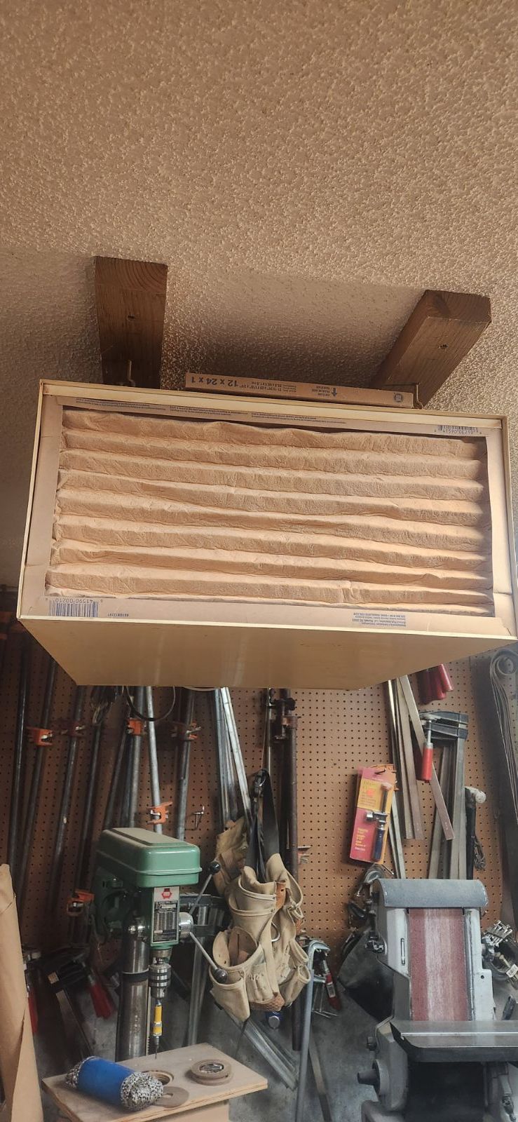

Of course  Cheery dust everywhere.  Luckily I just put a new filter  in from Menards.

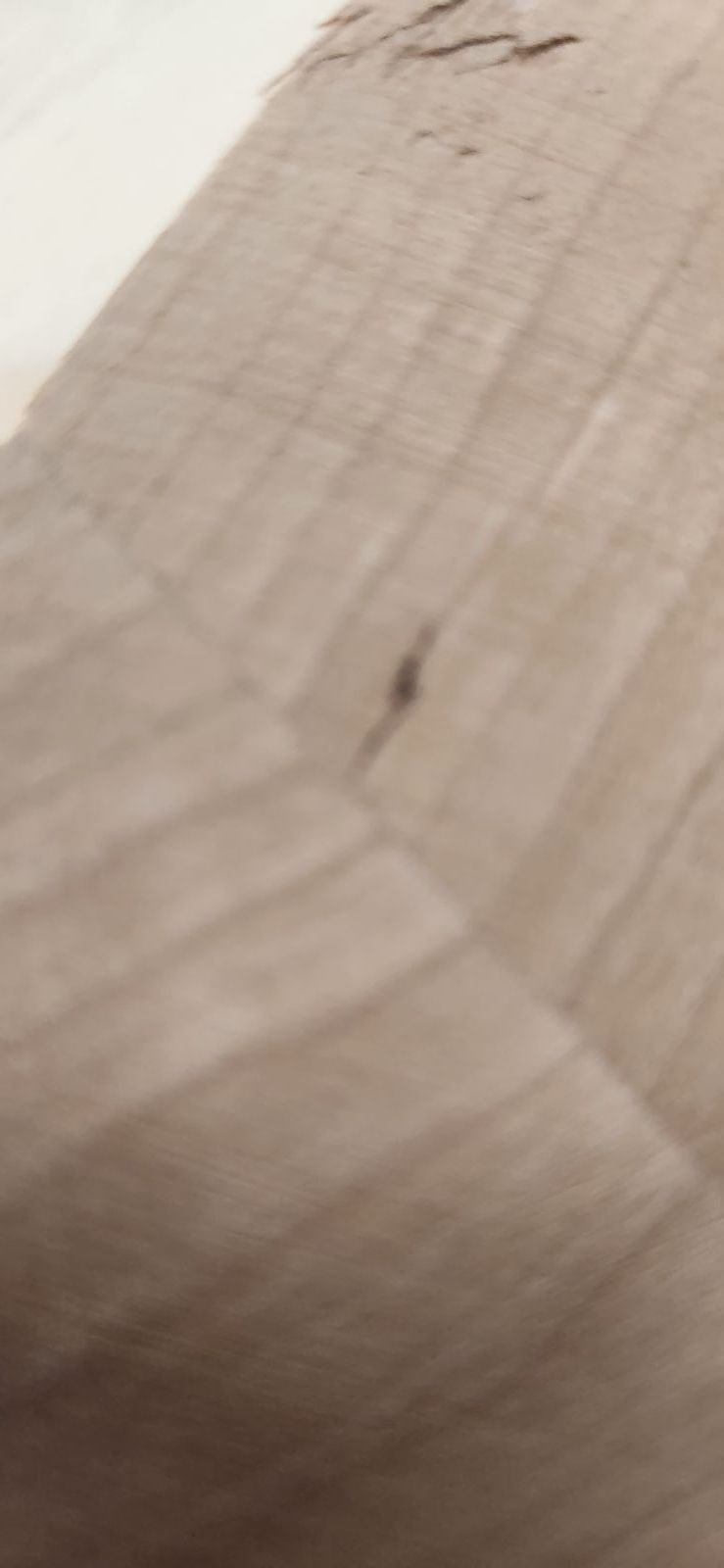

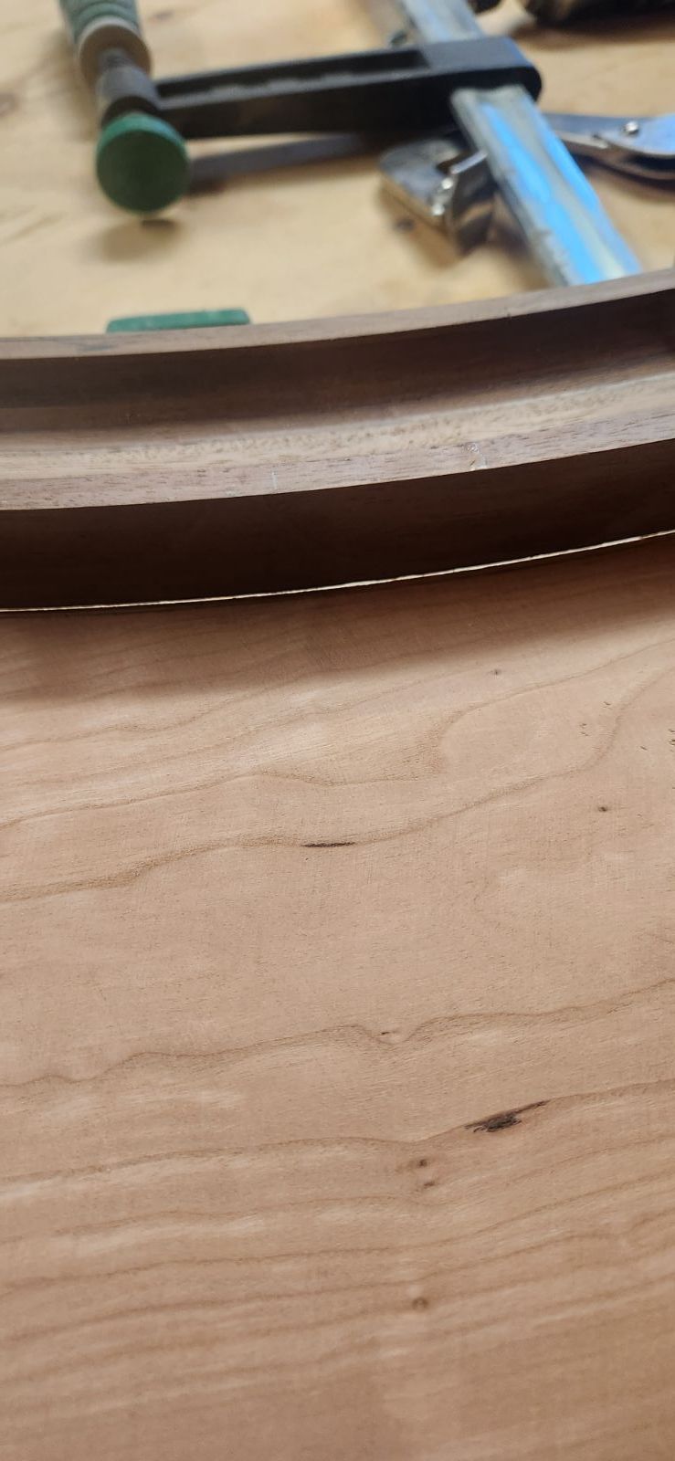

I though the third picture was a crack from a pocket screw.. The cherry is a messing with early in da morning...

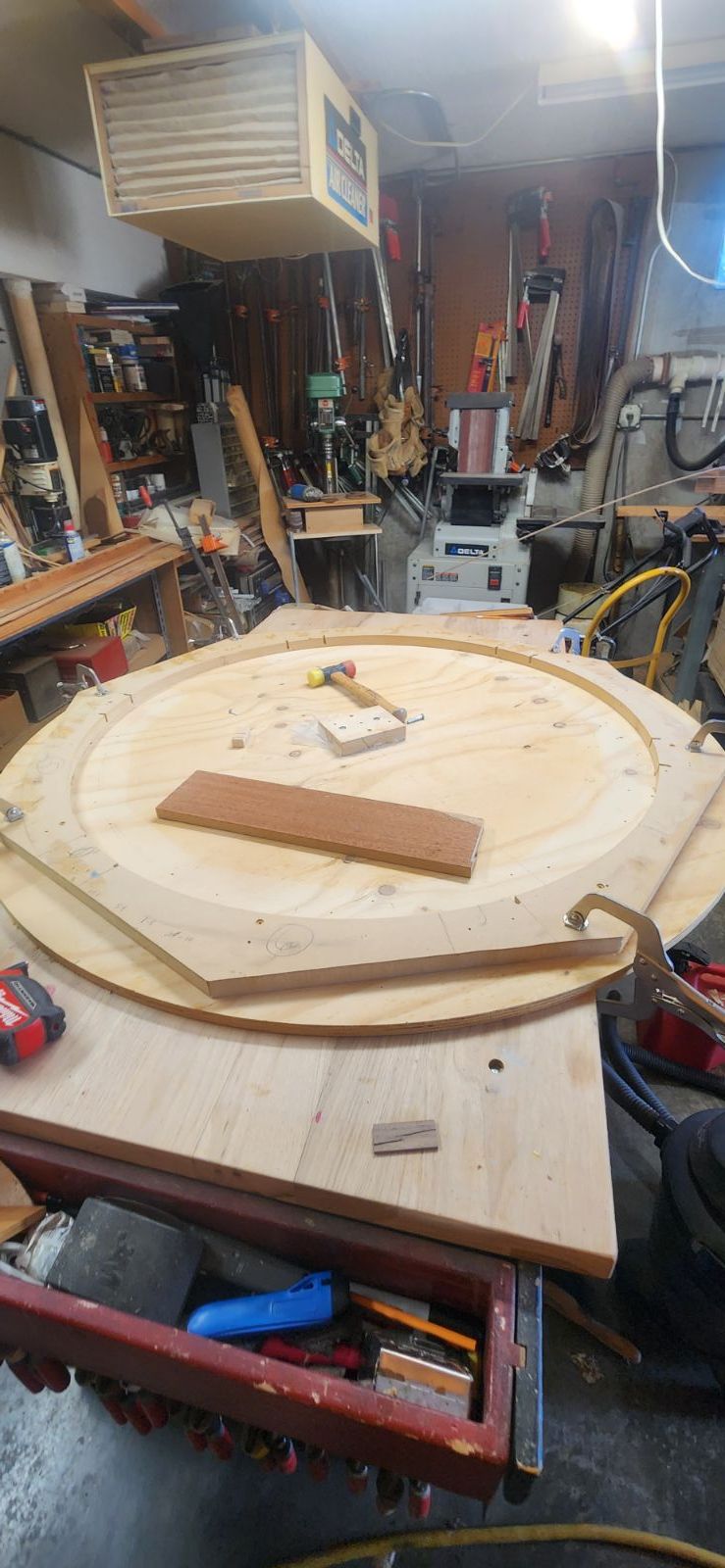

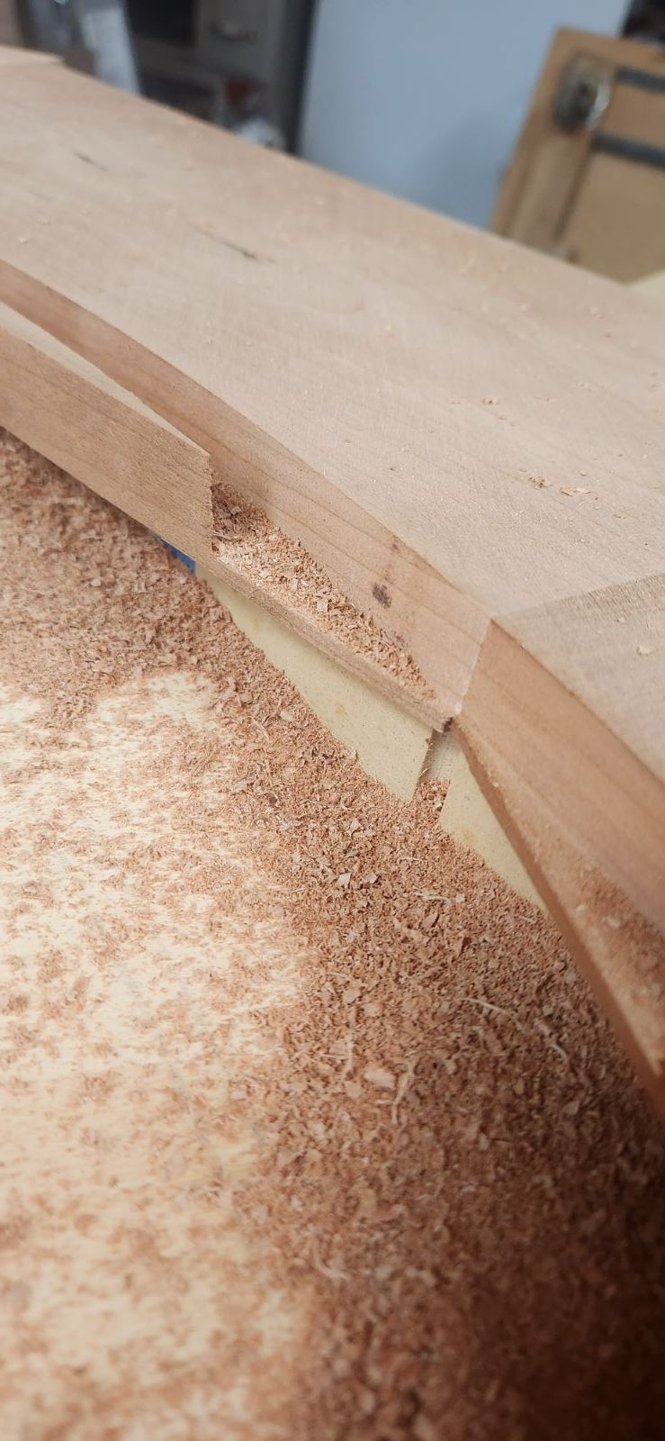

With the radius routed out, it's about a 32bd too small for the chip ring. I have a couple options..
#1 ... Reset the router tk take off a 32nd.
#2....hand sand and make the ring fit perfectly.
I'll chose  #2... Why?  The ring is shrinking. Over a couple days it's slowly drying and the rings are slightly separating. It may notvshring anymore, but I hate to route and it be too small over tine.
