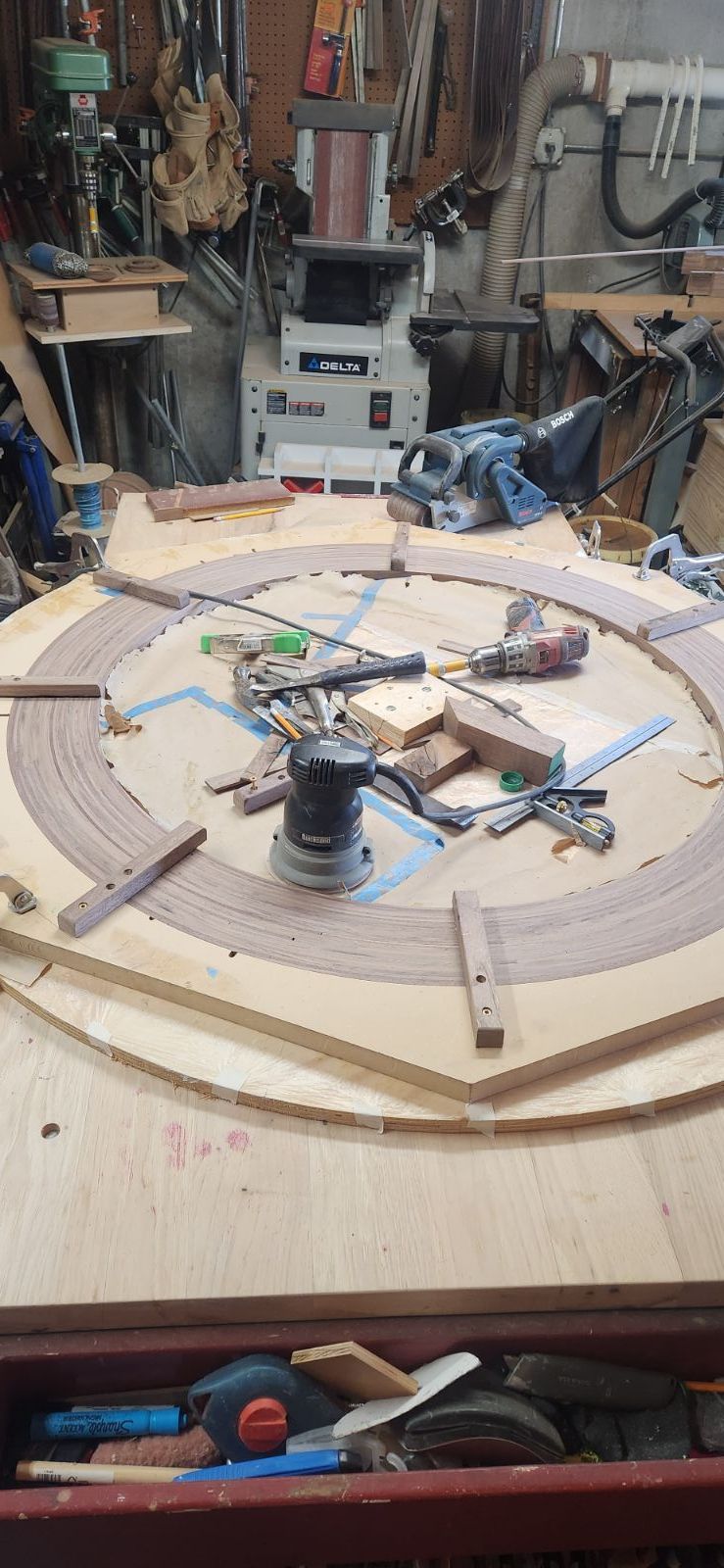

Popular Post BillyJack Posted September 28, 2022 Author Popular Post Report Posted September 28, 2022 With many days behind me. Feelin old, I finally started sanding the chip rail.i had to reinstall the rail so they were level to sand. Adjusting the hold down blocks as I go. You have to sand a small area and move to the next. With so much glue it softens with heat and this ring 10 times. Slowly reaching my goal, moving braces each time. D will just clog your sanding belt as it melts. Moving periodically can greatly improve performance Once it's clogged it's toast. I probably went around 10 times moving the hold downs as I went around. Patience,patience,patience... Gerald, Cal, Woodman and 2 others 4 1 Quote

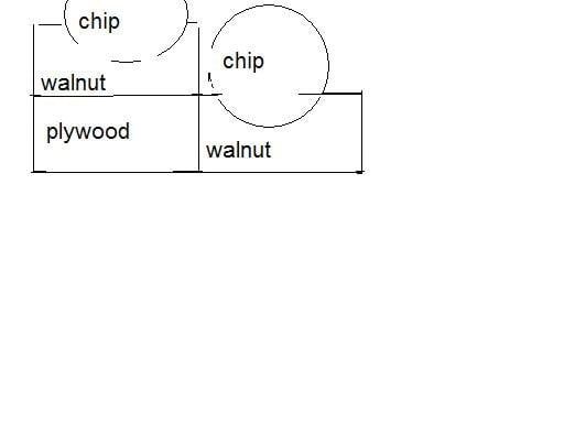

Popular Post BillyJack Posted September 28, 2022 Author Popular Post Report Posted September 28, 2022 With the ring completed and sanded, I focused on the chip trays. Carefully marking my lines, depth and distance of two chip bank. Grandpadave52, Woodman, Gerald and 2 others 3 2 Quote

Cal Posted September 29, 2022 Report Posted September 29, 2022 You are making some serious progress on this Billy. I was surprised to learn that you tackle all that excess glue with the sander. I thought you might use a card scraper or anything other than sandpaper. And I sure appreciate the technique you've shared for doing it, that alone should kick my woodworking up a notch Woodman and Grandpadave52 2 Quote
BillyJack Posted September 29, 2022 Author Report Posted September 29, 2022 (edited) Don't have a card scraper. I'm running into a problem with sanding belts. They are new, but old. My 6x80 belts for the grizzly edge sander and 3x24 belts for the belt sanders are old and breaking apart. Must have broke/broke seam on 6 or more till I found one that could still sand. Nothing wrong with buying old/new sanding belts if you use them fast, but if your buying for bulk for long term sanding belts aren't the deal over time. Don't buy bulk unless your in the shop,and very busy, otherwise buy as you go for fresh stock.. Edited September 29, 2022 by BillyJack Grandpadave52, Cal, Woodman and 1 other 4 Quote
