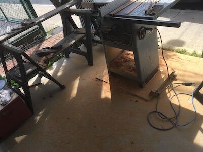

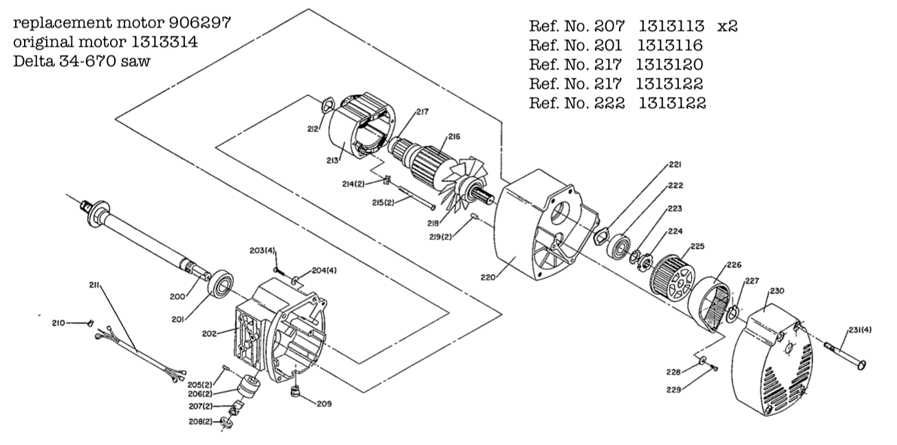

Made a stop at a tool guy's shop. Known him for almost 30 years now. He glanced at my schematic, said the bearing part numbers meant nothing, said "we have bearings", bring them in. If I bring him in the whole motor, for $100 or a little more, he'll open it up, presumably replace all four bearings, the brushes, and it will be done. Me, I do not know what I am looking at if there is a problem.
So I'm into this saw $50 cash, $60 gas and tolls, $120 motor rebuild, time, wear and tear on both me and the truck . . .  I'm talking myself into thinking it will be a decent deal when all is done. And I can get my money back if need be.

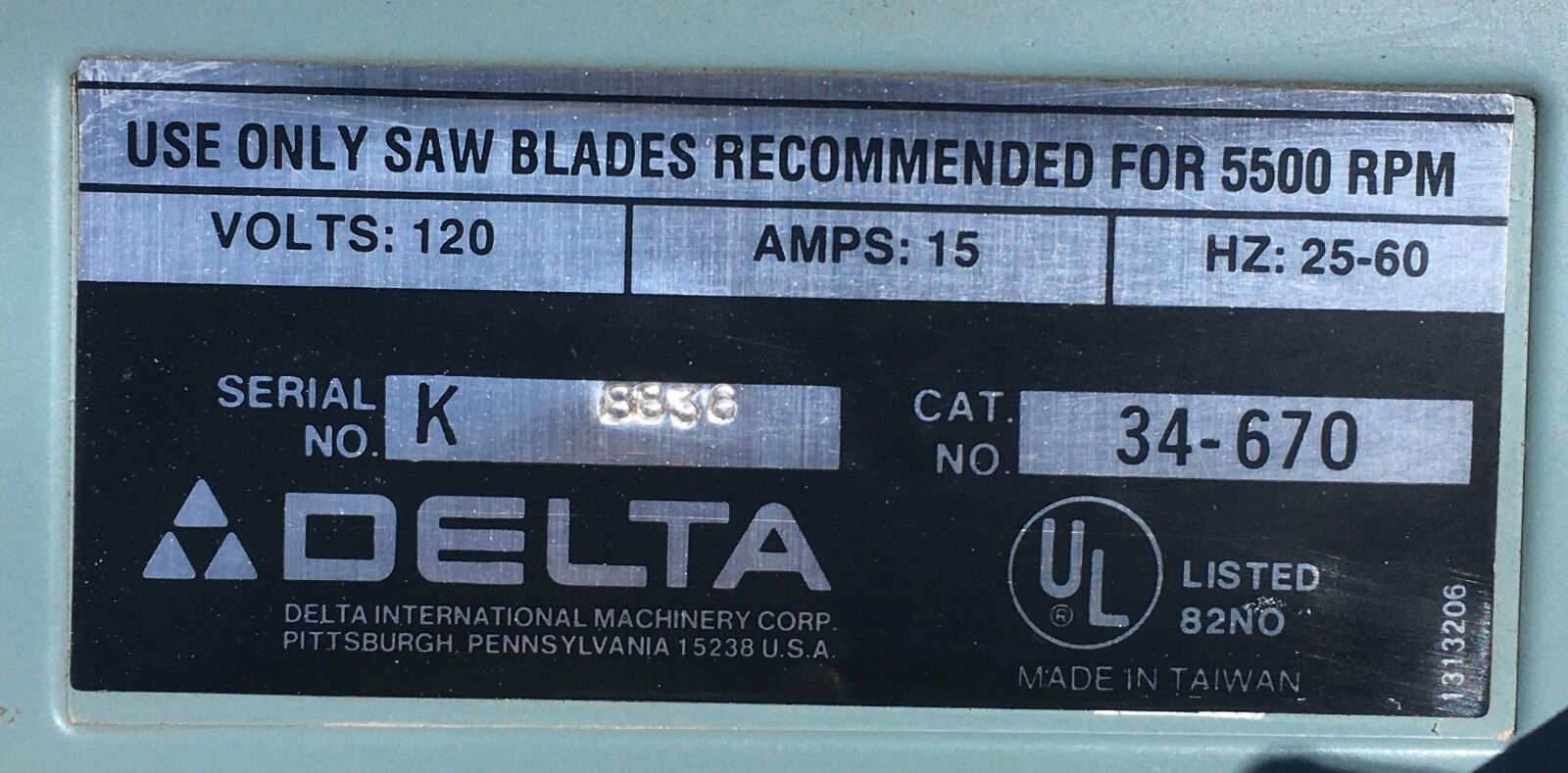

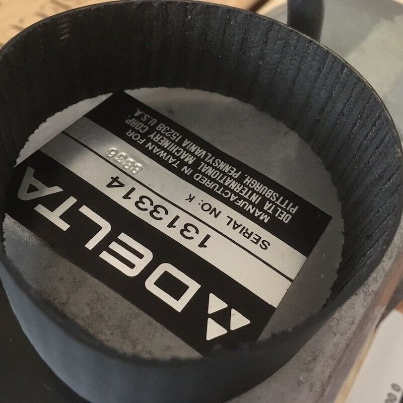

The new Delta (SN K8838 = August 1988 ???) weighs a whole bunch but I got it into 3-4 pieces. Got the motor out very easily. The motor guy seemed confident he has the bearings. Took him the motor along with two boxes of Speer Gold Dot 9mm I've had for 15 years. An advance gratuity works wonders.
The Delta part numbers are just that, Delta part numbers.
The motor guy will replace them using the numbers off of the bearings.
If the bearings have no numbers, he'll go by the bearing dimensions.

DING DING DING ! - The motor was completely disassembled. All 4 bearings fine. Brushes fine. It was the belt. Plus loads of white wispy plastic inside the motor. The seller may have been cutting  HDPE cutting boards or the like.
Glad I took it to a pro because I know nothing about electric motors. Reassembly Thursday maybe. Gonna rip a whole lotta wood.

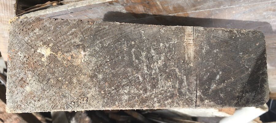

It was not bad. Full height through heartpine was a slow push. Before buying I was able to push the saw hard enough to trip the relay thing. But no issues once rebuilt. Granted, I did not try to speed up cutting.

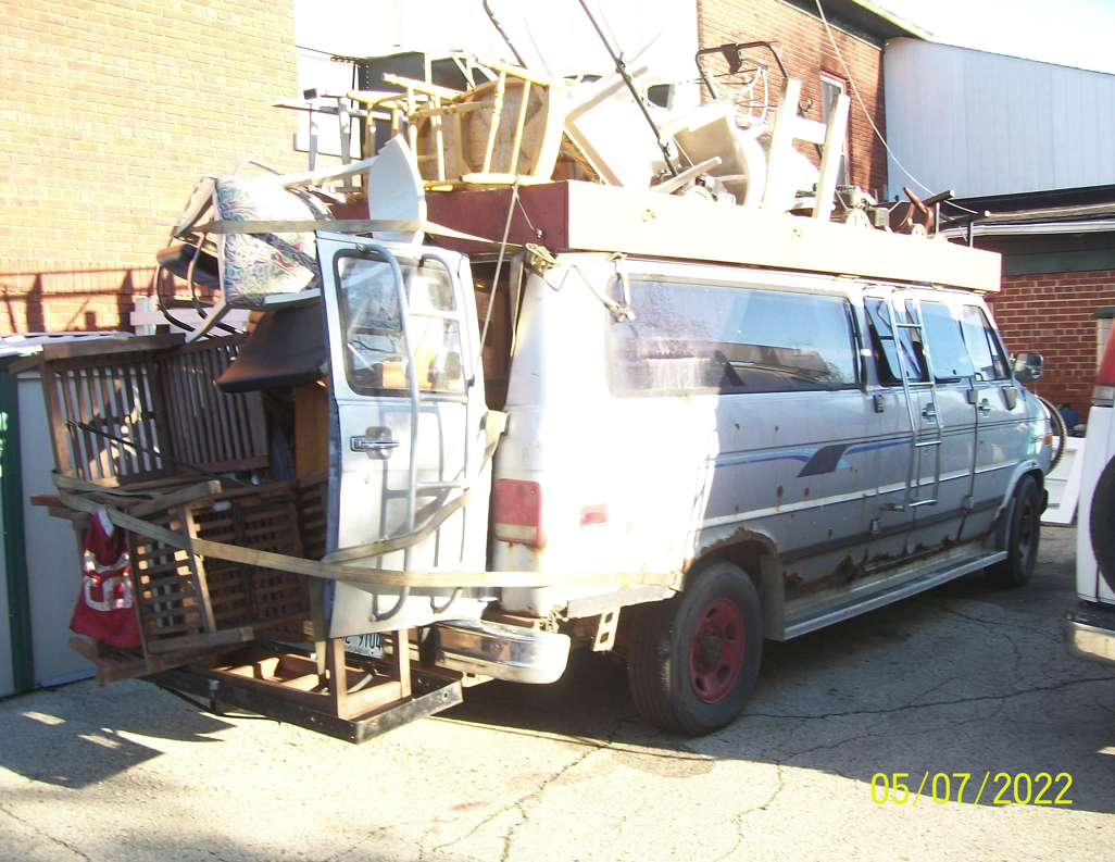

Long day yesterday. Started out in first van lost brakes, went out in second.
Got back around 11:00 PM.
:throbbinghead:
Somewhere in there is a 1940's-50's Dunlap Bench Grinder that doesn't look like it was used much at all along with a few other goodies. Photos when we get unloaded. Have to have breakfast first though.
