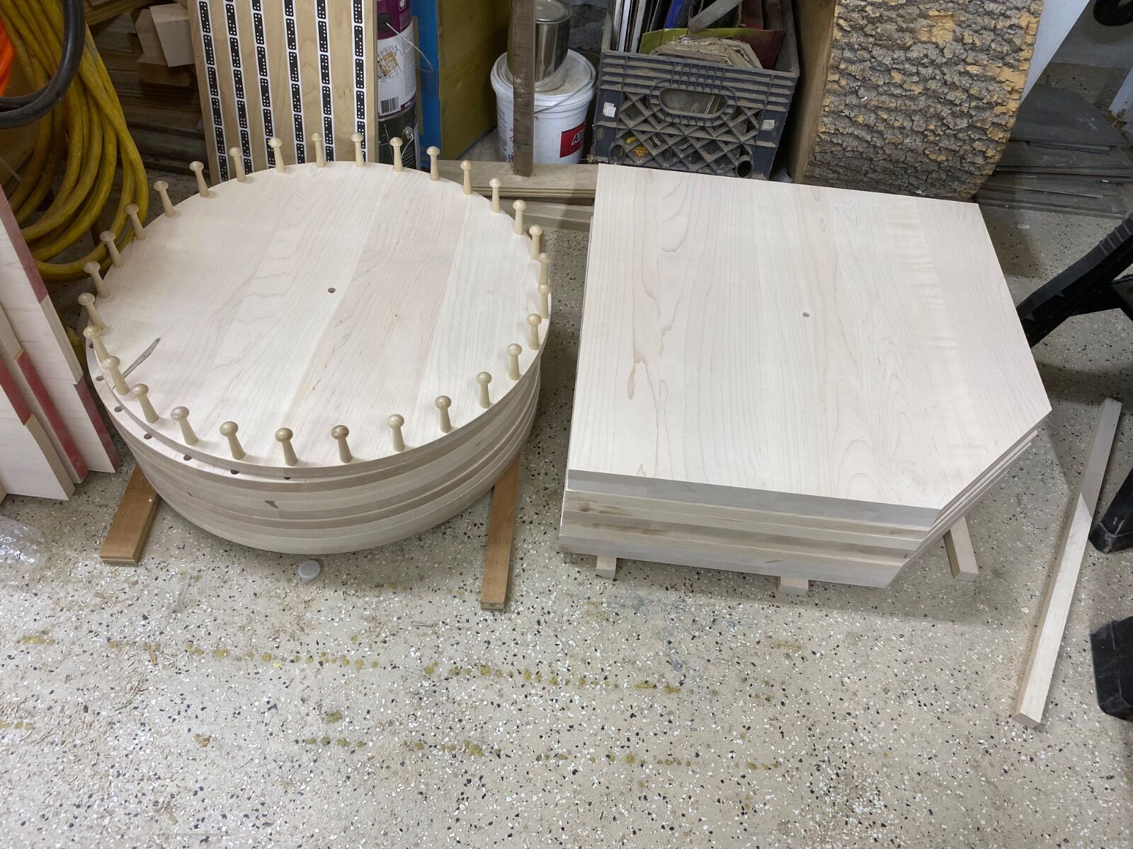

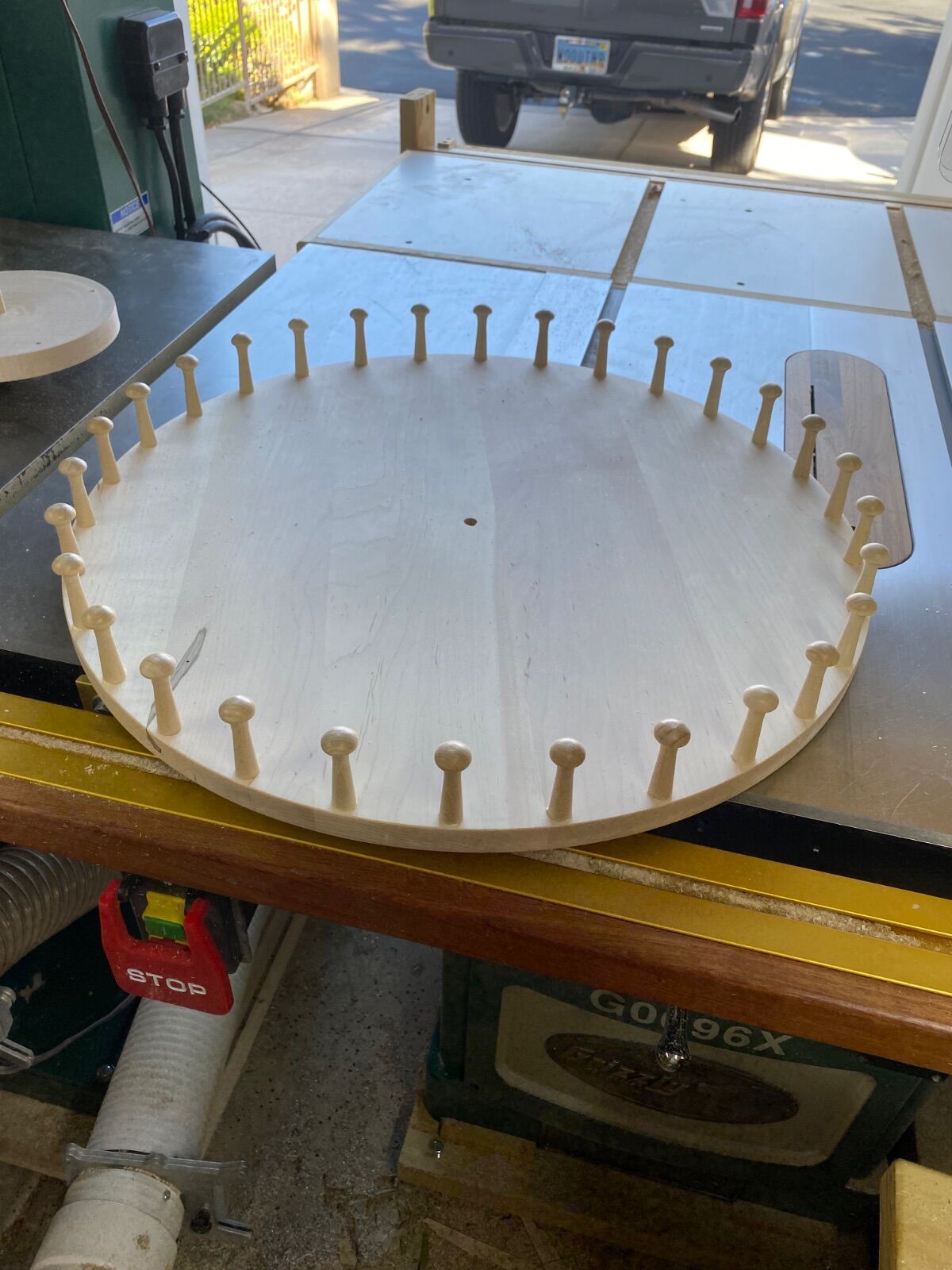

    With all the stuff going on around here the pantry is moving slowly. I managed to get the sanding of everything done and all 300 pegs glued in on Sat and then yesterday put the first coat of finish on

    You’re right about that Lew. I make my lazy Susan’s using Shaker pegs on the perimeter spaced about 2-2 1/2” apart. They look great and also give your fingers something to grab.  Paul

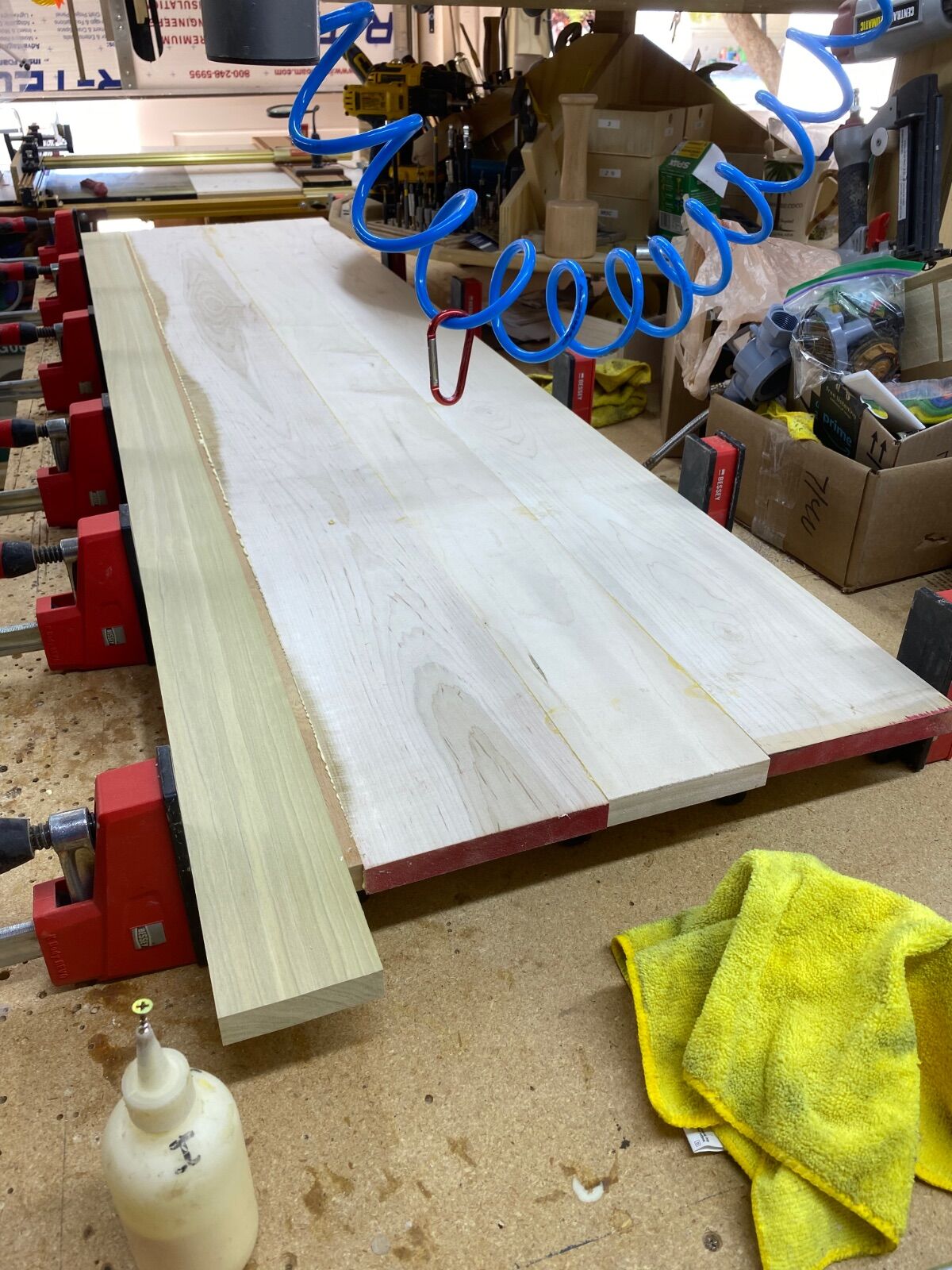

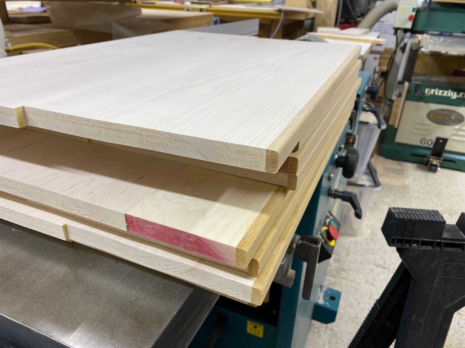

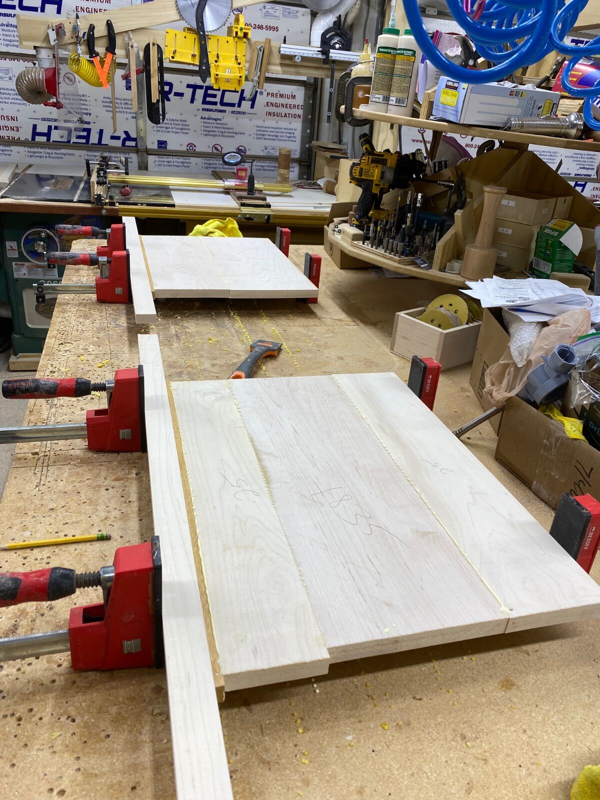

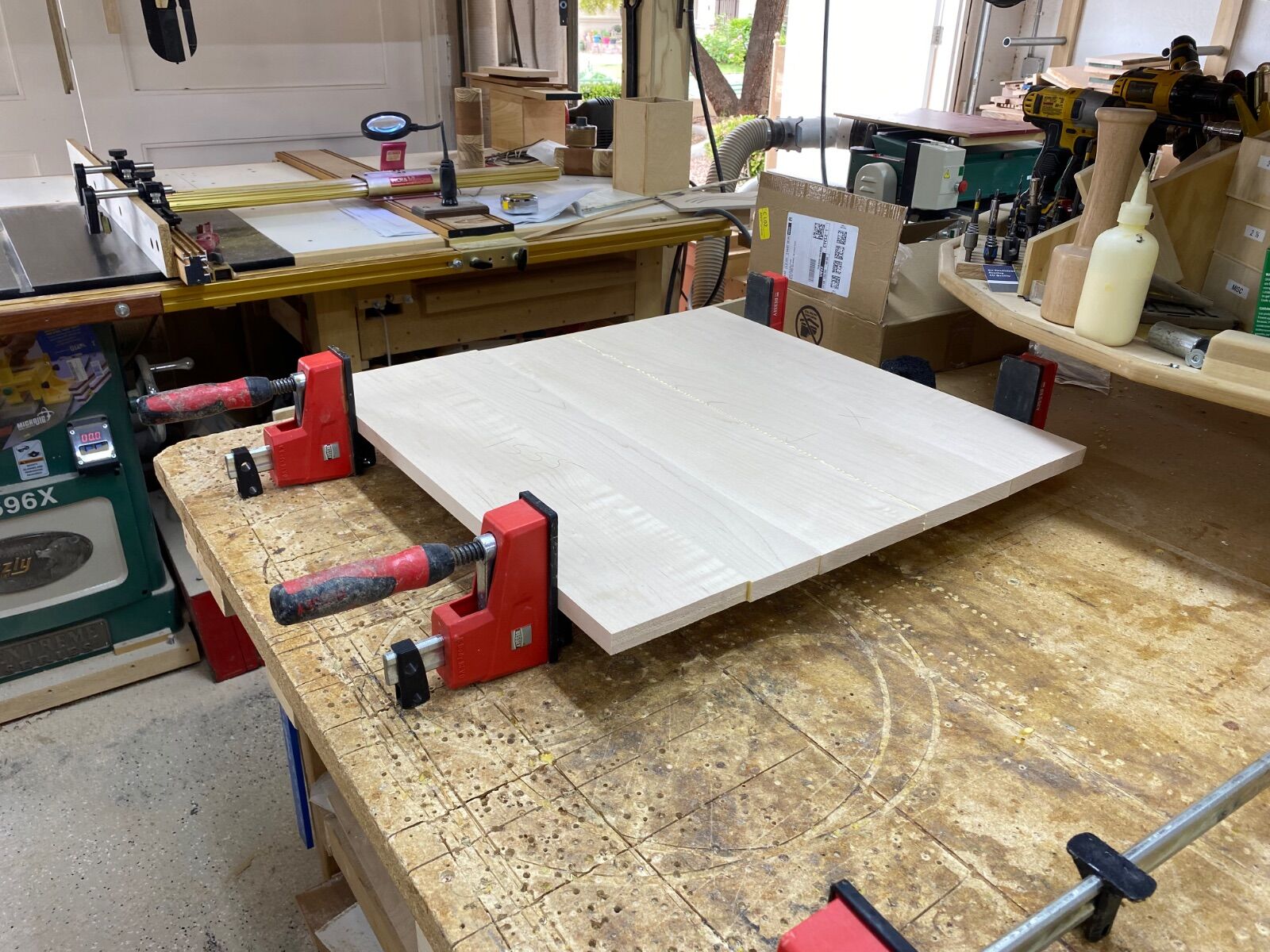

A little work done today. Glued up two of the vertical panels. These panels are heavy so I will be doing all the rabbeting and dadoes with a router.
Paul

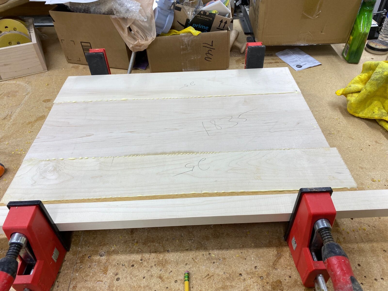

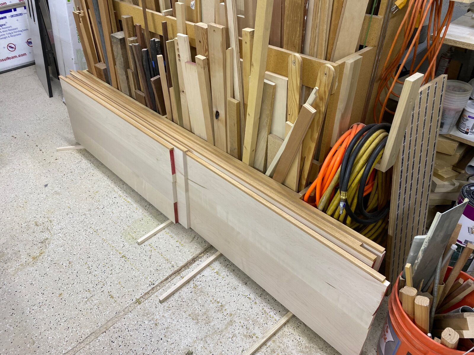

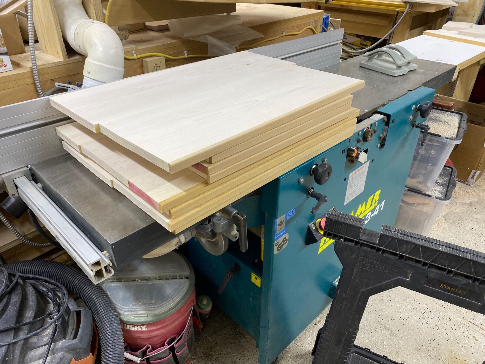

Productive day today. All the components for the carcasses are glued up. Tomorrow I will try get them all run through the planer and ready for assembly.
Paul

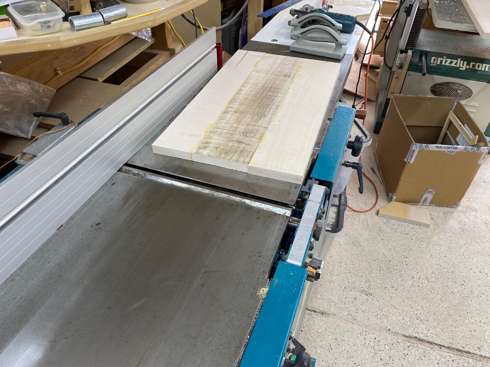

The last two days I’ve been trying to get the horizontal shelving for the lazy Susan’s done. Kind of tedious but they are coming out fine. Next will laminating up the blanks for actual lazy Susan’s which is pretty much the same process.
Paul

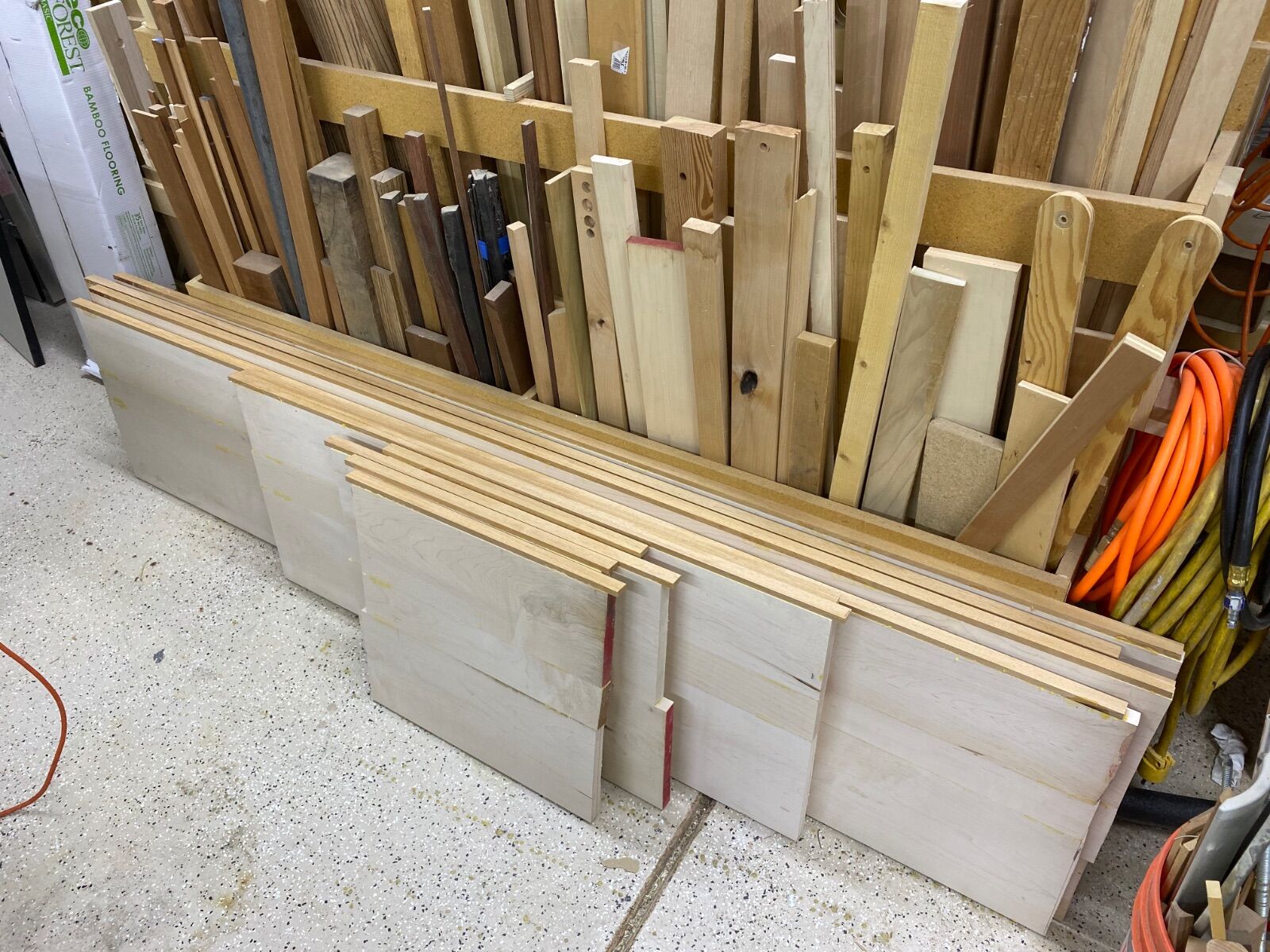

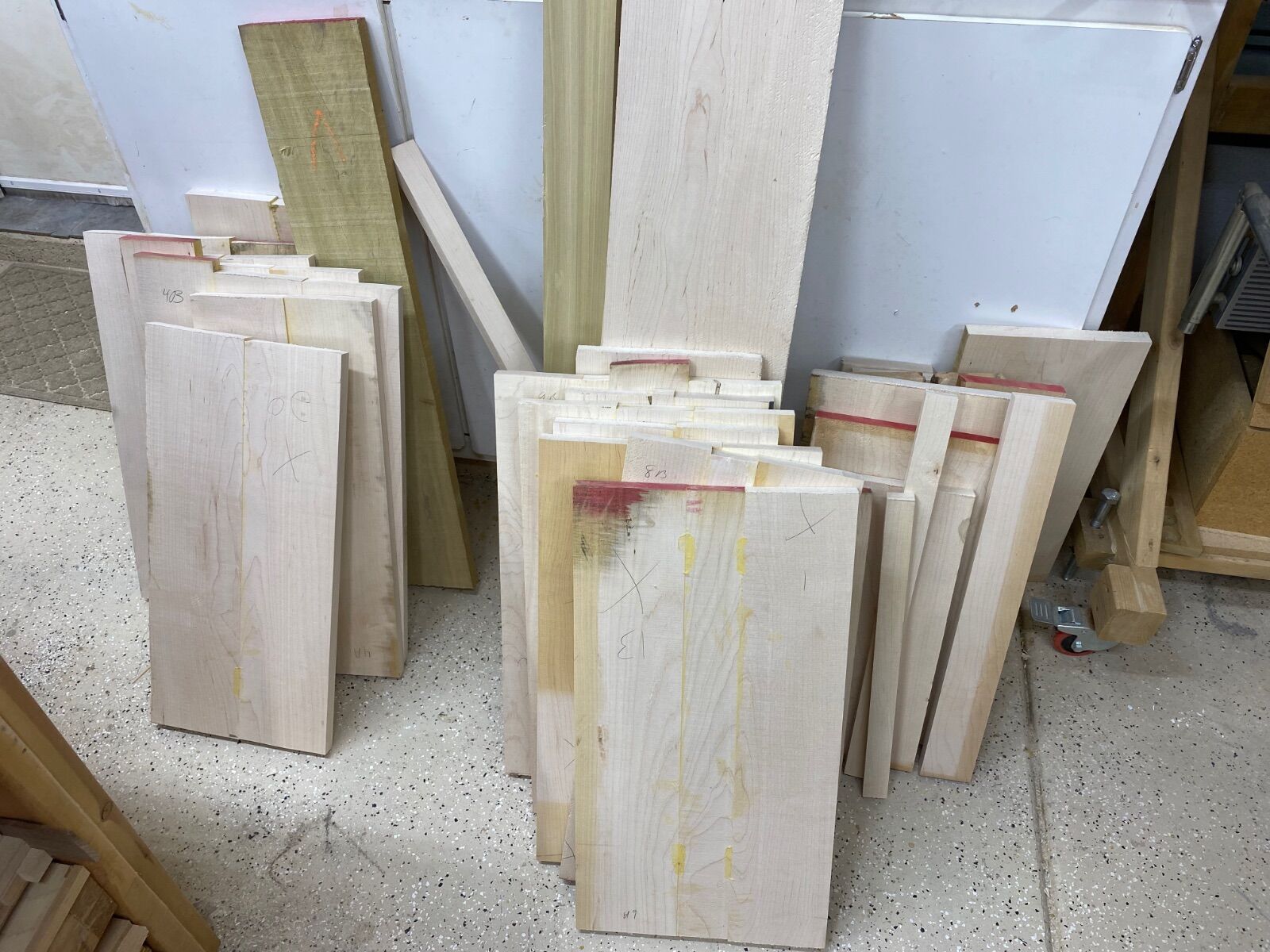

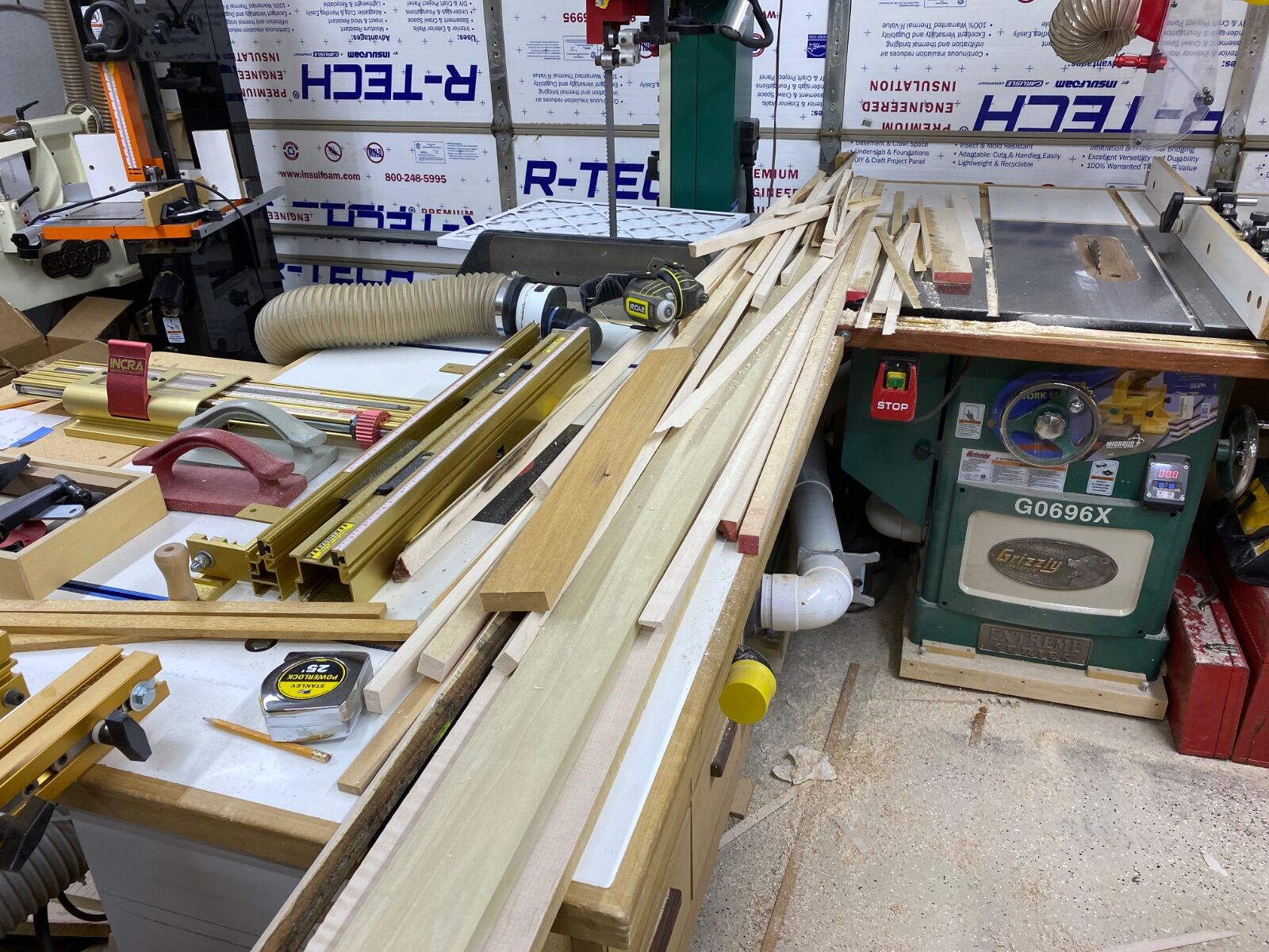

Got a fair amount done today in the shop. Still working on prepping all the components for the carcass. They have all been run through the planer and now it’s down to sanding and routing. I will hopefully have them ready for assembly Friday.
Paul

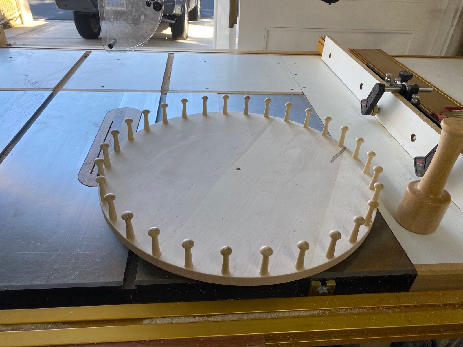

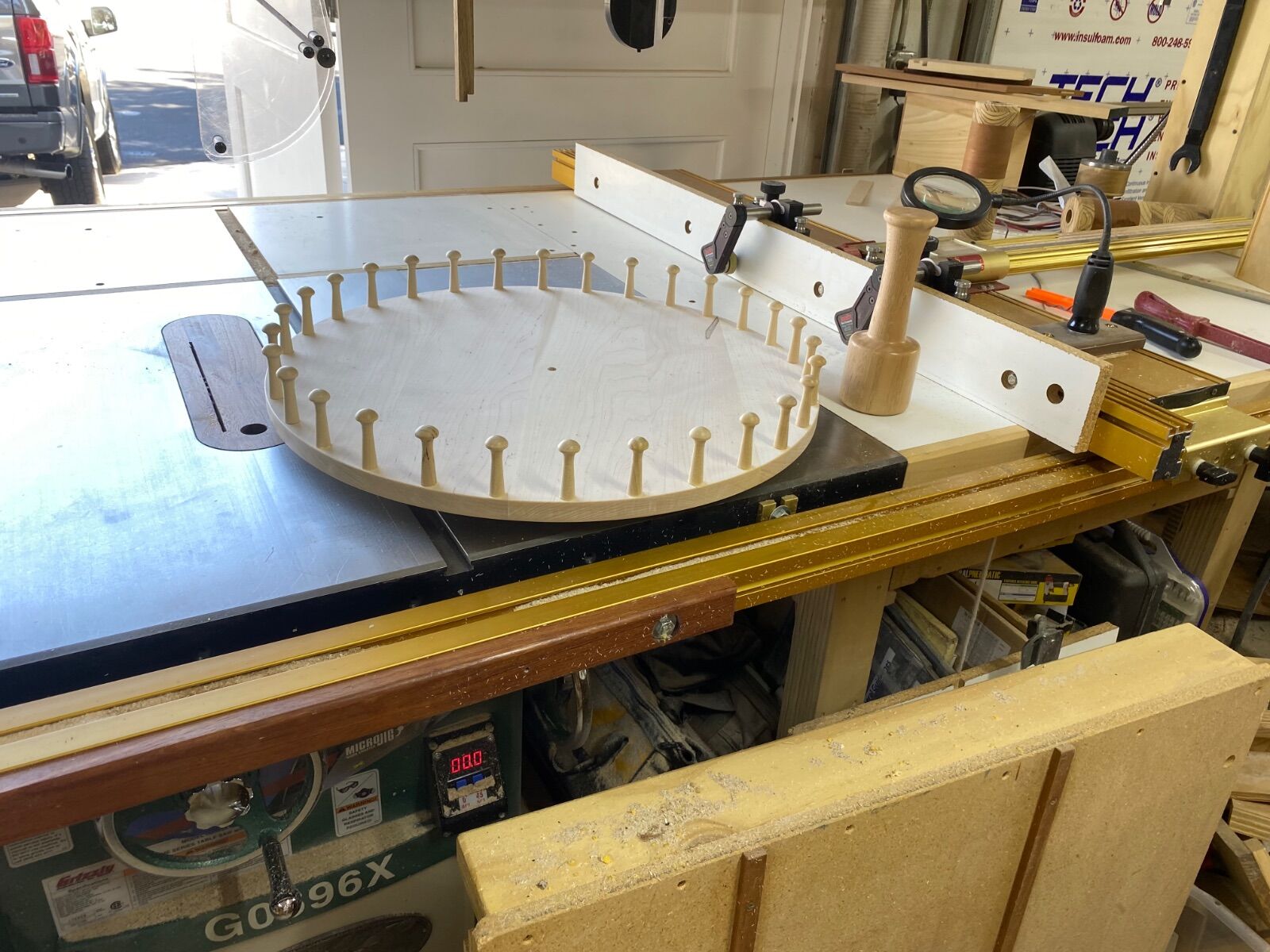

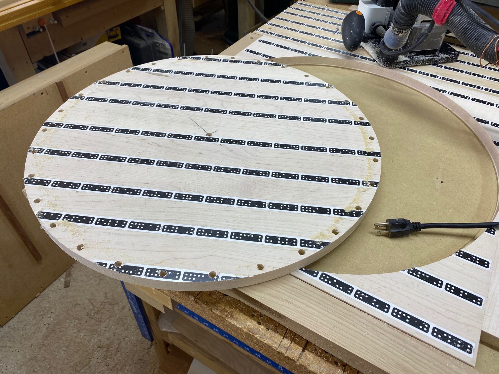

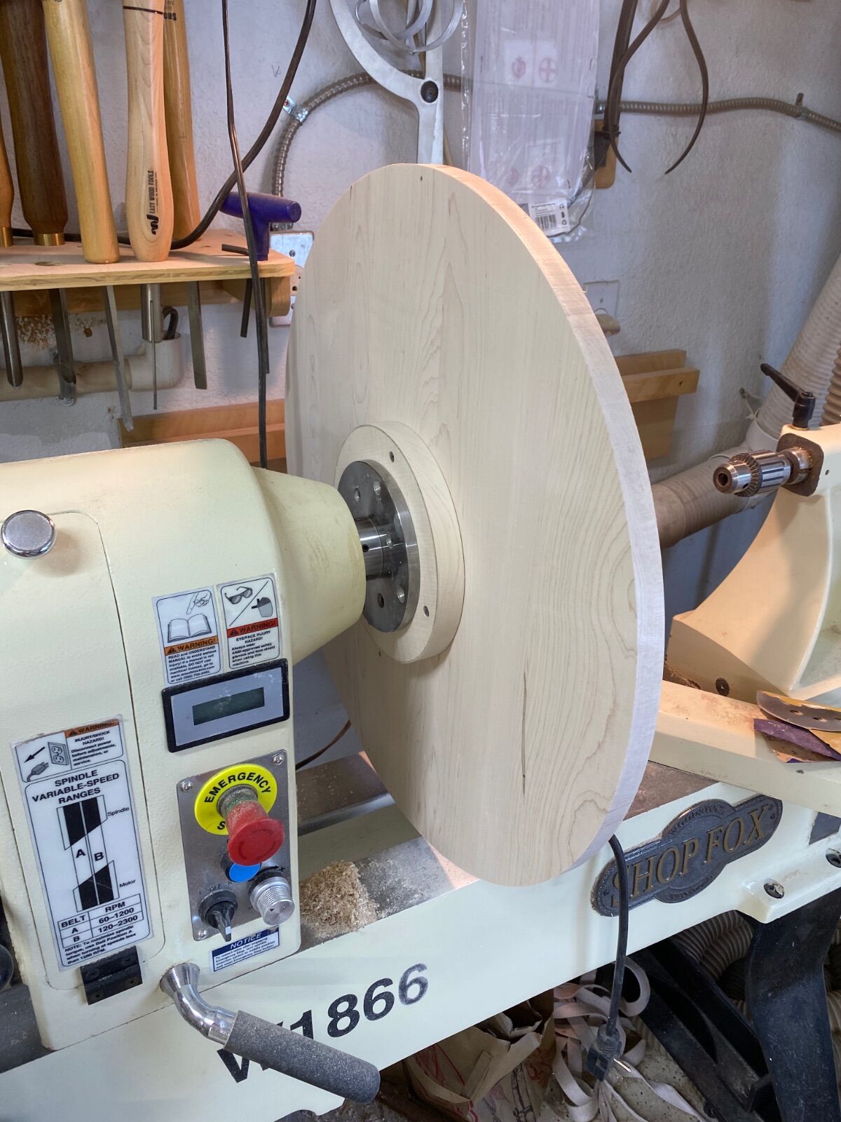

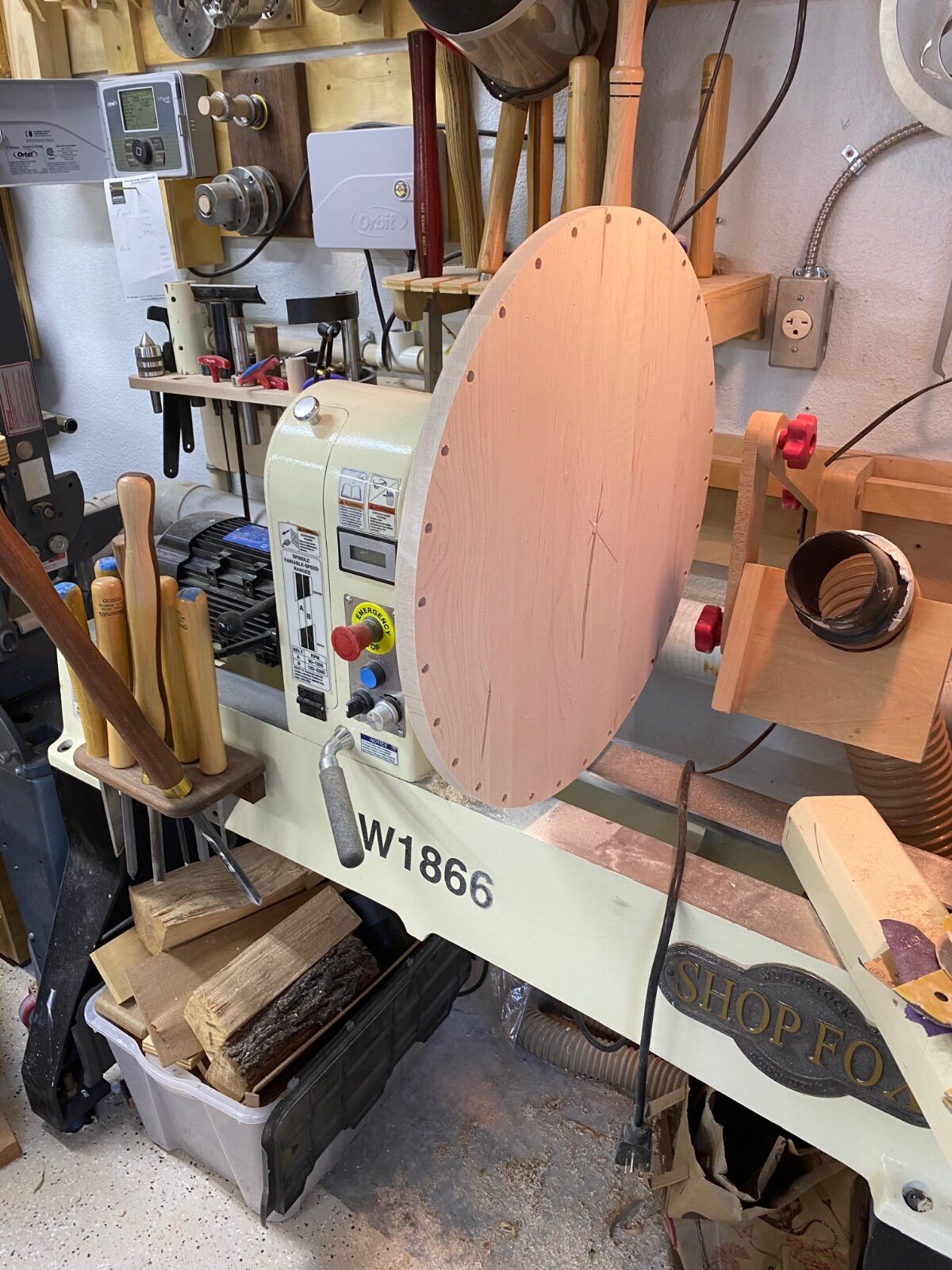

Today I got some time in on the pantry. I started cutting out and sanding the lazy Susan’s. One of the difficult parts of making them is getting the edges sanded. I decided to mount them on the lathe to try and make it a little easier and quicker and it worked very well. Most of the time is spent using the Shaper Origin to do the cut out and the holes for the pegs.
Paul

Busy day in the shop. All the lazy Susan’s are cut, sanded and ready to glue the pegs in. That won’t happen until right before the installation. To hard to store with the pegs in. The bases are also cut and sanded. Hopefully tomorrow I can begin assembling the carcasses.
Paul

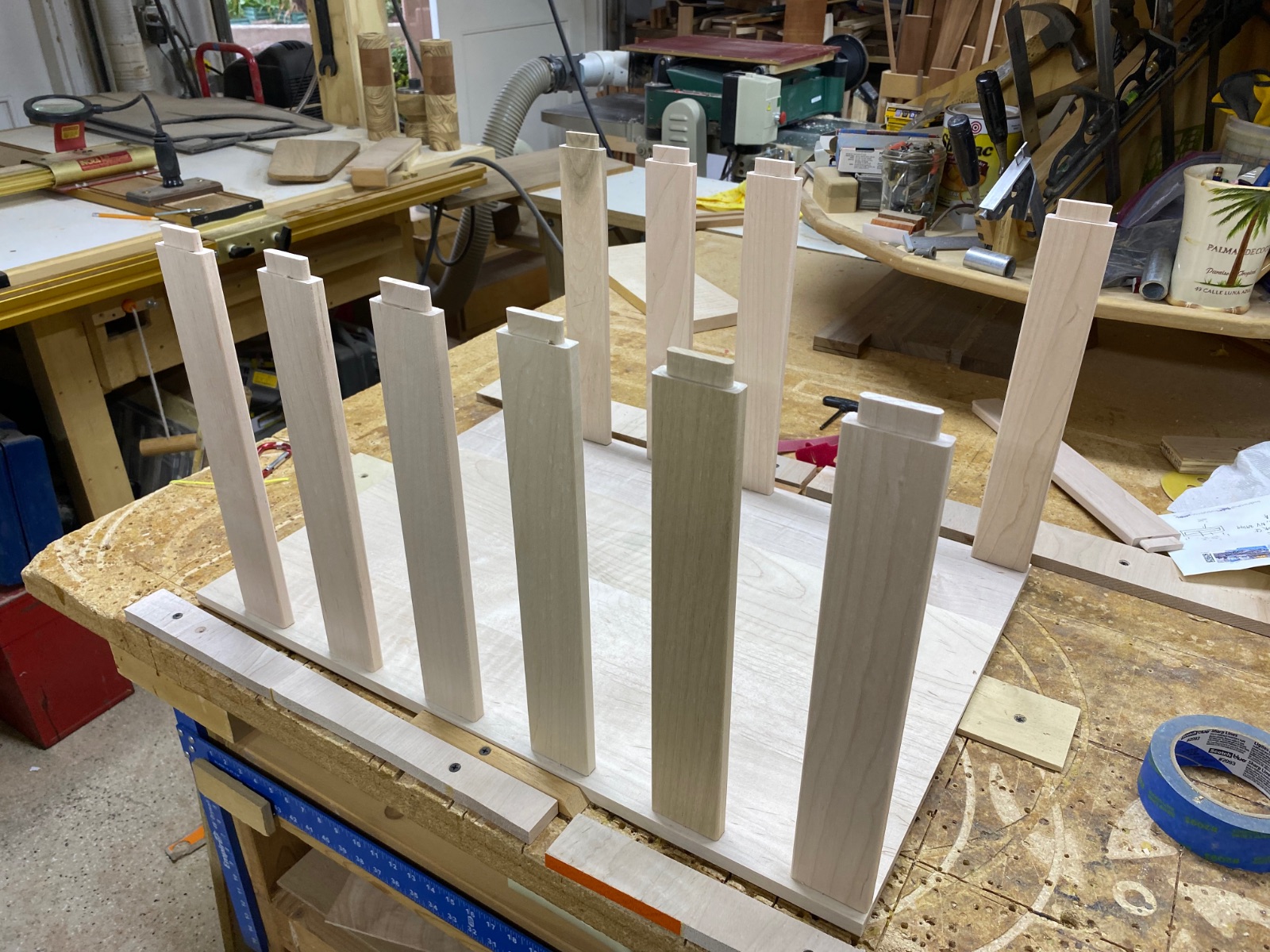

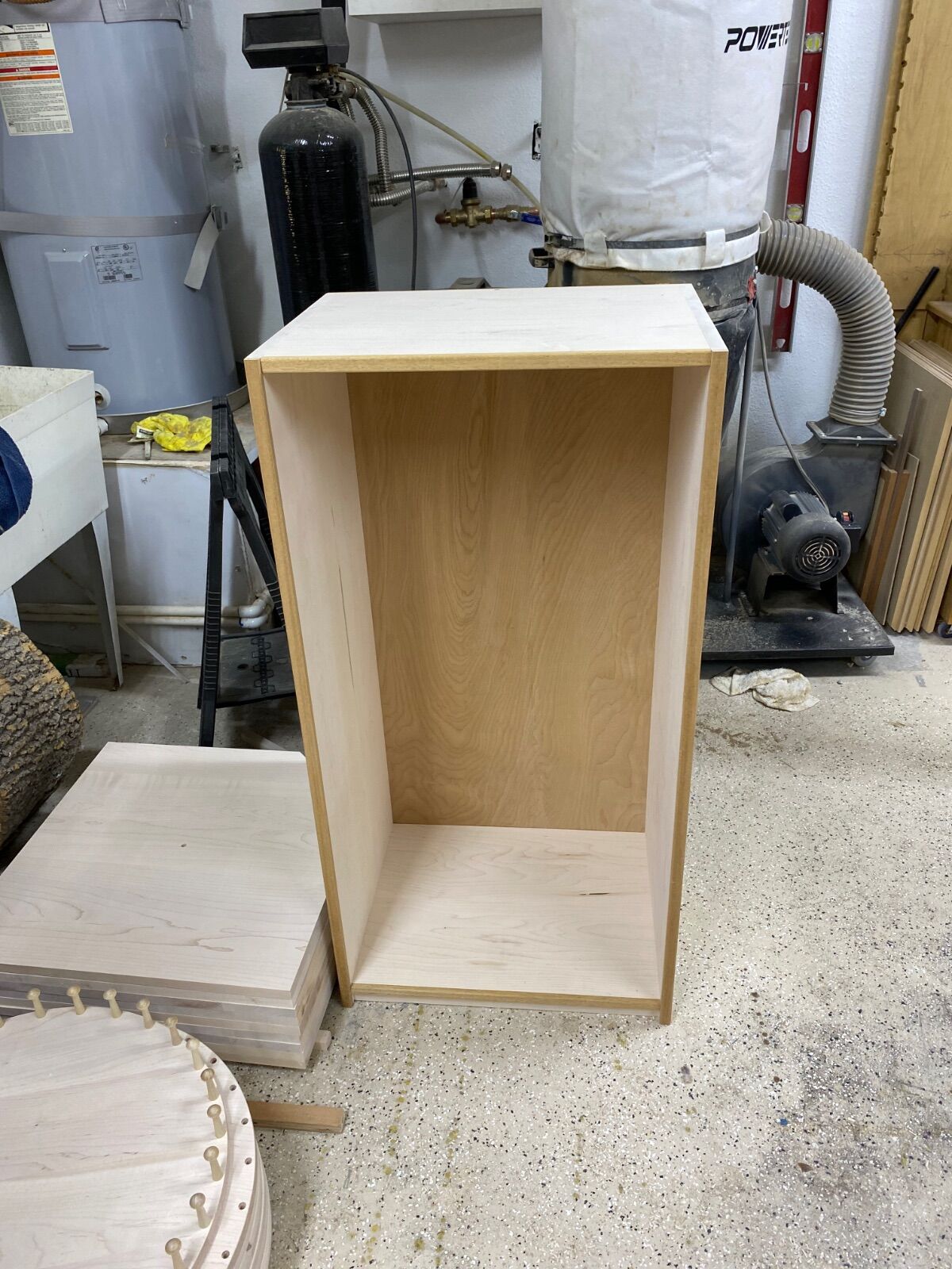

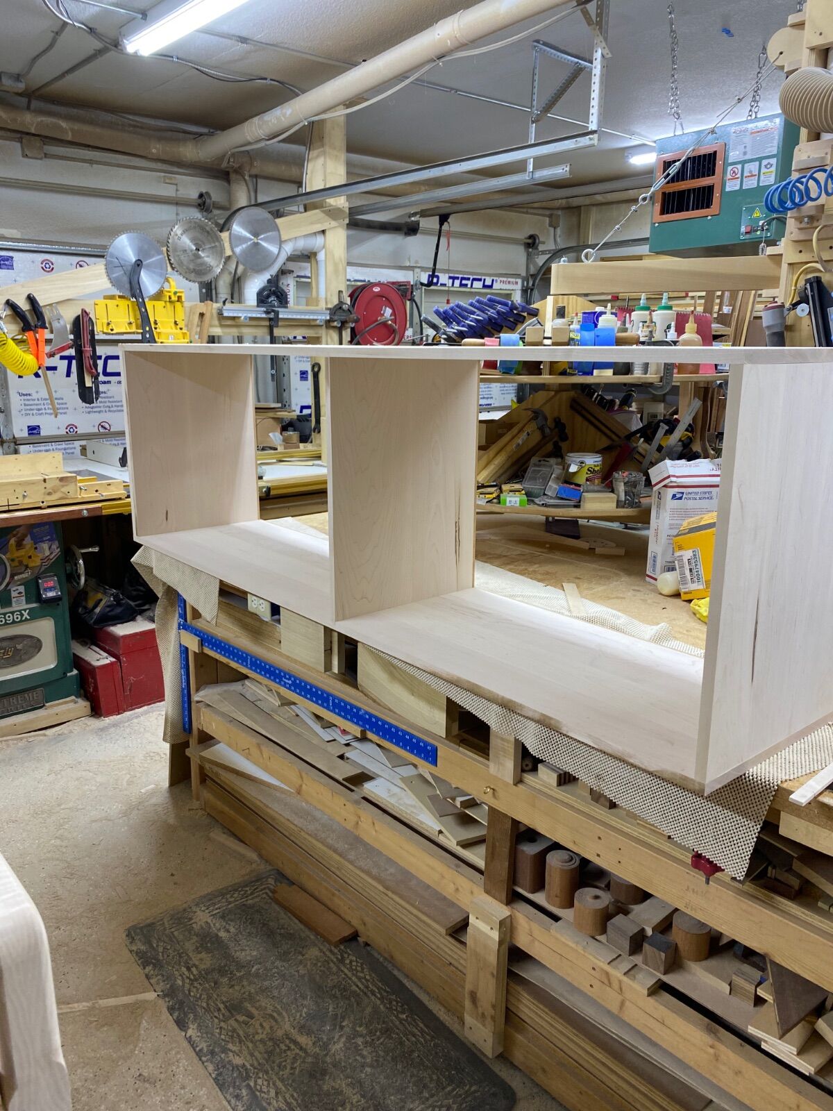

We managed to get two of the carcasses together. We will finish up tomorrow. It’s warming up here. 90 today. The roof is still underway. They have the felt down so they are slated to begin laying the tile on Tuesday.
Paul
