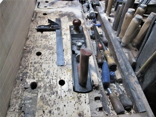

Sunday Morning..in the shop..:SaluteandRun:
Last two legs need done..layouts..:ChinScratch:

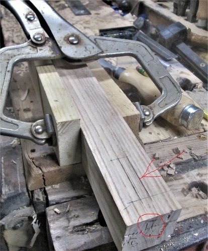

Additional markings?   "L" for long apron, "S" for the short apron...move this back into the jig..
Getting a bit chippy, try a dry fit...
Then repeat for the short apron.
Almost there, pared the gap away,,set this leg aside..

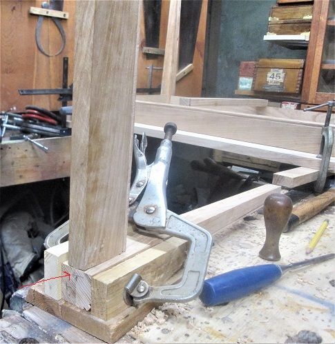

And repeat for the 4th leg,,,Stick was cut to length, and a tail added...

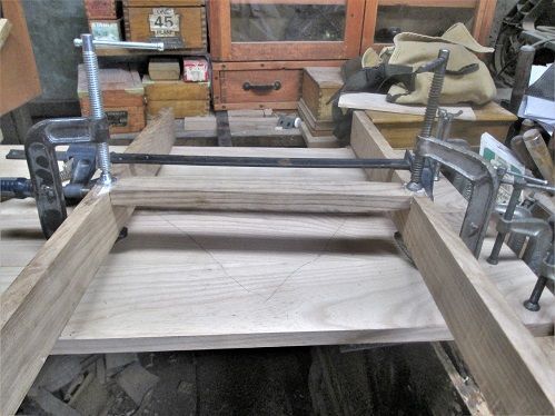

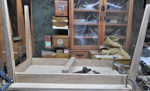

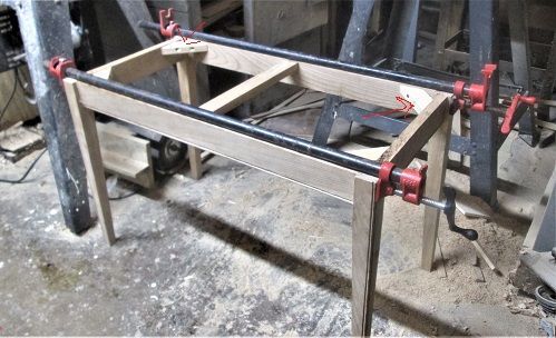

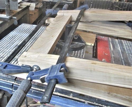

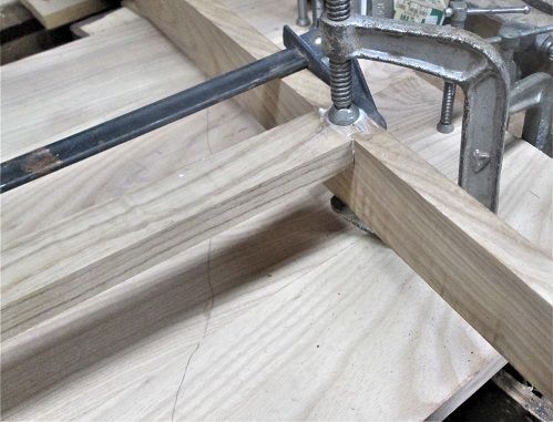

Will get back to this in a bit...decided to glue the 2 ends up...less work than trying to glue the entire mess at once...just a few sub-assemblies..
2 clamps?:WonderScratch:

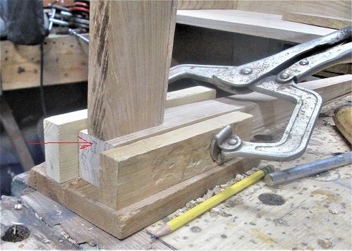

One above and one below the tenon,,,let these sit a while...back to that dovetail..:SaluteandRun:

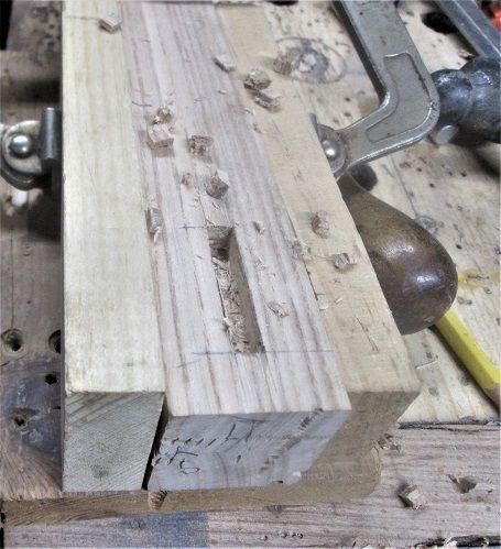

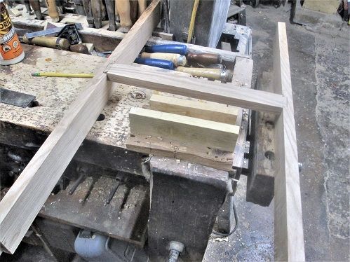

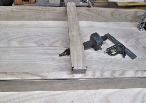

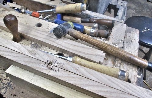

This is the top of the long aprons, with a center line across both aprons...Chopping sockets for the tails to call home..:ph34r:

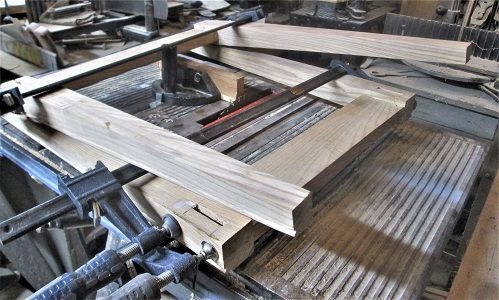

While they started out in the jig, I had to move them to the vise, and finish each separately ....might as well glue this up, too..:ph34r:
Added the c clamps..:ChinScratch:
To keep the tail down in the socket...:ChinScratch:

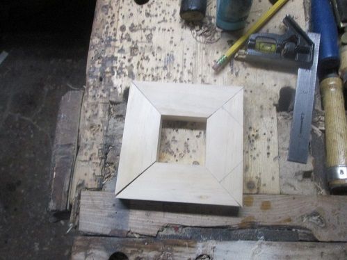

Need to run to Lowes in a bit...need a chunk of 1 x 2 Pine...to make the corner blocks....they pull a base into square at the legs, and provide a place for a slot...for the screws to attach the top,,,,speaking of which..:OldManSmiley:
Almost time for a trim?  :WonderScratch:
Stay tuned...might try again later today...:cowboy:

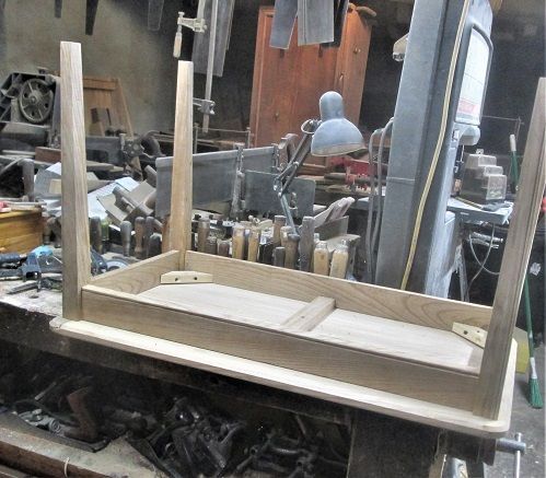

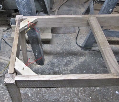

Got the corner blocks made..
New drill bit to drill some holes..
Then glue, clamps and screws...
237893940_TuesdayFolliescornerblocksinstalled.JPG.e768ad90fc4a1f60f8e05c12493ed42f.JPG
With a little "mallet assist"...let this sit a spell..

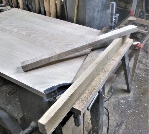

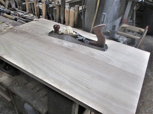

Table's top...

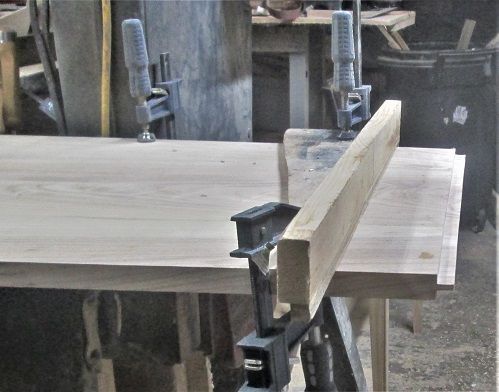

Found a high spot, or 2....
Ends were a bit ragged..

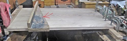

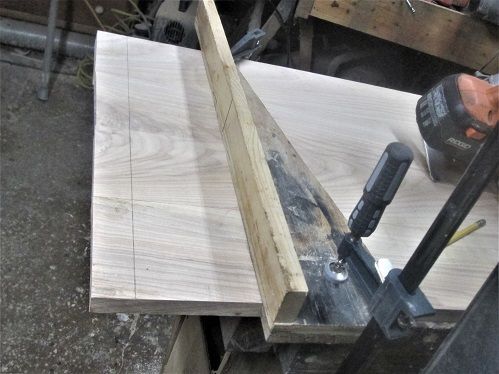

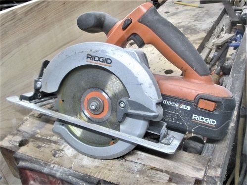

That battery is from a circular saw...trimmed both ends square..
Because I needed a good edge for the router....
Tongues for the Bread Board ends to get fastened to..
407580720_TuesdayFolliesBreadBoardsinstalled.JPG.7ce811f6a5b7b4e57c822095b5dc699c.JPG
And let this sit a day, too....

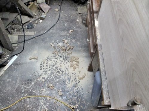

Late night, Laundry Detail....needed something to pass the time, and save one round trip on the stairs..:SaluteandRun:
Well, it seems these 2 got used for a bit...:ChinScratch:
Left a mess, they did..:rolleyes:...results?:WonderScratch:

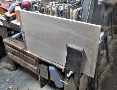

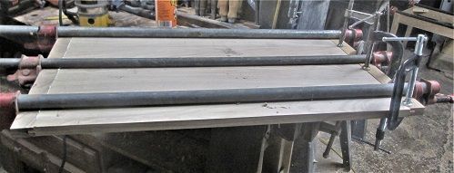

Moxxon who? :OldManSmiley: Edges have been jointed to match the Bread Board ends...gaps filled in...Bread boards each have a pair of screws coming up from the underside....Clothes were dry ( about 0200) and that was it for the night ( morning?):GoodNight:
May get out another router, later..( why change bits, just change routers, right Norm?) after I decide on the corner details...:WonderScratch:

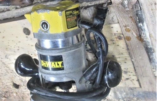

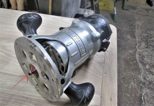

Today being "The Camel's Day"  decided to get something done.  Had one router to put away..
DeWalt No.610....Also needed to put away a circular saw...

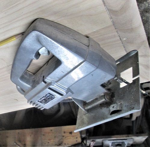

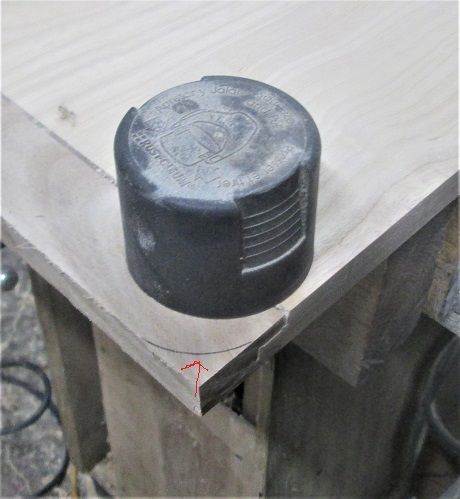

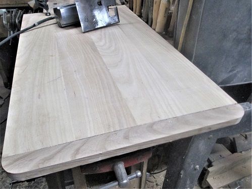

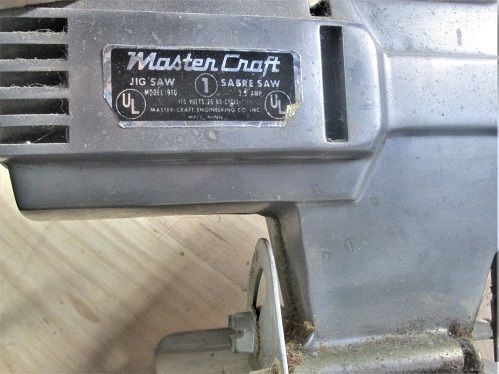

Square, sharp corners had to go...got out the "High Tech Circle"jig..:ROFL:
Then set up a vintage tool to make these cuts..once all the cob webs were removed..:MachineGun:
IF a tool is older than I am...does that make it "Vintage"?:cowboy:
Once the rough is done, the beltsander will clean up..:ph34r:

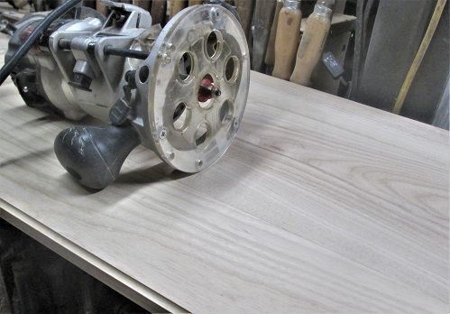

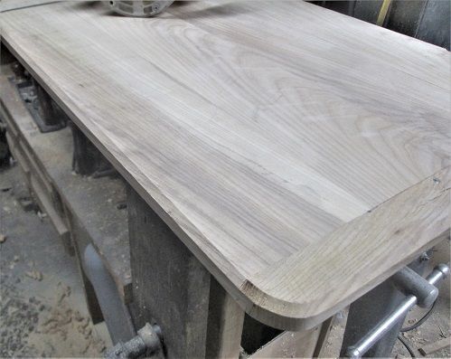

Then yet another router came out..:JawDrop:
Had the bit I needed for the bottom edges ..:TwoThumbsUp:
Flip the top over, reset the router with another bit..:ChinScratch:

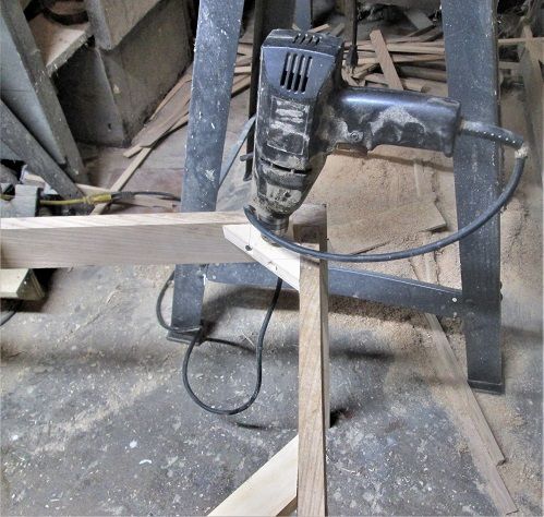

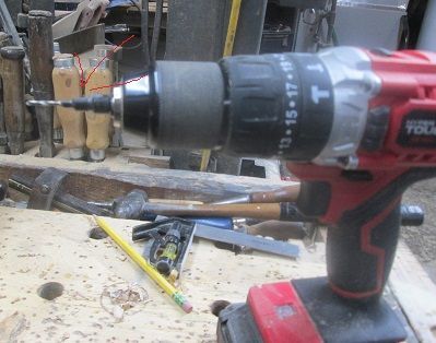

Then put this router away...dig out a special drill..

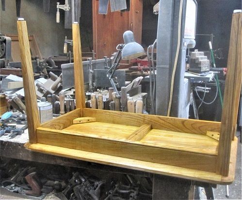

I drill straight down, then tilt the drill forwards and backwards, to make a slot..:ChinScratch:
Allows the wood to move a bit despite being screwed in place...a single hole in the stretcher will do, no slot needed..:OldManSmiley:

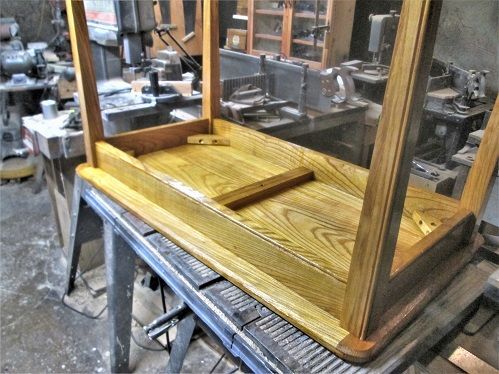

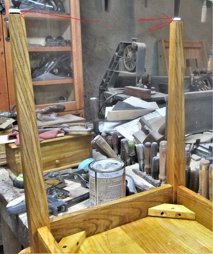

5 screws total...we are now together..:TwoThumbsUp:..1st coat of Amber Shellac coming up...:SaluteandRun:
Waiting to flip this over, and shellac the top....those white tabs?:WonderScratch:
Are Foot Pads...just nail on...:ChinScratch:
That will do for today...having an ICE COLD Yuengling Lager...to cool ME down:ph34r:

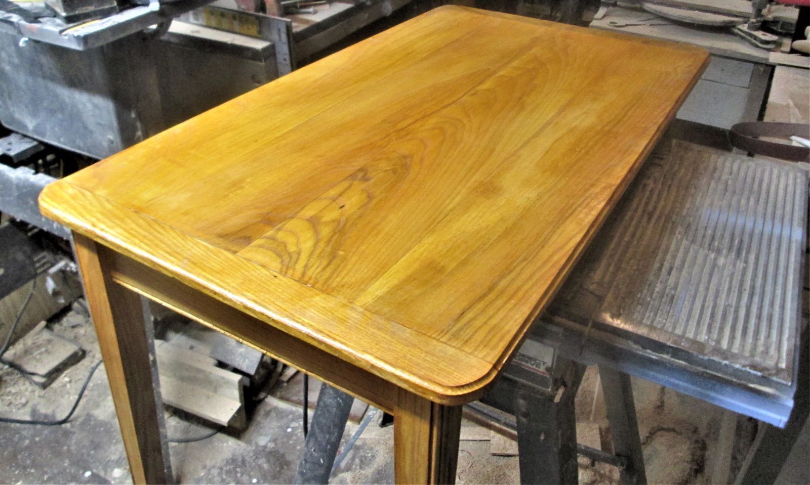

First coat on the table's top..
Looks like I might have missed a spot, maybe...second coat should take care of that...
Will try again tomorrow...
And see how it looks, then...

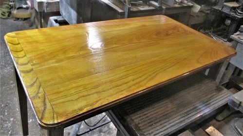

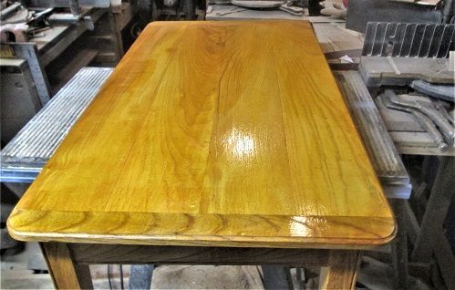

Clear Gloss Poly on the underside..
Waiting to see how it turns out...before I try to do the top...
:huh: No, it makes you an "Antique". DAMHIKT :OldManSmiley:

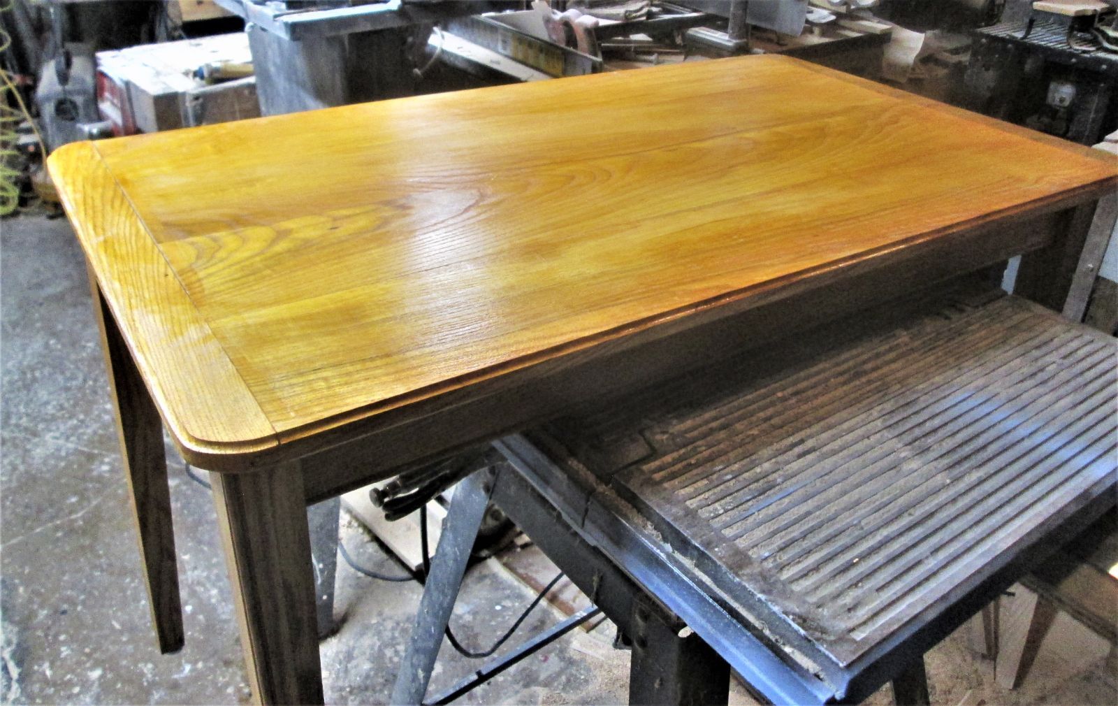

Top is now varnished...and rubbed out..
Hopefully, the grain does line up...

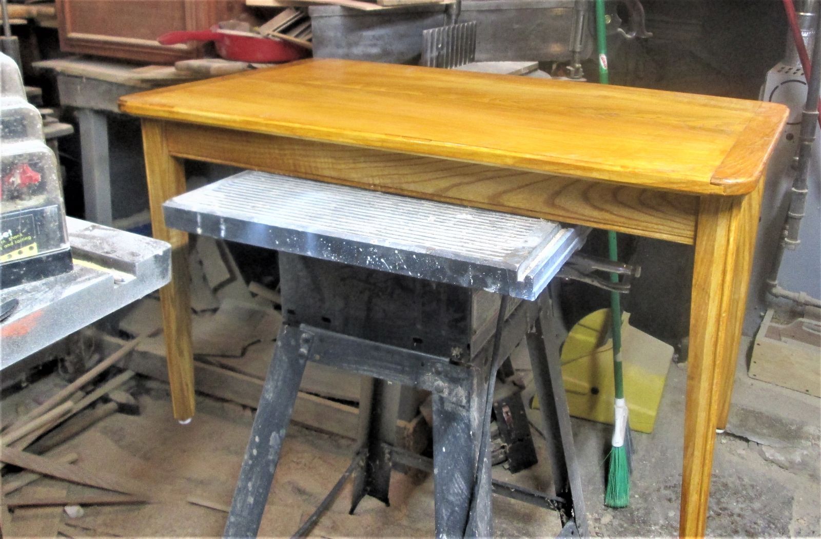

Have since moved this table upstairs..
And...the Boss already has 3 potted plants sitting on it.   Stands 21" tall, 33" x 19" top...
Need to set up a photo shoot, later...But, calling this Project done.:TwoThumbsUp:
