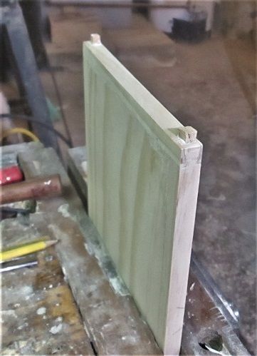

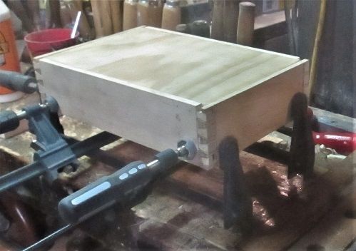

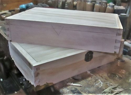

    Ok...figured I an make one corner joint in about...15 minutes or so.....wound up putting in an hours worth of work today...counting stopping to take a few photos...but..Corners #2 through #4 are now d
Decided to try me luck....yeah, yeah, I know...shop is NORMALLY closed on Mondays ( used to call them Murphy's Days:DevilLaughing:)  but was tired of sitting around...so..

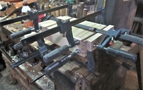

Them clamps had to leave..all 16 of them...first 8 were to glue the bottom to the box...:ChinScratch:
Which made it easier to get these 8 off the bench...B)
And..to get the last 4 off, I turned the box over...:OldManSmiley:

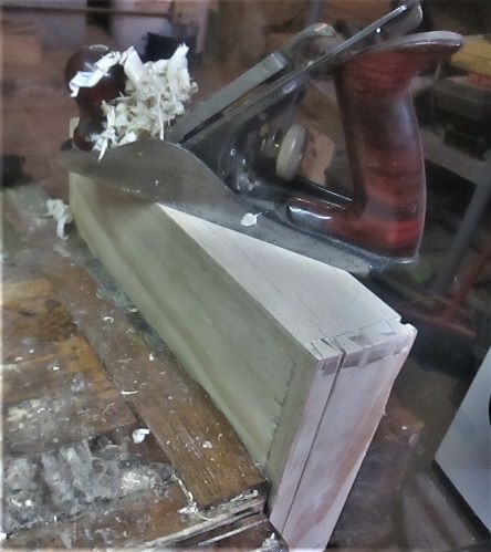

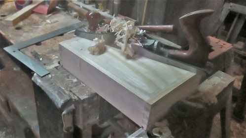

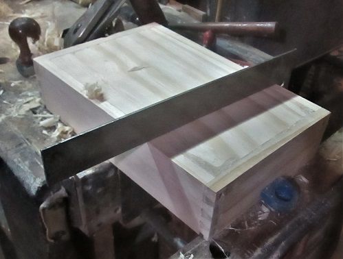

Then the real fun began..:SaluteandRun:.sanding dovetails flush, filling a few holes, checking for square...:ChinScratch:

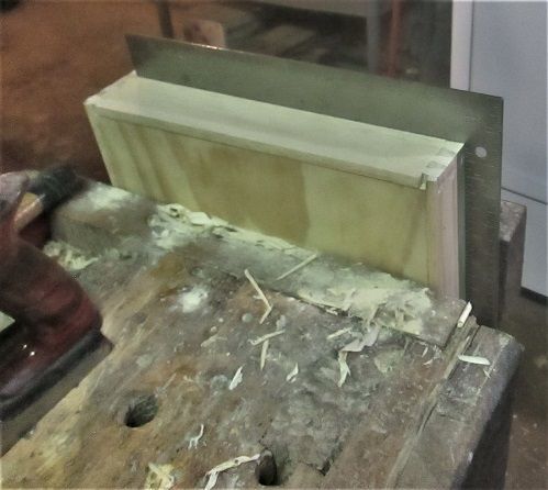

Looking for high spots...one edge was a bit angled...flatten that..once all for sides were done, and a combo square set up...time to work on the bottom of the box..:Cheer:

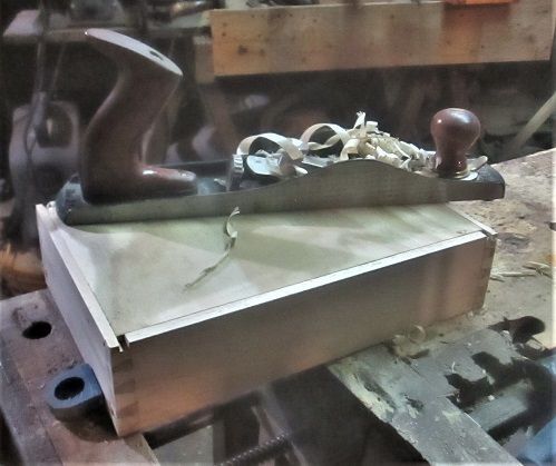

Used 2 planes, today...a Millers Falls No. and this WR #62....once the bottom was flat..:TwoThumbsUp:

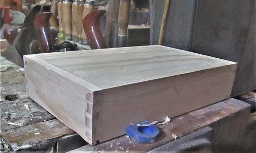

Flip the box over, and work on the top...there was also a high spot running right down the center of that panel, we have ways...checked again?:WonderScratch:
No gaps?   had taken the time to mark out where to make the saw cuts, again...as all that plane work had about erased the first marks ( why I set that combo square)
Why all this work to get the box flat and square?  :WonderScratch: Well, it will saw better, for one..:OldManSmiley:

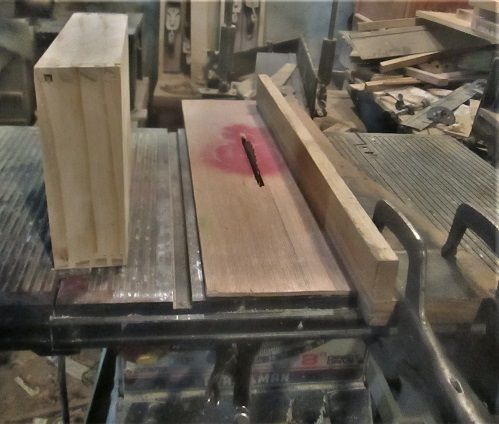

Someday, I need to make a new Zero Clearance Overlay..this one has developed a flex..fence set up and ready to go....:ChinScratch:
This is after the cut..one corner was a tad....off...:BangingHead:
Top left corner...Overlay flexed just enough on the last cut....well, haven't put the planes away just yet...plane down the higher spots level with the rest..check the fit, again..

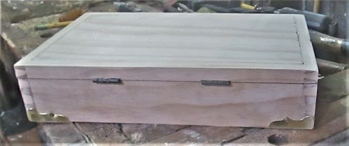

looks a little?  :TwoThumbsUp: Small hole at the bottom corners...get a brass corner protector cover-up..there are 4 square holes in the lid...:MachineGun:
Let the glue sit a bit, then trim this flush, and sand smooth..B)
Maybe tomorrow, I can get a bit done?:ChinScratch:
Stay tuned...:cowboy:

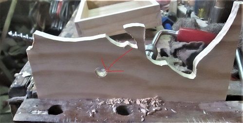

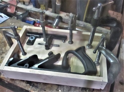

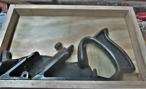

Fitted a pine insert around the plane..:SaluteandRun:
Lot of fancy bandsaw cutting...traced around the plane...Pine is sitting on the plywood "floor"..:TwoThumbsUp:

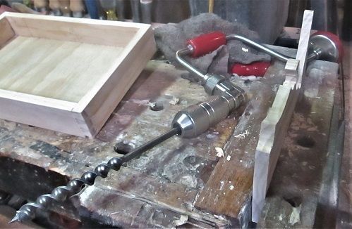

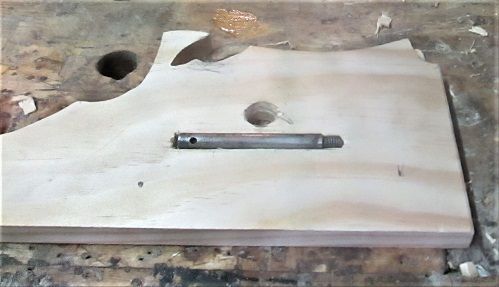

Needed a 9/16" hole drilled...got out the cordless drill and a #9 bit..:Cheer:
Drill from one face until the snail just starts to poke through turn the board around, and complete the hole,,Had some "trench work" to do..:ChinScratch:
Not really all that deep...:rolleyes:

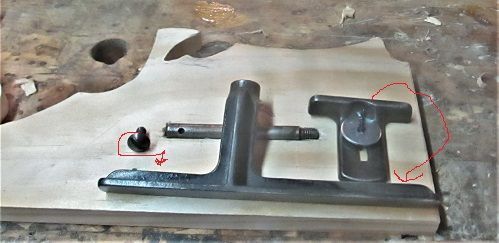

Rest of the parts...fence's bolt fits down into the hole.   I turned the depth stop around, to press against the fence...lonely little bolt got it's own counter bored hole...Spread some glue, and a few c clamps to hold things until the glue sets up..:OldManSmiley:

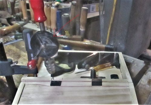

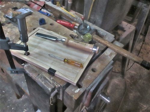

Set this aside for a bit..while I try to install some hinges...:ph34r:1213706239_Box2hingework.JPG.2a77227cd1784de1e9f80bc6d56cc384.JPG
One done.   Had to offset it a bit.  Made the other one match that.  A better fitting screwdriver, old chisel, mallet and a drill for pilot holes...glue had set enough..see IF I can attach the lid to the box..maybe?:OldManSmiley:
Worked for me..Clamp to keep the box in one spot while I worked it over...:rolleyes:

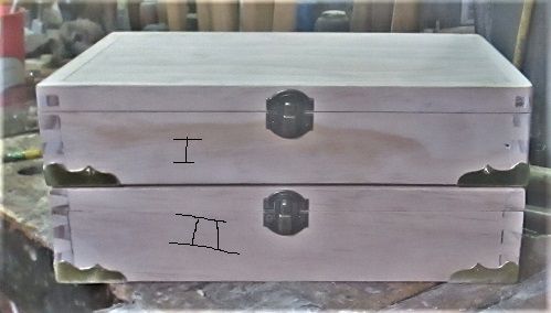

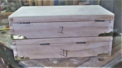

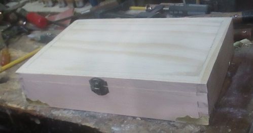

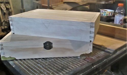

Hinged and Brassed.....set this into the vise to install the latch..:ChinScratch:
Lid and box were on different levels...we have ways ...to level the playing field :MachineGun:
Latch installed..:TwoThumbsUp:

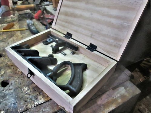

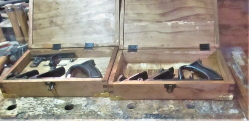

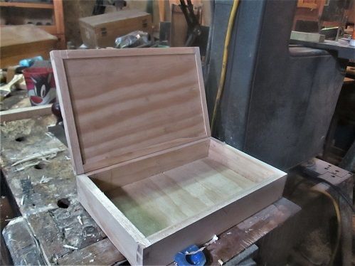

Open it up, and see how things look..:TwoThumbsUp:
When the lid closes, it press the fence into place.   Fence holds the rod in it's trench.  Lid also keep the plane in place.   Hmmm..B)

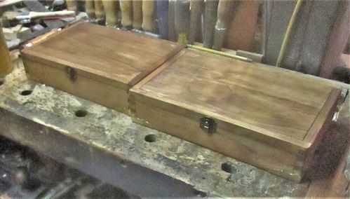

Stain has been applied..:TwoThumbsUp:
I guess this counts as a PIP?   Had to leave the lids opened...
To let them air out a bit....takes forever to get that smell out....doubt if I'll varnish the insides..
Going to try label making 101 later today.:WonderScratch:.then varnish the outsides..:TwoThumbsUp:

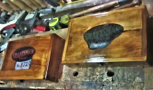

Stay tuned....varnish day tomorrow...
Put the crayons away...  :throbbinghead:

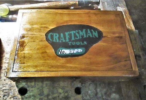

Lid now has one coat of varnish brushed on..then a label was pressed into the varnish..and a little more varnish brushed on to the label.....will check on them after a bit...
NOT Crayons....coloured permanent marker Sharpies....
Film @ 2300 hrs, ZULU....
just a teaser, for now....:rolleyes:
Red is the fancy plane's box....waiting on varnish to dry...
Sweet. You did those vintage #3270's perfect recognition with their new "old" boxes.
2nd coat has been rubbed down...labels installed under the hood...:ChinScratch:
and...:OldManSmiley:
