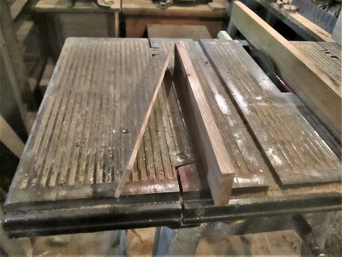

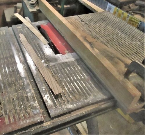

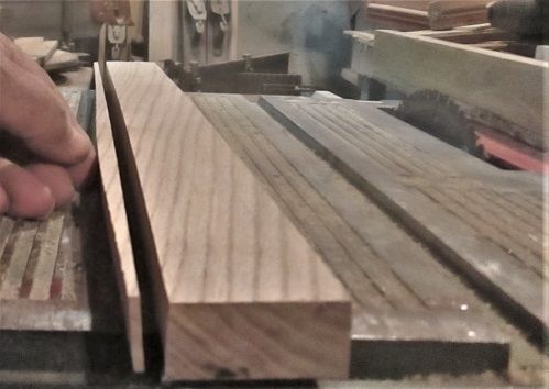

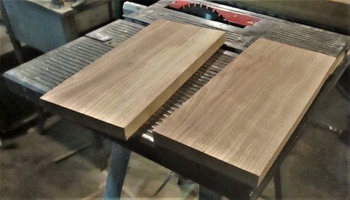

Idea being slide the best edge along the fence, and just skim off the wavy stuff...mark THAT freshly sawn edge..
With an "X"....reset the fence a 1/4"....slide the edge with the X along the fence...:ChinScratch:
264153535_AugustProject2ndstraightedgeripped.JPG.4d7786aedb10709c5063cce69f65ac89.JPG
And now I have a second straight edge, parallel to the first edge....But....3 boards made a wide panel..too wide...2 of the planks had some bad areas...reset  the fence..:ChinScratch:

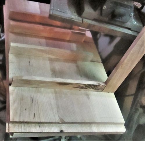

And we have a filler strip.   2 wide planks were at 10-1/4" for the width...had some gaps to clean up, too...so:WonderScratch:
(hand tool time!:Cheer:)

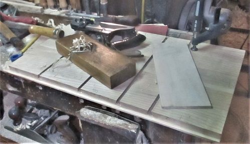

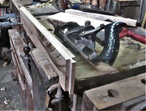

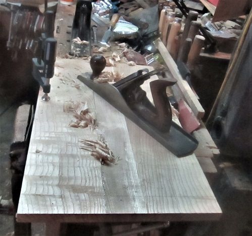

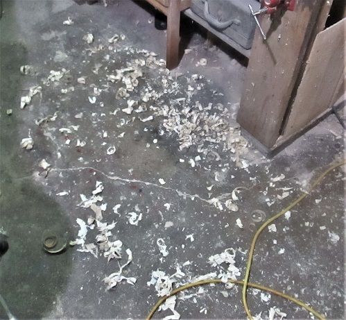

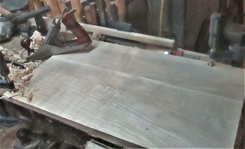

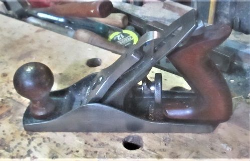

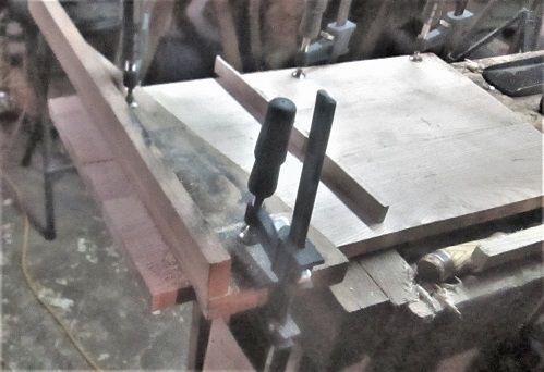

Clamp a board to the bench, and get out the Cordless No.6 Jointer...
Stanley No. 6 Small Jointer Plane.   Then check for gaps...:ChinScratch:
Repeat for the other wide board....:TwoThumbsUp:

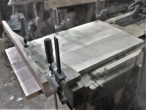

No gaps...Clear of the tablesaw, we have more work for it to do....:ChinScratch:

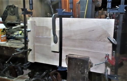

Set out 2 pipe clamps...moosh some glue around....add the upper/middle clamp..still no gaps....added cauls at both ends, to keep things flat...then back to the bench..
need to prep these for a glue up...once Panel No1 is done.  Again, No. 6 Jointer at work..:Cheer:
321693040_AugustProjectPanel2checkingforgaps.JPG.95f9ff726f828df752a3c3d7e13aec68.JPG
No gaps? And....
Not too bad?   Again..it is just sitting there, no glue, no clamps nor braces (don't sneeze!:ROFL:)

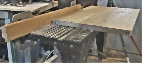

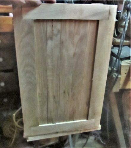

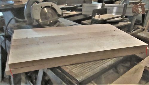

Clamps came off..panels need a little trimming done...:ChinScratch:

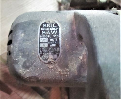

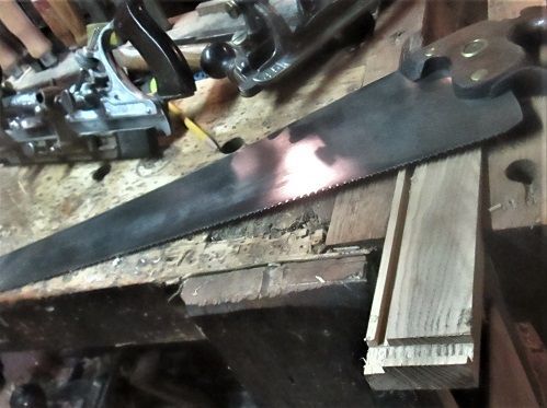

Maybe?  Not feeling up to using a hand saw for this, unsafe to use the tablesaw...AND get a square, straight edge...so, needed a Vintage saw, anyway..:JawDrop:
How Vintage?:OldManSmiley:

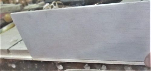

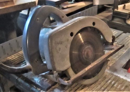

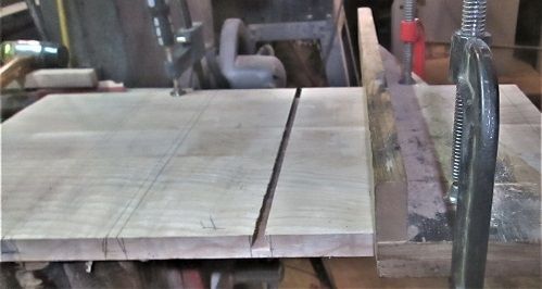

6" trim saw.   Needs a fence to guide it along, though...:WonderScratch:
Ok, I mark where I want the saw to cut...square that line across.   Then measure out from the saw blade to the edge of the saw's foot plate, that will run against the fence...square that line across, and clamp the fence to that second line.  As long as I keep pressure against the fence while making the cut..:OldManSmiley:
No matter how wide or narrow the waste, I can still get a decent, straight, and square cut.B)..repeat for the other end..

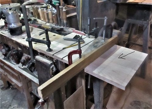

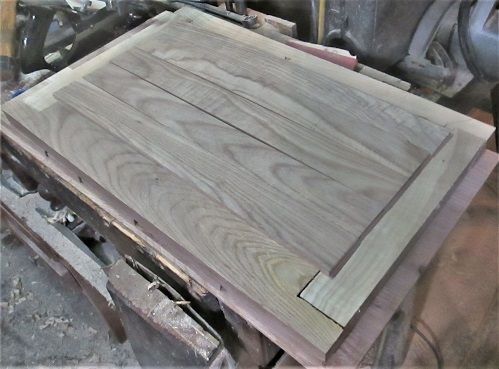

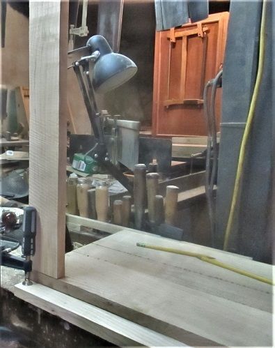

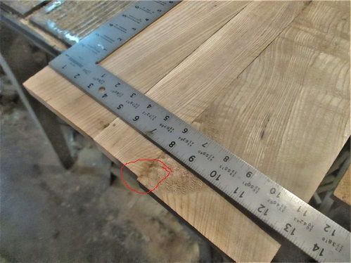

Then lay the "finished" panel on top of the non-trimmed panel..:ChinScratch:
Mark the 2 cut lines I need.   Since it would be nice IF these two will match each other..:BugEyeSmiley:..and complete the last 2 cuts...still need a couple clamps, though..
Glue line flattening (which had shredded a belt on my sander:ArguingSmileys:)...then finish all faces with a smoother plane..
At least to make things easier to do layouts.    And, figure out which will be the "inside" of the case.   The rip fence?   It had more work to do....after 3 planks were cross cut down a bit...set the fence to 1-1/2" width..:ChinScratch:
Although some needed a second cut...:BangingHead:

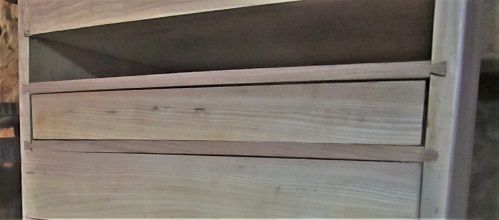

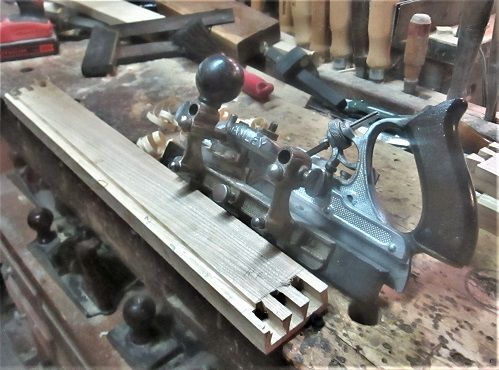

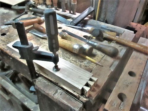

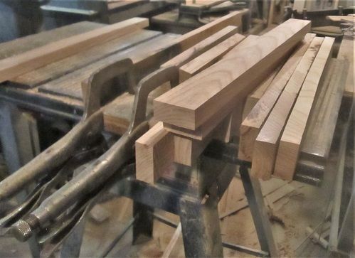

Drawer dividers, and drawer runners.   Dovetail to fit in a sliding dovetail socket (later) :TwoThumbsUp:  But, not every one was thinned down...at least not THAT thin...
Web Frame for the bottom of the chest....will go from 7/8" down to ~ 3/4" bare......these also get a groove to house a bottom panel.  At the top of the case, instead of a drawer, there will be a compartment..3" deep...so..:WonderScratch:
Which will get a rebate to house the 1/4" plywood bottom...and another to house the top edge of the plywood back...:OldManSmiley:

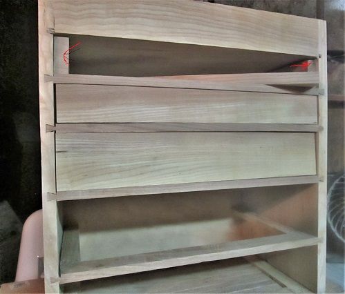

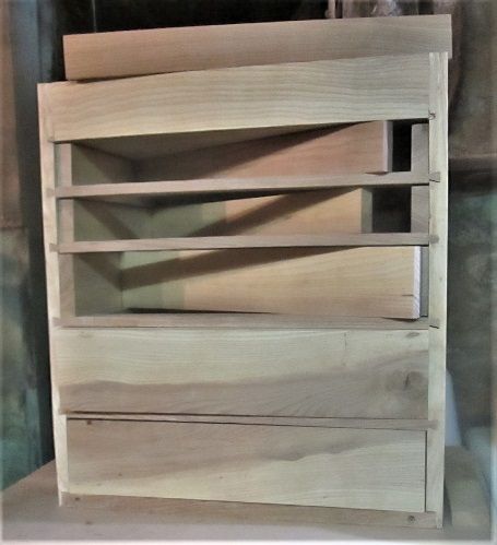

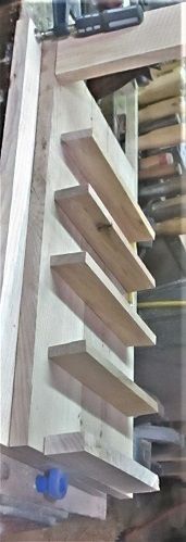

I also tried a bit of layout, to see how many drawers there will be..:ChinScratch:
35904446_AugustProjectspacedfor5drawersmaybe.JPG.e8bc6621d90c2c2ae0289b11fa39600e.JPG
Looks like there will be 5 drawers...might be enough?:WonderScratch:

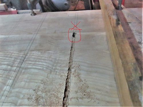

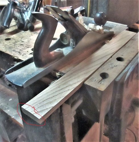

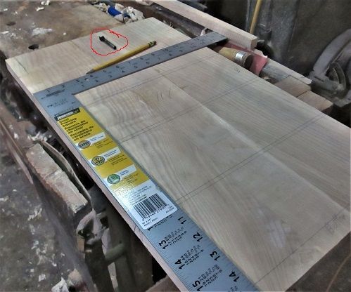

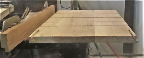

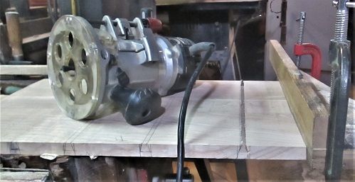

Edges have been planed, though.   Set about milling sliding dovetail sockets...:WonderScratch:

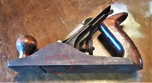

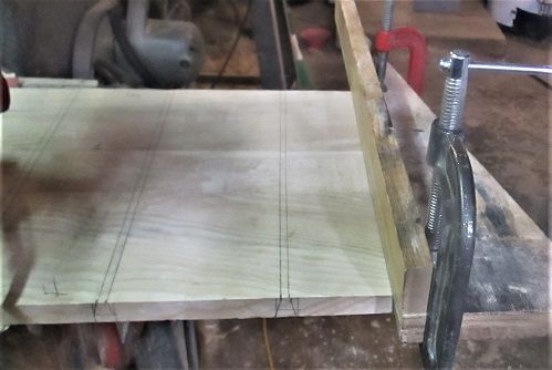

And try to transfer these lines to the other panel....red circle?  That be the dovetail bit I started out with...once things were set up...:OldManSmiley:
Did a couple checks, to make sure the bit was where it needed to be...then ran the router..:JawDrop:
So far, so good....reset for socket #2...and try again..:Tapping:
SNAP! :ArguingSmileys:  Half hour round trip to Lowes, buy a new bit.:ArguingSmileys:..back at it, again...:BugEyeSmiley:
Before I could do #3 and #4, had to rotate the panel...:Tapping:
And work my way outwards....double check to make sure the other panel did match up...all but #3...tried to correct that...almost did it..:BangingHead:
2nd from the right....rest are right on the money....Next...a few cuts along the bottom edges of the panels...
These to remove the bulk of the waste...then..:MachineGun:

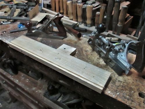

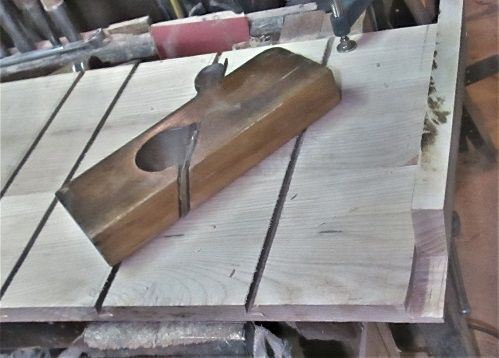

Skewed rebate plane No. 181......double checking for fit.:TwoThumbsUp:..also needed something like this down the back edge of the panels...
This is for the 1/4" plywood back....sample piece to set things up..

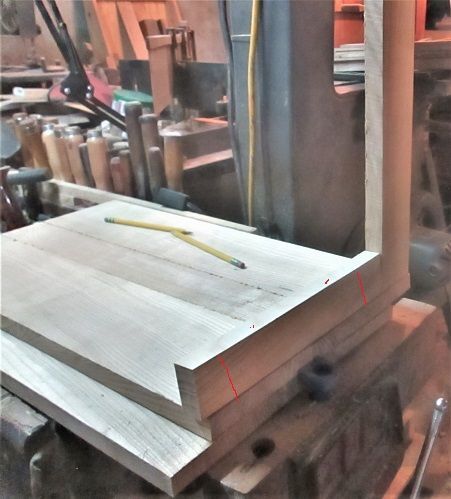

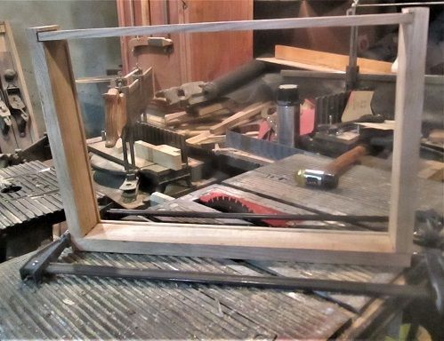

Webframe for the bottom of the chest?:WonderScratch:

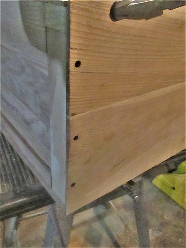

Stiles needed notched...will get a counter bored and plugged screw to hold the corners together.   Those slats?   they be the waste from when I thinned the dividers down from 7/8" thick to 9/16"....these were then cut for length..to match a set of grooves..needed to run the grooves centered in all the parts..
Fun part ( more cussing :ArguingSmileys:) was trying to assemble the dang thing...Cussing?  Think Day #1 Boot Camp Reception Center....:SaluteandRun:
Needed cauls to keep the corners flat....glue and screws....let this sit a day.....:TwoThumbsUp:

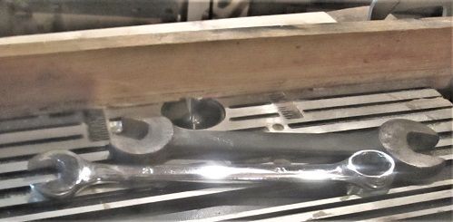

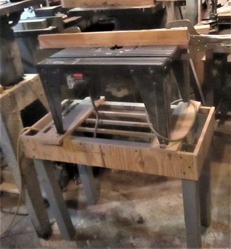

Cleaned it off, installed the fence to about where it needs to be.....router is an all-metal B&D....about the same as my DeWalt 610...other than paint colours and size of the chuck...which still takes 2 wrenches, to change a cutter:ChinScratch:
Same adjuster for height..as the no. 610 DeWalt:TwoThumbsUp:

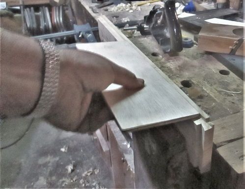

Goal is to make a dovetail joint that slides..:JawDrop:
Drawer runners (8) get this treatment....2 trips along the fence, then a dry fit..:OldManSmiley:
To see how they fit...adjust the fence a bit, for a better fit...Time to go vertical...:SaluteandRun:

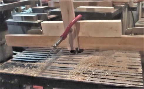

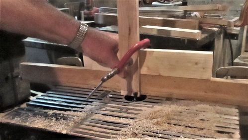

Slider and a c clamp...then a push stick...:WonderScratch:
Other hand is working the camera, otherwise, it would be helping out, as well..:ChinScratch:

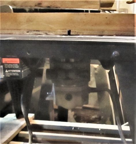

Been a long time since I have used this router table...router is still running great.

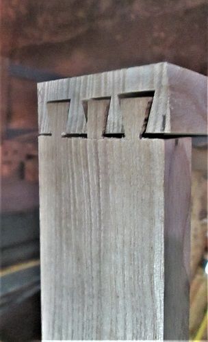

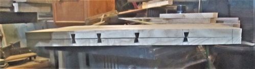

Day 3.....Sockets (4) have been milled
2 and..
2 more....took 4 set-ups....one for each.    The tails that will fit these?    Same system I used for the drawer runners....except..I forgot these are a tad thicker...:BangingHead:as in 3/4" instead of 9/16"....that first pin was a bit on the thin side...corrected for the other 3 ends...:OldManSmiley:

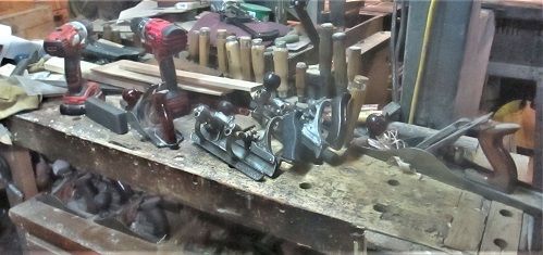

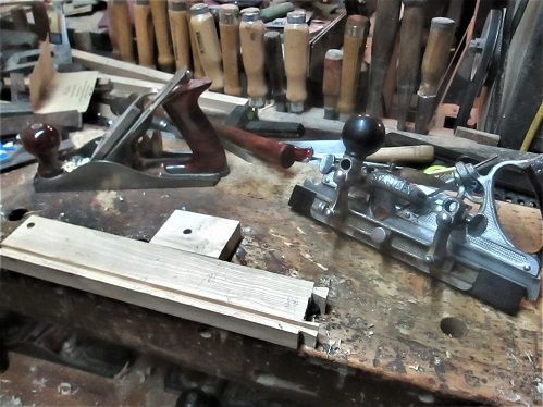

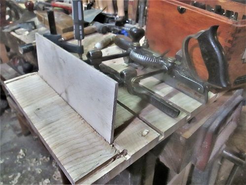

That should do it for the router, today...back to the hand planes.....floor of the top compartment, needs rebates and dados to support it...:ChinScratch: Rebates first..

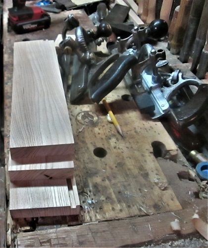

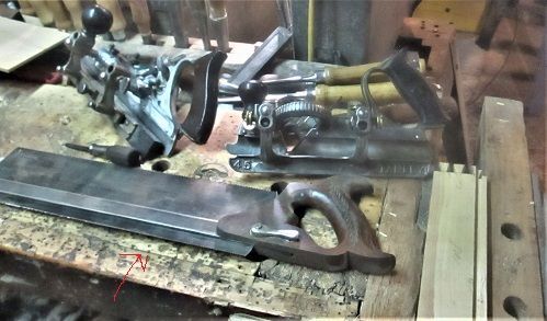

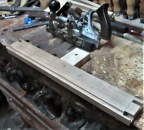

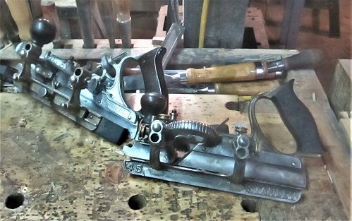

Ward's Master Quality (Stanley) No. 78....need enough room for glue and screws, and go down 1/4" for the thickness of the floorboard (plywood)..
Getting there....got both rebates done...and fitted...dado is next, needed two...settled for one..:WonderScratch:

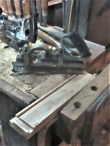

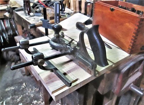

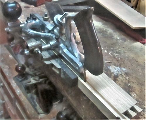

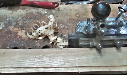

Had to set up the plane, first..Stanley No. 45, type 4...with both spurs pointing down..:TwoThumbsUp:
hardest part, besides the DULL spurs, was keeping the plane vertical....wanted to lean a bit....floor is getting covered, too..
This was just from the #78...anyway..:MachineGun:
Yep, dull spurs.:BangingHead:..haven't decided IF 1/4" is deep enough, yet....decided to try a full dry fit, of everything milled so far...and see just how much work needs to be done..:ChinScratch:

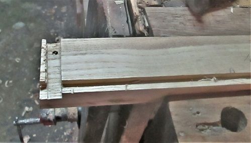

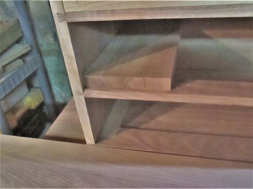

Steve, that is an interesting corner joint on the stiles and rails.  What is it called?  How is it held together?  I didn't see any dowels but did you use biscuits?  Is it mortised and tenoned?  Thanks.
Gunny, I think he may be further along than 55 %.  Scary.
These joints?  glue...and a single counter-bored screw.  goes through the thinner part of the corner, and into the end grain.
About like building door...
You can barely see one of the counter-bores right beside that gray clamp on the end...top left corner

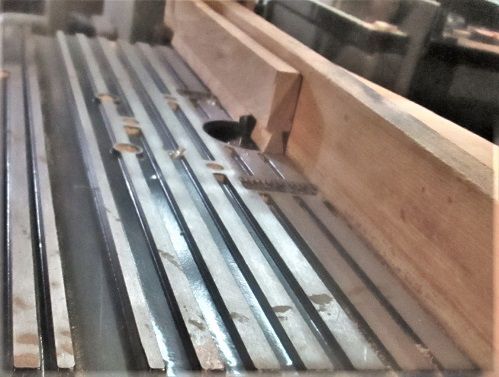

Router table has been put away, for now.   Tablesaw back out to where I can work with it.   Compartment floor has been cut to size....so has the back panel.  Reset the fence...peeled a saw blade's width off the front edge of the case's side panels...  Laundry Detail today....:SaluteandRun:

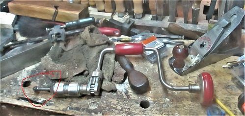

3 holes were drilled at the bottom of both side panels....then a fancy drill was used...:ChinScratch:
Millers Falls No. 1950.   circle shows the countersink bit....

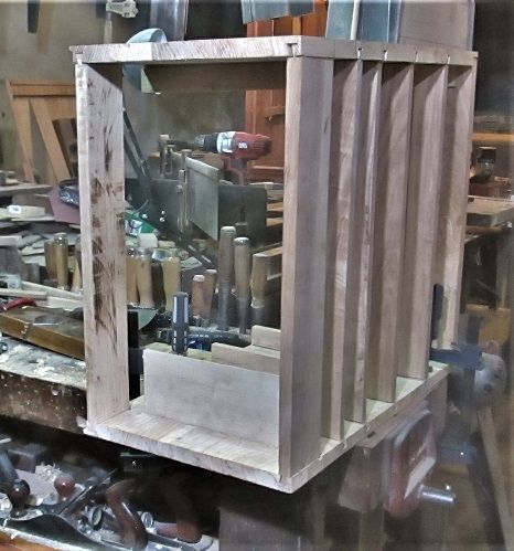

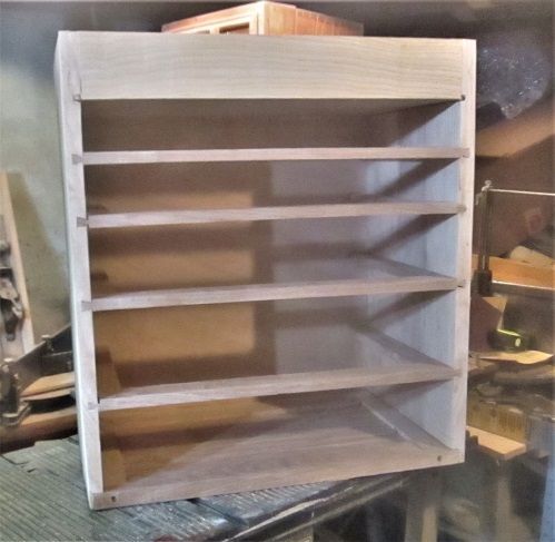

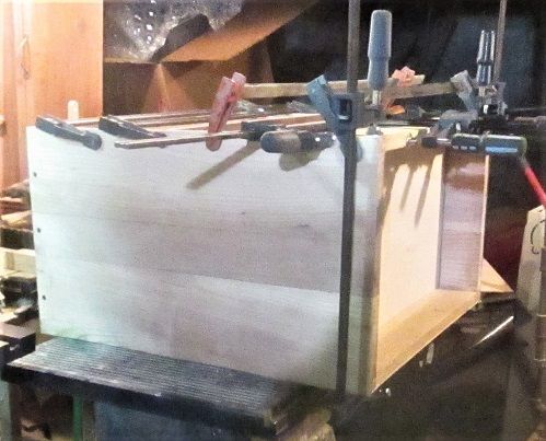

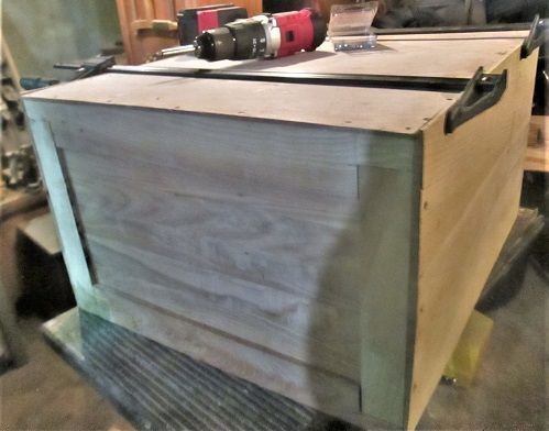

Glue and screws to attach the sides to the bottom:OldManSmiley:

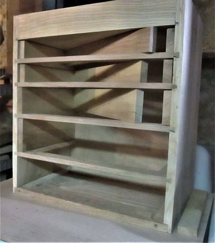

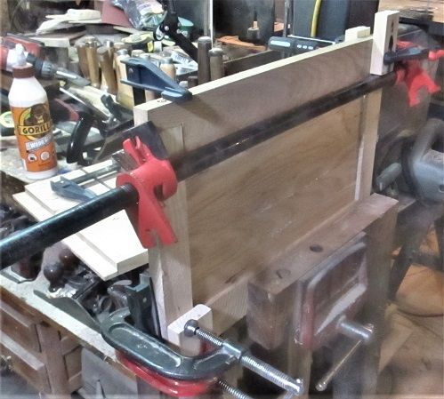

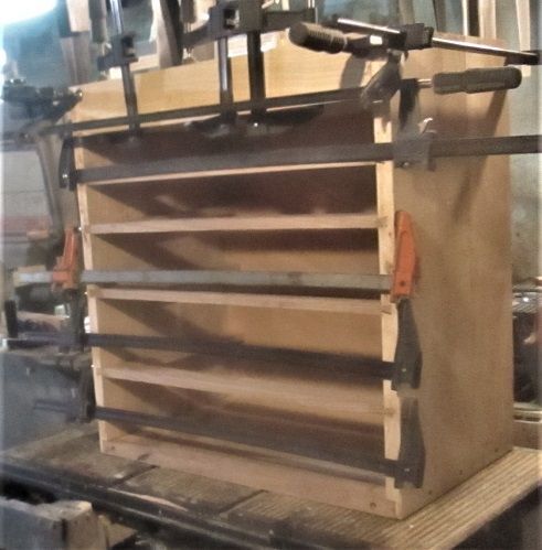

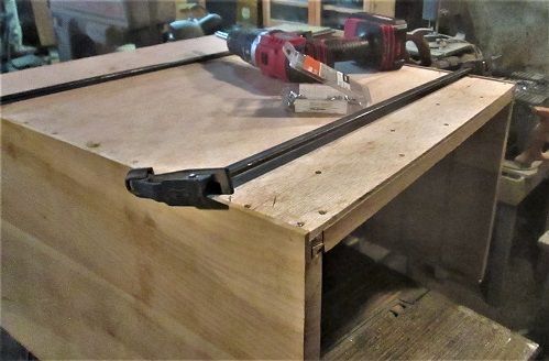

Clamps glue and screws to install the back of the case, including the top..:OldManSmiley:
After I had removed the burn marks...then flip this over...and install drawer runners, drawer dividers, compartment parts....:Cheer:
And from the other side..:ChinScratch:

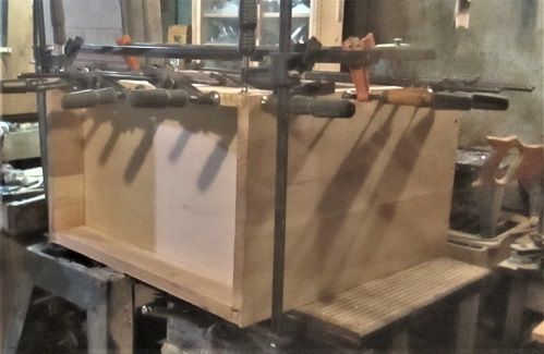

Enough clamps?  How about I stand this heavy thing up...?:ChinScratch:
Let this sit a day, or two...while I work on drawers....all five of them...:BugEyeSmiley:

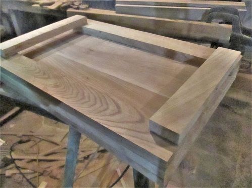

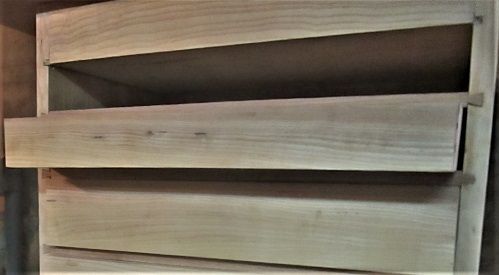

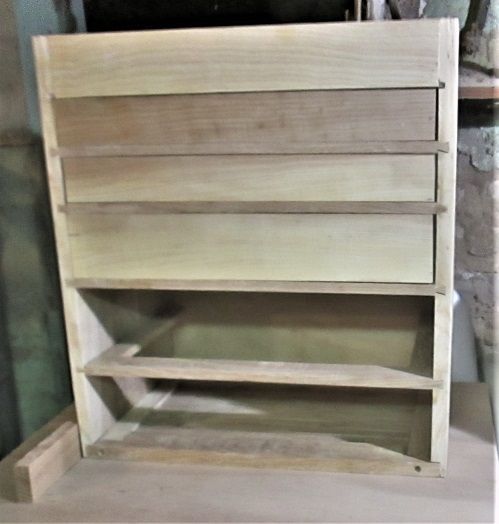

get caught up here...Clamps came off the other day..
Glue joints were cleaned up...and even a start on the drawers..
Yes, it is sitting on the new Dryer.:ph34r:..but, there is a clean sheet of plywood between them...Managed 3 drawer fronts with what I had hauled to the shop, that day:Tapping:

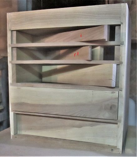

One hour shop time this morning....more tablesaw work..:ChinScratch:

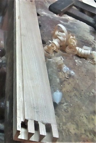

one plank managed to produce enough for 4 drawer sides...once I checked for length..
Removed the rough edges...and a tapered one at that...:BangingHead:
Then milled for width..first drawer's two sides..
Was on a roll...kept going...:TwoThumbsUp:
7 out of 10 sides..not too bad...wanted to get the last 2 drawer fronts..:Cheer:
Nice grain patterns....was to the point of either going upstairs to get the last plank, or work on 2 drawer backs..as I had some thinner stuff sitting around..and didn't want real thick backs.  So..:ChinScratch:

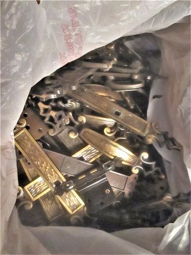

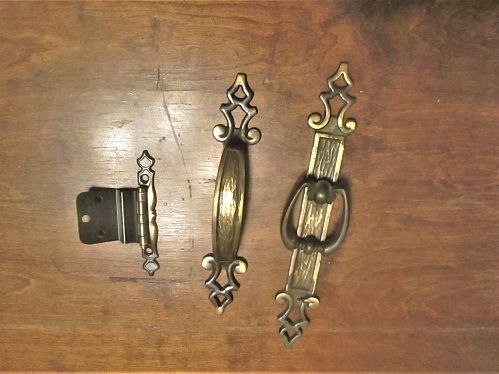

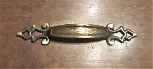

Picked a $2 box of hardware yesterday..:MachineGun:
Yard Sale, the owners had re-done all the cabinets in the house...the box needs two hands to carry it.:JawDrop:
has a nice selection of parts ( and the bolts for them)
Not sure IF the screws are in the bag......I don't know....:ChinScratch:
Do you think 2 of these per drawer would be a bit much?:WonderScratch:

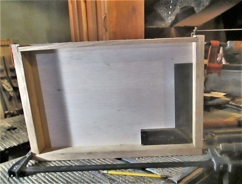

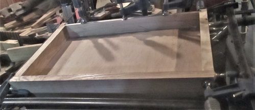

1525 hrs to 1830hrs...was a busy afternoon...including laundry detail...did NOT get off to a great start, though..:ArguingSmileys:

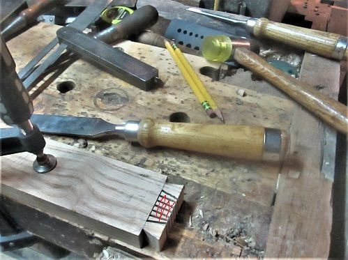

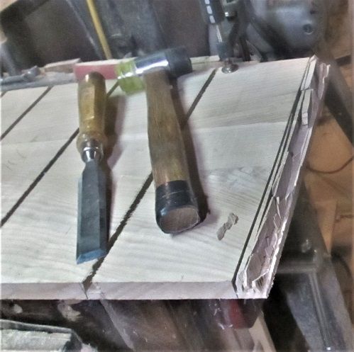

Not the way I normally do these things..:WhoMe:.wasn't much better on the next one..:PullingHair:
turned out, the router setting was a bit too shallow...:WonderScratch:
Getting better at each try...usual luck. :DevilLaughing:  need grooves for the bottom to sit in..:OldManSmiley:
Front got it's groove thing going...:Cheer:
Via a Stanley No. 45..with a 1/4" wide cutter...same with the sides..:TwoThumbsUp:
Making some curlie Qs:ROFL:
They come up, and try to wrap around me left thumb.:ph34r:..intend to leave this plane set up for this work...so..
So, I just set up the other 45 in the shop...for the next task.....but, since the spurs are still DULL..
I used a saw instead...:ChinScratch:
To plough a dado for the back of the drawer..hole was to help hold the side while I milled the groove..I can run a screw through that and into the end of the drawer's back...speaking of which..backs needed to be thinned down a hair, and flat..:BangingHead:
Yeah....reset the tablesaw, instead..buzz that "extra" width off.   ripped for width, to allow for the bottom panel to pas under..  then a dry fit for length..
Nibbled on one end until a perfect fit occurred...THEN cut a plywood bottom panel to size...:TwoThumbsUp:
Checking for square...may do a glue up sometime....Dryer is done..:SaluteandRun:
Looks like it just might have been a busy day?:KooKooClock:
Stay tuned:cowboy:
Went and added some glue, and a few more clamps ( can never have enough, right?) and that glue-up was it for shoptime this morning..
Then a Lumber Run was made...4 planks bought....two at 3/4" x 6" x 48", and the other 2 are 3/4" x 6" x 75"
Hope that will be enough to finish up this project.  price?  all 4 boards...was a total of $7...:TwoThumbsUp:

So...went to the shop LATE last night...was AFTER rehabbing a $10 plane..
From this...
to this....

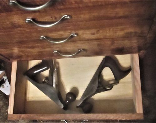

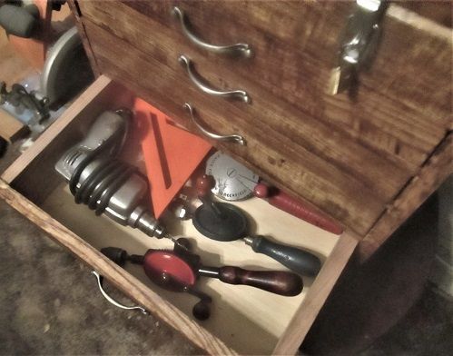

Took the drawer out of the clamps, and got it fitted to it's new home..:ChinScratch:
And...it even closes up nicely...:TwoThumbsUp:
Which left Drawer #1 to get into the clamps...despite Murphy's "help":ArguingSmileys:
Grooves to do,,this is the front..sides weren't much better...
At least I could drill a hole where the dado will be...to help hold the part still...Dado?
And..since I have yet to sharpen the spurs on the dado plane...:Tapping: Needed a saw instead..
Disston D8 Panel saw...pre-1928 style, 11 ppi....then cut the plywood bottom....and trim the back for length....:ChinScratch:then the real fight began..
Herding cats is easy, compared to this ( just walk with a full food dish..):ROFL: however much Murphy tried to "help" out:ArguingSmileys:This drawer WAS getting glued up and clamped up....needed a few extra ones, too.....and gave a couple of them an extra turn of the handle, just for spite.:MachineGun:
Let that sit a while...has a slight toe-in in the back..fine with me :ChinScratch:

Need to do the dovetails, too...might be a full day in the shop, for one drawer?    Need to FIRE Murphy, too.:MachineGun:
