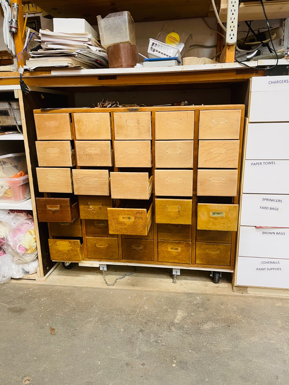

Popular Post Gerald Posted April 9, 2021 Author Popular Post Report Posted April 9, 2021 (edited) Well today resulted in a change of plans. Was just going to test a small area and then decided to remove finish on sides and front, then maybe the front and drawer fronts. Well this is a thick and hard lacquer finish so sanding was slow. Then the light went on and scraped it off not easy but good results. Yes @Marv Rallnot only will shellac seal out odor but is universal primer . And it can be used between oil and water based finish. So I decided to seal inside and out and maybe drawers. Then lacquer on outside. Had to make a support for the end of counter so did this little diddy. May get drawers later and maybe a door or two. Edited April 9, 2021 by Gerald p_toad, Fred W. Hargis Jr, Thad and 7 others 10 Quote

Popular Post Gerald Posted April 12, 2021 Author Popular Post Report Posted April 12, 2021 I applied shellac to inside and started applying General Finishes Arm R Seal to top sides and front. and working on platform to mount wheels to so will not add holes to the case. forty_caliber, Gunny, Artie and 8 others 11 Quote
Popular Post Gunny Posted April 12, 2021 Popular Post Report Posted April 12, 2021 Some beautiful work on that, looks spectacular!!! DuckSoup, Larry Buskirk, FlGatorwood and 2 others 4 1 Quote
Popular Post HandyDan Posted April 12, 2021 Popular Post Report Posted April 12, 2021 It will look new by the time you're done with it. Looking great! Cal, DuckSoup, Larry Buskirk and 3 others 5 1 Quote
Popular Post FlGatorwood Posted April 12, 2021 Popular Post Report Posted April 12, 2021 Gerald, that is some fiiiiine work. Looking really good. I never thought of using one of them as a tool storage cabinet. Gunny, Gerald, Cal and 2 others 4 1 Quote
Popular Post DuckSoup Posted April 12, 2021 Popular Post Report Posted April 12, 2021 Great save on a vintage piece! Masonsailor, FlGatorwood, Gunny and 3 others 5 1 Quote
