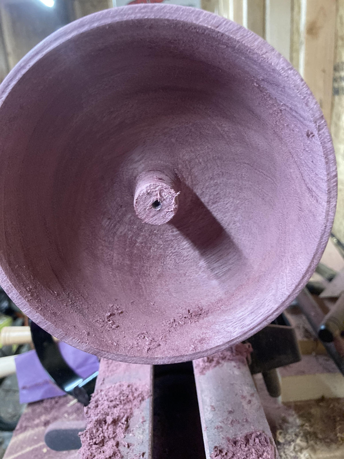

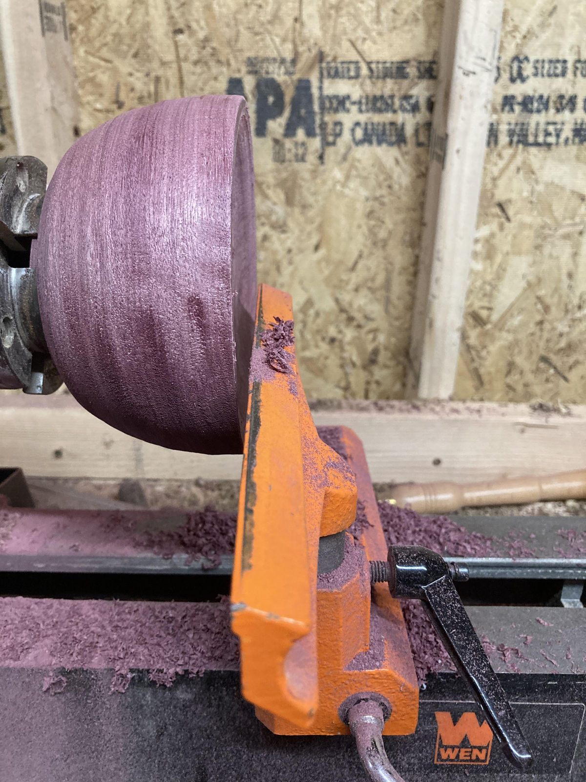

You asked me for pics of the tool rest position.  I did the best I could with the angles and to get a comparison of how the chisel sat on the rest with the lathe turned off of course.  It's still a bit on the bumpy side but once I started carving into the bowl itself it seemed to stabilize more not sure if that's because I'm cutting further down into the meat of the wood or what.  I also tried to dress up the outside a bit better since I've got drill power sanding stuff coming this morning at some point.

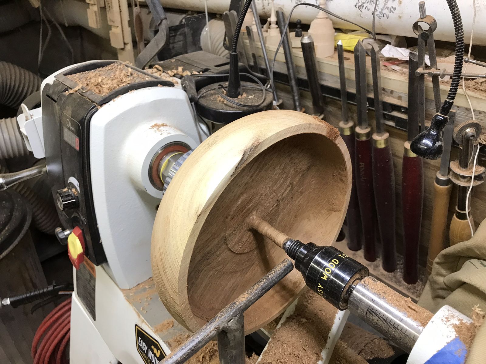

OK-
FIRST, bring the tailstock up against the inside of the bowl. That provides support while hollowing. It's hard to see in this picture but you leave a "post" in the center of your hollowing section until you get most of the interior hogged out.
SECOND- your tool rest position is good for now but as you remove the interior  you'll need to position the tool rest so the end is setting within the bowl hollowing area to keep it close to the wood.

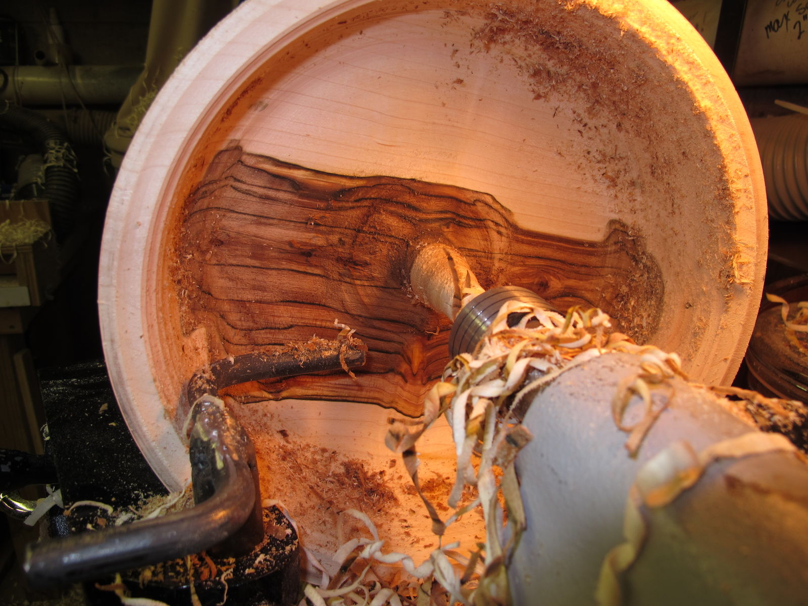

Couple of better pix-
Notice the end of the tool rest in the first picture. As the depth of the hollowing increases, you move the end of the tool rest further into the hollowed area. This keeps the tool rest closer to the material and helps with tool control. It you have those "curved" tool rests, this is when you would put them into play.

Okay @lew and @Gerald  This is the point where you guys get to say to me well we hate to say but we told ya so on this one.  So simply the top portion of the bowl wasn't as well trued as I thought it was.  As soon as I smoothed out that the wobble went away.  Before I did that I had just popped in the 60 degree chuck into the tail stock and locked that in.  100 times more stable.  Gah should of been doing that all along.  Its a bit on the awkward side of things trying to get in there with tools to hollow out.  I've still got some sanding to do on the outside yet how ever I wanted to give that a go with having that set with the tail stock locked in there carving into it and leaving a pillar for support in the middle of the bowl.  This way seems to be working so I think I'll be continuing to do it.  As far as removing that when the time comes i'll have to figure that one out.  As you can see with this short vid there is no wobble now.
