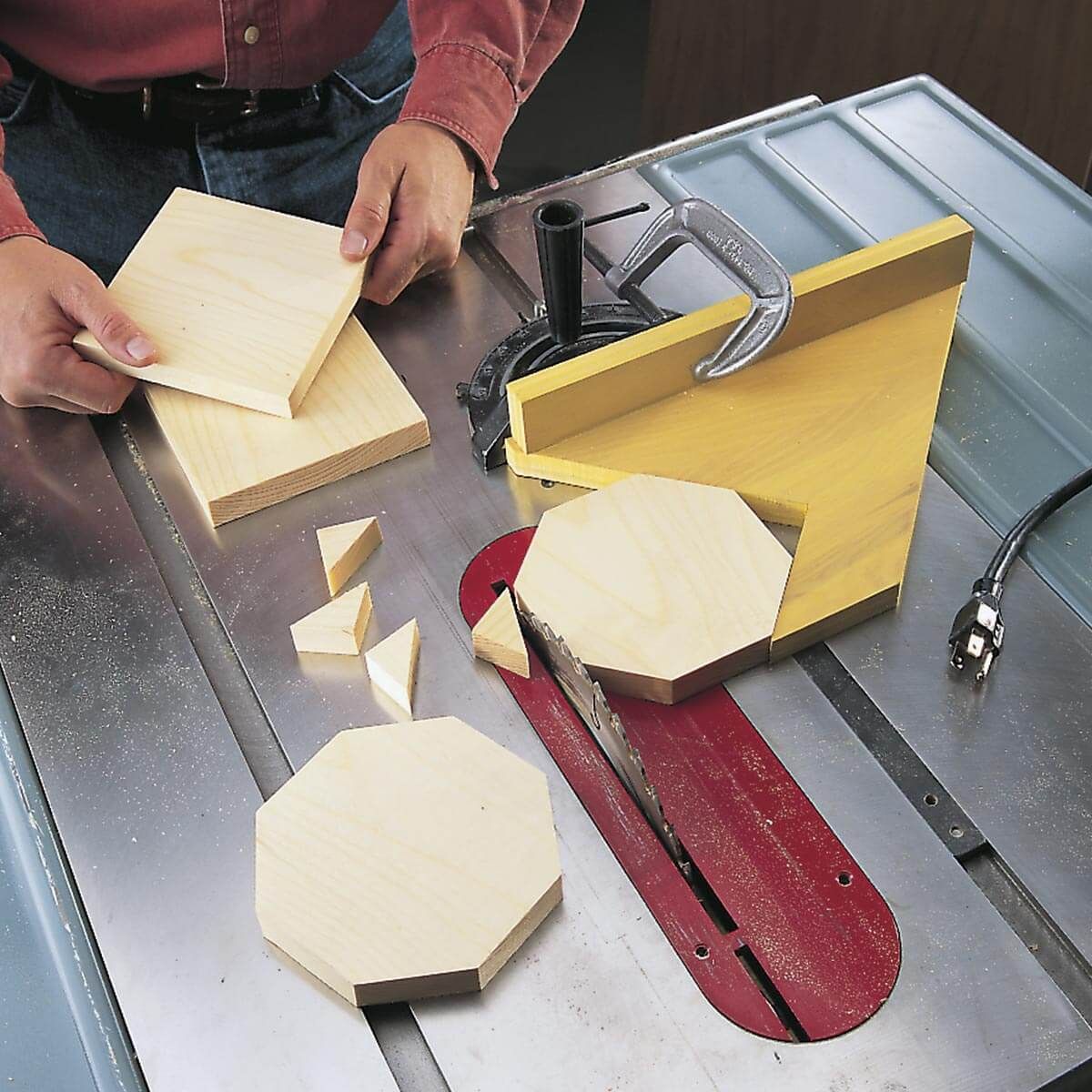

The EWT rougher works best when the amount of material taken off is about half the width of the cutter (or a little less). You probably noticed a lot of "chatter" when you first started and that's typical when the blank is square. You could reduce that some by converting the square into an octagon using a table saw or bandsaw.
https://www.familyhandyman.com/article/right-on-octagons/
I forget if you said whether or not you have a bandsaw.

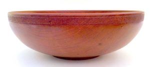

@Gerald mentioned sometime back about the outside shape of your turnings. Now that you have what will be the open end of the bowl sized, try to bring the tenon end to a little smaller diameter making a graceful curve from what will be the open end to the bottom. Aim for something like this-
With a 6" x 3"  bowl you probably won't be able to achieve quite this much curve but you can see the graceful arc of the side.

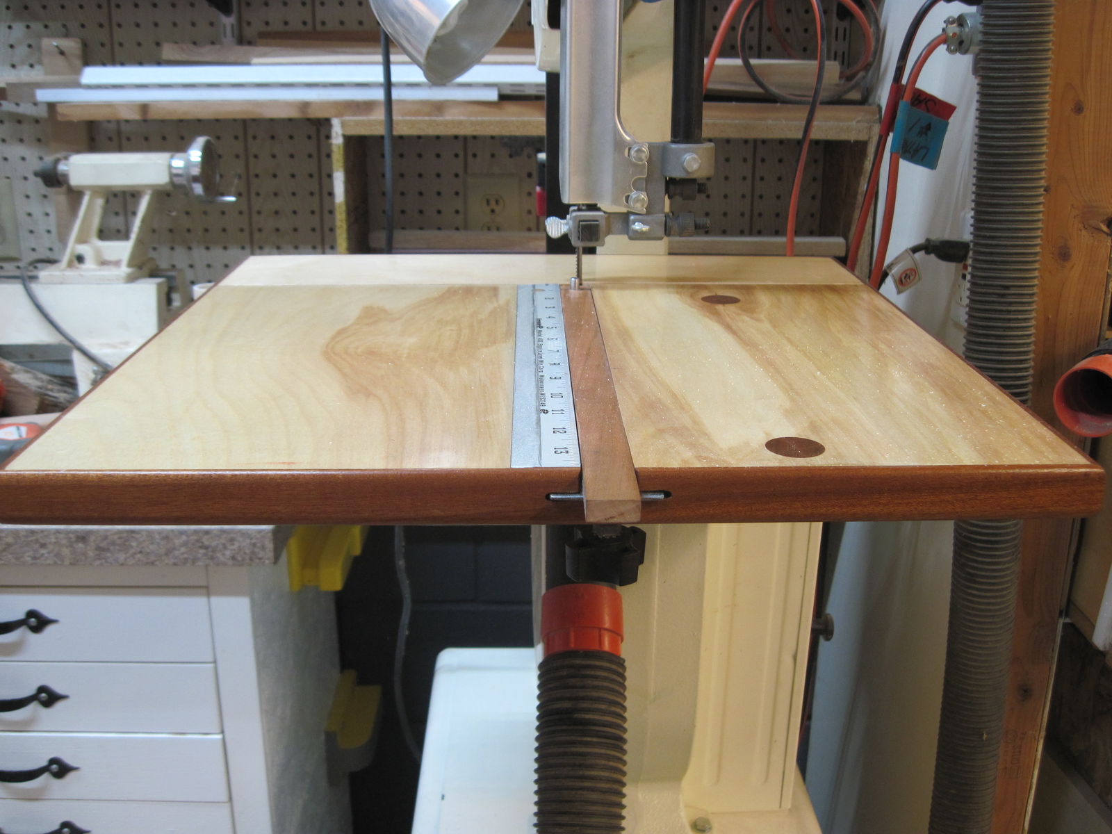

I typically cheat and use my Bandsaw Circle cutting jig.  This gives me a fairly round start on a piece before I take it to the lathe.  Any size bandsaw can have a jig made for this.  You can cobble one together quickly or make it as fancy as you like.  I also have used my hexagon jig on the tablesaw.  Fairly easy to do.
For reference here is mine.  It can easily cut a 26 inch diameter circle.  So this jig is useful for lathe work as well as other projects that might come up.  Cause ya never know.  :D

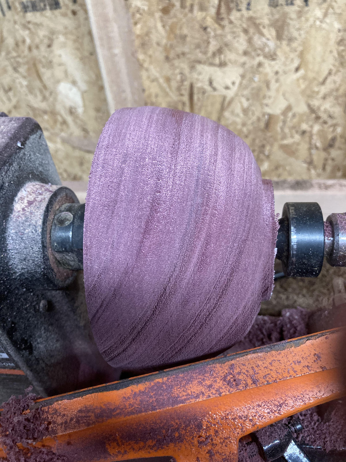

It did chatter quite a bit but I managed to get it carved down for the most part now no chatter.  Just got to work on the tenon for bowl so I have a place to lock the chuck on to.  I don't have a table saw yet and sadly no bandsaw blades at the moment I have to get some.
It seems to be a bit wobbly still towards the face plate.  Hopefully the tenon is right lol I don't want to have to carve down any further on that side.  I just have to work on the curve of it and some how straighten out the woblble before I even think about mounting it to the chuck.  I dont want it to be wobly mounted on there.  So not quite sure how to fix that as of yet.  I can only trim off so much material.
That’s really not bad at all. It is not unusual for a turning to be “perfectly” round on the faceplate and when reversed to the chuck to run a bit out of round and need a bit of rework.

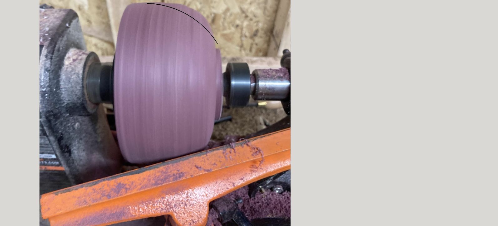

Here's what I meant about the more graceful curved side
The black line shows a more gently arced side.
Yep that's actually what I've been trying to work on is the curve to the bowl.  I'll be out back at it again in the morning.  Ah yea I did get some drill bit sanding stuff so no more hand sanding for a while except on the inside of the bowl.  But that's actually the shape I was aiming for or trying to aim for at least.

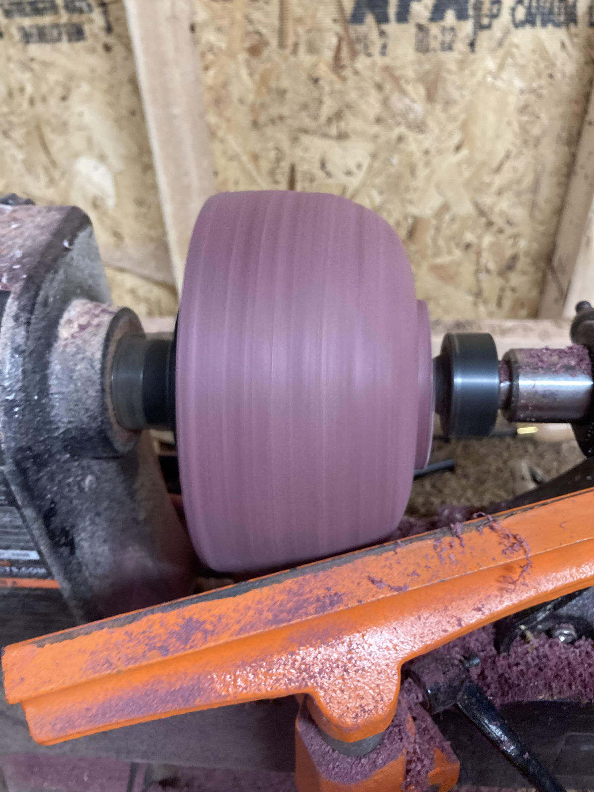

I think I've finally got the desired curve to the bowl that I want.  I think once the tenon is smoothed off it will look a lot better.  Now to hurry up and wait for my sanding disc and drill attachment to get in so I can sand the outside of this thing.  Hollowing should go a lot better with this project.

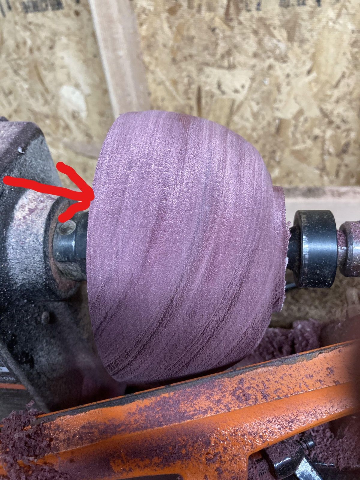

So far th is morning I spent most of it sanding Not sure what to make of the wobbliness I'm hoping it doesnt effect the hollowing process because I plan on starting that here shortly.  Its roughly sanded to 400 grit on the outside.  I will be finalizing the bottom after the hollow out using the cole jaws later on.  So that will be re done but in the mean time not sure what to do about the wobble.  I don't want to completely re design what I've done.
That's typical when you reverse a turning. I'd ignore it. Start by facing off what will be the "open" end then proceed to the inside.
