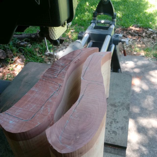

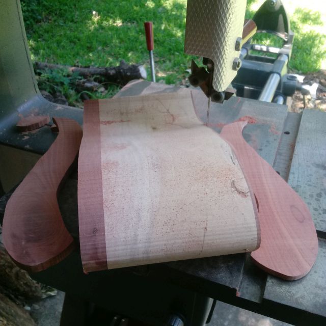

    Here is another board from the cedar tree that grew in the back yard of Ann's childhood home.  We purchased the property after her mother died.  So, when hurricane Ivan came by, he decided he didn't l

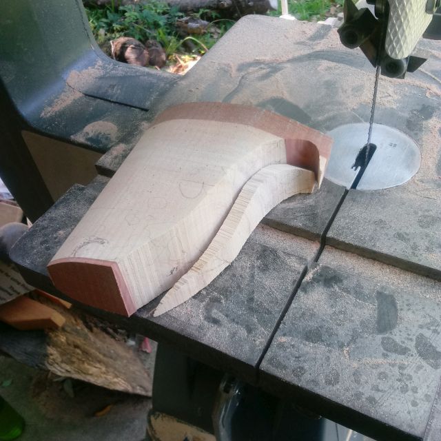

    Just a couple more photos from today.  The drawers will be hollowed while the front and back remove.  Yes, I saw the light bulbs turn on.       Just tracing of another part of the

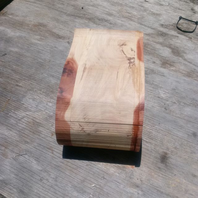

    Got a couple of hours today.  Wood is going back together minus the parts that make the drawer pockets.       Out of clamps and it stayed together, but you can see where it needs

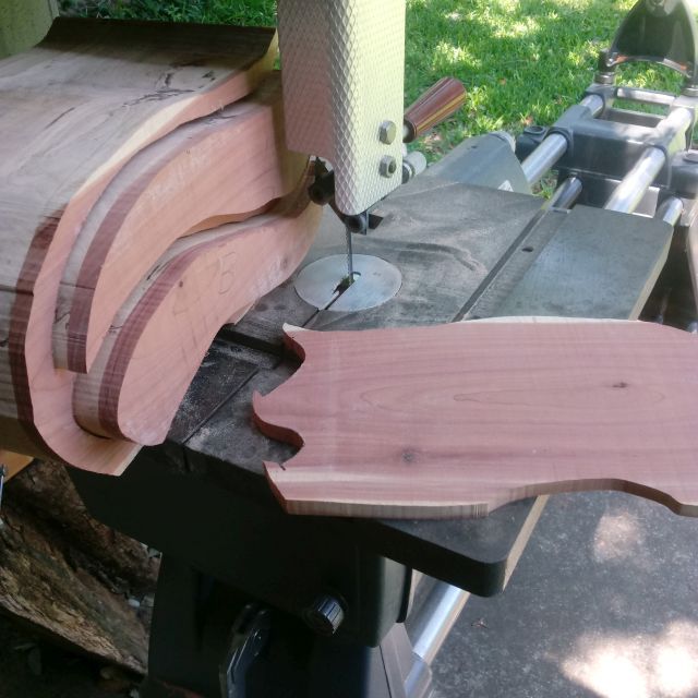

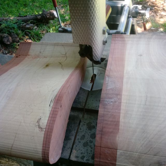

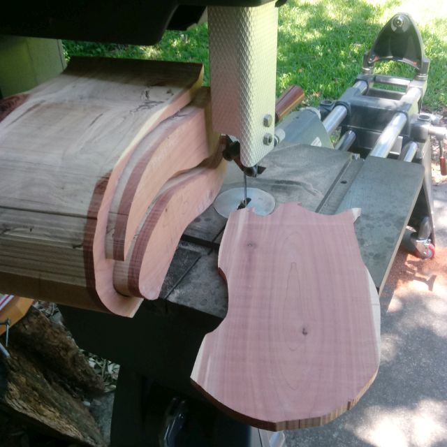

Thanks, Al.  Finally getting back to this project.  Been doing so many other things but for the moment, caught up.  Turned 3 pens this morning and got a few hours on this project.  The last time I posted, I showed the back cut off and the drawers cut out.  Before putting the back panel back onto the box, there were 2 little cut outs to be made.  Now, it looks like a hog lying in the mud.  :D  But, here are a couple of pictures to show how it looks.  I had to trace these cut outs from the pattern which you have seen.  So, I won't bore you with that.
I'll turn the back panel so you can see it better.
And, now, you see the pig.  Next step is to remove the front and back of the drawers, so here we go.

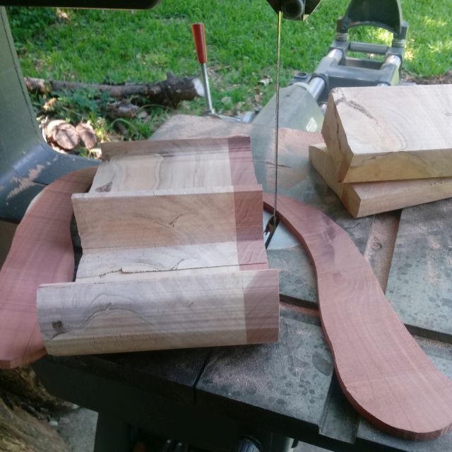

The next pic is to show the fronts and backs of the drawers removed.

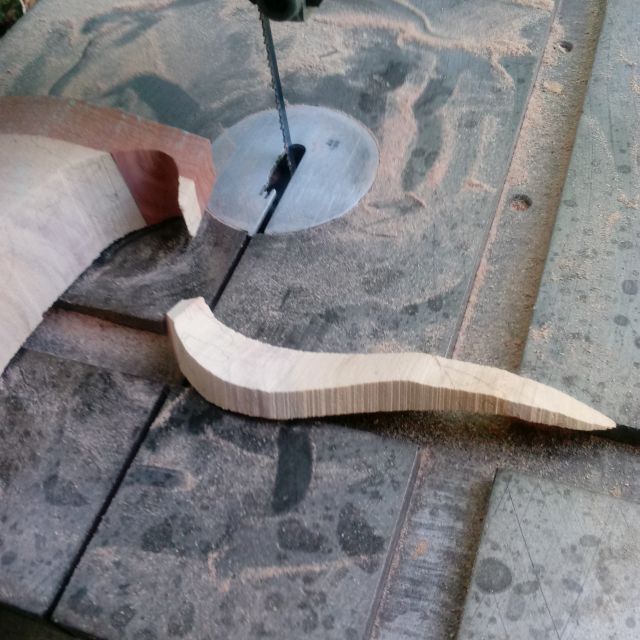

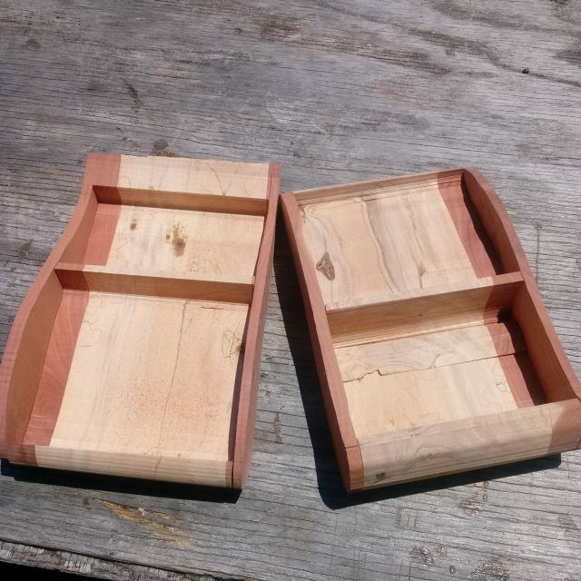

Just tracing of another part of the pattern.  This is not hard, just many steps.  Just think we get to glue all this back together.  :Laughing:
Yes, I buggered this one drawer.  This Olson blade does not turn are quickly as the 1/8" or one with more teeth.  It is an aggressive blade which I like, but I prefer a little more ability to turn without binding the blade.

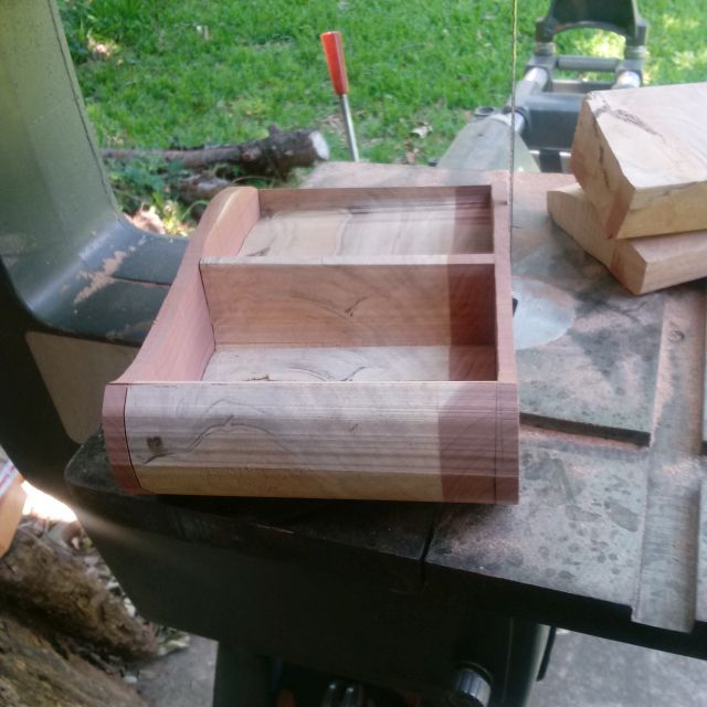

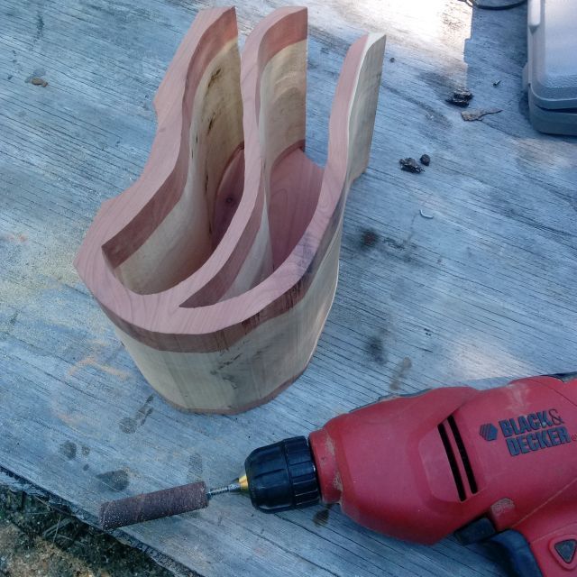

OK, a few dabs of Titebond III glue, some sanding and will line with blue felt at the request of our daughter..  I really need to work on that patch.  Will sand while the fronts and back are not installed.  Going to sand the mother box.
A word of caution here:  You only want to sand down the inside enough to make it relatively smooth.  If you sand too much, the drawer will have a large space at the top.  It naturally will have plenty of space at the top.  In the final sanding, the edges of the box and drawers will be rounded to reduce the image of all the space at the top of the drawer.
These little round sanding drums are available almost anywhere.  I purchased these from Shopsmith but I have another set that I purchase somewhere and they are Northern European.  It appears to be either Swiss or German.  I can't read it.

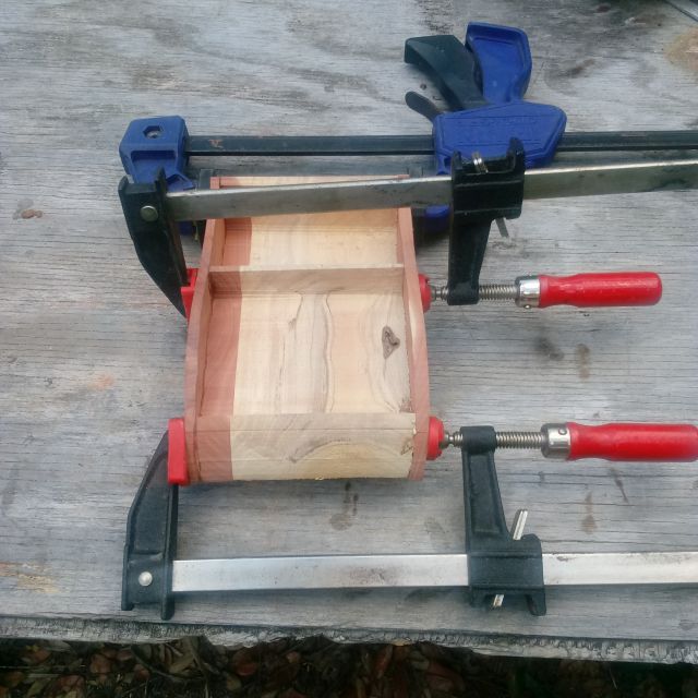

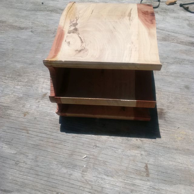

Out of clamps and it stayed together, but you can see where it needs sanding.
For the inexperienced, the gap you see on the right side will be sanded, the dust collected and mixed with glue and inserted into the gap.  This will take a l....o....n....g time to sand but won't bore you with that.
On to the drawers being assembled.  I am not going to take the time to sand inside this pockets.  She requested blue felt so will sand the exterior and then glue in the felt.  One more band saw cut to make and it can rest.
