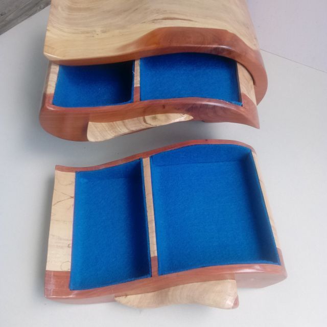

The cedar has been drying for 16 years and the dogwood has been drying for 3 or 4 years.  I thought that most of the stress would be gone by now, but take a look at the kerf.
It closed so tightly on this little saw blade that I could not get it out.  You can see on the dogwood that I tried to pry it apart to ease the tension on the blade.  Not going to happen.
Blade removed and finally got the blade back from the box.  It takes less time to put on a blade than to get this out.  Blade checked and still looks good.  Going to buy a couple more for back up.
Carcass after the drawers are cut out and removed.  Yep, we made it together.
Next up will be sanding and putting the back onto the carcase.  After that we will play with drawers.  Then it will be sanding for a couple of days.  Hope this is not too boring.
