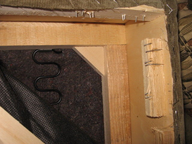

#1.   If a few staples are good, more is more gooder, whether or not they actually hit the pieces they are trying to connect.

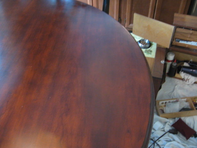

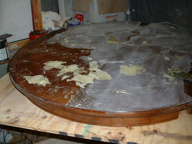

  • Don't spill fingernail polish remover on your place mat.   Before and after

Don't spill fingernail polish remover on your place mat.   Before and afterIMG_8129.JPG.c09d7519b1c912ee757602facb5bef84.JPGIMG_8137.JPG.1a3366e4bb4c4eb9fcab6a7402888ec0.JPG

Don't know why the leg support didn't hold on this sofa, it was stapled on real good.
IMG_8897.JPG.d310d4abf537356f5b4743340d526171.JPGIMG_8898.JPG.8766c68e6268b293373e3d9de7a2531d.JPG

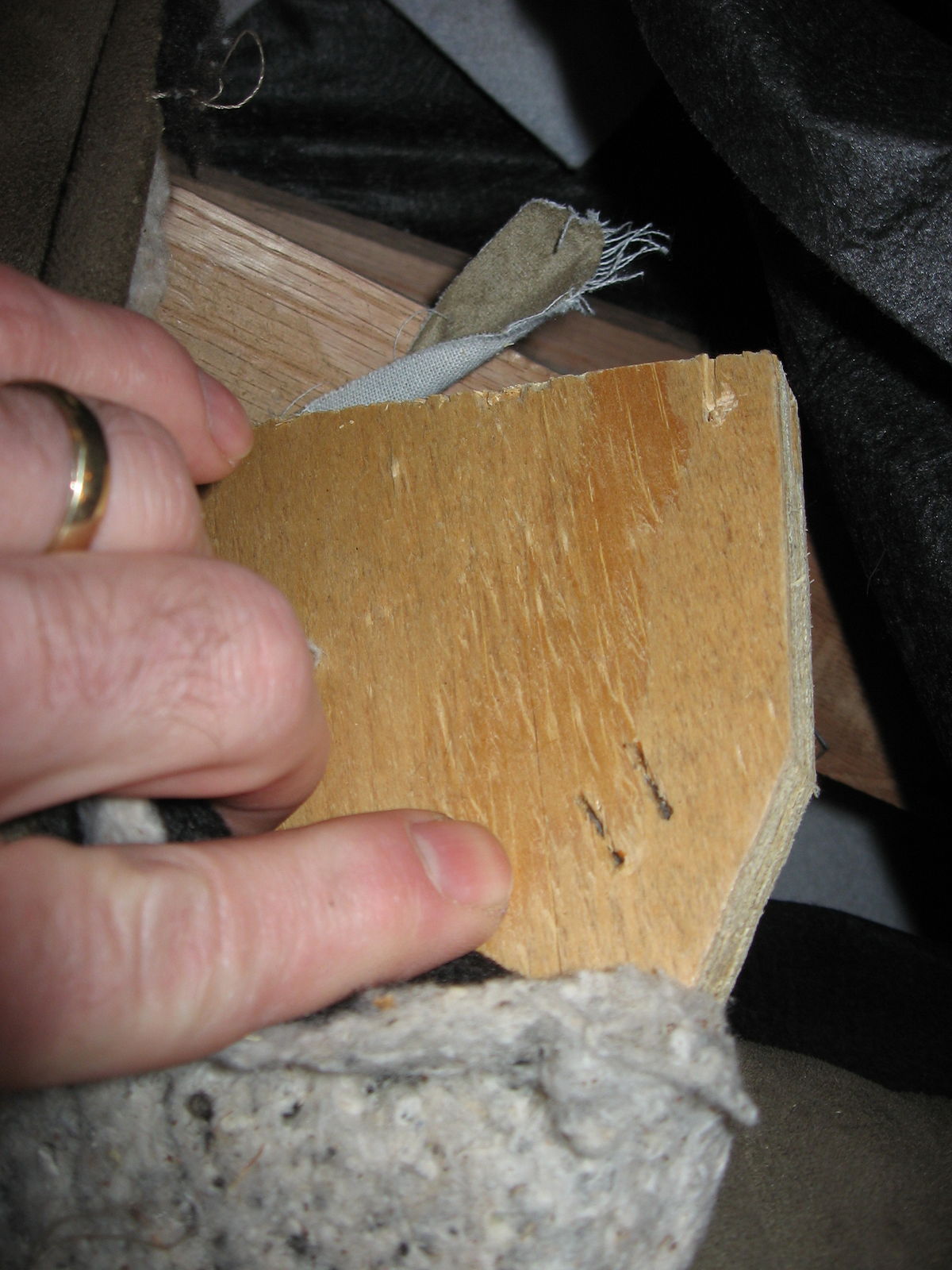

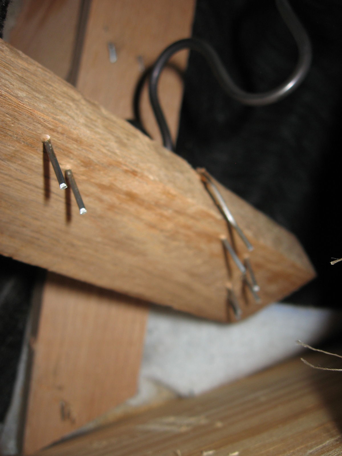

What, roofing nails won't hold the spring straps in place? One of several brands.  One was "squeaking" while still on the showroom floor.  1/3 of nails fallen out, 1/3 loose, 1/3 still holding for the time being.   What do you expect from a $10,000 sofa???

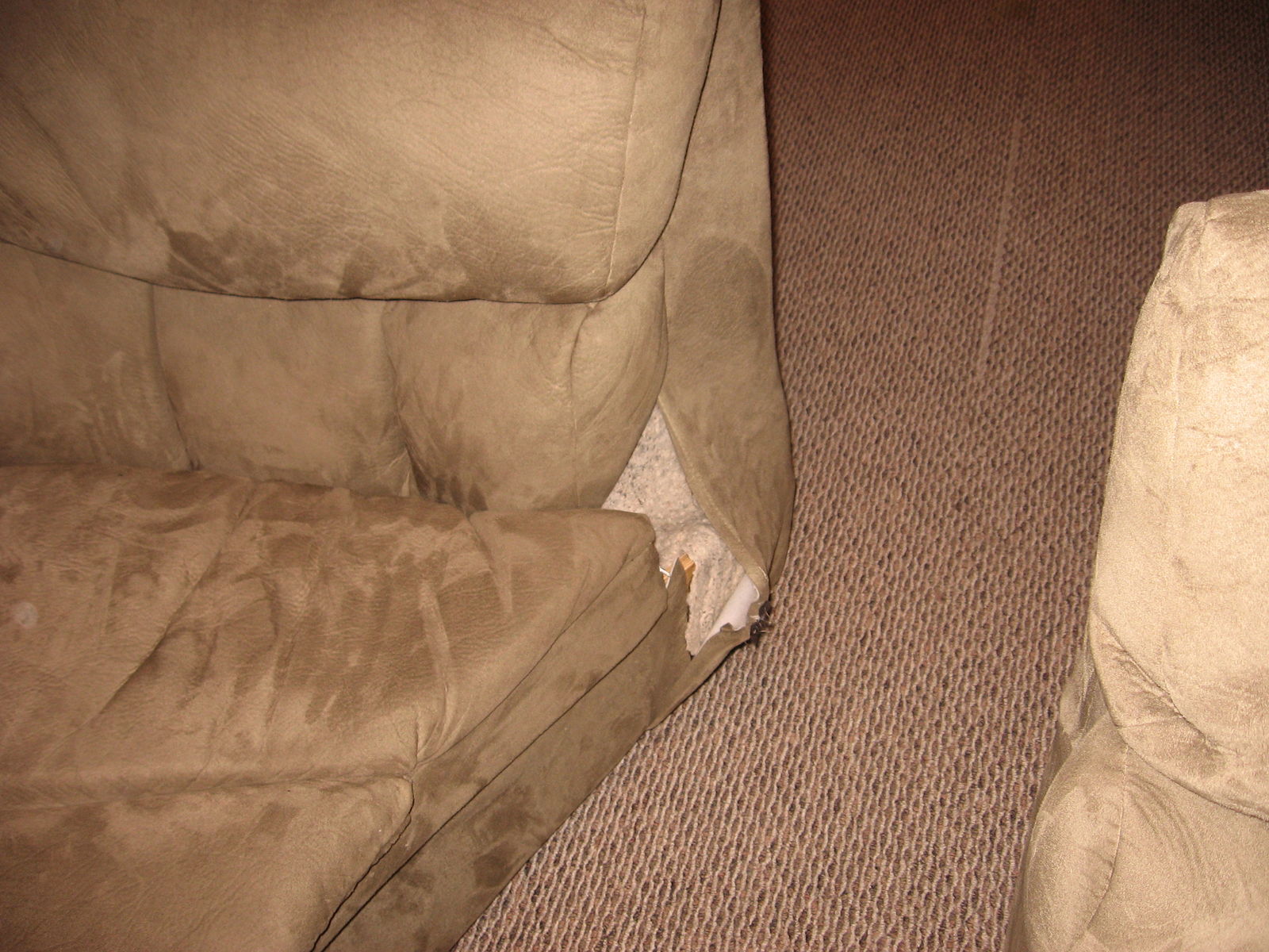

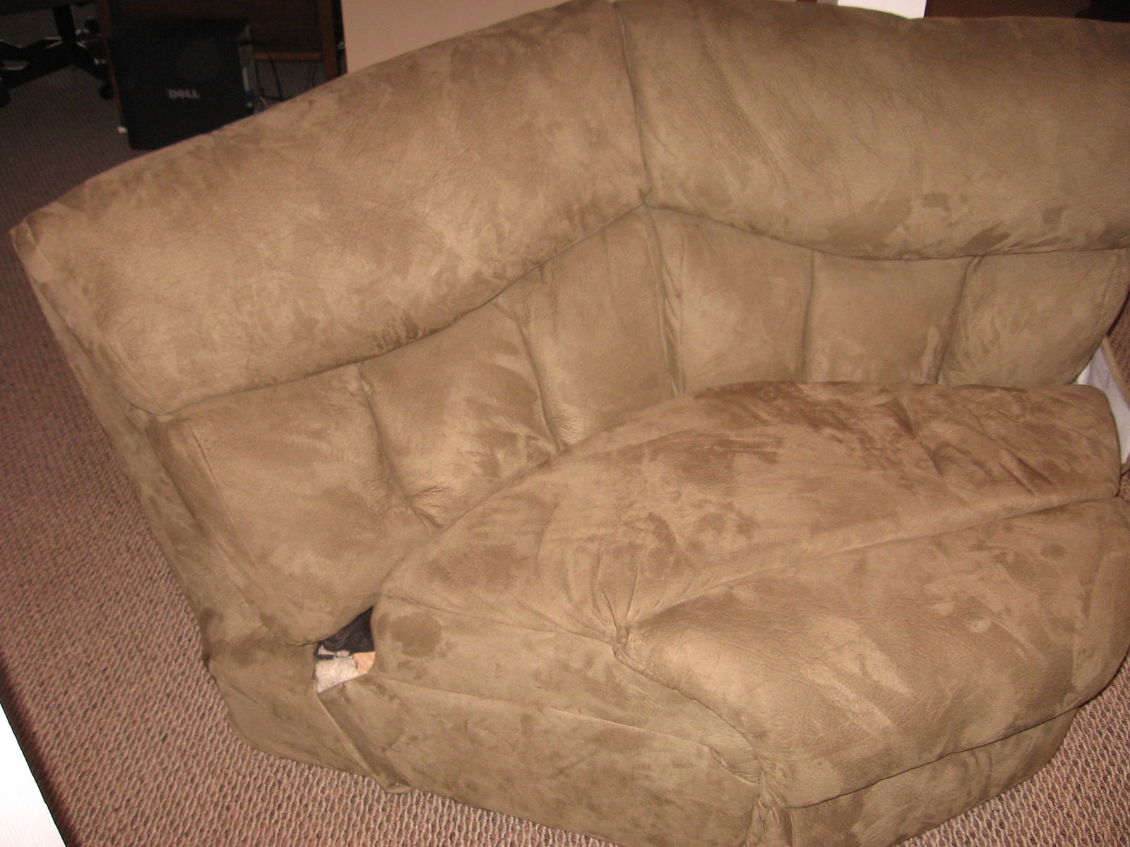

Really?   This was right out of the box.  Left side facing arm falling off.IMG_6671.JPG.82f6d2de0763a404c0d6443f691b07b2.JPG

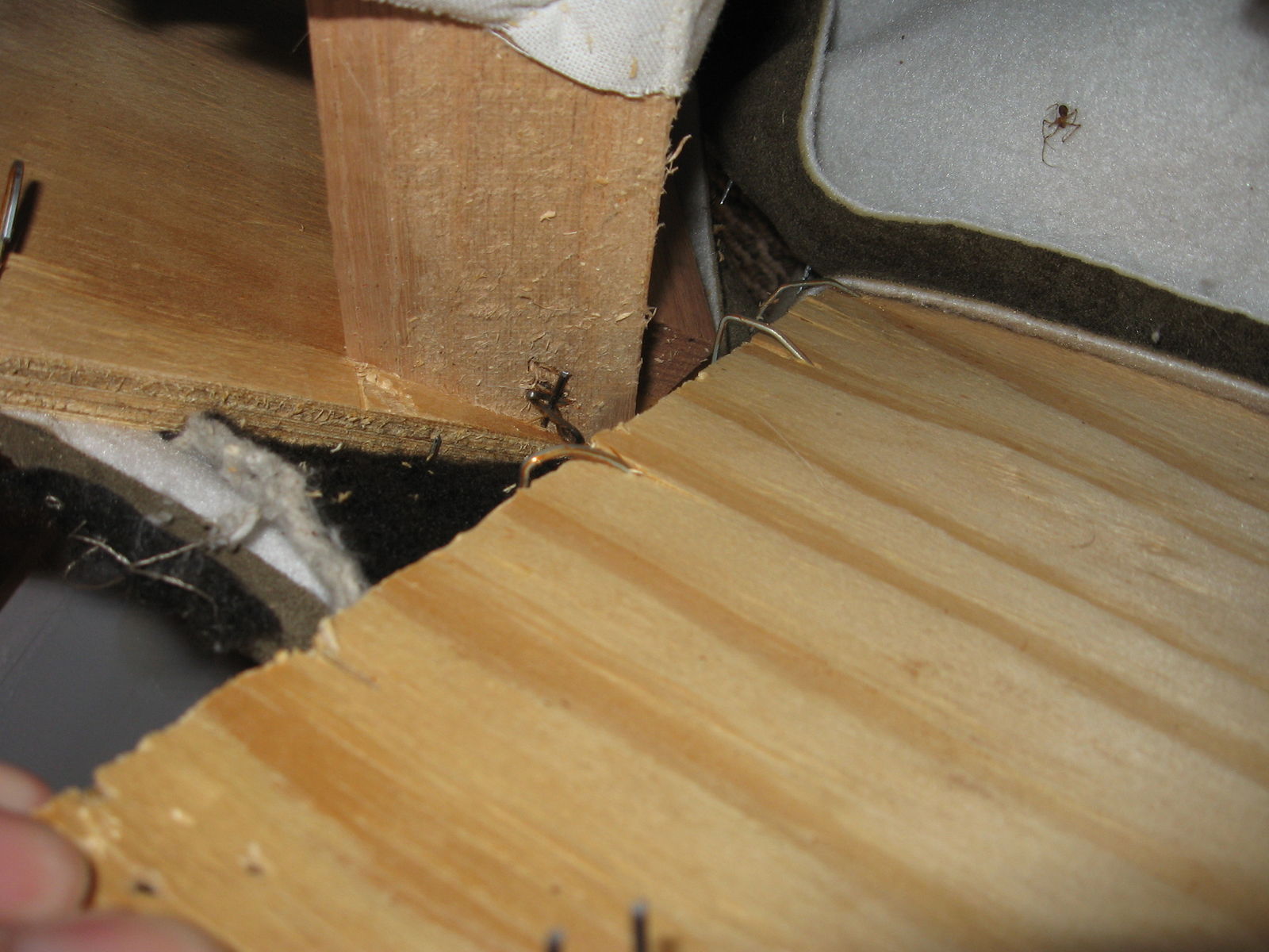

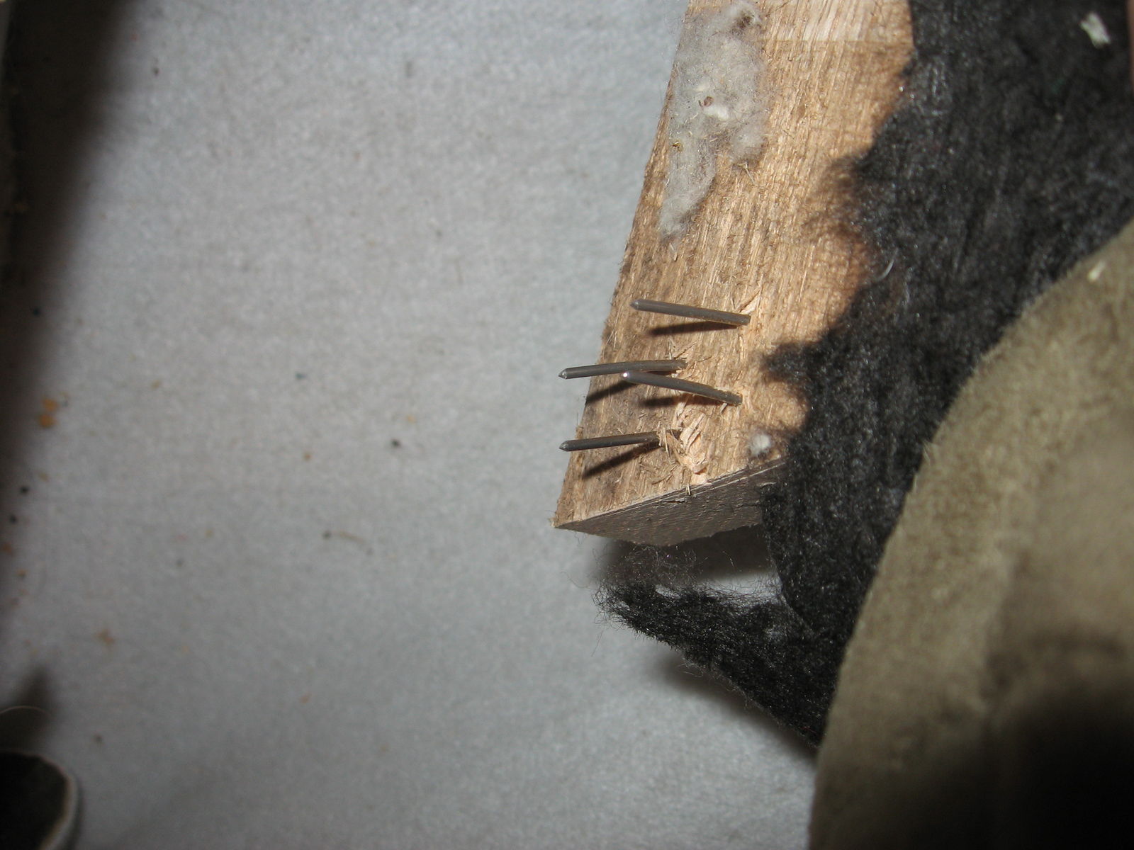

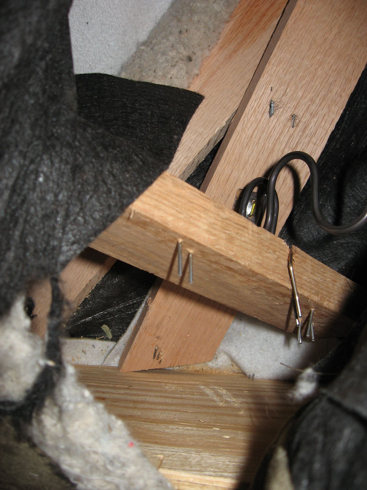

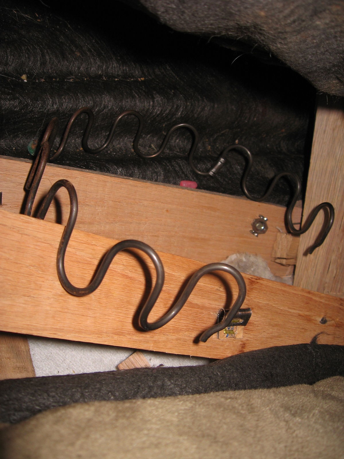

This was a total *#(&$   The whole back collapsed, seat fell through, springs popped, frame separations, fabric tears.   The guy was a fireman so muscular, but not obese.
IMG_6863.JPG.76f30bec23cd630b6609f85947d8deea.JPGIMG_6864.JPG.9028b68717964fb72c6b01ac46490b45.JPGIMG_6865.JPG.eb3053e8b93824f4de874ac02141e547.JPGIMG_6866.JPG.ea5eafd28bb23f659ff84e0ae657b774.JPGIMG_6867.JPG.f994b3de7762fdda65d3339b0eb56388.JPGIMG_6868.JPG.45307eec1a9ecfc527916ef30aae3143.JPGIMG_6869.JPG.56d68dd7561a10afed32ec9e140987d0.JPGIMG_6871.JPG.c5d2b402823ee75e8a0951b6b066820e.JPGIMG_6872.JPG.e5957e81953e9600754299adb1f70369.JPGIMG_6873.JPG.9e8ce28e25745fea3904a92947be841e.JPG
Looks like pallet wood and assembly by first and second graders.  Wow!
:ChinScratch:...And people wonder why I "Curb Shop".
:huh:...I find better quality stuff thrown away!
Yep, Butt joints (and maybe that other one too) , sorry wood and staples. And what was left out?????   GLUE.
