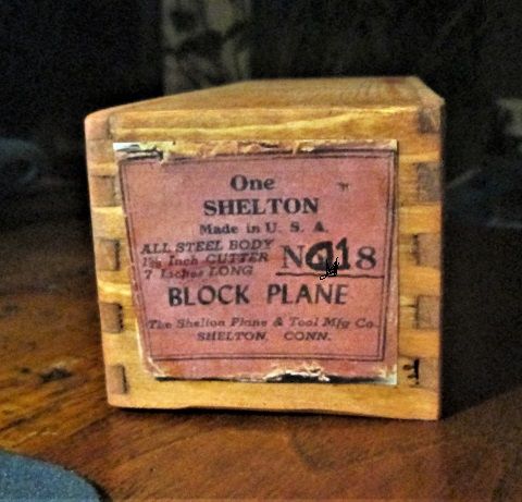

Small box for block planes?
Ok...got to thinking :WonderScratch:Dangerous I know.   Seems I have a stack of thin Pine scraps....and need to do something with them...:ChinScratch:
A couple of my block planes do have a box to call home....keeps them out of mischief and a bit cleaner...:OldManSmiley:
But...I think I can do a little better than just a labeled cardboard box...B)
Most of the Pine scaps are about 1/4" thick, if that......maybe connect a few into the proper sized box, including the "lid"
That can slide down over the box....maybe use a sharpie to make a "label" on the end of the lid........thinking finger joints....green, or black sharpie?:WonderScratch:
Will see how the bod feels today...and see how the wood "supply" looks....may have to resaw to get enough "timber" to make the boxes and lids...:JawDrop:
Stay tuned..:cowboy:

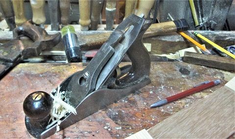

    At 2 hours a day....this might take a while....Knee is NOT liking the stairs to the shop. First, had to plane a couple parts flat.. ( new pencil?)..then see if two sides will match up.

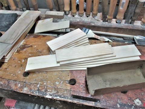

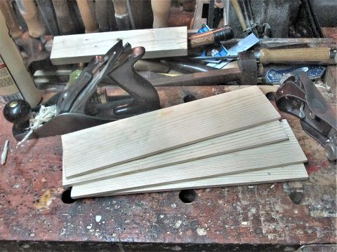

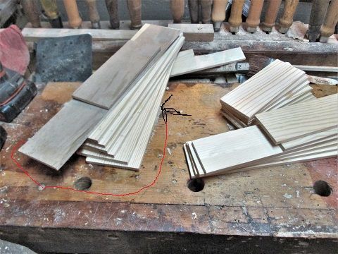

Resaw has been done, for now...wider stuff...B)
For the "cover" and bottoms...narrower stuff..:ChinScratch:

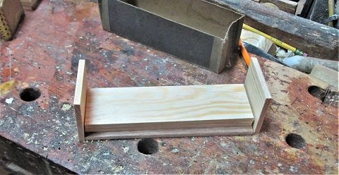

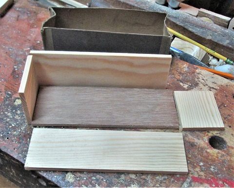

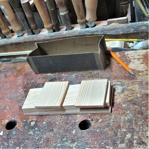

To make the inner box....5 parts ready..
Sized to that box....to make the inner box...ends..
Match the ends of the old box...the rest?:ChinScratch:
A plywood bottom, and the sides...Just need me to feel well enough to cut the corner joints, and build the cover.    Parts are 1/4" thick....was ripping them down from the 3/4" scraps I have in the shop.....still have a decent stack to do...also have a big stack of 3/16" thick stuff...get 2 @ 1/4" and 1 @ 3/16" out of each scrap board...have 14 Block Planes to do...this MIGHT take a while..maybe?:ChinScratch:

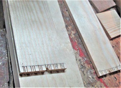

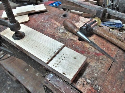

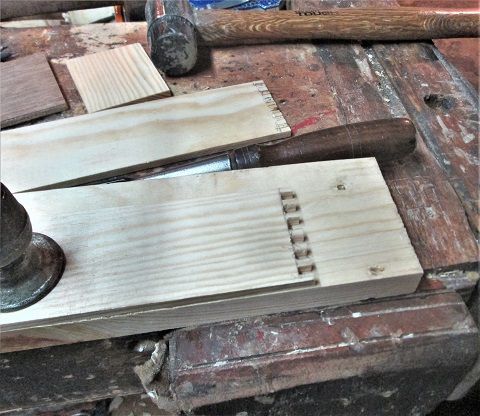

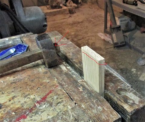

Marking gauge to score a few lines....:ChinScratch:
Saw a few lines...:OldManSmiley:.
Chop out the waste...wash, rinse, and repeat....using the completed finger to mark the next part...:ChinScratch:

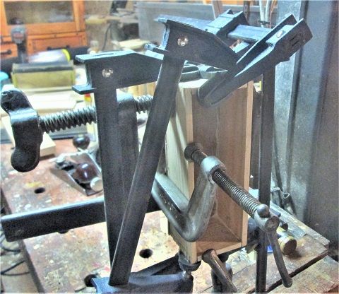

Get enough done to do a dry fit...get the last end done and fitted......then the fun...:ArguingSmileys:

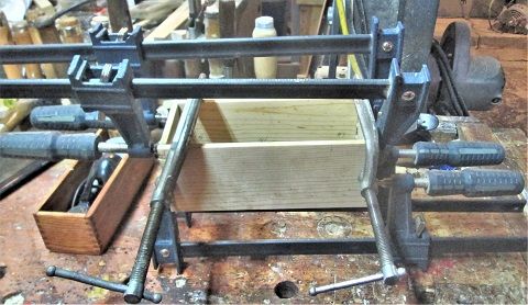

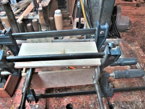

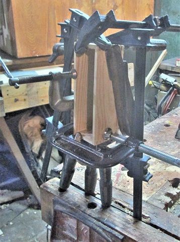

Diagonal clamp because the sides wanted to just fold flat..:MachineGun:..Bottom of the box is also glued on...:BugEyeSmiley:
"Need more clamps!"  :ArguingSmileys:  Let this mess sit a day ( don't sneeze if you walk by..:DevilLaughing:)and laid out parts for tomorrow..

Looks like my small box glue ups. Funny three will do a large box ok maybe 4. But a small one just won't hold all the clamps it needs. By the way can't believe you cut those small joints by hand. I have done on the TS and have a jig for making them but have never used it.

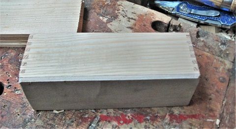

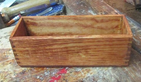

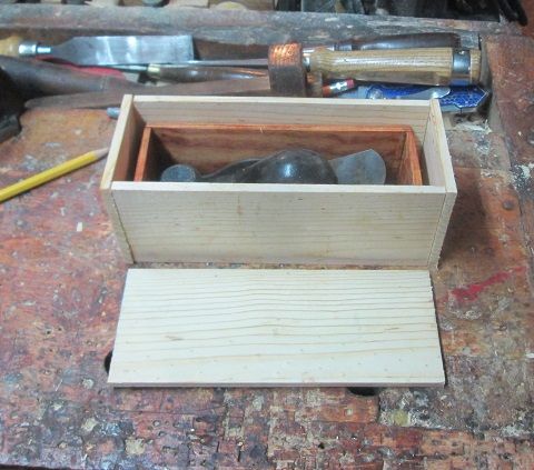

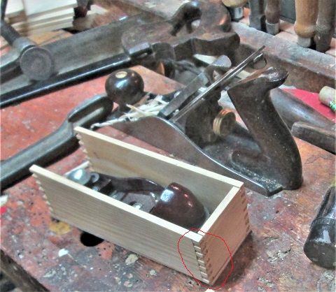

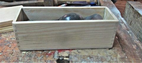

Box came out of the clamps...meh
Edges sanded smooth, corners rounded over..:TwoThumbsUp:

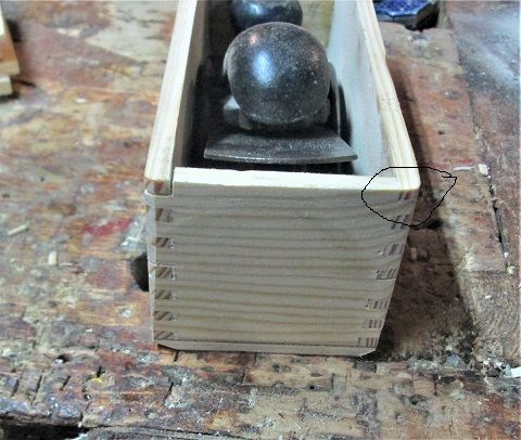

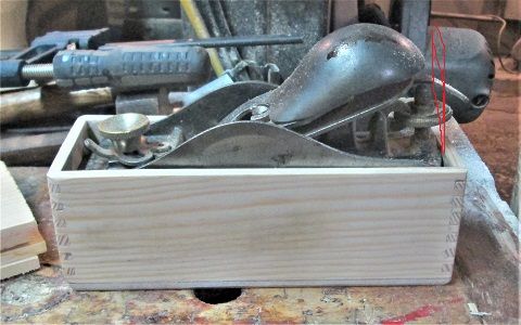

Problems came when I tried to place a lane IN the box...
Either too long in the back end, or.:BangingHead:

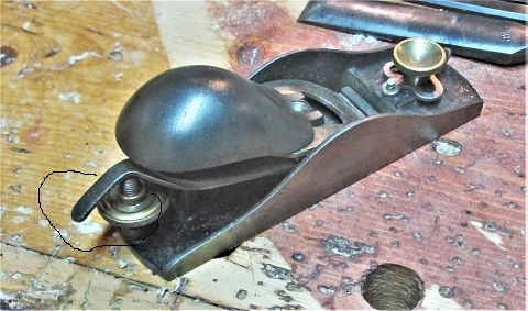

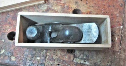

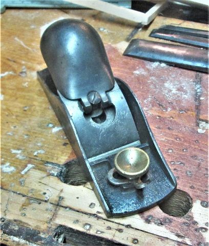

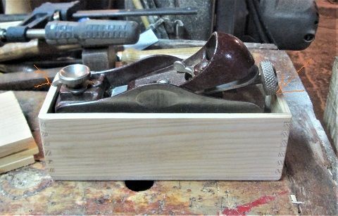

Both ends...dug around, and found ONE block plane that would fit..:ph34r:
IF I moved the cap iron forward....as it stuck up too high, otherwise. :TwoThumbsUp:
I uess that will just have to do:rolleyes:  So, gave it a coat of the "Brew"B)
Set the little #110 back in the box..

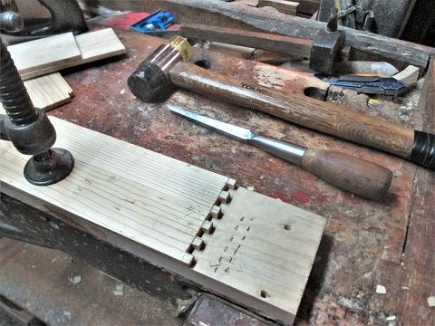

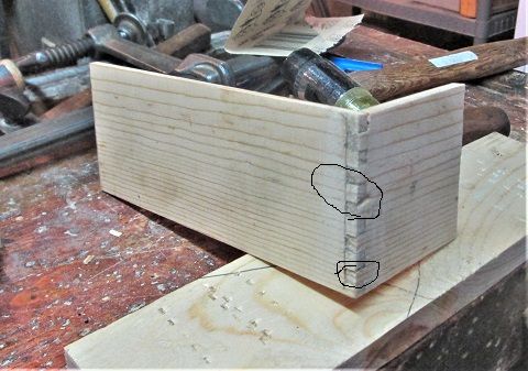

used a wider chisel...
Made a lot of saw cuts...
B)
1/4" wide chisel to chop...test fit?
Maybe the other 3 corners will be better?....

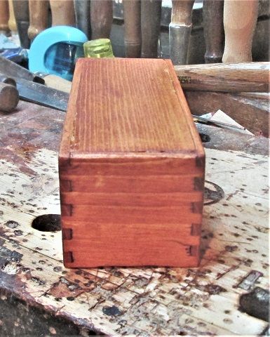

Then glued them up....I made sure it will fit over the bottom box...waiting on glue to dry...
Tomorrow, I can trim the lid for height, and add the topper.    Then start on the next box and lid
