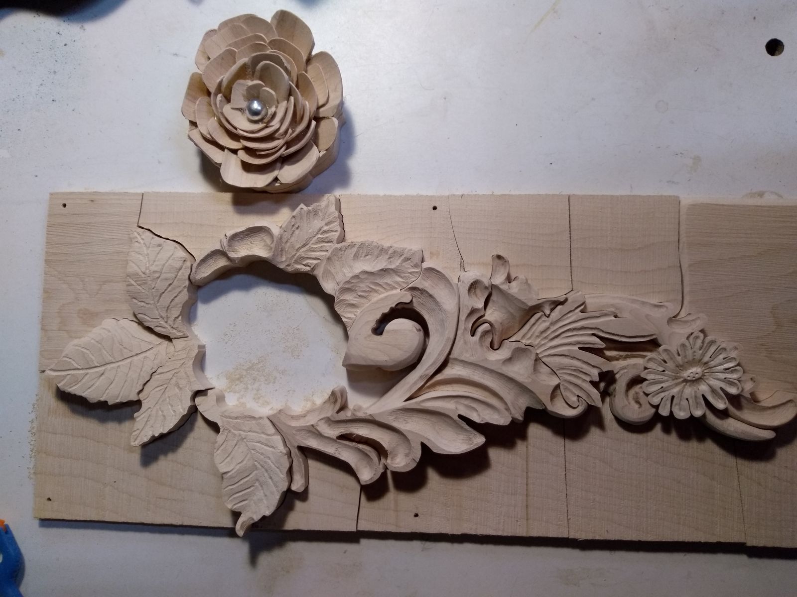

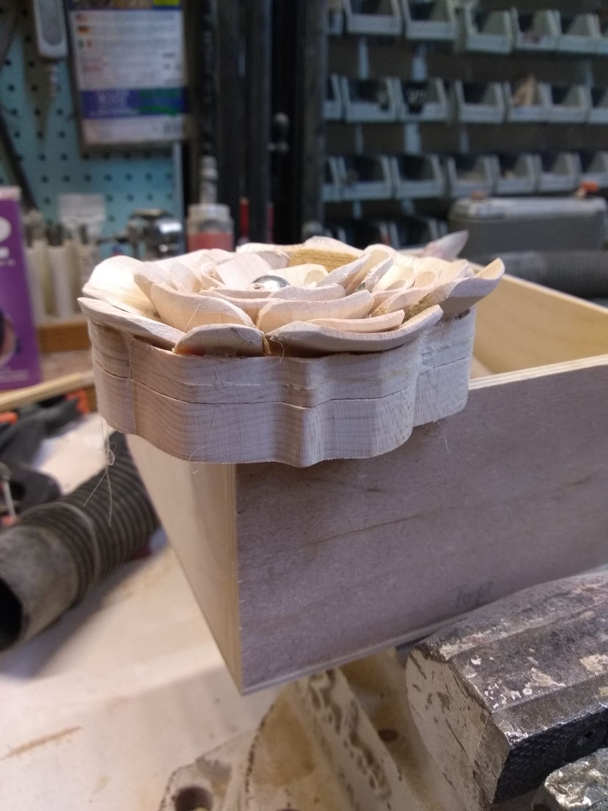

April 19, 20206 yr Author Popular Post comment_225733 This is how I experimented with making a rose. Each petal is scroll sawn with the grain up and down...time consuming but hey a carved rose might take a day or more carving one with a knife. Plus carving a rose the grain would be running side ways making it easy to break off pieces and not looking like petals as much... I wanted the leaves to hang over past the other things around it. And I can still add a petal here and there that might need it for looks. That was tricky but it worked out okay so when I get all the other pieces carved to suit I can color all the pieces if I choose , put a finish on, then glue all the pieces back together.... The base of the rose is 1" thick. I knew if I stacked the petals on top of 1" it would be too high up so I sliced it in to three pieces and then scroll sawed the insides away from the two shorter pieces. I needed the right height of a fence around the outside of the rose to hot glue the petals in so they would hang out over the leaves and things that is around the outside of the rose. Stacking the petals on top of the fence made the petals look more natural??? Report
April 20, 20206 yr comment_225848 You are doing great with the running how-to Jess. Please continue Hope that @Lissa Hall is catching this one, there is a lot to be learned here... Report
April 20, 20206 yr comment_225851 2 minutes ago, Cal said: You are doing great with the running how-to Jess. Please continue Hope that @Lissa Hall is catching this one, there is a lot to be learned here... I agree the tip on having the grain oriented up was good! Report
