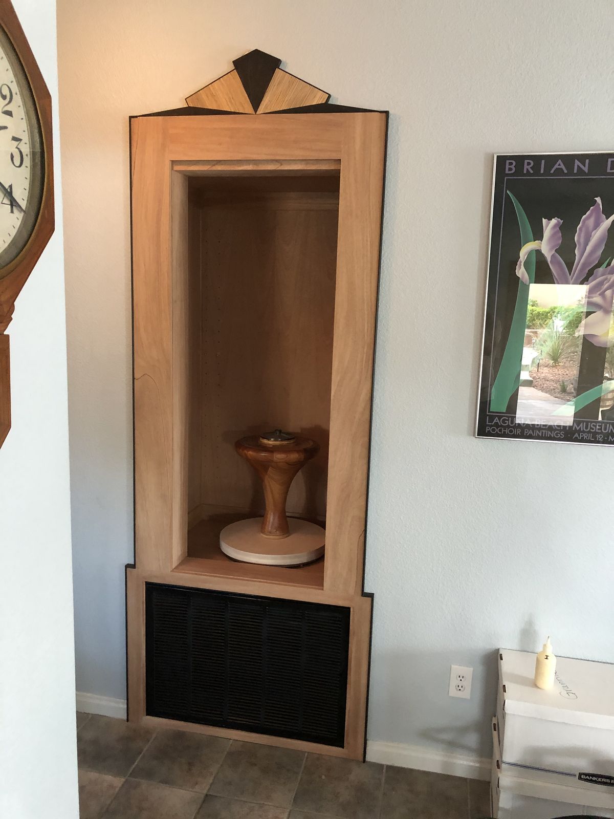

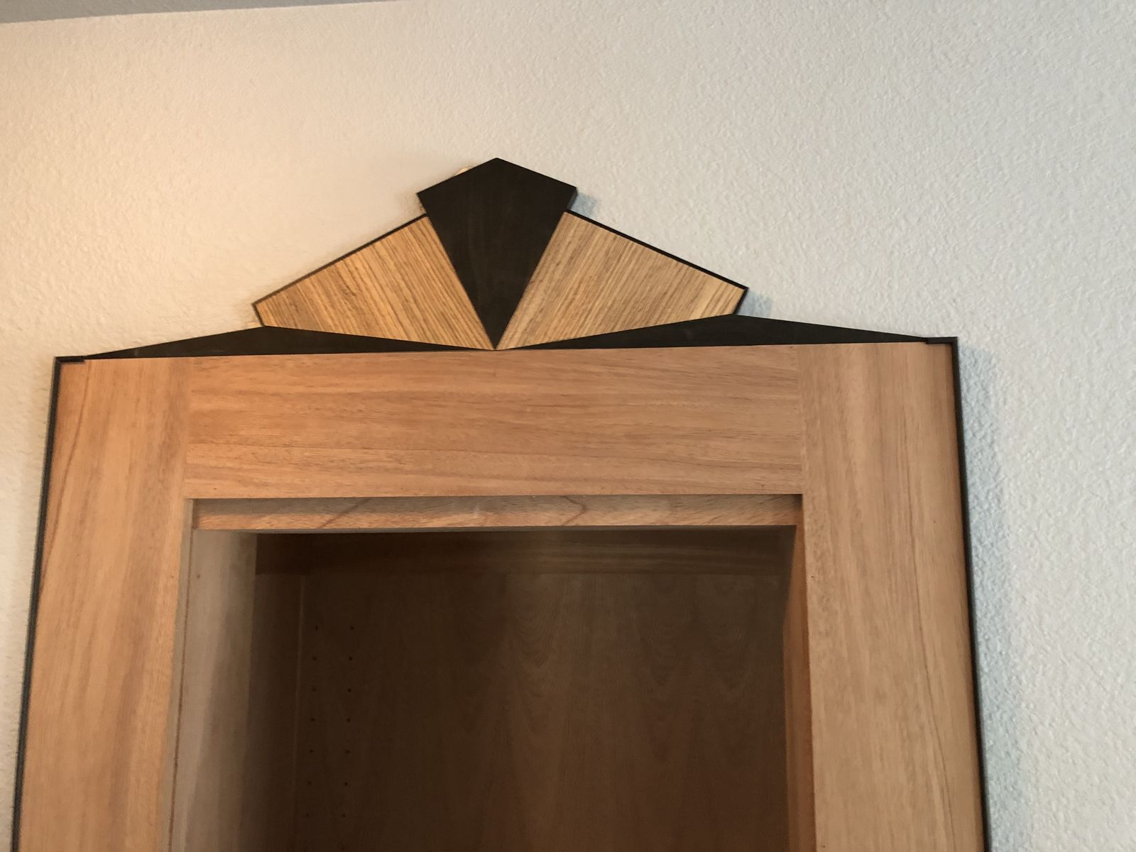

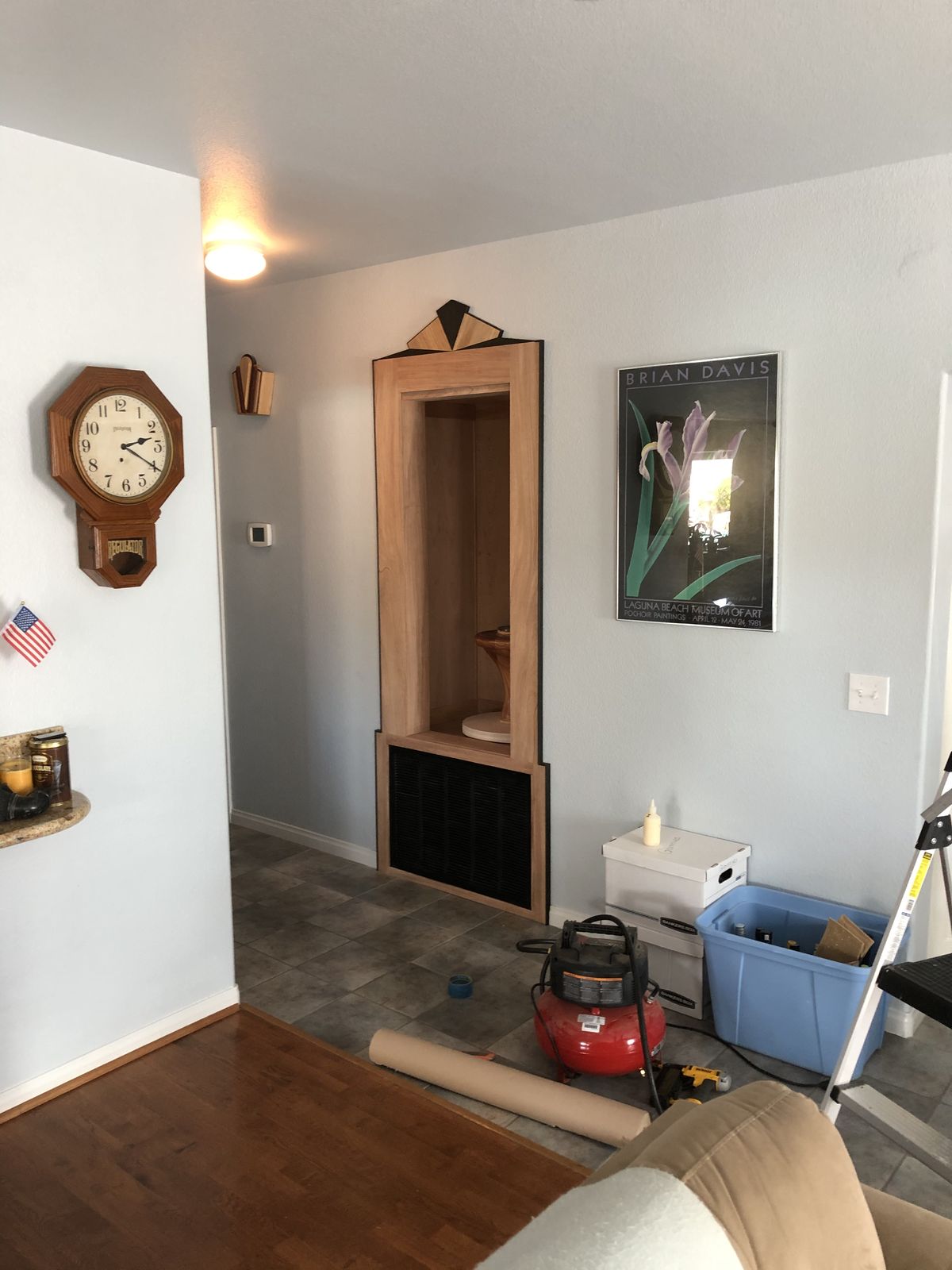

Finished trimming it out today. Now a couple of coats of finish and I can start mounting the tulips and glass shelving. I am going to do the door last.

    Finished trimming it out today. Now a couple of coats of finish and I can start mounting the tulips and glass shelving. I am going to do the door last.  Pa

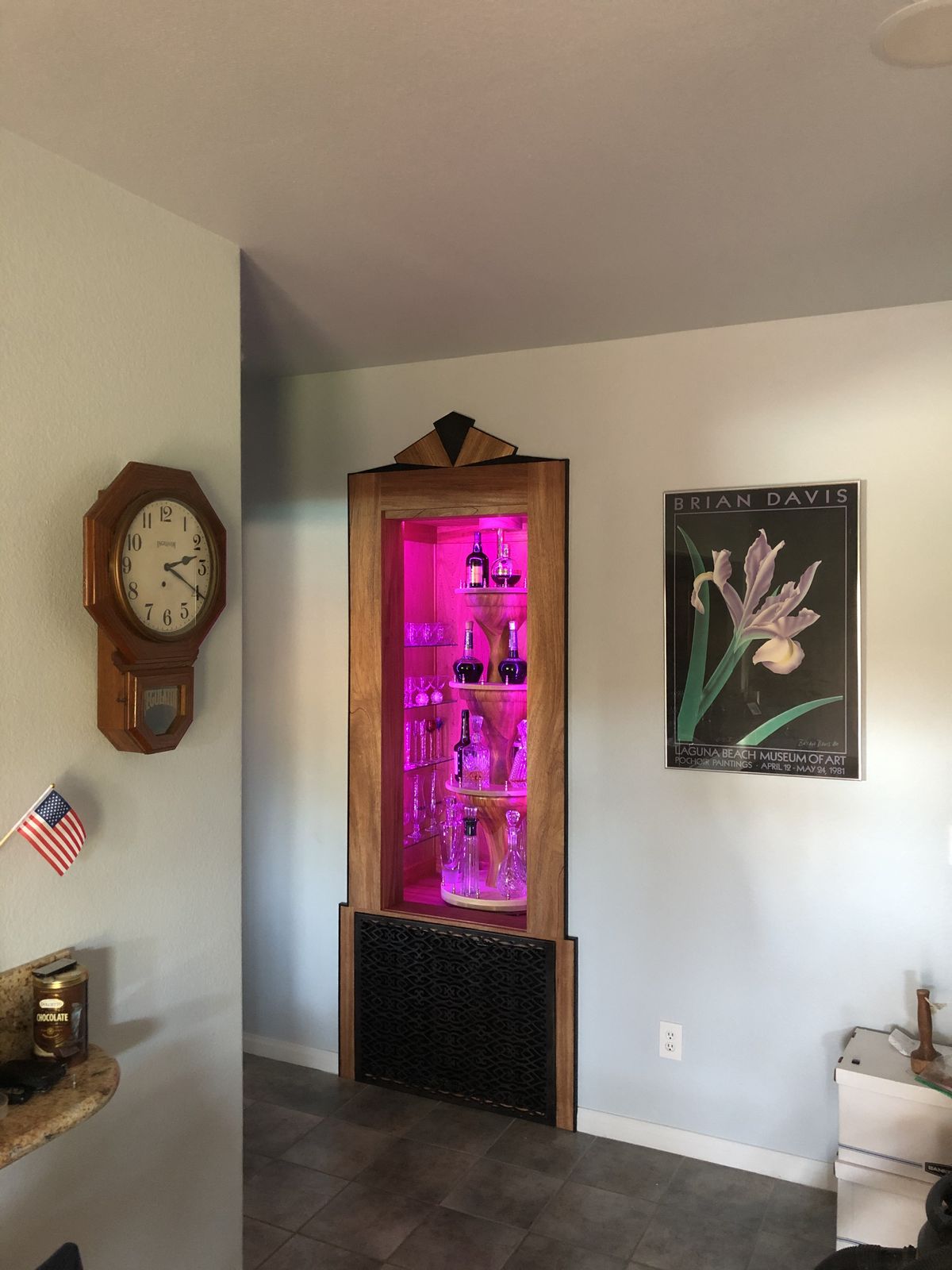

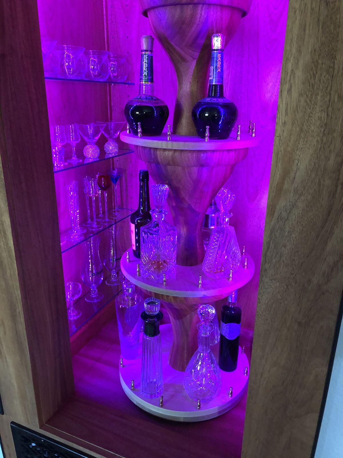

    Excluding the door it is complete. The glass for the door should be here early next week. Getting the tulips installed was interesting but we did it !  Paul

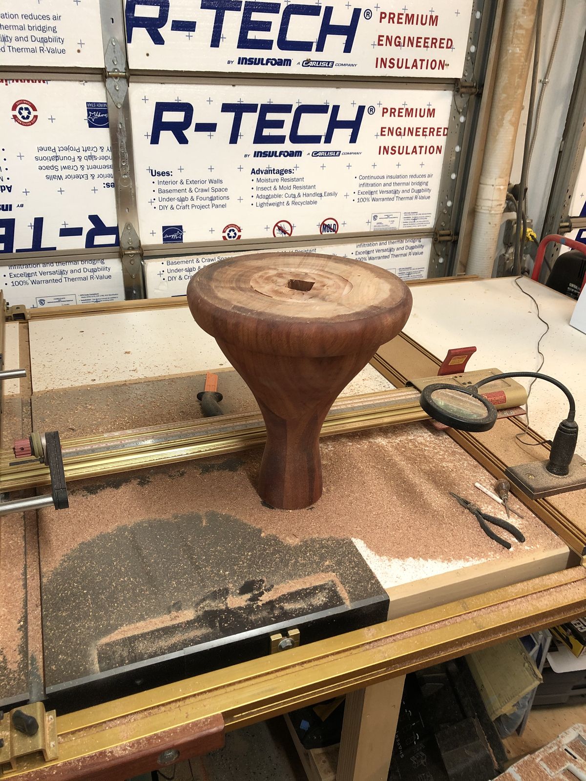

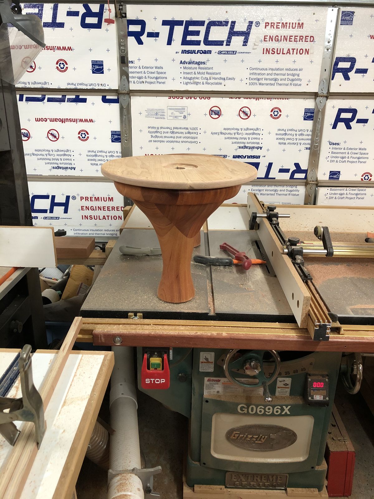

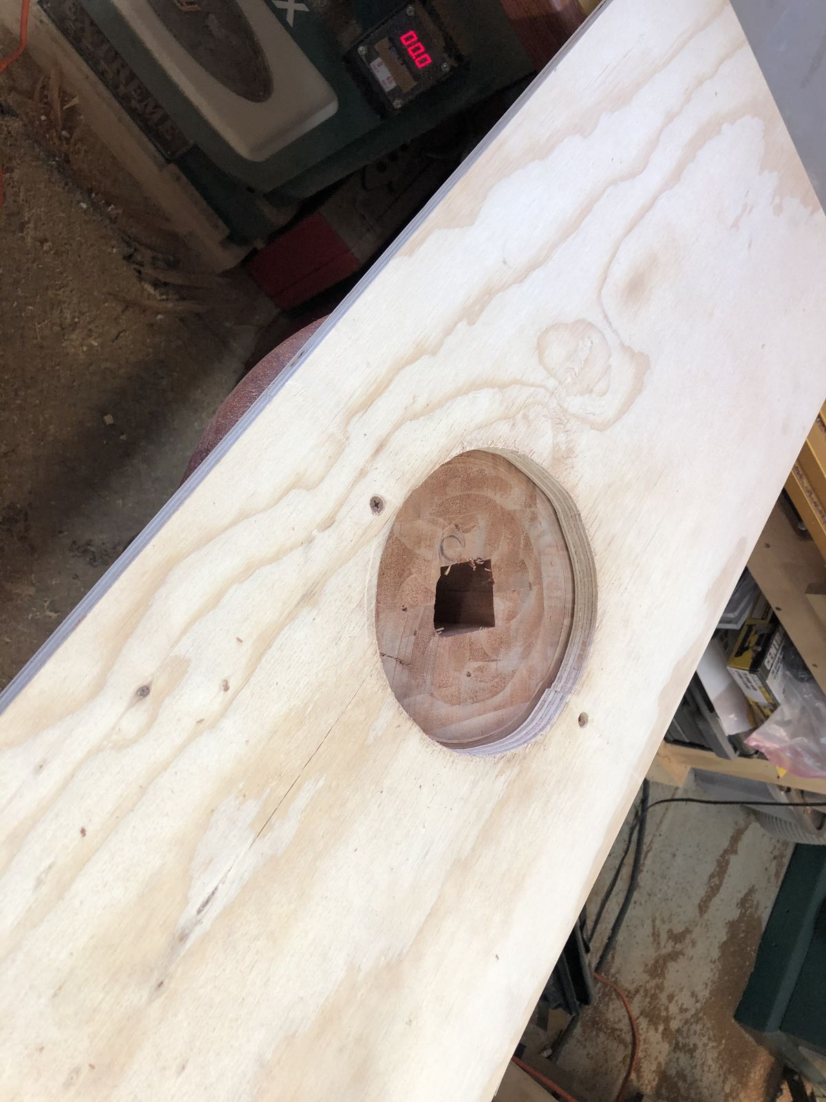

    Well despite the Super Bowl interruption the third tulip turning got roughed out this weekend. Another hour or two of turning and that phase of the project will be completed.  Paul
That is some excellent work.  NICE!!!!:TwoThumbsUp:
Wow Paul, that trim really sets it off!  This is one project I really want to see through to completion...

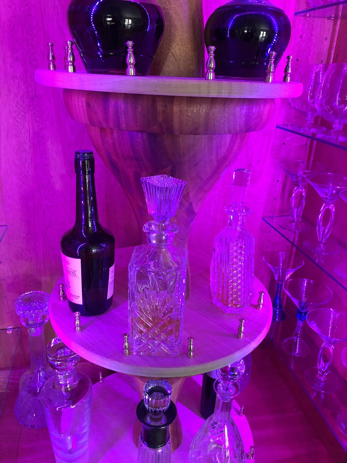

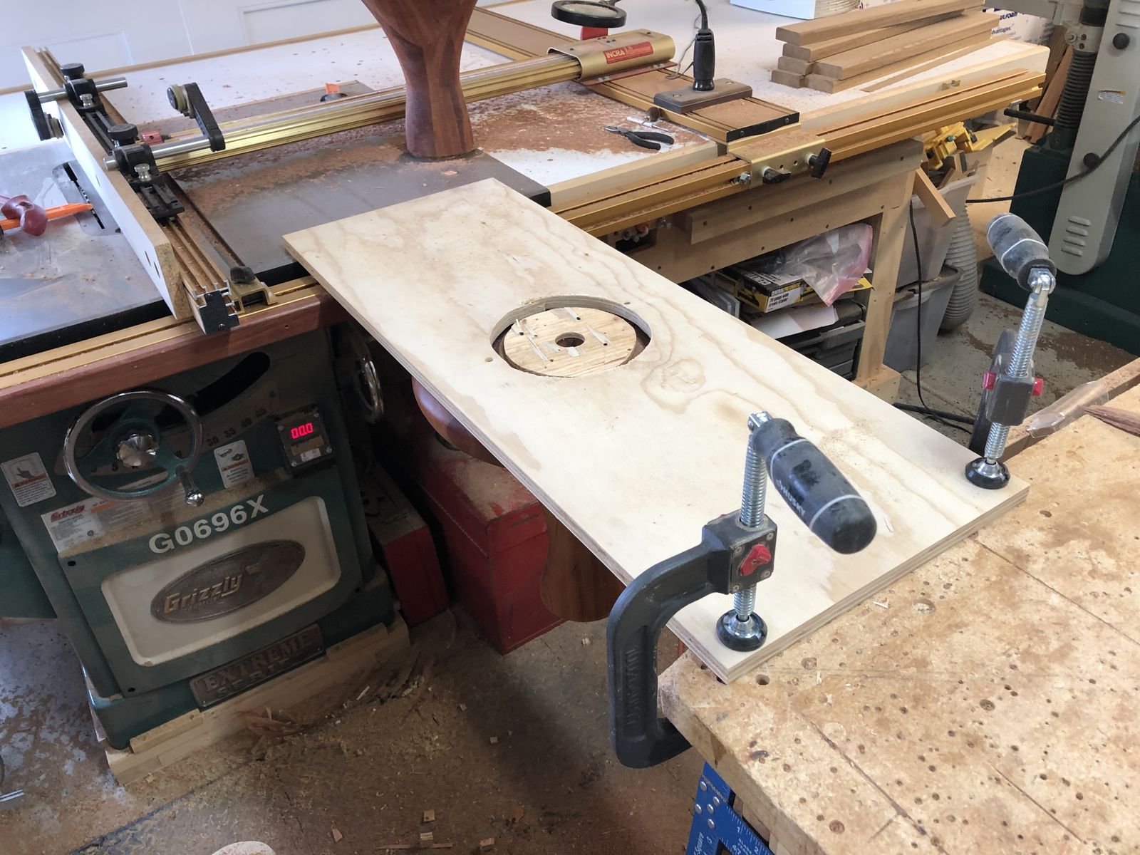

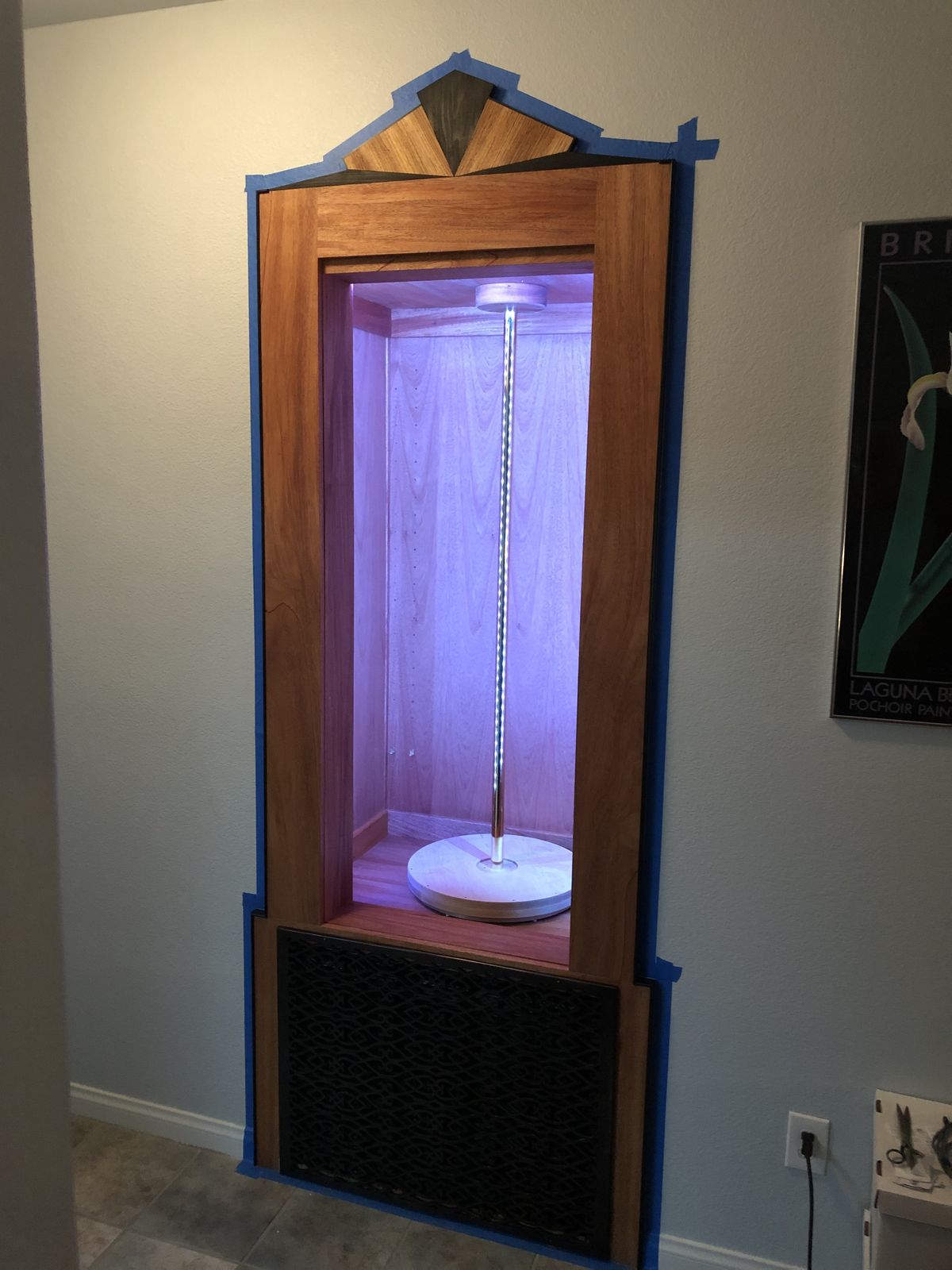

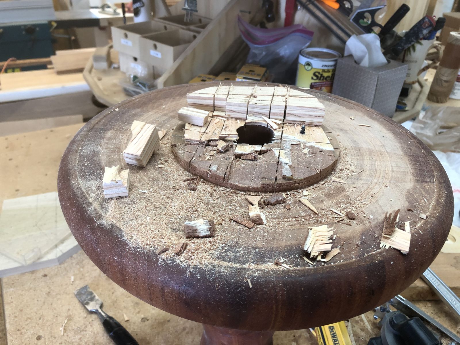

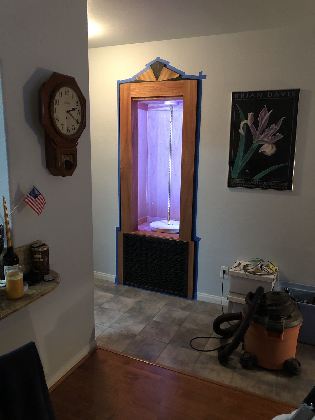

Last two days have been productive. The first coat of finish is on, the brass rod is fit and ready to stack on the turnings and platters. I had to build a quick router jig to flatten off the top of the turnings. Also the lighting was installed. I used LED RGB strip lighting. This has been a long one but the end is in sight !
Paul

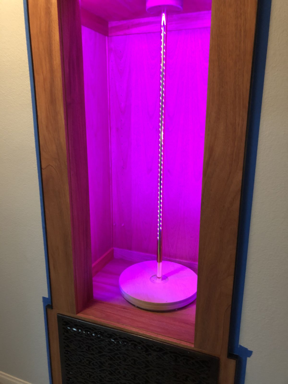

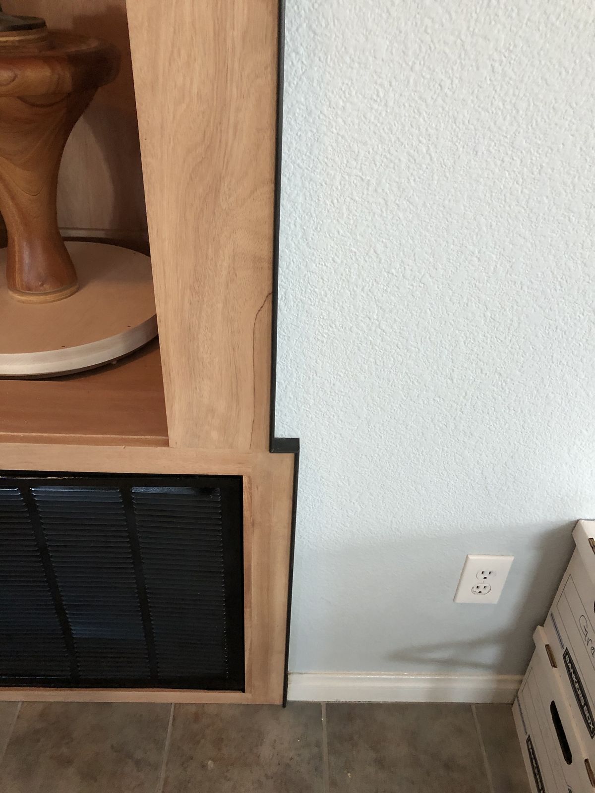

Beautiful casework Paul.
May I ask where the wife found the HVAC cover for the inlet?  It sure does look better than that white grill:)

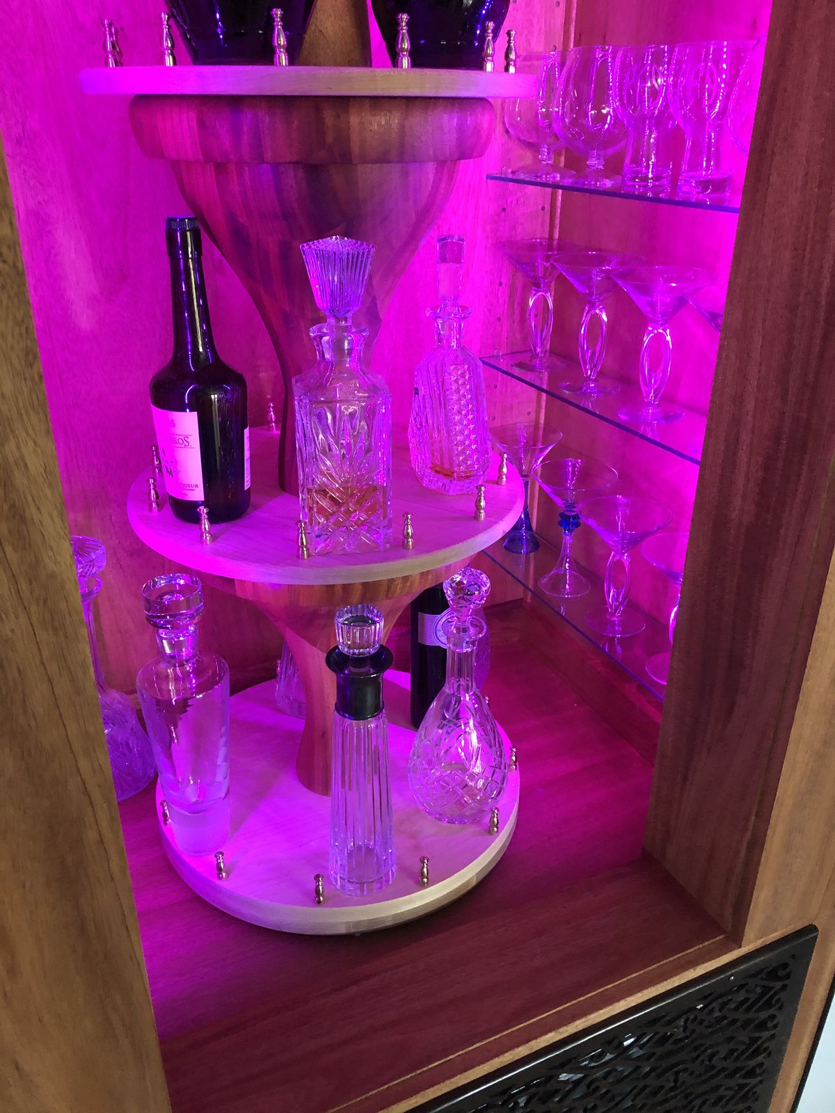

Paul
Yes they are RGB. Cal the wife needs to look up where the return air grill came from. Should have it tomorrow.
Paul
THAT IS AWESOME!!!!!!!!!!!
That right there is some kind of spectacular!
How about posting up some pics with the different color lights?
Beautiful!
Before I read your last post, I knew that was a floor register.  From the old days when I was a child, they either fit as a return register or sat on top of the old gas or oil floor furnaces.
Paul, as usual, you did a fantastic job.  When I first saw the pole, I thought you were working on a dance club but could not figure out how small the girls would have to be to fit into the space.  It turned out totally different that what I could imagine.  Kudos.
Thanks Paul.  Didn't see my size listed (20x20) - but knowing that I can consider a floor register will open up whole new possibilities for me.  I appreciate it:TwoThumbsUp:
Just for giggles take a Barbie Doll in  bikini and wrap it around the pole, real conversation starter.  :throbbinghead:

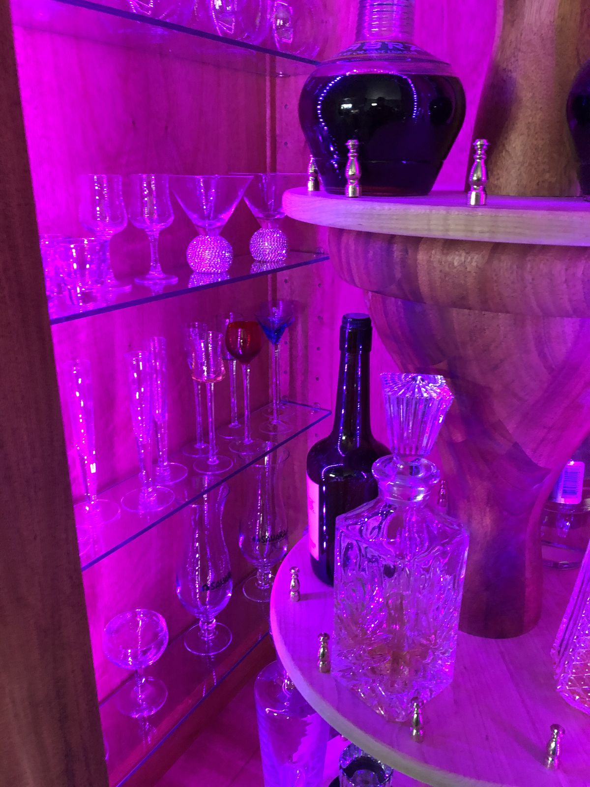

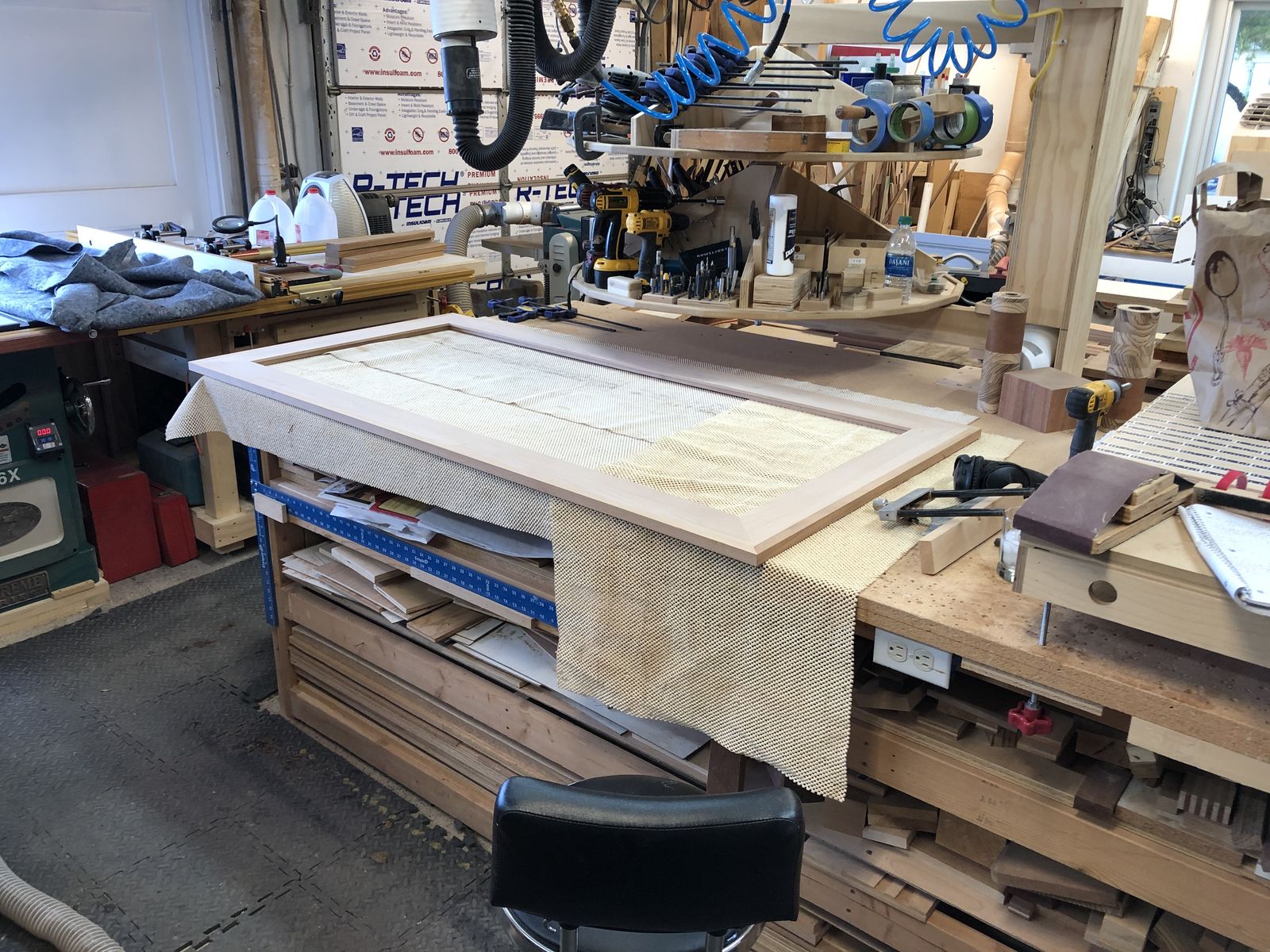

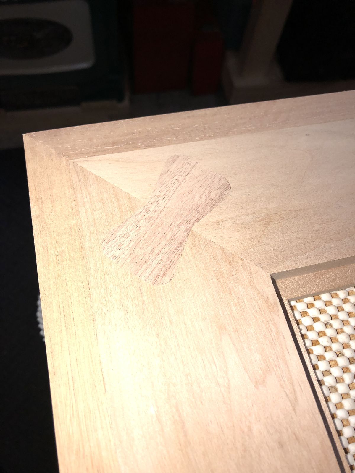

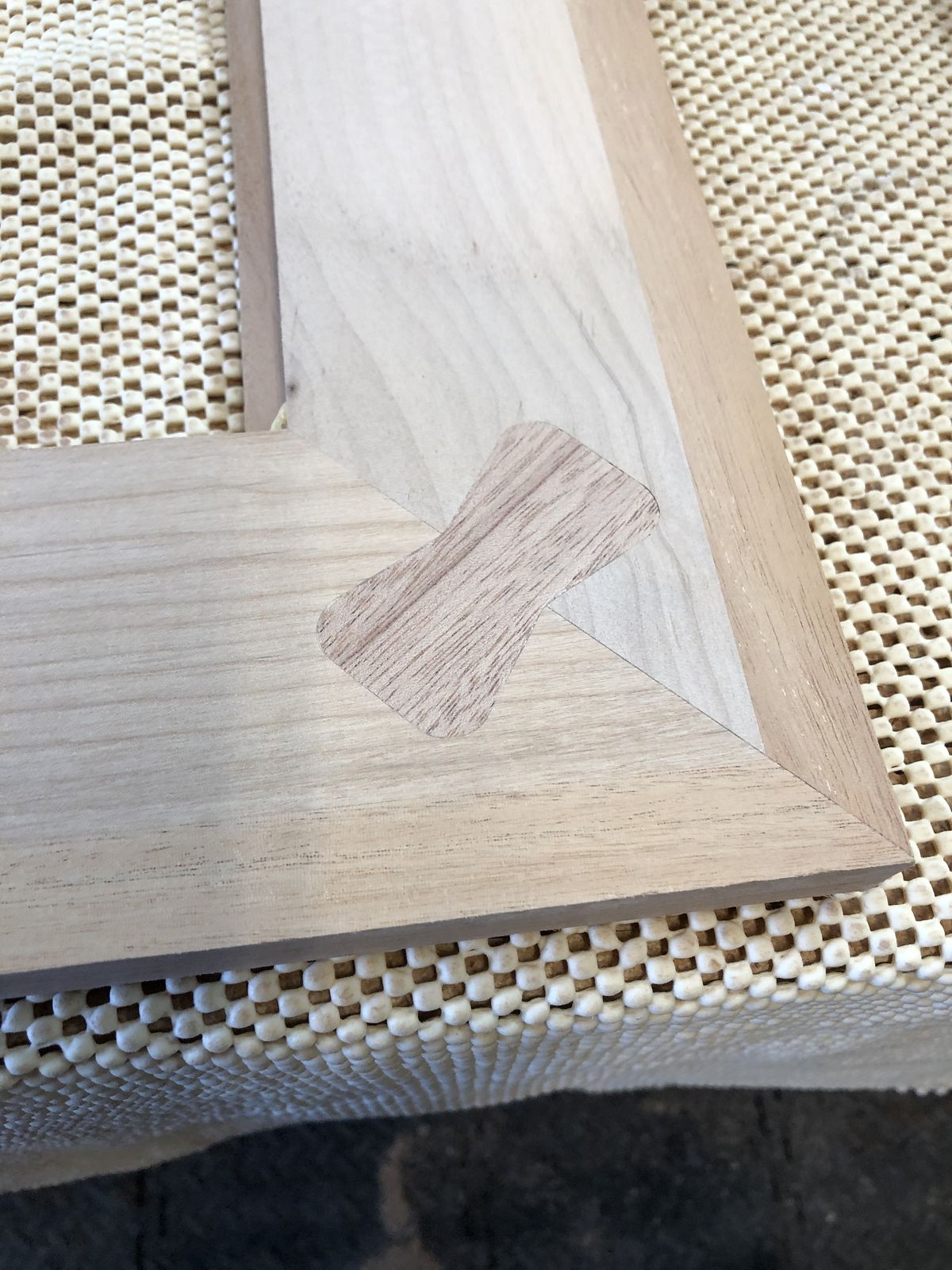

The glass arrived so now I can finish this project. I was afraid the mitered joints even though they were put together with biscuits would not be able to withstand the weight of the glass which is pretty heavy. I decided to key them together for a little added strength. The Shaper Origin really made easy work of them. In the past I would have used a forstner bit and round inserts across the joints. Both work but I am pleased with the look of the shaped pieces.
Paul

The glass arrived as well as the hardware for the door so this project is officially done per the boss !
Paul
That is spectacular Paul.
