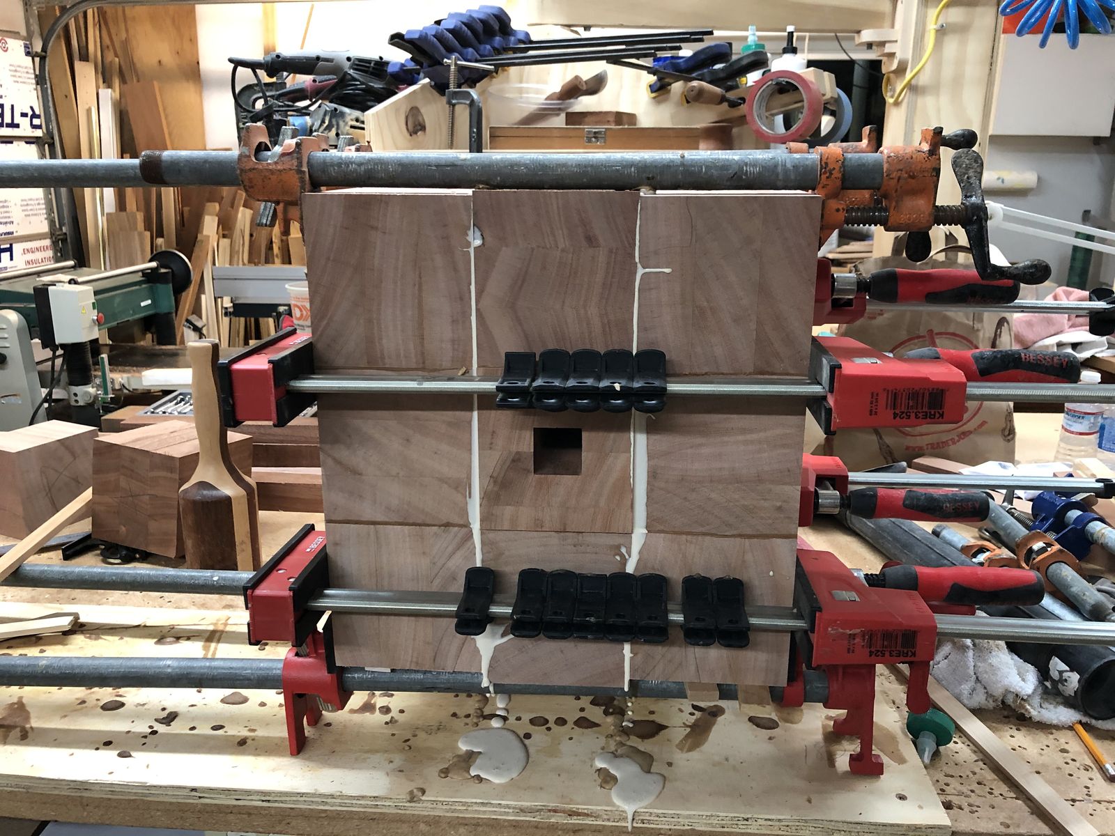

I just joined the forum so I thought I would start with my latest turning project. This is a project to turn an existing liquor cabinet into something to bring it into line with our Art Deco theme for this house. It involves three separate turnings in a tulip style which will be mounted vertically on a 1 5/16” brass pole and progressively getting smaller in diameter, largest on the bottom. The “tulips” are all 15” high, and are 16”, 13” and 11” in diameter. I am making them from 8/4 African mahogany. The biggest challenge has been to arrange the grain pattern to end up looking like overlapping petals. On top of each tulip will be an alder platter attached and 2” larger diameter than the turning. So it is basically a vertical mounted lazy susan. The first and largest turning is now complete.

That is awesome! Thanks for showing the glue-up that really helps me understand how you designed these!

Nice project . I try to avoid those enormous glue up but it looks like you handled it very well.

Today was roughing it out on the bandsaw and then getting it down to the balanced blank. I decided to weigh this one for grins and it was 45 lbs before starting.
