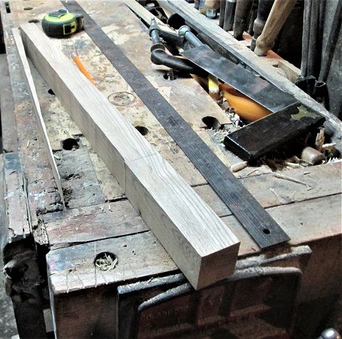

3 legs needed tapered...and a fourth needed cleaned up...tapering legs? :WonderScratch:
Well, first I need a lay out line..:ChinScratch:
Come down 5", for the top of the leg.  At the other end, I am leaving about 1"....planes will correct that, later...
This leg had a knot..:ArguingSmileys:
Had...because after both tapers are cut...knot will be gone..B)
1st cut.   Bandsaw has a brand NEW blade, too.
2nd cut.   Needed a way to hold the leg still, long enough to smooth them down with a plane, or 2
Made a couple cleats...didn't feel like drill out an electric drill and find a bit...
Cleats in use...used a couple hand planes to smooth things out...
Jack plane to get the worst off, then the #3 smooth plane can do it's job...
One thing..be sure to mark which face is the tapered one....as Tenons will go there, too..
Because you don't want to get the last leg done, only to find out you've tapered the wrong side...:WonderScratch:
Caught myself..this time.:BangingHead:..got all 4 legs cleaned up, same size, tapered, and then a round over bit was used..

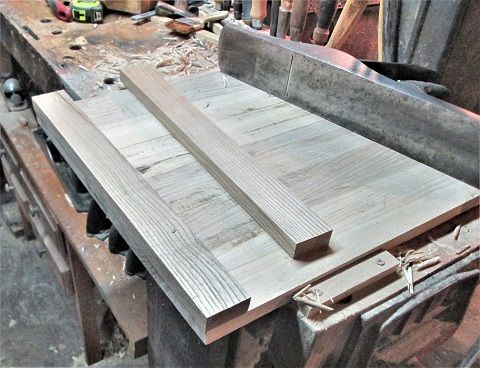

This is the edge of the blank for the top of the table....we have work to do, as the bread board ends don't fit..:ArguingSmileys:
974500360_ShakerTableProjectbreadboardendnofit.JPG.d5277e3b1ce51ef66e2f3776ac5f132b.JPG
Tablesaw can trim the ends...need to flatten the faces..
And...this IS the good side? :JawDrop:  Gave an old plane a test drive, on the theory it is lighter..:rolleyes:
22" long...it did work, but..:ChinScratch:
At 4" shorter, and a LOT sharper...also had a couple spots where the #3 could fine tune things...finally..
This face is done, or, at least flat.B)  Then flip this over:JawDrop:
THIS might take a while...I also checked the ends with the blanks for the bread boards, looking for high spot..
Beltsander to level the ends...That way, I can cut a straight line across with the #78...to make tenons for the BBs to attach to.B)  Since the floor was in a mess..

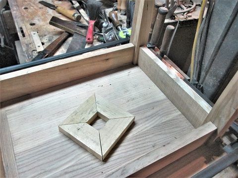

Hour #3 for today....:rolleyes:  cleared off the bench....after I cut some 1 x 2 scraps to make corner blocks from...
1761651849_ShakerTableProjectcornerblocklayout.JPG.3a093d0346fb80f6e65c7bb0572fb5f6.JPG
Used this as a pattern....and then used the mitersaw.:rolleyes:
Quieter this way...had to adjust the depth stops a bit....finally was getting some decent cuts..
Those slotted "stops" can limit how deep a cut will get made.   AS long as the saw doesn't try to cut that metal "gib"....how well did it do?:ChinScratch:
Here is the 4 corner blocks I needed...:TwoThumbsUp:

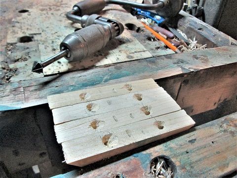

Needed to drill pilot holes, and then counter-sink them...

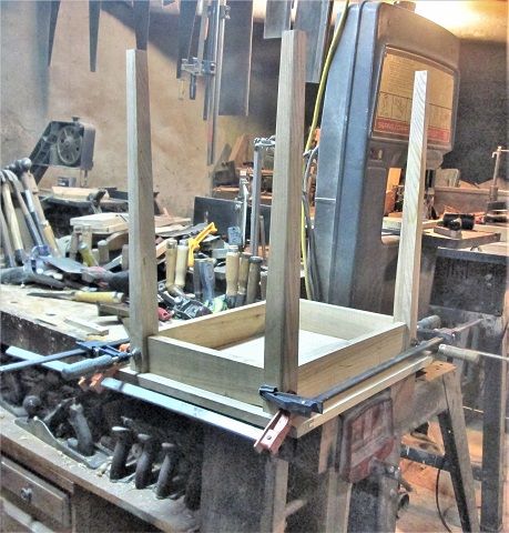

Then glue and screws to attach.    Fun part....holding 2 legs, and an apron....and trying to add glue and a clamp...all at once.   Wound up doing sub-assemblies....2 legs, and a long apron...then another set...finally, two shorter aprons to connect the two longer assemblies...then add the corner blocks...
Sides of the aprons that will show, sanded and planed smooth....bottom corners were given a slight round over, with a plane...
Letting this sit overnight....then attach the top tomorrow....
