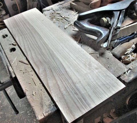

    Spent about an hour in the shop, this morning....panel for the table's top is out of the clamps,  planed and sanded... This is going to be the underside..there is a bit of a chip-out....

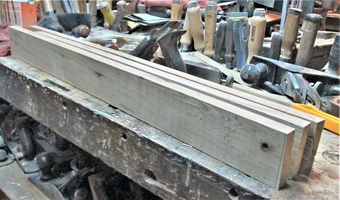

Ok...hauled ONE 5' long plank to the shop.:OldManSmiley:   Cut it into thirds.  Cross cut was with the Atkins No.65, again.....cuts like new.:TwoThumbsUp:  Then came the tablesaw ( both of my rip saws are at the sharpening service)
Needed 2 blanks than matched each other for grain...and glue and clamp them up..
Got a bit too much glue, this time?:WonderScratch:

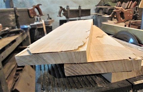

Ooops.  :BangingHead: I also ripped two blanks for the bread board ends..
1965493914_ShakerTableProjectbreadboardblanks.JPG.aaf04022ff5f3c794fef1f586239e167.JPG
Then trimmed them to length..and stashed them away..
What was left of the plank..went towards a stash of aprons...:TwoThumbsUp:
May get a drawer front out of one of these....I also got the 1st  three legs out of the clamps...
And then ganged them up, and squared the ends, both ends...B)
Once the bench is cleared off, I can work on all four legs.....clean the glue joints, and taper two sides....:ChinScratch:
