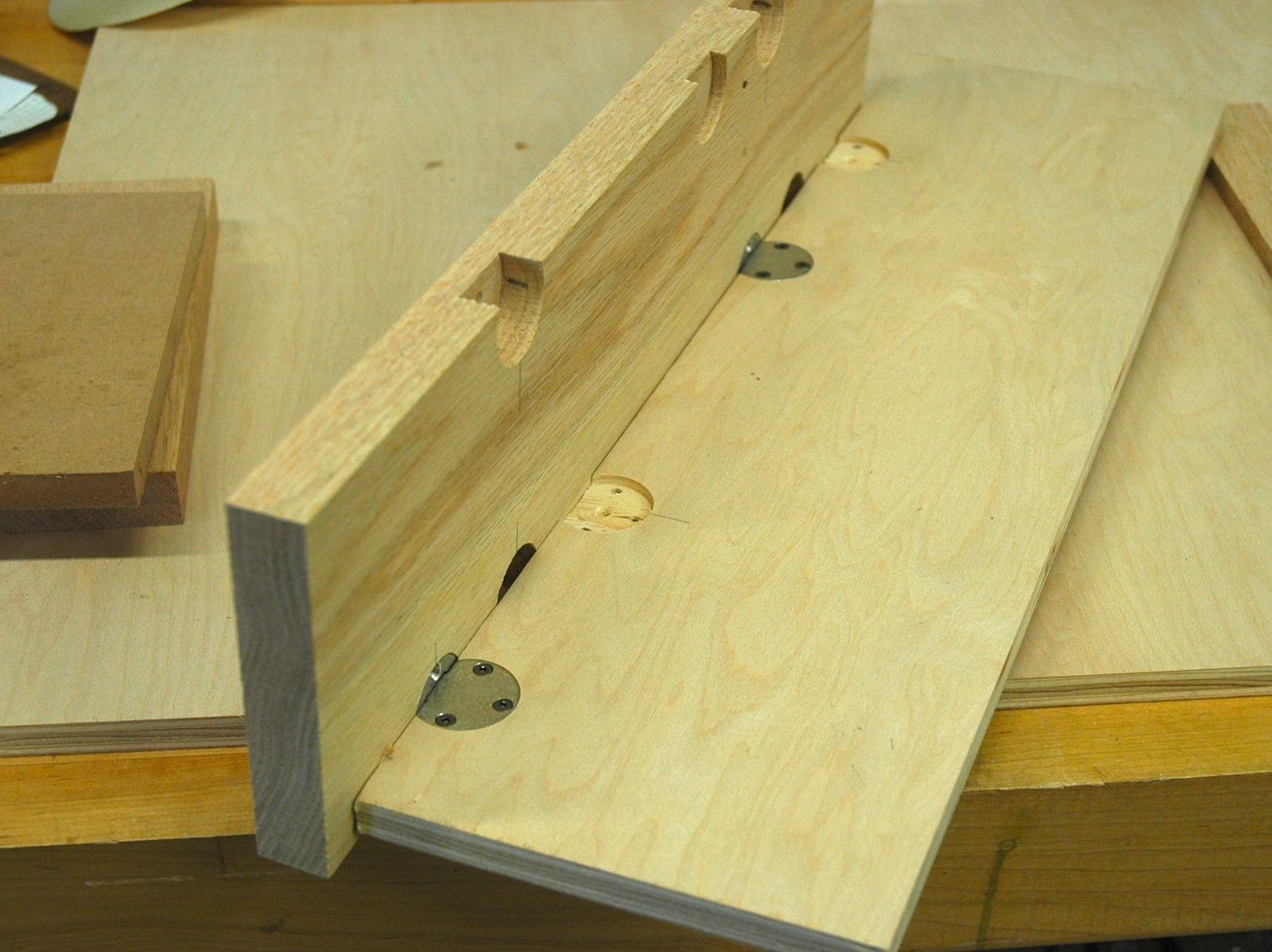

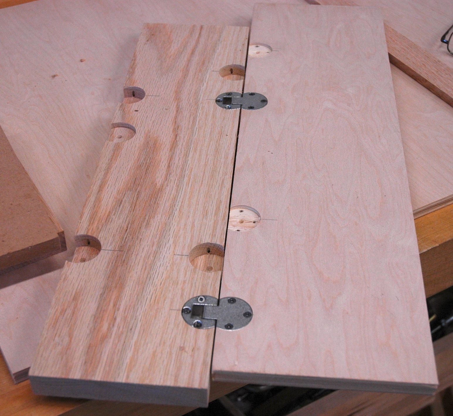

Success! If you've followed my hinge saga for the drop down drawer front I've got everything figured out. To get the effect of the drawer front being 1/8" lower than the tray, I need to use 1/2" material for the tray and 3/4" material for the drawer front (OK, 12mm for the tray and 16MM for the front). Next the 1 3/16" forstner wasn't working, the hole is far to sloppy for the hinges (too big), soo I wound up buying a Fisch 30 MM bit. This one is Austrian, and the quality difference versus the Chinese bit (1 3/16" is considerable...it's also HSS. Then setting the DP fence precisely 8.5mm from the edge of the work pieces was a PITA, these hinges require a little more precision than typical for woodworking. But after all that you can see my test pieces (notice the several test holes) open/close the way i want for the desk. I probably have to put this on hold for some yard work at the moment, but I'm leaviung the DP set up for when I can get back to this, and maybe get the thing ready for finishing.

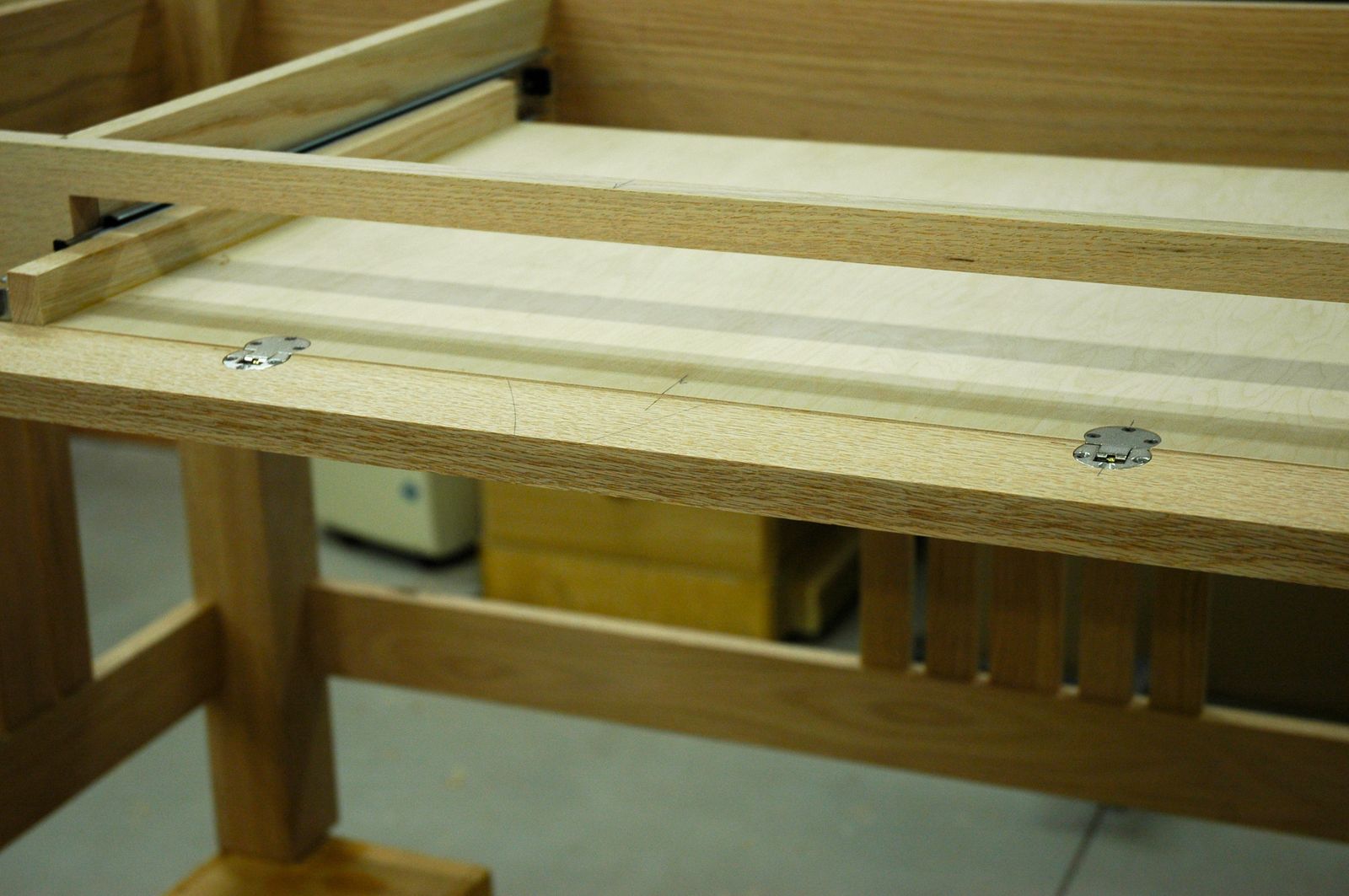

OK, got the frame together and proved I can have an inset drop down drawer front. I didn't think I was going to get this figured out. Even then the drawer front isn't perfectly centered side to side so i screwed something up; not sure if I'll try to fix it or not.traydn.JPG.7a24152c52ef3e96b61e61ba25aae128.JPG752509732_trayupcopy.JpG.12ecc045c776c37df1a9dec5ea391243.JpG
