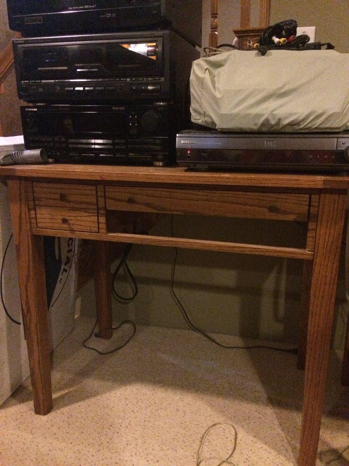

    Well, got the stain on and it'll be OK for the intended use (have I mentioned I don't like red oak?). The staining (which I do don't a whole lot) came out much nicer than the flash makes it appear...t

    Arts and Crafts. Well, the easing is done...all that's left is the staining (something I hate doing)and finishing....and sweeping up the mess. Because this is red oak, I'll be using a dark gel stain a

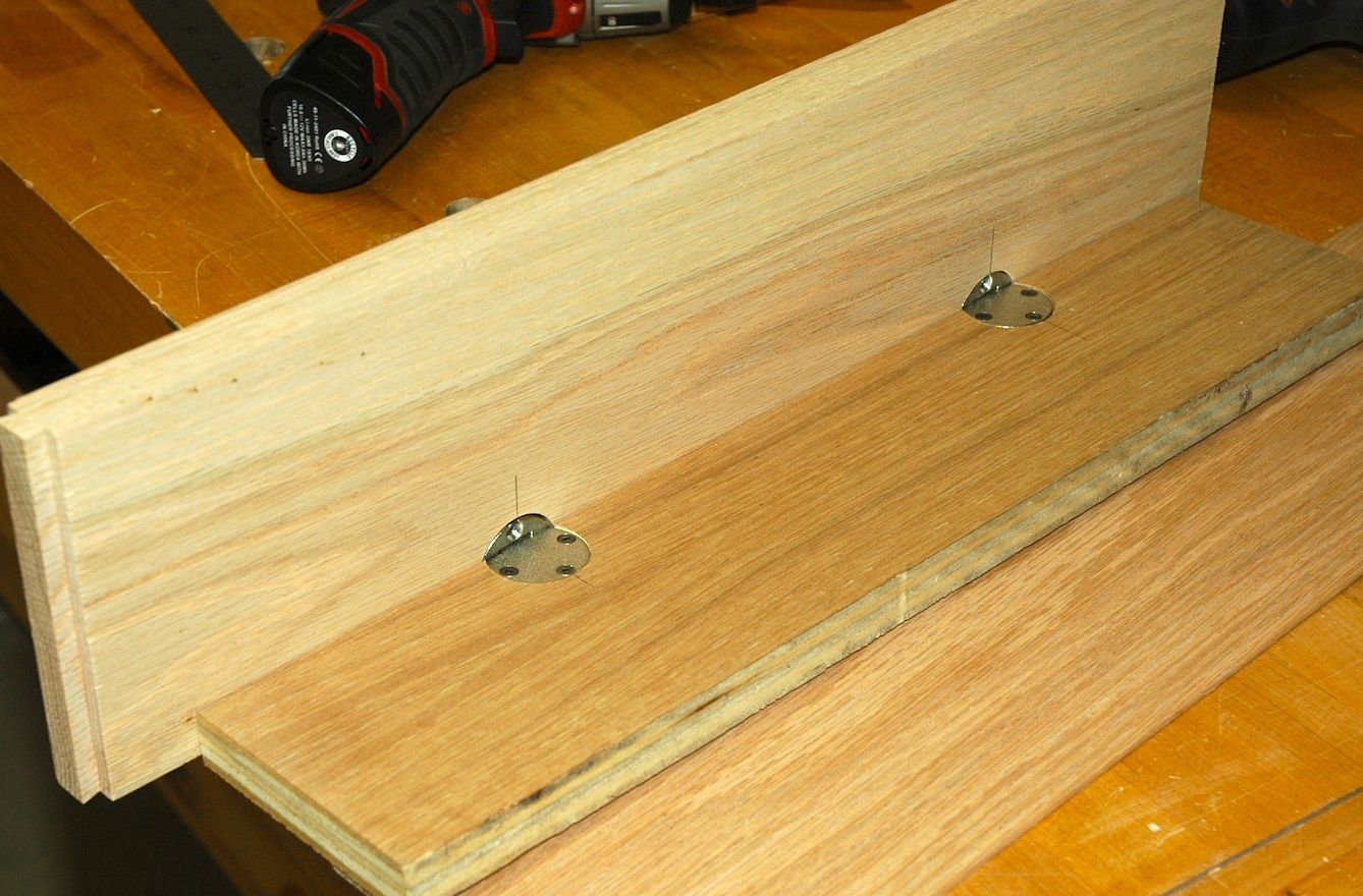

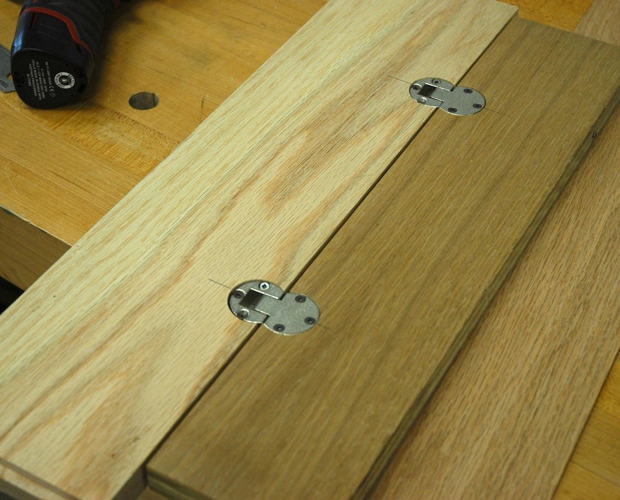

OK, I've done a test with the drill bit and those hinges. Couple of things, the drill bit actually cuts holes 1/32" undersize...but that's still a fairly sloppy fit with a 30 MM hinge. I think it will still work. I fastened to test boards together with the hinges and the results weren't spectacular (I learned a lot). First the hinges didn't come with screws, but I did have a supply of #6x 3/4" flatheads I keep on hand for hinges. They seemed to fit just fine. The hinge requires 2 different depth holes. The one you see in the plywood is supposed to be 3mm deep, the other side is 12MM deep. When I do that, the drawer front (the solid oak piece on the left) isn't flush with the bottom of the tray (the plywood). So I drilled the ply wood hole another 1/8" deeper and they lined up. These hinges aren't perfect but they'll work for the basement desk....I'll choose a different set (they make some that are larger and use the same depth hole on both pieces. One other thing, the screws on the drawer front piece are actually angled into the wood, it's really hard to get the hinge properly aligned with the set up, the screw kept trying to pull the hinge out of place. I don't know if you can see the misalignment in the bottom most hinge in the pic, but it out of alignment enough to make the flaps close very tightly.

Success! If you've followed my hinge saga for the drop down drawer front I've got everything figured out. To get the effect of the drawer front being 1/8" lower than the tray, I need to use 1/2" material for the tray and 3/4" material for the drawer front (OK, 12mm for the tray and 16MM for the front). Next the 1 3/16" forstner wasn't working, the hole is far to sloppy for the hinges (too big), soo I wound up buying a Fisch 30 MM bit. This one is Austrian, and the quality difference versus the Chinese bit (1 3/16" is considerable...it's also HSS. Then setting the DP fence precisely 8.5mm from the edge of the work pieces was a PITA, these hinges require a little more precision than typical for woodworking. But after all that you can see my test pieces (notice the several test holes) open/close the way i want for the desk. I probably have to put this on hold for some yard work at the moment, but I'm leaviung the DP set up for when I can get back to this, and maybe get the thing ready for finishing.

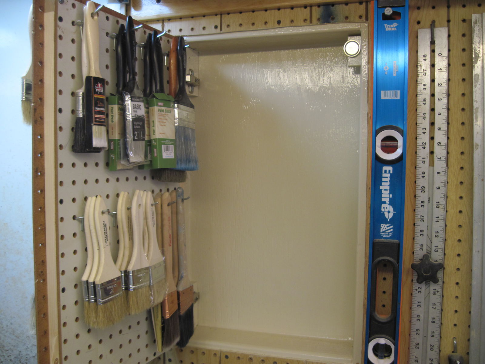

I ran into something like this when building this hidden cabinet.  Was limited on how thick the door could be and remain flush with the wall.  Don't remember the measurements but I do recall I couldn't use my original plan.
