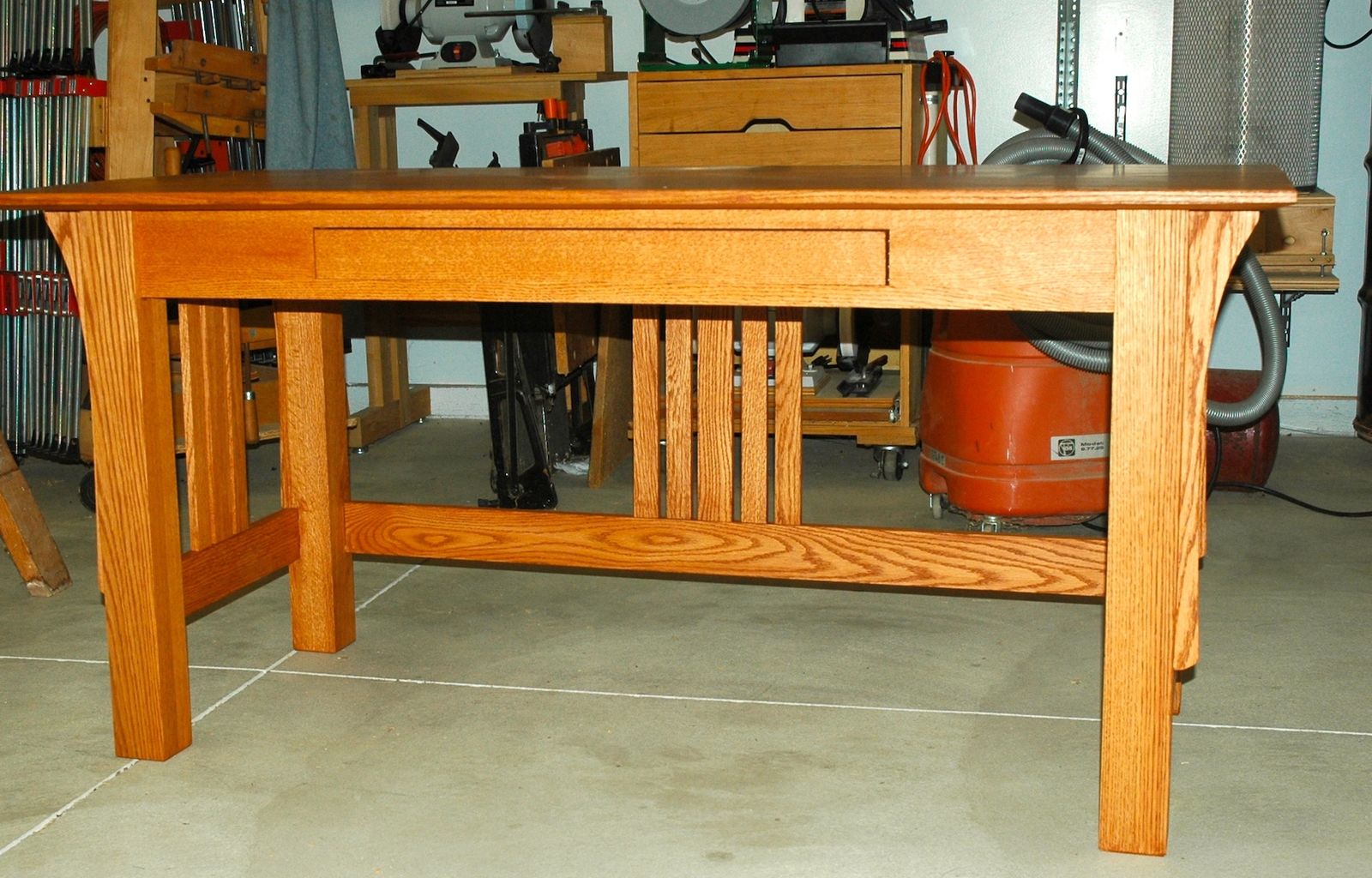

I had mentioned in another post I was building a desk. This isn't anything really challenging but I want to prove I'm doing something. I need 2 of these, one for a basement area I use and another for our main floor "office". I was planning on doing both in an A&C style, but I now think the second one will be more contemporary. The reason why is that both are computer desks, and I want/need a drop down drawer front for a keyboard tray. The A&C style with inset drawers just doesn't lend itself to that convention. In the pics below you can see the drawer opening...since I don't have a way to hinge the front down (with hidden hinges, and it stay level when opened) I'm thinking it will just be removable, held in place with spring clips. Then the keyboard tray will just pull out.  Anyway, I mentioned a week or so ago I had these wide oak boards I would be using. They were supposed to be white oak, turns out all but the one on the left is red oak. I don't like red oak, and never use it...much preferring the white species. But I have what I have, so I went and bought some more red oak to complete the desk, and you can see the dry fitted frame. Nothing remarkable here, but I did do every joint with loose tenons and that worked out OK.

    Well, got the stain on and it'll be OK for the intended use (have I mentioned I don't like red oak?). The staining (which I do don't a whole lot) came out much nicer than the flash makes it appear...t

    Arts and Crafts. Well, the easing is done...all that's left is the staining (something I hate doing)and finishing....and sweeping up the mess. Because this is red oak, I'll be using a dark gel stain a
