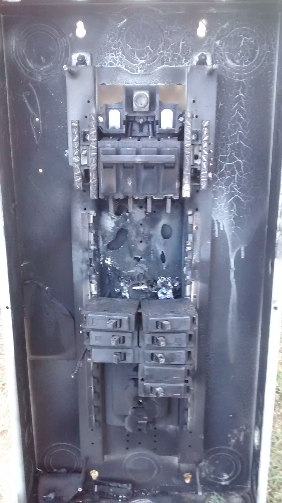

7 hours ago, Artie said:
but you lose an extra spot in the breaker panel.
My neighbor had this problem, they doubled up circuits to the breaker box.  THEN in trying to force a AC compressor to run they went straight to the box and overloaded it.  Set it on fire, melted it to slag.  He put the fire out with?  BEER, yes folks drunk people do crazy stuff.
Since we like pictures here is the aftermath of insanity squared.  We went and got a new box and breakers from the borg and starting at 2030 till 2300 I worked steady at install and rewiring every one of those circuits.  Was my first time doing a breaker box entirely by myself.  Had done this with my Grandfather, my Dad and a friend but this, yeah I left the drunken one out of this equation.  Not to say I didn't have a few AFTER it all worked.
@Artie even passed inspection by the electrician he had drop by few days later.
