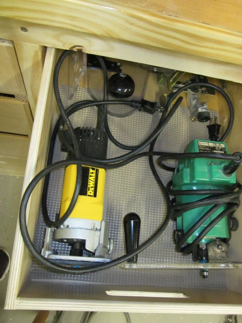

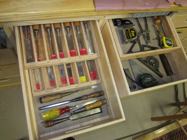

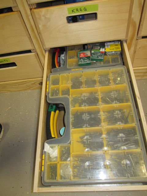

2. Storage underneath for frequently used tools and hardware.  Since I decided to fully retire this spring, I have lots of specialty hardware that I used to take onsite that can now reside in the shop, but I need a place for it.  I managed to win a bid for the wine display when a local Sam's Club closed and I got about 25 wine box displays made from 1/2" baltic birch.  They will make fine drawers.   In addition for my $8, I got about $20 worth of Roberson screws, a bunch of 2x4 shorts, about 10 pieces of 3/8" plywood, and some metal racks (that I gave to a friend who runs a feed mill).

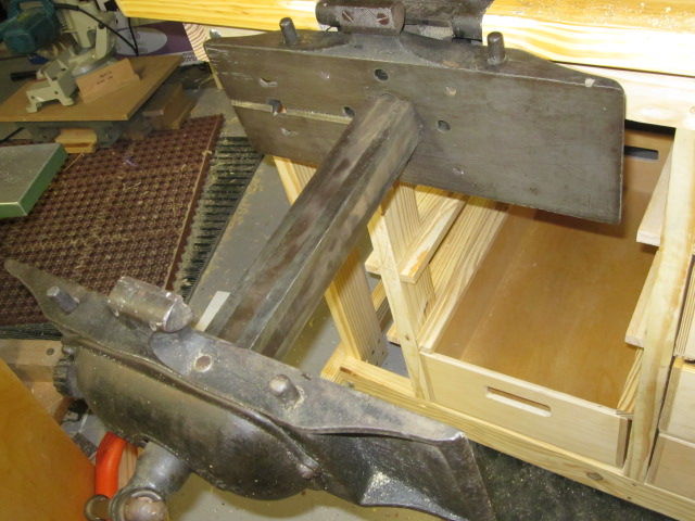

3. A place for my Emmert patternmaker's vise that I've never had a place for.  It's a heavy guy about 75 lb. Rotates around, swivels out, and holds tapered pieces.

Here's some of the wine boxes, a few of which I've cut hand-holds in.   The rest will get it later.   I have a jig, use a plunge router with a bushing and mortising bit.

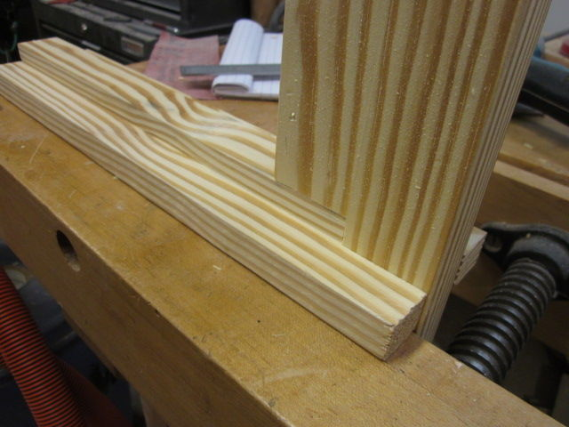

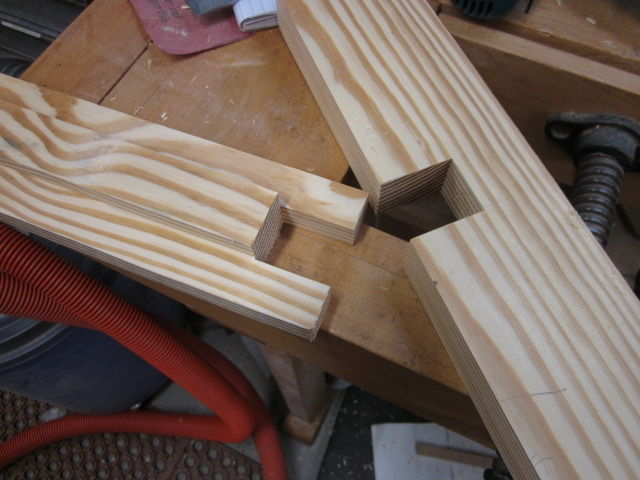

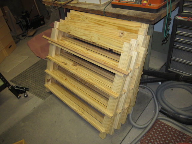

I thought about how to make the whole thing sturdy, yet disassemble with ease.   While driving across the state, my mind came up with this approach to support all the drawers.  Here's the prototype joint for the drawer runners into the vertical supports
2019_09040004.JPG.91e27c56ec721ff9bd82ab16d91d996a.JPG2019_09040005.JPG.df8c82484c0db0d00c779759ed9d7070.JPG
That works and gave my dado head a real workout.
Stock for drawer runners and vertical supports.
Until next time, working on rabbeting the drawer glides.

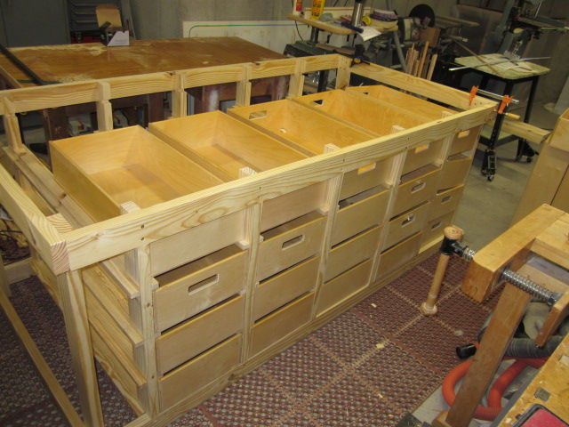

  • Got the rabbets for drawer glides cut this afternoon and all (20) them and 5 top supports fit in the posts this afternoon.  Next step is to do the left to right spacing for the drawers (two different
  • T minus 10. Got the end supports built and top and bottom rails laid out and attached today.   Lots of mental geometry with two different width boxes and two different lengths of each.  A few sma

Good thing you're so tall with a table that big. But this will be fun to follow. Torsion box top?
Got the rabbets for drawer glides cut this afternoon and all (20) them and 5 top supports fit in the posts this afternoon.  Next step is to do the left to right spacing for the drawers (two different widths) and make the end posts
 I thought about doing a torsion box but decided that 1 1/2" of plywood would do for me.   I'm still trying to decide what I have that is 4x8 and close to dead flat.   Yeah, I can almost reach all the way across a 48" span.   37" shirt sleeves plus leaning over.
It's going to be a hair over 37" tall, same height as my Tage Frid bench and level with my palms held horizontally or "thumb height."

T minus 10.
Got the end supports built and top and bottom rails laid out and attached today.   Lots of mental geometry with two different width boxes and two different lengths of each.  A few small thing to do like add shelf/drawer glides to the end panels.  That's why the right hand drawers look askew.   Then on to the top and get the vise attached.   The top row of boxes (drawers) will need to be cut down an inch and the rest of the hand-holds cut out.  But it went together, got squared up, and all the drawers fit without slop or binding (!)  Trying to align 20 dado to dado joints in two dimensions each took some time, even with the help of gravity.    Building something this big on my undersized table reminded me of why I wanted a larger table.
This is not supposed to be mobile right?  Because I can tell you from experience once you fill it up that thing will require a truck to move.
:JawDrop:
Makes for one heckofa lot of drawers. Looking good.
:JawDrop:
It will not be on casters.
Objective #4. Able to disassemble with minimal work in case I need to move it in the future.
The top's not on yet, but so far, it will take 8 carriage bolts to disassemble.   The end and side frames separate and everything else is cross lap joints that slip apart.

Speaking of which, is this called a "cross lap joint?"    It's just something I thought up.
If you want to call it a cross lap joint, then that's what it is. This is woodworking, after all.
Should have mentioned....a cross lap is what I call that joint as well.
