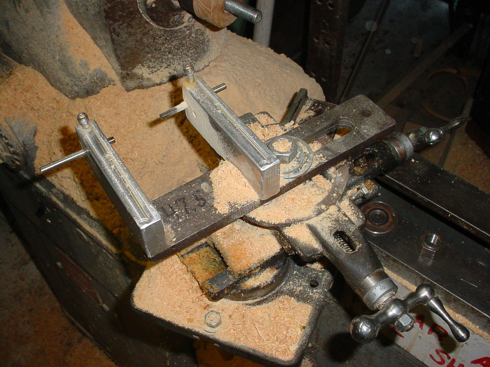

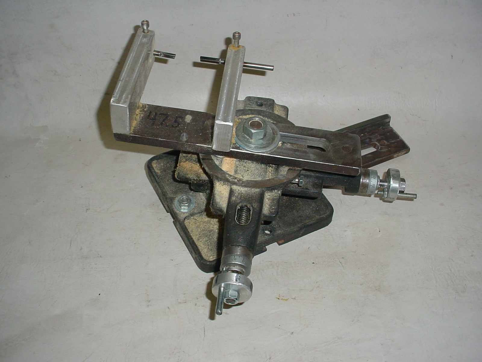

I finally got around to working on the ringmaster face-plate mount in order to "avoid a hole in the base", and after a little thought and experimentation, there is a solution. First, my adaptation is for the Ring Master for Lathes, in my case a Jet 1442.  To make the bowl without the threaded spindle mount, I extended the distance from the lathe power-head by simply mounting a separator/extender (made from a blank cut from a 2"engineered beam used in new home construction obtained via "dumpster dive") on the face-plate.  I mounted the bowl blank to the extended face-plate with double stick tape.  I use 3M™ Double Coated Tape to mound the blank to the face-plate being careful to center the blank on the face-plate.  See the picture below.  This tape has never failed me on any application.  I cut a small recess on the face-plate mount which I use as an access with a small pry tool like a screwdriver.  Slow pressure will cause the tape to separate from the bowl base.
To cut the rings, I simply reversed the angle of the cutter head as shown below.  I used my PAG to set the angle just as I would set up normally.  You'll notice that the image also shows the position of the cutter head to the face-plate.  I started with a 12" blank and was able to cut 6 rings before running out of space.   bye bye hole in the bottom of the bowl.
Gluing the rings to make a bowl is not a problem since I use a homemade "bearing press" which I constructed from steel tubing acquired from more dumpster diving and assembled with bolts.  Much better than the all-thread method.
I really wanted a ringmaster but I did not have the $$$ to play with.
So I made one. The hardest part was finding something to use for
the cutters. also using it the first few time finding the right angles.
I really like the center hole because I put all the rings on my work
bench and bolt it down through my bench using that hole for the
glue up.
