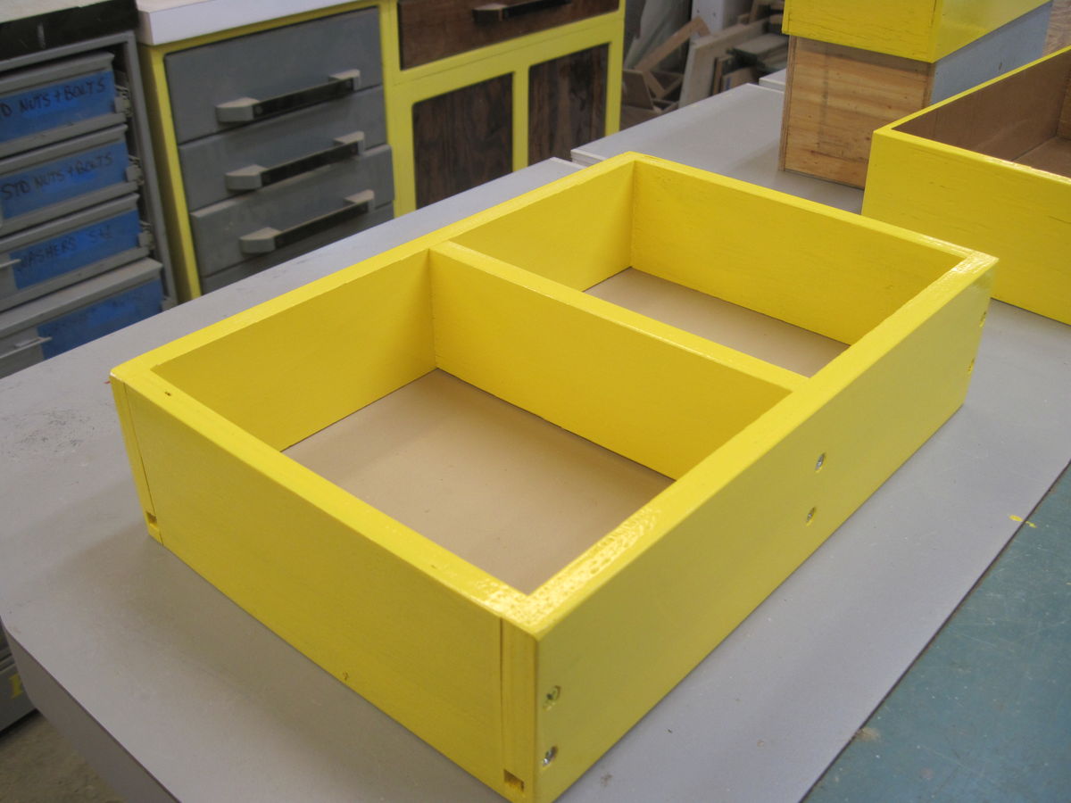

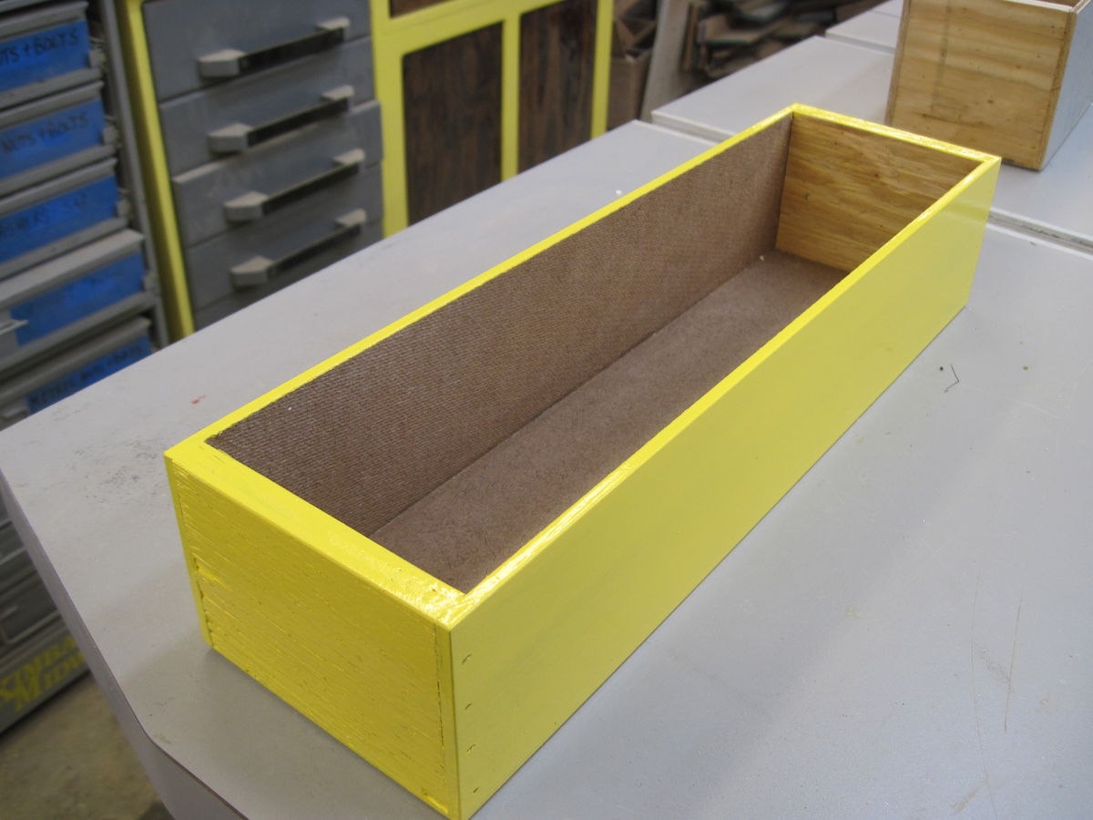

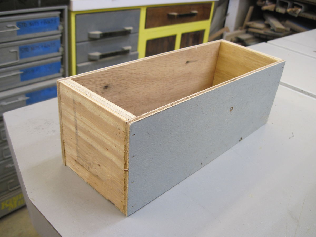

My apprentice made these 4 drawer inserts.  He wanted to learn how so he can make his own.  This was a lesson in planning, as well as finishing techniques.  All of these are made from scraps so some had paint on them.  No problem for this shop project.
4 completed inserts.  Before any finishing.
This one gets no finish, no sanding.
This on has no finish inside and 120 grit sanding pass with ROS then paint on outside. Edges rounded over with sandpaper block.
This one has been sanded twice.  A pass with ROS at 12o, then second pass at 150.  Rounded edges then 3 coats lacquer inside, 3 coats paint outside.
Last one has been sanded 3 times, 120, 150 then 220.  Inside and out, rounded edges.  3 coats of paint.  Bottom was lined with vinyl.  No reason just some him some other things that can be done.
Once done I asked him to decide.  His response.  They all look good and for the shop who cares. His preference?  Looks better when you finish it all.  Reality? Well it does take a long time to paint and wait for it to dry.
A good lesson for him, and a visual for others.
