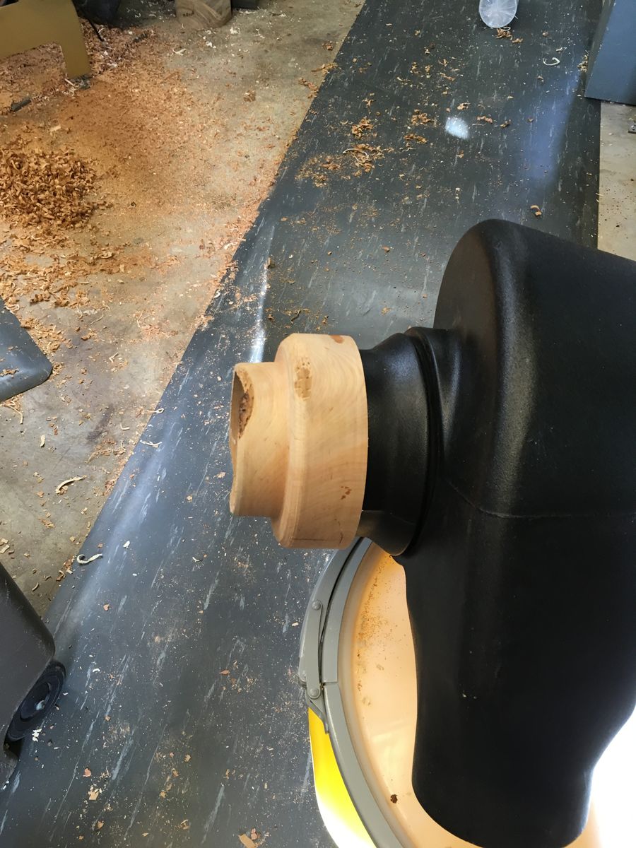

  • Finished the setup today. I turned a 6 inch to 5 inch to go to the DC and a 4 to 5 for the inflow adapter. Then cut the hole in barrel lid and enlarged the ceiling hole to pass hose thru.

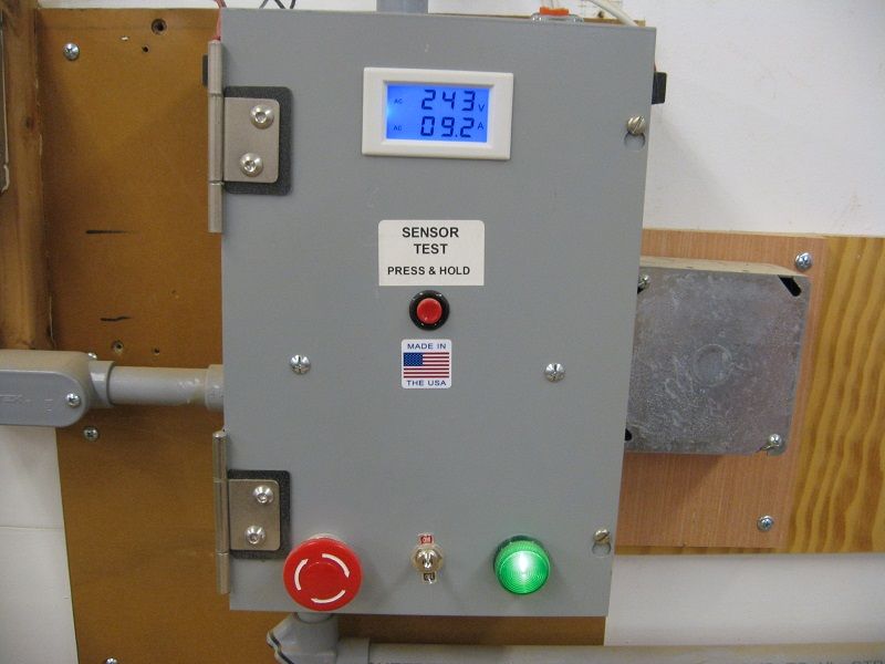

I have sensors at the top of the 32 gal garbage can, and when it gets full it sets off a blue strobe light in the shop.
I could lower the sensors but the black trash bag in the garbage can might not let the sensor "see' through to detect the level of chips if I lower it. and I hate to cut a hole in both sides of the bag, it would defeat the purpose of the bag.
Herb
Nice set up.  I also have a sensor.  I ask my self how long has it been since you checked the bag?  :JawDrop:
If you are thinking that, it is time to check the bag. I also have a test button on my DC Electrical panel I can press to check the sensors and set off the strobe light if my little heart desires.
Herb
Got a picture of this?  I have several DC power supplies in the shop.  Always looking for some more garage engineering ideas to upgrade.  My neighbor thinks I am a mad scientist when he comes to visit and I am doing wiring and such. :Laughing:
